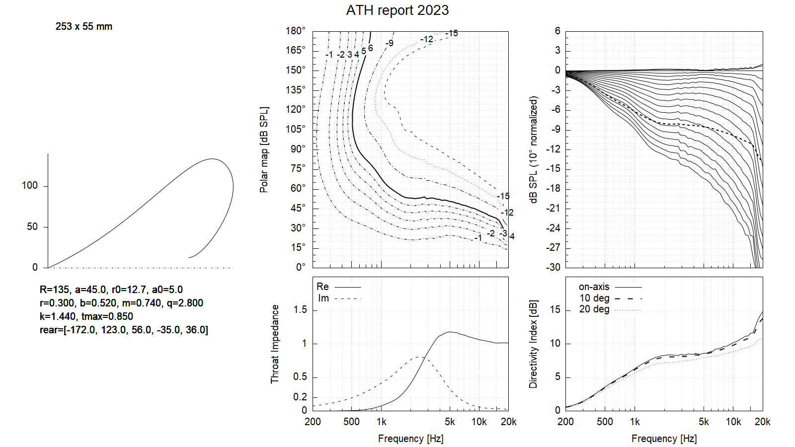

Here's an improved report functionality for circular symmetry with R-OSSE, including the back side:
https://at-horns.eu/ext/ath-4.9.0-pre-230113.zip
Copy the attached gpl file into lib\scripts and use it this way:
Report = {
Title = ST260-ROSSE-5
Width = 1600
Height = 900
GnuplotCode = rcirc-mono.gpl
MaxRadius = 150
MaxAnglePM = 180

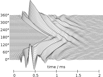

- I just came across this graph, haven't seen this before. It's basically a polar map in the time domain - impulse responses at various angles.
Could it help to visualize something not readily seen in a level map?

Interesting. Maybe early reflections show up. It's kinda like the reverse what you do for anechoic measurements.
Seems like the same data as the level map, but presented in a different and worthwhile way. Resonances, diffraction effects, and maybe even the hard to measure HOMs?
Curious to see what the "diffraction hunters" (said in an admiring way) think.

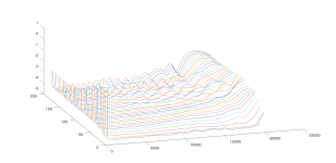

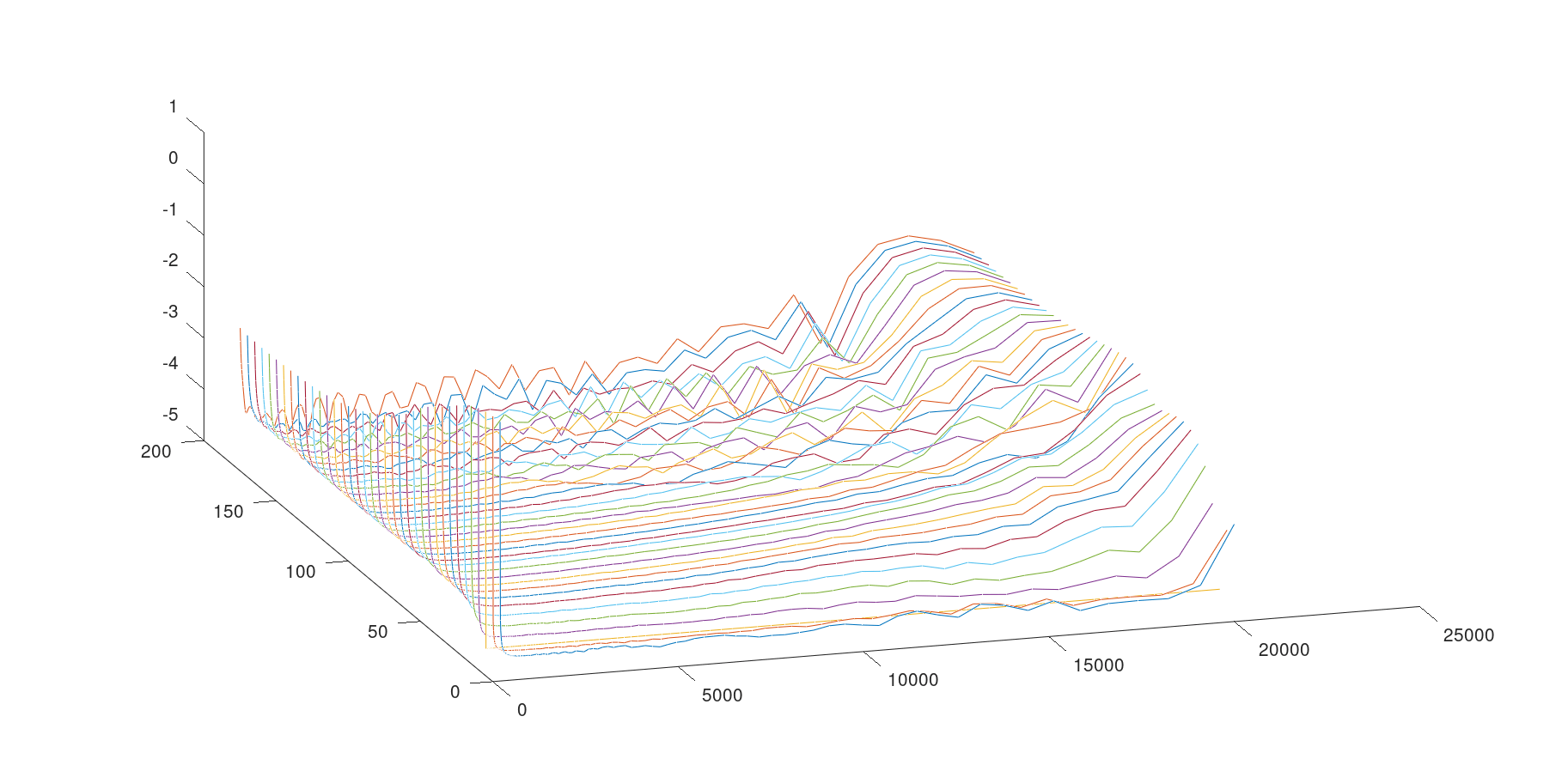

Warning: very preliminary stuff ahead! Input for a brainstorm session.
I parsed the vips file generated by ABEC. Inside are the frequencies, angles and something that can be used to calculate the SPL. Let's call it X. X is complex and represents something like the frequency dependent amplitude and phase. If that is the case, than the convolution theorem says that the inverse FFT is the impulse response. So I calculated ifft(X), took the 'abs' (data was still complex ??), took the 'log' to enhance the low level signals and plotted the result.
The time axis still has frequency numbers; i didn't bother to convert that
The angle is the angle in degrees.
There is something in the data, but how to interpret this is a bit of a mistery. I hope some smart people can do some smart things 🙂
Those are frequency responses of the device but only the magnitudes, so it's not a complete information (unlike the impulse response but that's hard to read directly). So the question is if there's something that could emerge in an IR polar map, that would be easier to notice. Maybe not.
I'll try to get IRs from the simulated data.

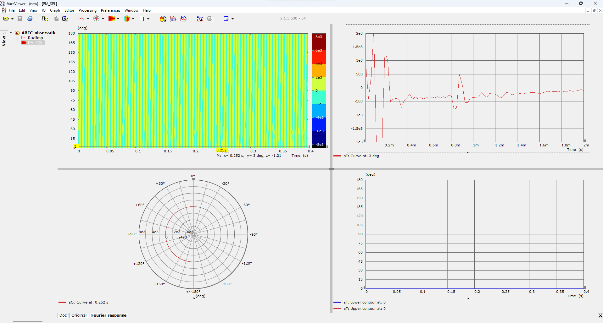

I think that the simulator calculates a complex transfer function for each frequency. From enough points it should be possible to calculate the corresponding impulse response (via IFFT) in any detail, it's only not that straightforward as Tom showed.
Sorta. I think it is a complex pressure per frequency which is a transfer function.

In VACS you can convert the responses to IR's by choosing the Fourier Response option in Processing Tab.I think that the simulator calculates a complex transfer function for each frequency. From enough points it should be possible to calculate the corresponding impulse response (via IFFT) in any detail, it's only not that straightforward as Tom showed.

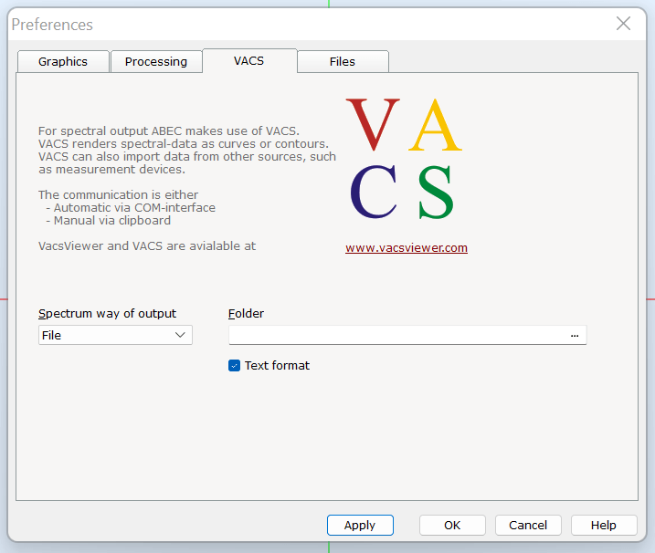

I don't know as I haven't tried. The option to export the spectrum that is used in ABEC is not there in AKABAK, but I think you can just redirect the output to VACS into a file like in the screenshot attached.When I solve an imported ABEC3 project from AKABAK, will the FRD export function work?

The time delay can be removed from responses directly in VACS, or Vituix can generate a minimum phase response just by ticking a box. Both options will give clean phase traces to make further experimenting easier.
