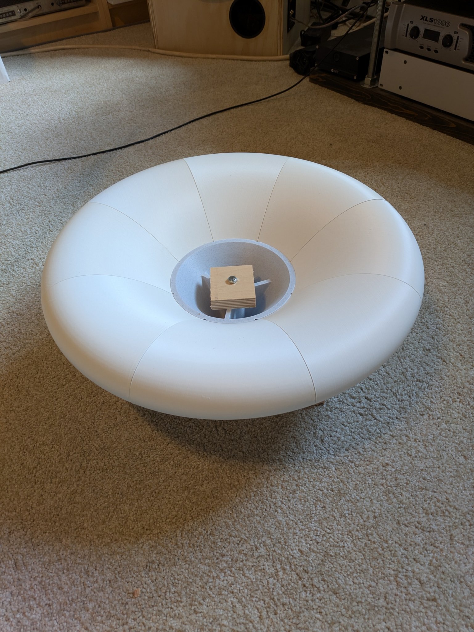

I haven't glued mine yet, but here is one assembly with the petals in place on the base with the assembly jig to show you how they go together:
I found that the petals need a little 'fettling' to fit snugly together. The indexing pins are a little bigger than the divots into which they fit so they cause a small but visible gap. I also get a couple of lumps on the mating surface that are consistent on every print, so I suspect they are artifacts of the slicer. A little filing and reaming with a drill bit let things fit together better. This all might vary depending on the slicer, printer and filament used. I plan on using Gorilla Glue Clear, which is non-foaming, and has enough open assembly time to allow everything to be placed in the jig.

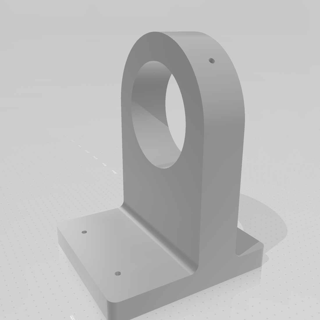

I'm a rank beginner when it comes to CAD, but I took a while this morning to try to design a horn mount that would fit the A460s. Here's a render from windows Print 3D:
The adapter barrel should be a close slip fit into the hole, and there are a couple of M8 setscrew holes to allow it to be snugged up and prevent rattling. We'll see how well the threads print.
It's made to screw into threaded inserts in the top of the woofer cabinet. If I got it right, it will give me close to a 1.2 wavelength driver spacing at 800 Hz, and allow the compression driver to be mounted very close to the correct offset for timing with the woofer. Maybe I should have slotted the holes for adjustment? The whole assembly is too tall for my printer, so I had to split it on the center line of the hole (175 mm up from the base) and add dowels for alignment. That was done in the slicer where I'm more comfortable. Pics of the real thing once it's printed, and if it works!

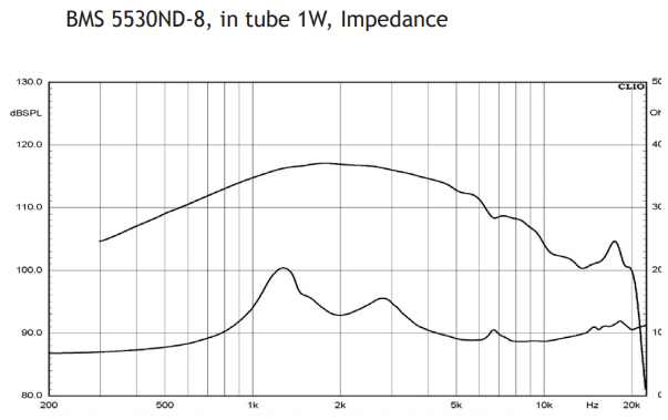

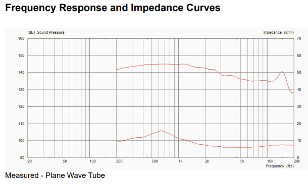

Ok, understood. I was surprised as there was no indication of this in the datasheet, but maybe that's just due to excessive smoothing. PWT of CDX14-3055:No, there's no chance that an angle mismatch per se would cause this. It's just very difficult (to impossible) to combine coherently everything from the different parts of the moderately large diaphragm and the compression cavity once the wavelengths are so small. With this driver, they did absolutely amazing job from the bottom up to ~12 kHz, then it seems they just let it go its way...
Yeah, something like that. I'm definitely going to try an exit-angle-optimized adapter for this driver, sooner or later. This matching has typically the biggest effect in the midrange - with a "matched" adapter it's typically the smoothest.
Very similar to PWT measurement of BMS 5530ND:
I would even doubt it's the right driver. Their graphs are often all over the place - different on the web and in various datasheets. It's best to ignore completely, IMO. How can you trust a picture named "CDX14-3055-PWT-Marketing-Curve.jpg"? 🙂Ok, understood. I was surprised as there was no indication of this in the datasheet, but maybe that's just due to excessive smoothing. PWT of CDX14-3055:

One note on the provided assembly jig - it's not meant to fix the petals together with a force (it can't), it's only for the overall alignment. You also need to fix it all together on the outside - either with a tape on the joints or something that you put around the mouth and perhaps tighten a bit.
