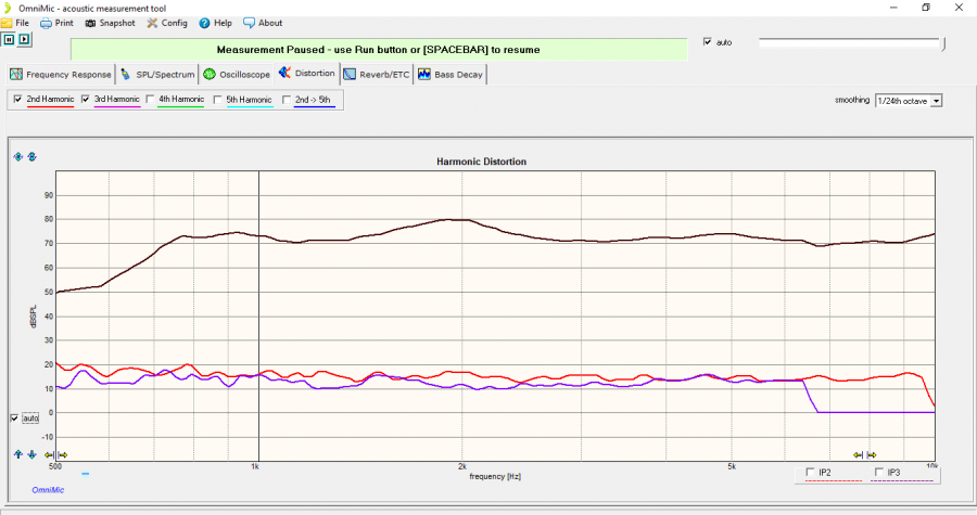

Mazza,Testing this....
I got this...

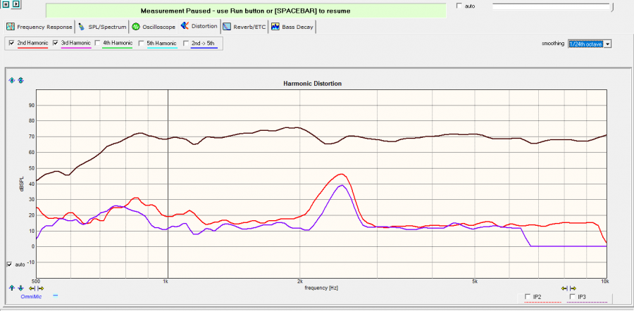

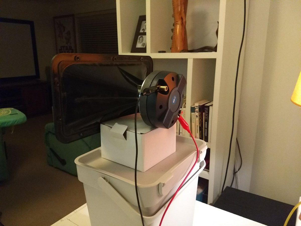

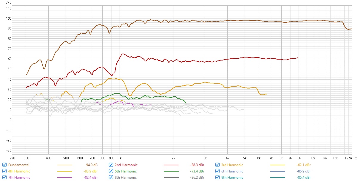

After disassembling and then running some masking tape around the voice coil gap to see if any manufacturing swarf might have been interfering I got this:
Maybe that might help here? Good luck!
Just opened up the driver again. Nothing visible in the gap, running tape around pulled out nothing, and on reassembly I got the same response and distortion. Good thought, but no help in this case.
Bill
If you got the same response and distortion, would that indicate that diaphragm centering is consistent? So perhaps the diaphragm itself is bad rather than any design problem?
454,
That's my sense, yes. There is no play to recenter the 'phragm anyway. Rotating it 180 degrees made no difference.

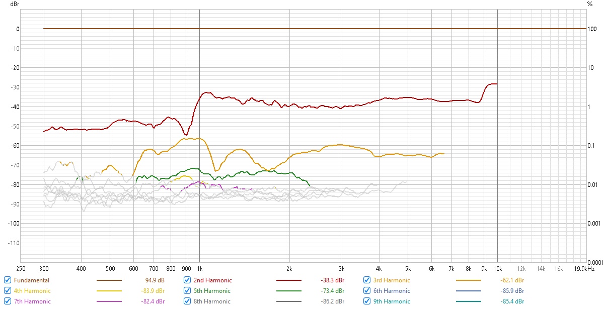

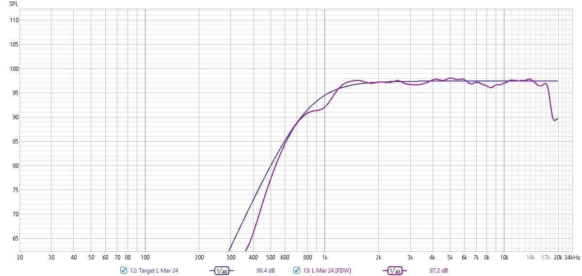

The question for me now is, how bad is it? I have been playing with the miniDSP, pushing the xover point lower. Here's a quick shot at an 800 Hz LR4 in REW' EQ tab (one highpass biquad, 636Hz, Q=0.31, one peak cut, and a HF shelf boost, no attention to the 1 kHz dip) for the 'bad' driver:
And how it measured:
Distortion at 96 dB (maybe 97), SPL and relative:
The THD trace (not shown) entirely tracks the 2nd harmonic.
This is an inexpensive 1" CD running down to 800 Hz, pushing the lower limits of the horn's design, and playing at what would be peak volume in my small room. The 2nd harmonic trace looks odd, but I don't know how mad I can be at it. I expect the mfg. to say it is within spec. Would this be audibly flawed? Bad enough to bail and throw $$$ at more capable drivers? Good enough to justify buying filament and plans to print a pair of A400's or A460's and building boxes for my 15" woofers?

H2 is significantly elevated when comparing it to these measurements, though one's got to remember it is on a different horn: https://www.diyaudio.com/community/...y-tympahny-dfm-2535r00-08.415988/post-7757146The question for me now is, how bad is it?
It is second harmonics, and I read it is mostly inaudible. H3, surpinsingly, doesn't differ a lot.Would this be audibly flawed?
Probably yes. H2 appears to be compromised between 1kHz and 8 kHz, "otherwise" the driver performs similarly.Good enough to justify buying filament and plans to print a pair of A400's or A460's and building boxes for my 15" woofers?
Overlay graph of 2nd harmonic between the two drivers at 96 dB (back to the original data with no filters applied). It's really only worse over about an octave.
I suppose my next step should be to swap the diaphragms between the housings. Maybe tomorrow.
I don't know what kind of mic were used, but most electret measurement mics like EMM-6 or ECM-8000 have elevated H2 due to suboptimal preamp (more precisely, single FET inside the capsule).H2 is significantly elevated when comparing it to these measurements
No pics today, but I did confirm that the distortion behavior follows the diaphragm when swapped into the other housing. No surprise I'm sure.

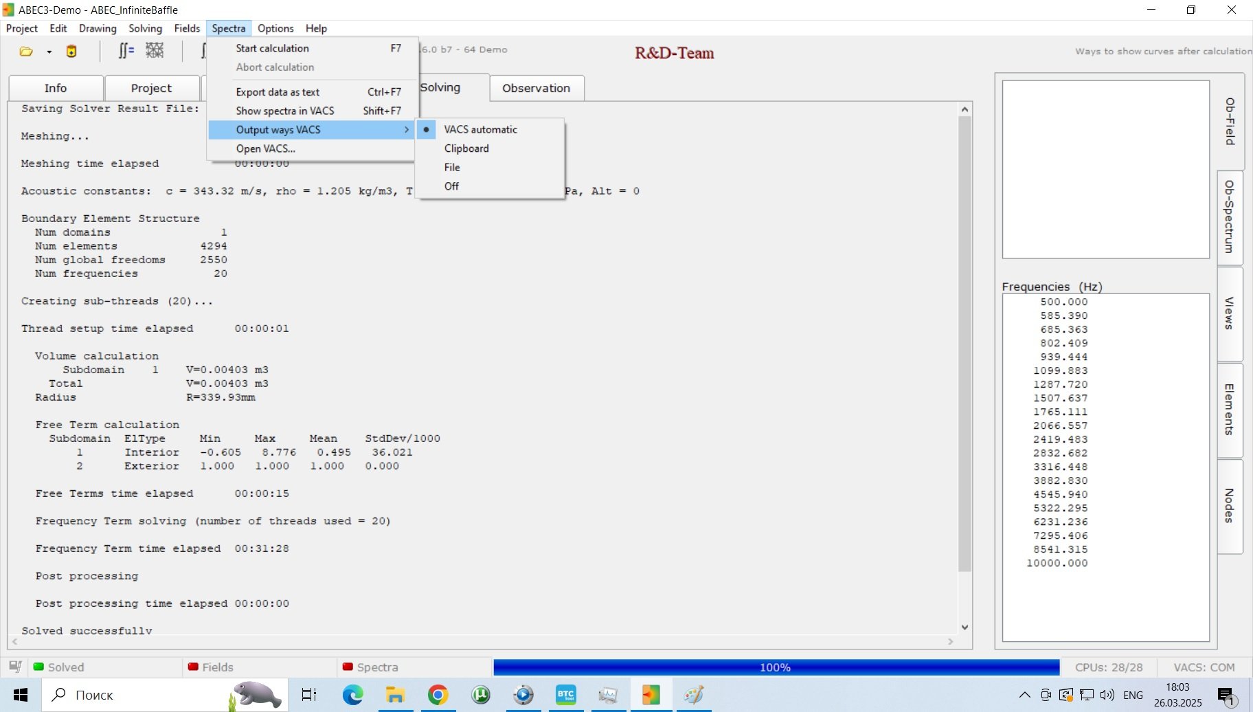

Hi guys. Can you help me? After modeling the ATN waveguide (using the latest version) and successfully calculating abec3, I can't see the results of VACS. I use ABEC_Demo_v360b07_NoInstaller or ABEC_Pro_v360b07 and automatic exit to VACS. The result is the same - VACS does not open. I use the code for the ATH from post №6628. I will be grateful for any help.
You haven't calculated the Spectra so there is nothing to show in VACS, spectrum calculation is separate to solving unless you choose the option to run all calculations. In your screenshot you can select the start calculation option, the spectra will go green and open in VACS.

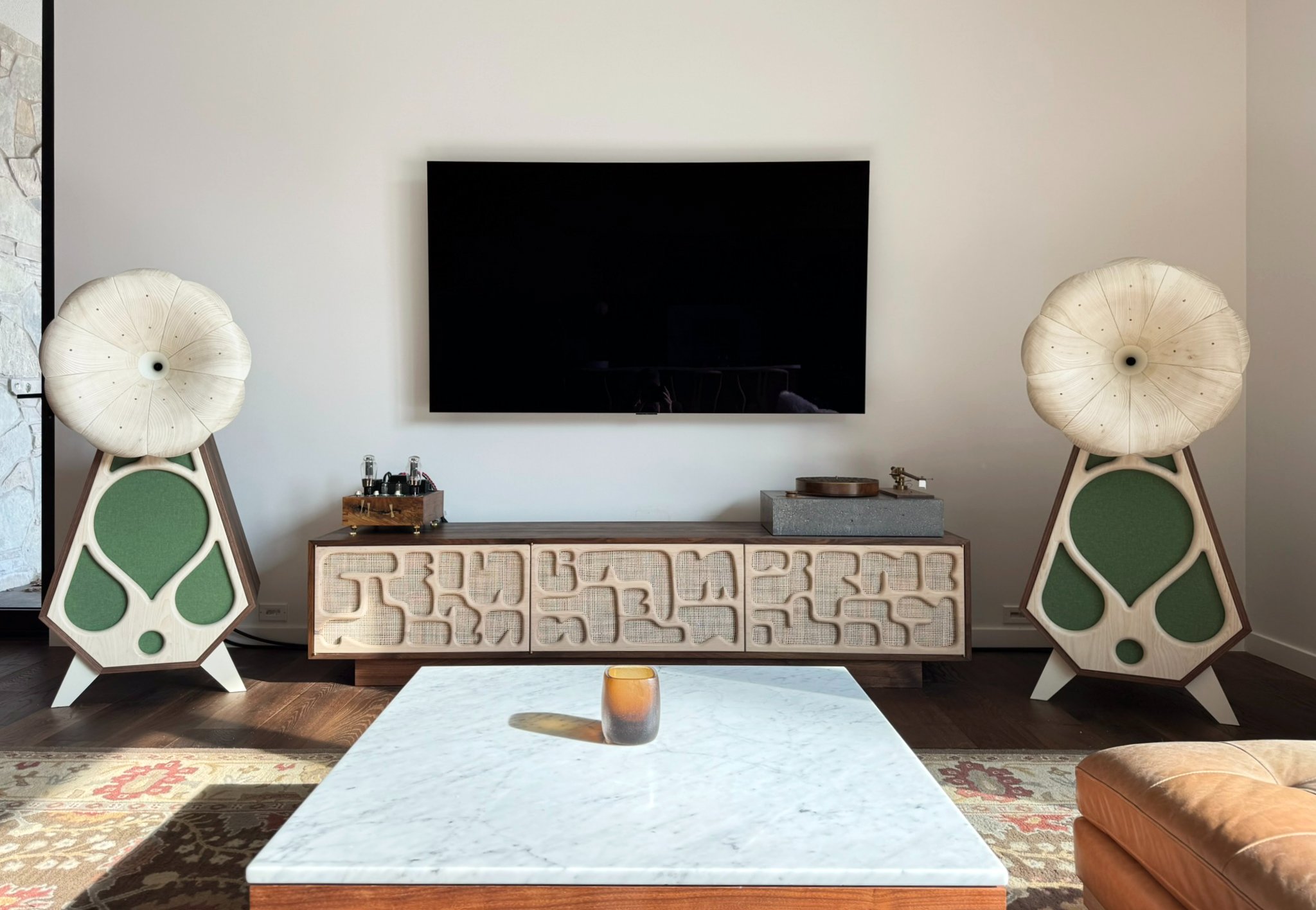

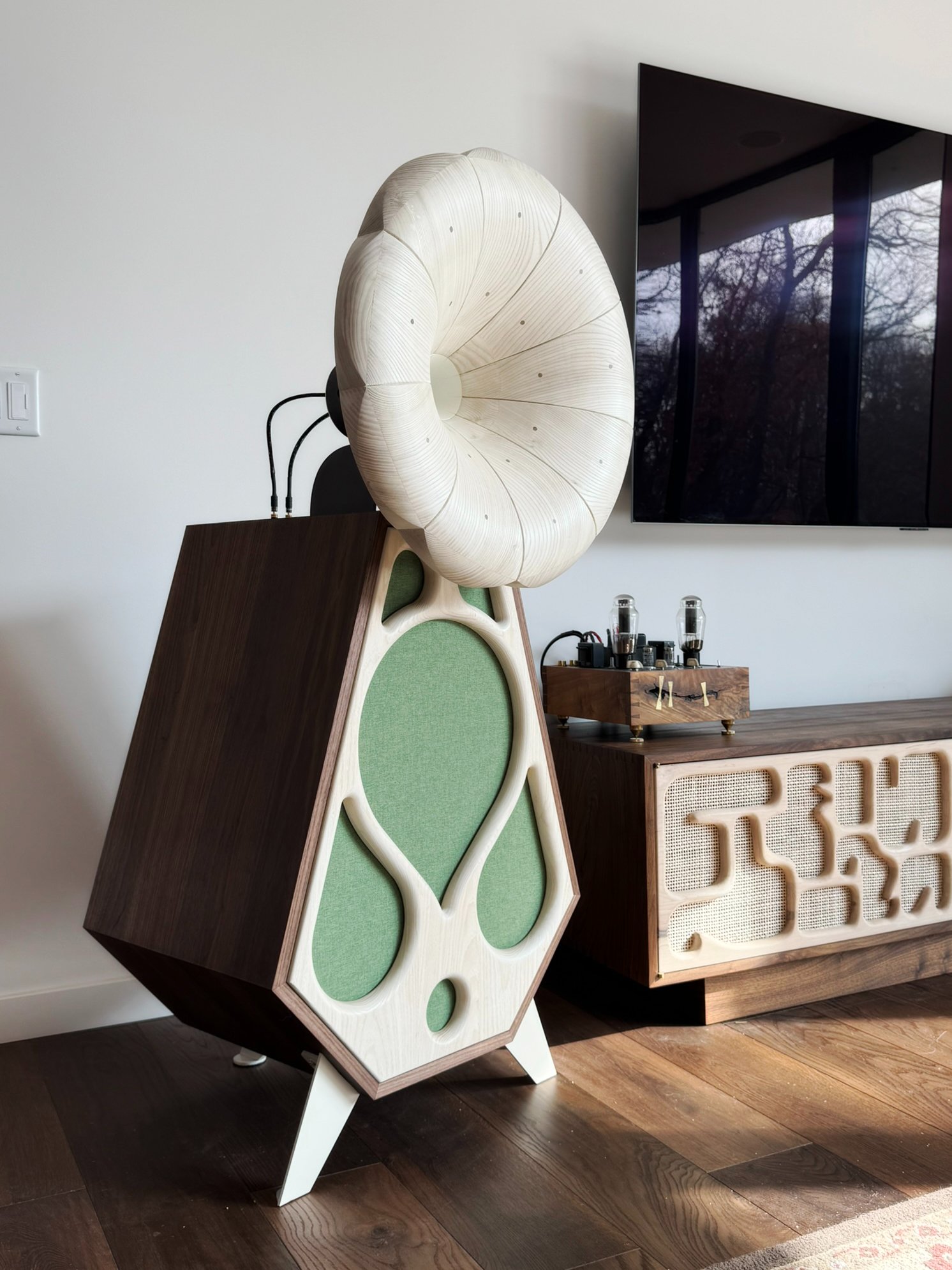

The Stuarts (as I've been calling them because they remind me of the cyclopse Minion of the same name) are done, hooked up, and singing. @mabat - your horn geometry sounds amazing, and that combined with the rear chamber from Joseph Crow got the SB Audience 65CDN-T down to 500 Hz before it really began to drop off. The horn is crossed over at 600 Hz to a Faital Pro 15PR400, actively driven with a 2A3 amp for the horn and a pair of the small but mighty Fosi V3 monoblocks for the woofer. It sounds amazing, loud, and dynamic and I couldn't be happier. Thank you to everyone on this forum for all the advice and knowledge, it is really amazing how much collective intelligence is out there that people are willing to share if you just ask. You are all extremely generous with your talents and I am SO GRATEFUL for it. Thank you!

... look fantastic. Superb form and choice of colors and materials. A work of art - congratulations!The Stuarts
Wow, lovely!are done, hooked up, and singing.
Very nice combination of forms, materials and colors.
I also like the sideboard very much - done by yourself I guess?

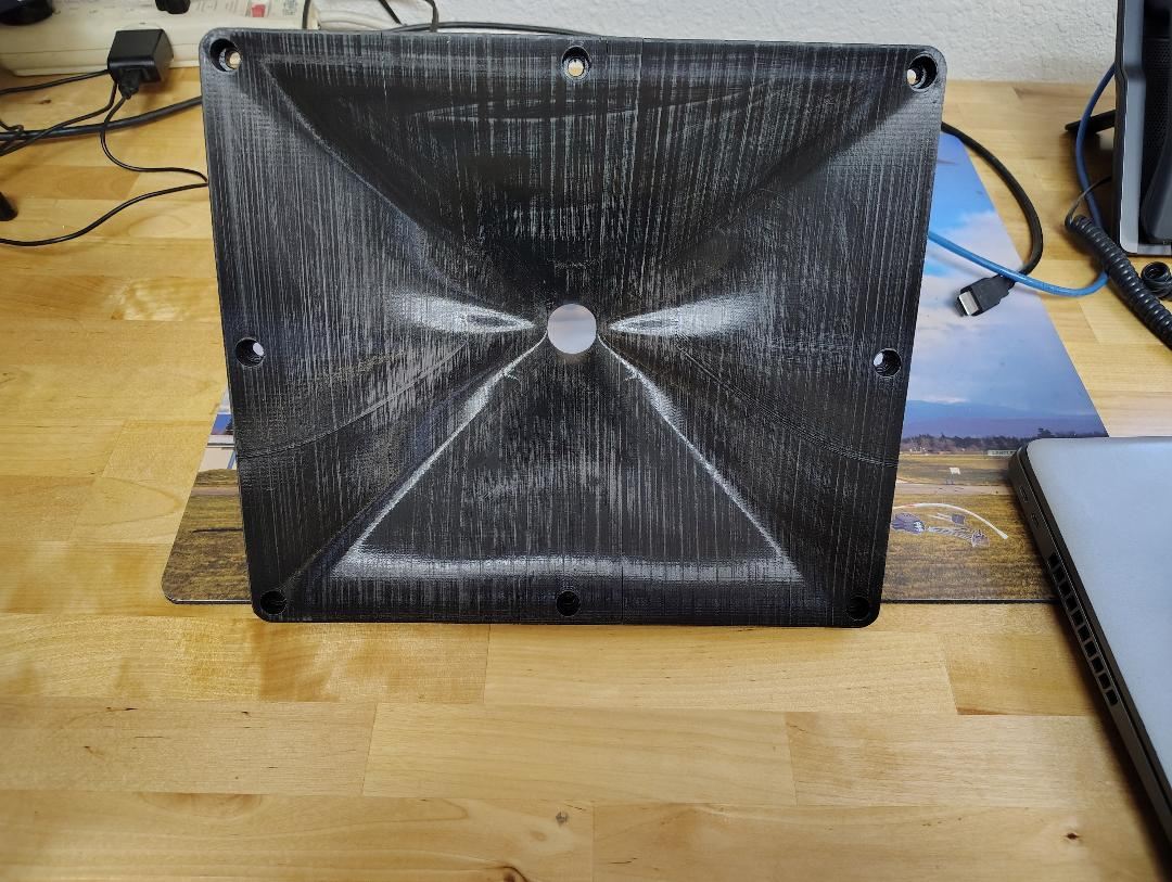

There have been several requests for removing the mounting holes of the Tritonia-M model.
If you want to integrate the waveguide into a custom baffle, there's hardly a better way than using the provided STEP model yourself. Just adapt it however you want -
The above was done in Fusion360, BTW - just click on the hole wall(s) and press Delete (the smaller holes first).
I've updated the STL package at Cults, but the STEP model is really what you want to use for any customization (integrate it in a one-piece CNCed baffle, cut out a woofer hole, whatever)...

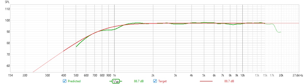

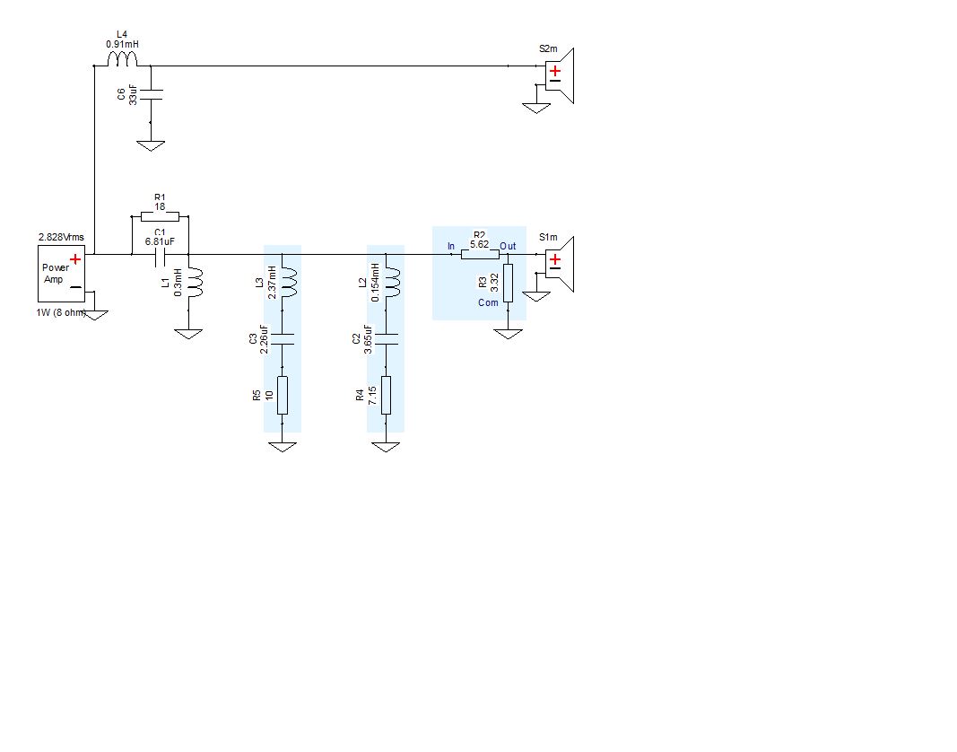

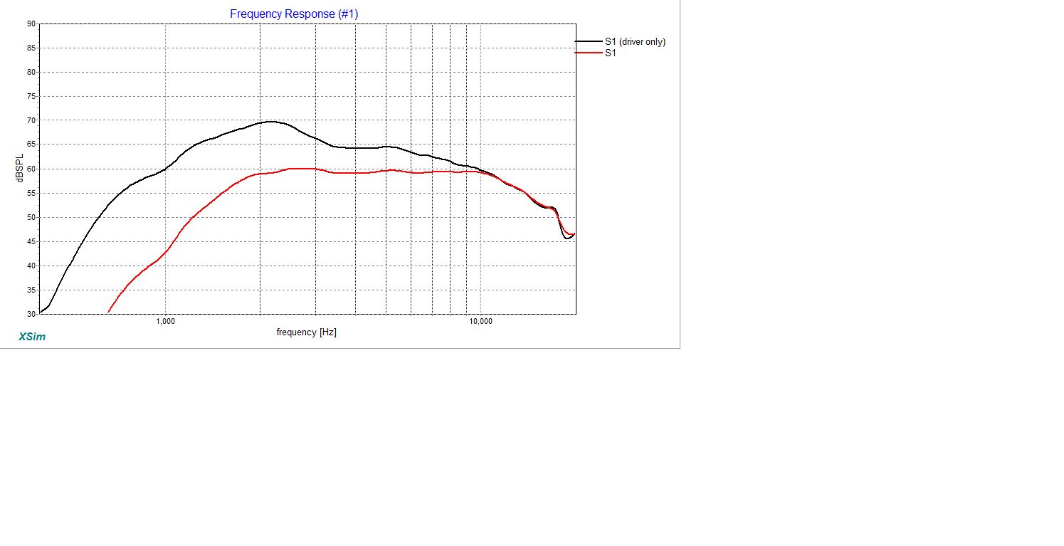

Hi BillJust for fun I tried my hand at a passive filter in XSim. I didn't try to correct all of the HF rolloff, but otherwise it looks pretty flat to me. My hearing is dead above 10k anyway!
Not actually built, of course, just a first swipe at it, and no attempt at using real-world components. Ignore the second driver in the xover.
View attachment 1437993View attachment 1437992
Bill
Would you mind sharing this xsim project?
