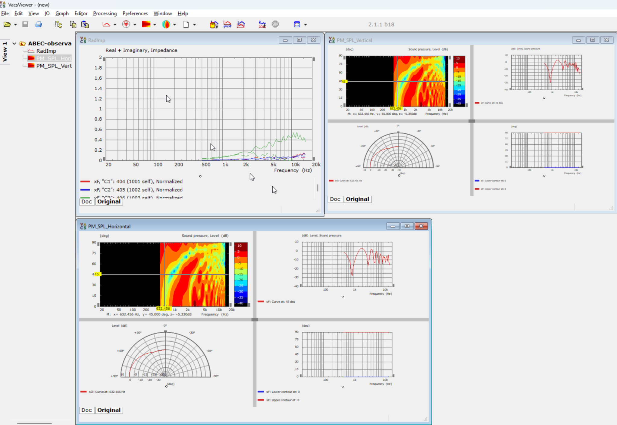

For years, I've been struggling to get consistent results from ABEC. Basically, sometimes I run a sim and the curves look spectacular, and other times they look like complete nonsense.
I've upgraded my hardware and bought piles of RAM and that's helped me produce sims that extend to 16khz and higher, but I still have issues where I'll run a sim for seven hours and the results are nonsensical.
My 'hunch' is that one of these reasons may be related to ABEC subdomains, but I'm struggling to understand what they do and why they're there.

I believe I've found a "fix" for my issues; I'm just not sure why this fix works:
Basically, to get good results, I've been adding an "offset" entry under the stanza "ABEC.POLARS" and the offset is equal to the distance from the throat to the mouth, plus one millimeter. IE, if the waveguide is 99mm deep, I set "offset" to 100mm in the stanza "ABEC.POLARS"
This solution also requires me to do my sims as infinite baffle; I'm not entire sure if the "offset" line is required for "freestanding" ABEC sims and I'm not sure if the subdomains are required either.
Anyone have any insight?

Attached is an example of what I was talking about; note the insane amounts of comb filtering in the simulated response.
This happens when something has gone with the mesh or program and the solver cannot come to a correct answer. It can be from a bad mesh or I have had it happen to me when I changed my computer and there was some drama between ABEC and the version of Windows I was running. Sometimes turning NUC on and off in different combinations fixed it and the same project that produced that type of garbage then solved properly.Attached is an example of what I was talking about; note the insane amounts of comb filtering in the simulated response.
If you do a search for NUC in this thread you might find the discussion.

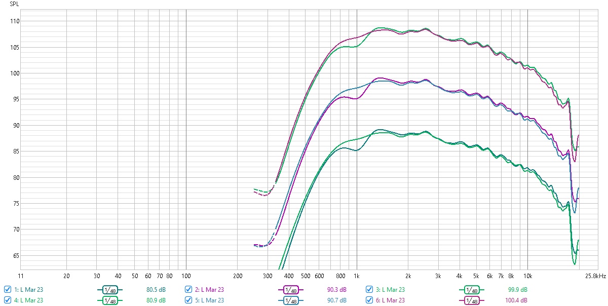

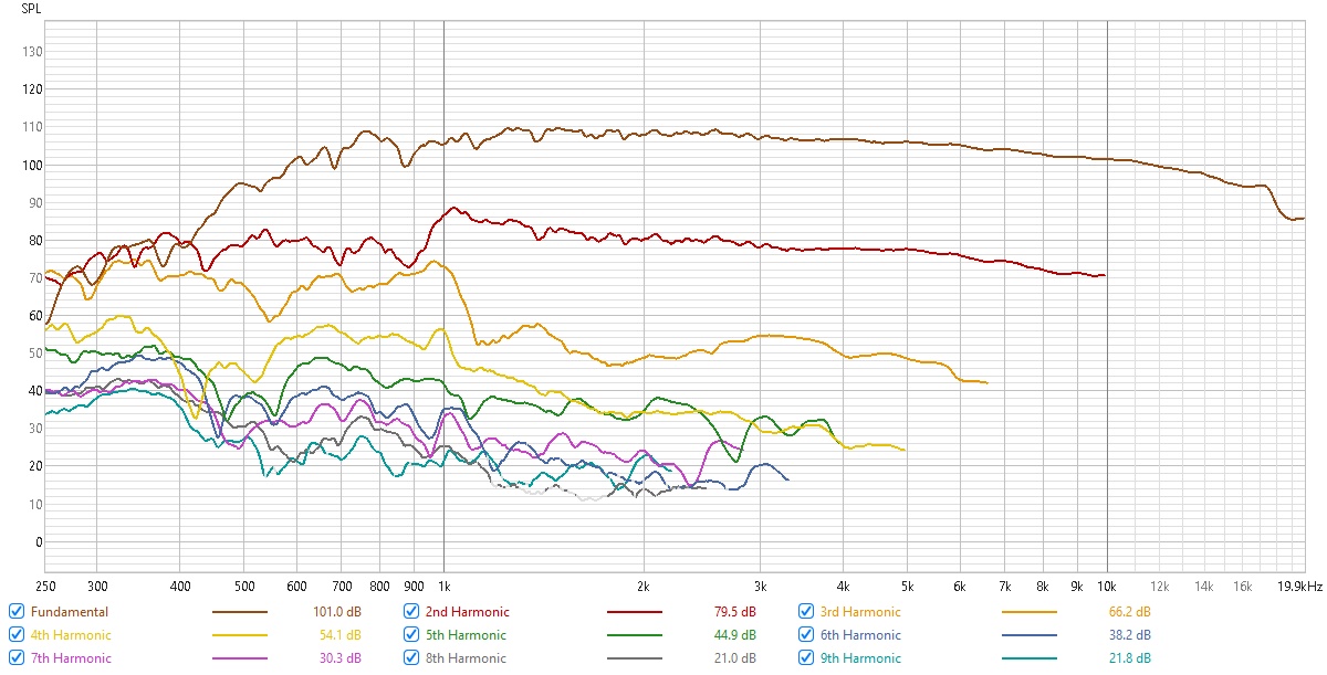

Wound up having some time tonight so here we go. My two drivers are now mounted on the Autotech Iwata horns, so I ran sweeps on them as they were. The Iwata gives a nice, smooth frequency response that goes lower than the baby ATH horn, so I thought it was suitable for this purpose.
I use an old Dayton EMM-6 mic and a Motu M2 interface. The mic was placed 1 meter from the outlet flange of the driver directly on axis. No l-pad or cap was used in between the amp (Neurochrome Modulus 86) and the driver.
I ran three sweeps on each driver, at roughly 86, 96 and 106 dB, as measured by my Radio Shack SPL meter.
Here are the six frequency responses, with a 3 ms gate:
The 2dB dip at 1kHz in one driver is consistent at all levels, and also consistent with the difference I saw on the ATH horn.

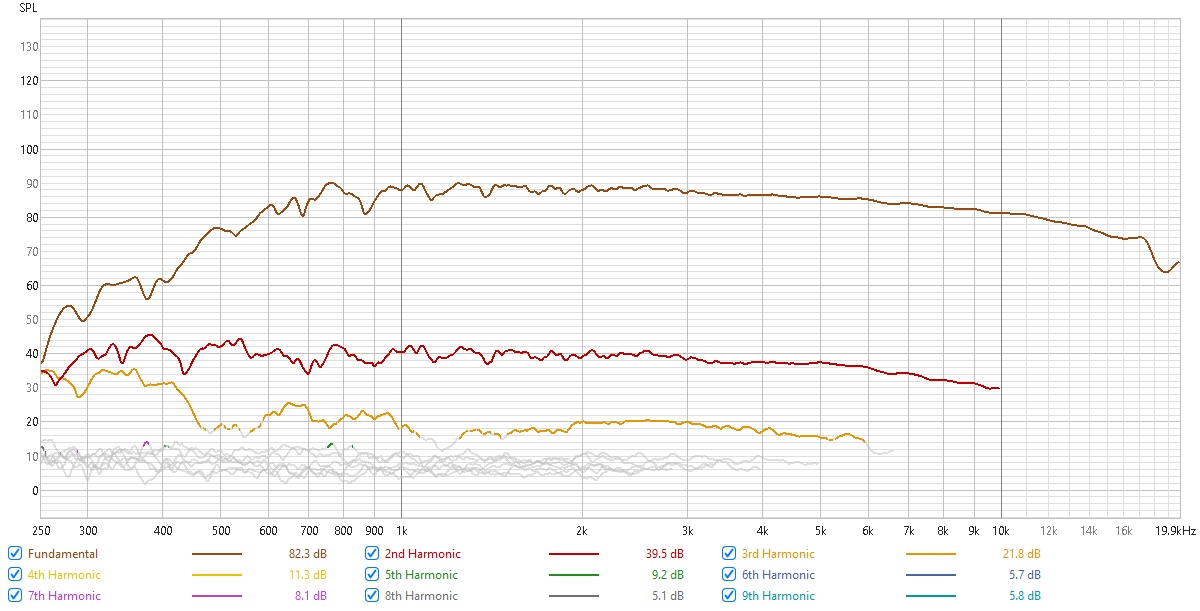

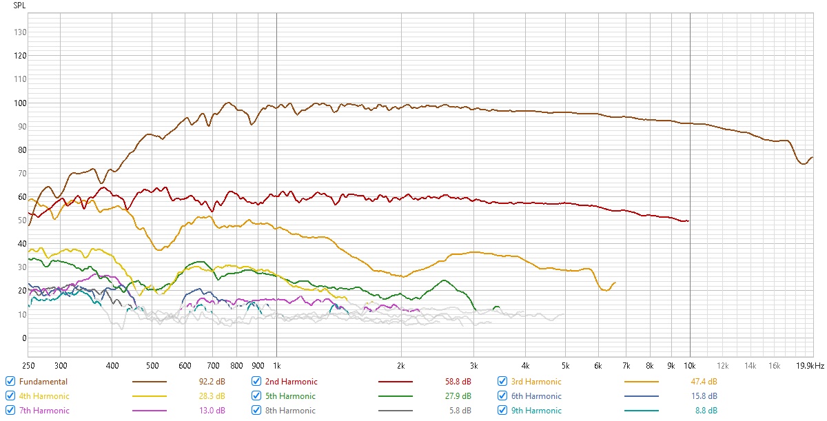

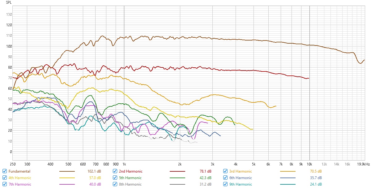

Now the distortion measurements. First the 'good' driver:
Now the suspect driver:
There is clearly something bad going on at 1 kHz. Whether that is actually VC rubbing or some kind of suspension resonance I don't know. Will Tymphany regard a 10 dB spike in distortion outside of their stated frequency range as a warrantable defect?

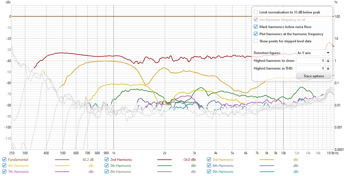

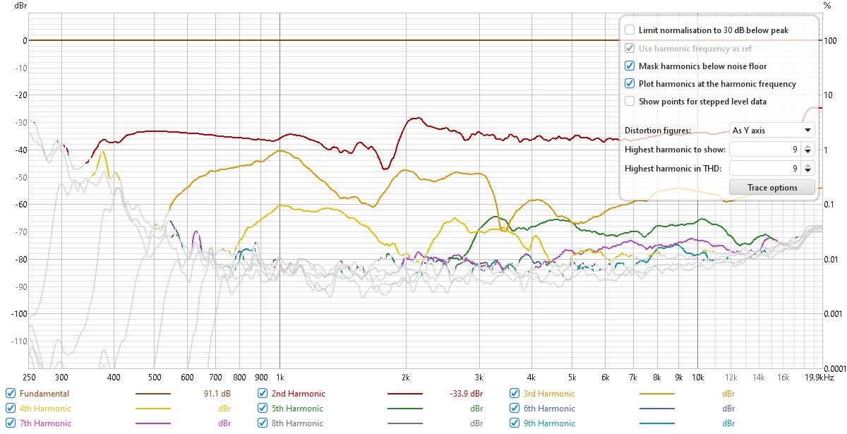

Two more graphs, this time relative distortion in dB for the two drivers at the 96 dB drive level, with the harmonics displayed at the harmonic frequency:
What does this say about the audibility of the difference?
For those that might want it, an REW .mdat file is attached with all six measurements.

Interestingly, these results aren't what I'd expect from a rubbing voice coil. Typically you'd see significantly elevated high-order harmonics (especially odd orders).Now the distortion measurements.
