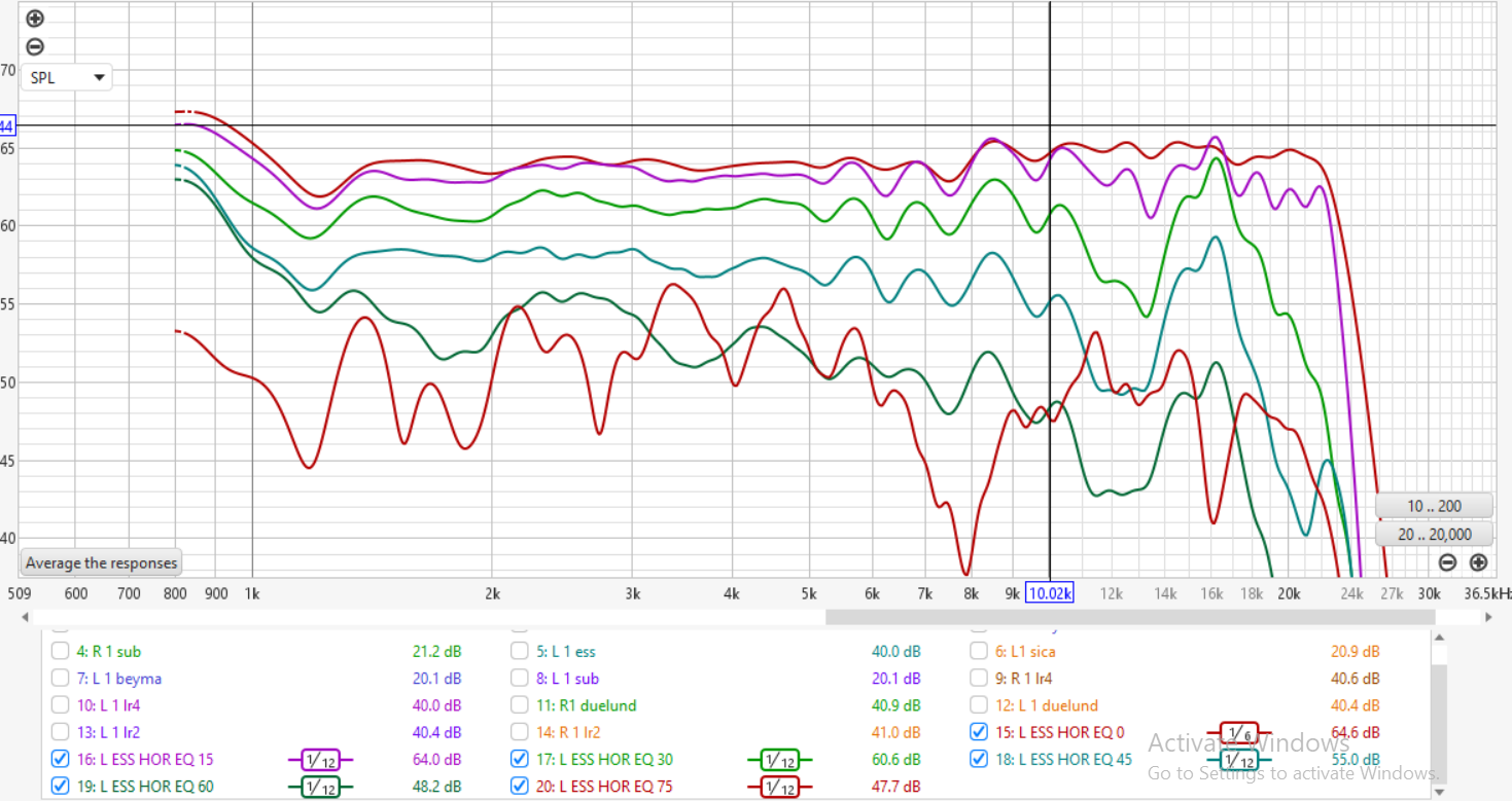

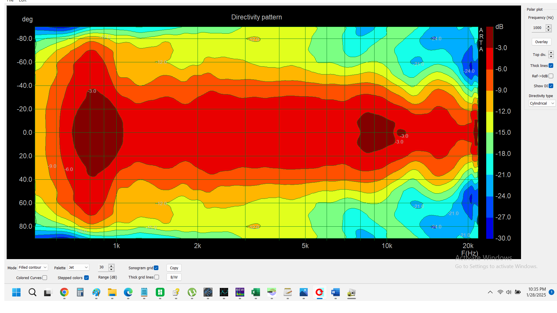

I'm curious if anyone has used the R-OSSO curvature to create a waveguide / horn for a planar driver? I have some Heil ESS AMT's that I bought on a whim, and I previously 3D printed some tractrix horns that seemed to do something good for the frequency response. Could make for an interesting experiment.

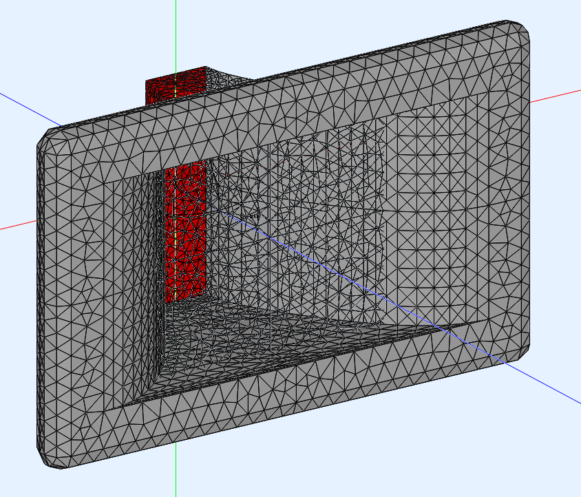

Hi! I have just started out with Ath for doing some simulations and experiments. I seem to have been able to model a horn for a rectangular source (see config below). But I wonder, how can I model the driver as a dipole source (like open baffle)? I tried to search this great thread, but couldn't find the way...
Code:
ABEC.MeshFrequency = 1000
ABEC.NumFrequencies = 40
ABEC.Polars:SPL_H_ARRAY = {
FRDExport = {
NamePrefix = "array_hor"
MapAngleRange = -90,90,19
NormAngle = 0
ABEC.Polars:SPL_V_ARRAY = {
FRDExport = {
NamePrefix = "array_ver"
Inclination = 90
NormAngle = 0
ABEC.SimType = 2
ABEC.f1 = 200
ABEC.f2 = 15000
Horn.Adapter = {
Height = 125
Segments = 0
Width = 37
Horn.Part:1 = {
H = {
a = 35
a0 = 0
k = 1
n = 4
q = 0.998
r0 = 18.5
s = 0.5
L = 1
Segments = 16
V = {
a = 0
a0 = 0
k = 1
n = 0
q = 0.998
r0 = 62.5
s = 0
ZMap = 0.5,0.3,0.5,0.9
HornGeometry = 2
Length = 111
Mesh.Enclosure = {
Spacing = 30
Depth = 24
EdgeRadius = 10
EdgeType = 1
FrontResolution = 10
BackResolution = 10
Mesh.AngularSegments = 64
Mesh.InterfaceOffset = 0
Mesh.InterfaceResolution = 6
Mesh.MouthResolution = 12
Mesh.RearResolution = 25
Mesh.SubdomainSlices = -2
Mesh.ThroatResolution = 6
Mesh.WallThickness = 10
Mesh.ZMapElementSize = 0.3,0.6,0.5,0.95
Output.ABECProject = 1
Output.STL = 1
Throat.Angle = 0
Throat.Diameter = 37

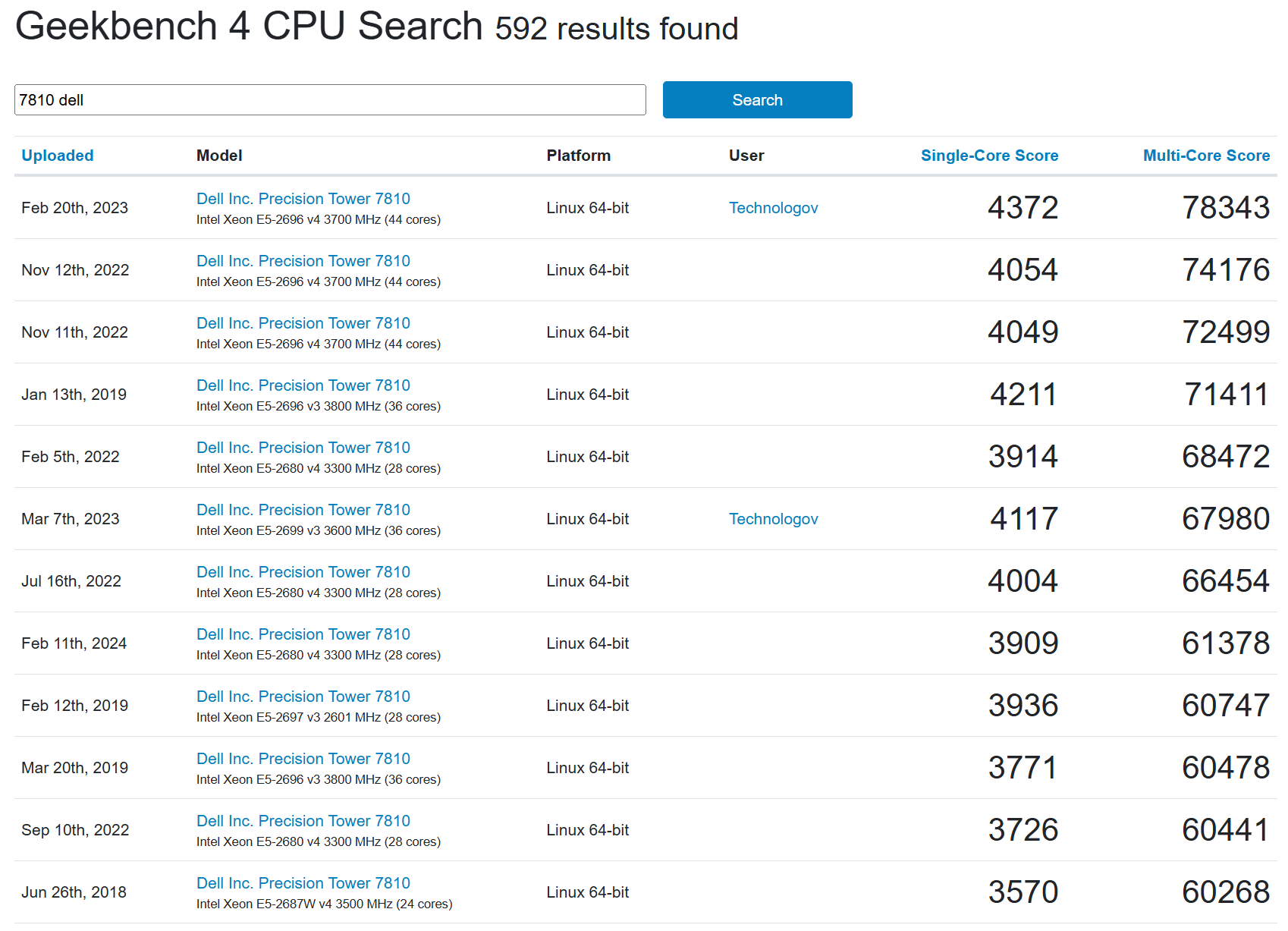

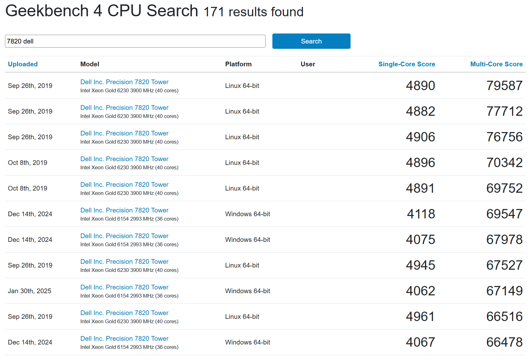

Here's a quick illustration of how hard it is to beat those dumb eleven year old Dell T5810s.
I've attached a photo comparing the performance of various builds of the Dell T5820 and the Dell T7820 online. The T5820 is the dual socket version of the T5810, and the T7820 is the dual socket version of the Dell T7810, which was the follow up to the T5810.
In the attached photos, you can see that the T7810 and T7820 are only marginally faster than the T5810 and the T5820. A lot of this is because the Xeon E5 V4s aren't "technically" supposed to work in the T5810s and T5820s, but they drop right in, as I understand it. (All of my Xeons are V3 not V4.)
The V4 Xeons are a substantial improvement over the V3. So Intel basically made a big leap between Haswell-EP (Xeon V3, 2014) and Broadwell (Xeon V4, 2015.)

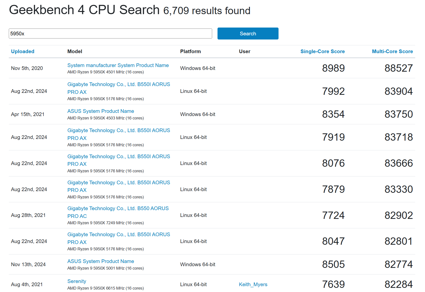

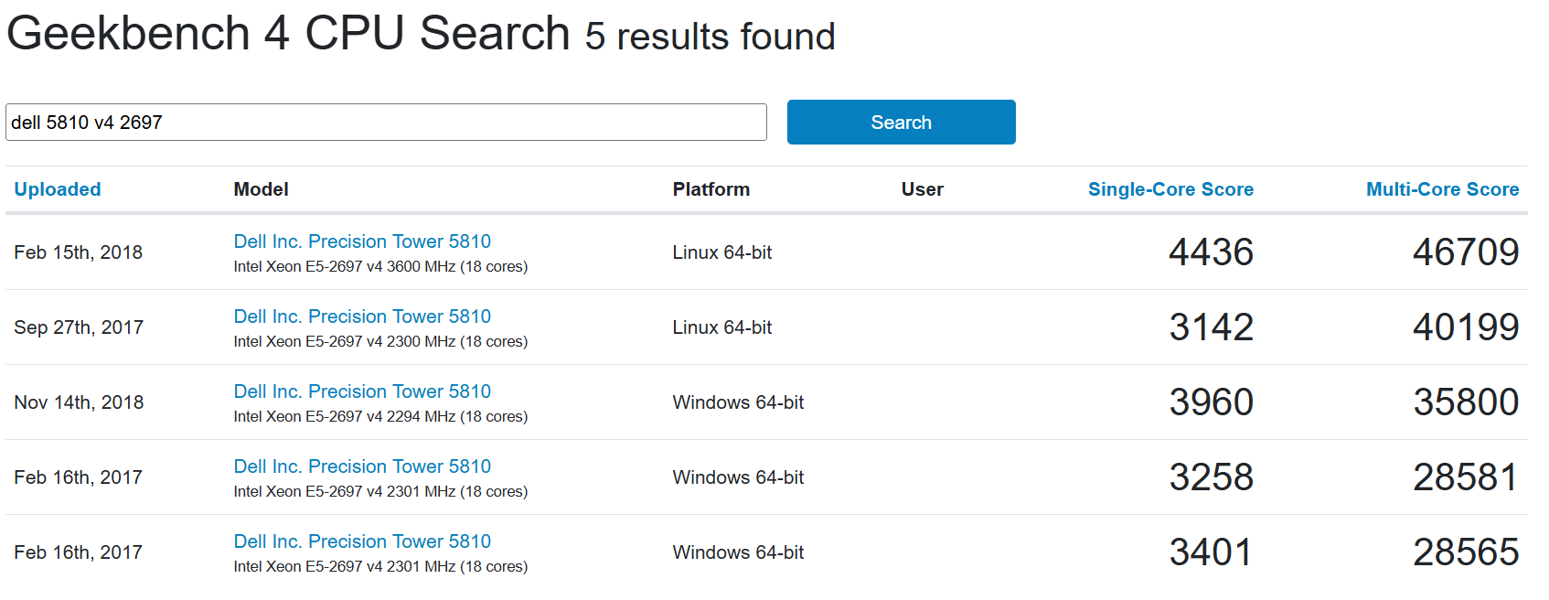

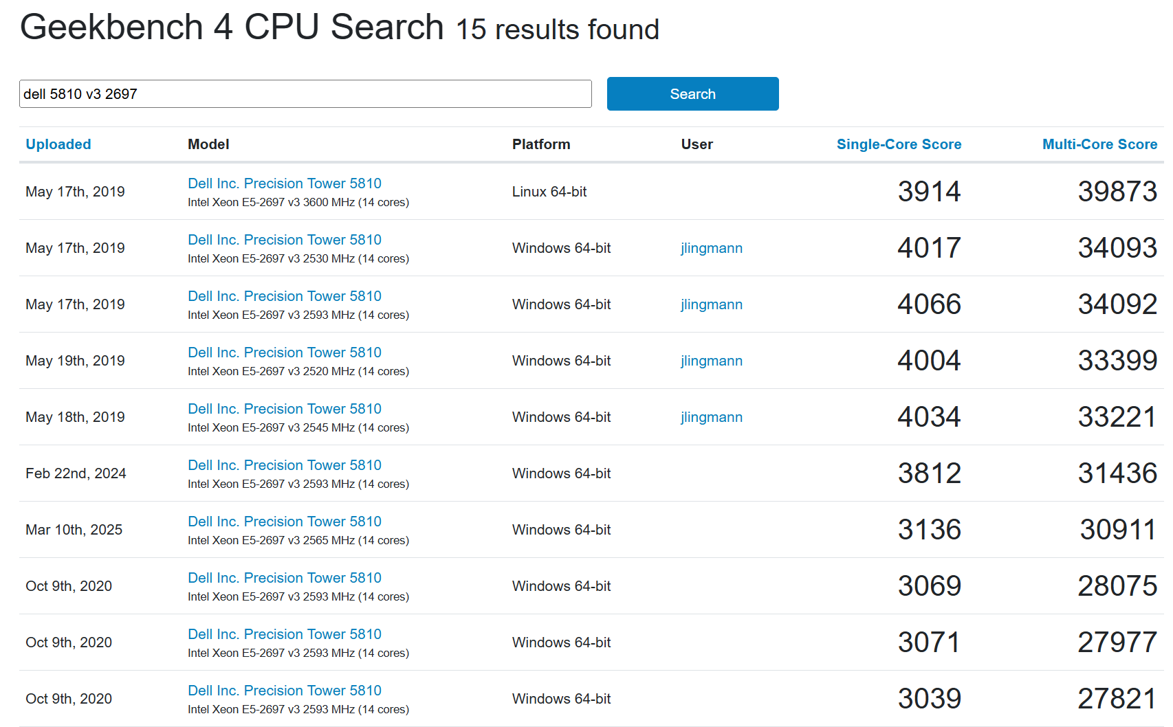

Attached are some benchmarks on the Dell T5810 E5-2697 V3 ($15) vs the Dell T5810 E5-2697 V4 ($45) vs the AMD Ryzen 9 5950x ($250)
All prices are used

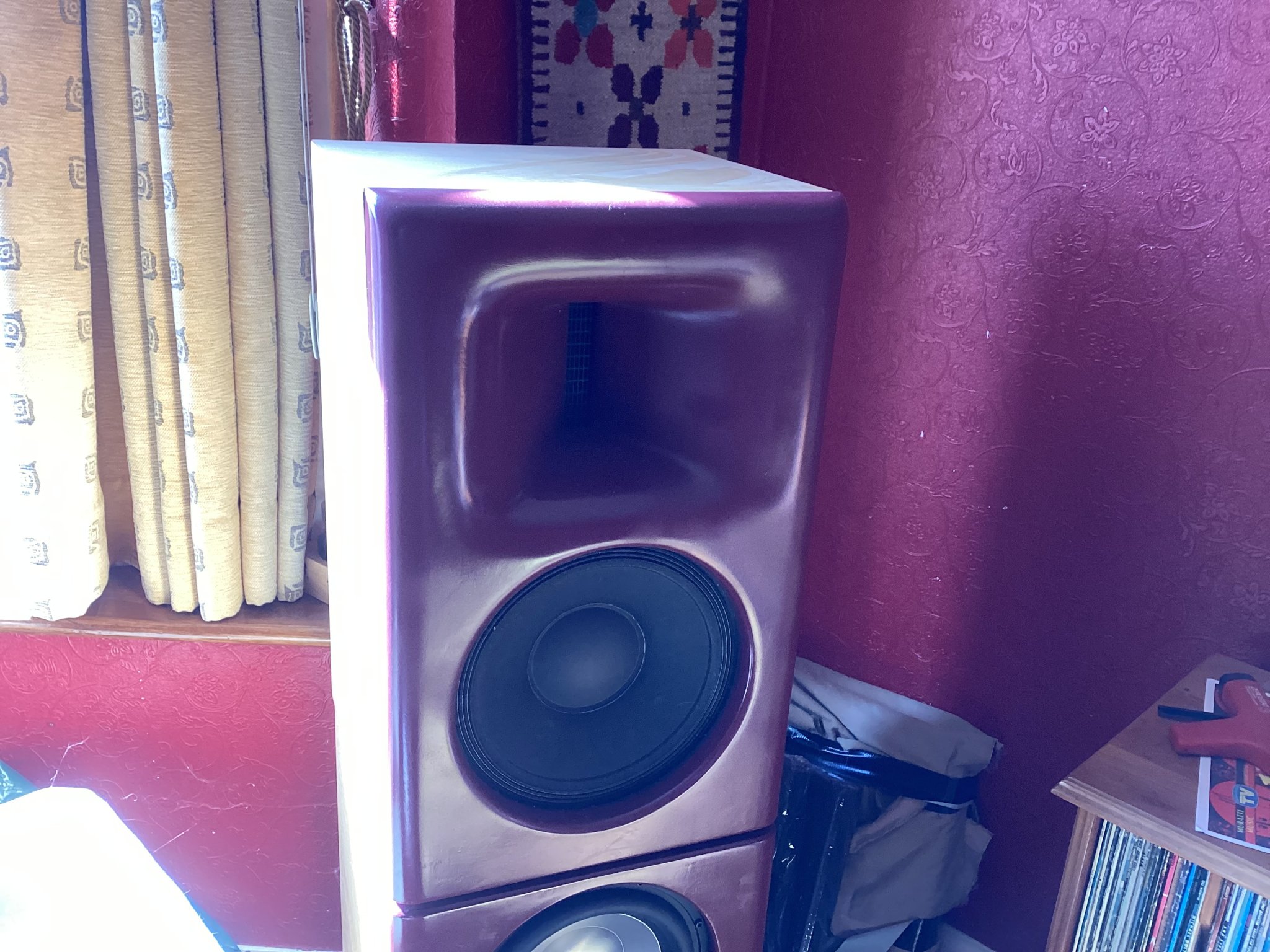

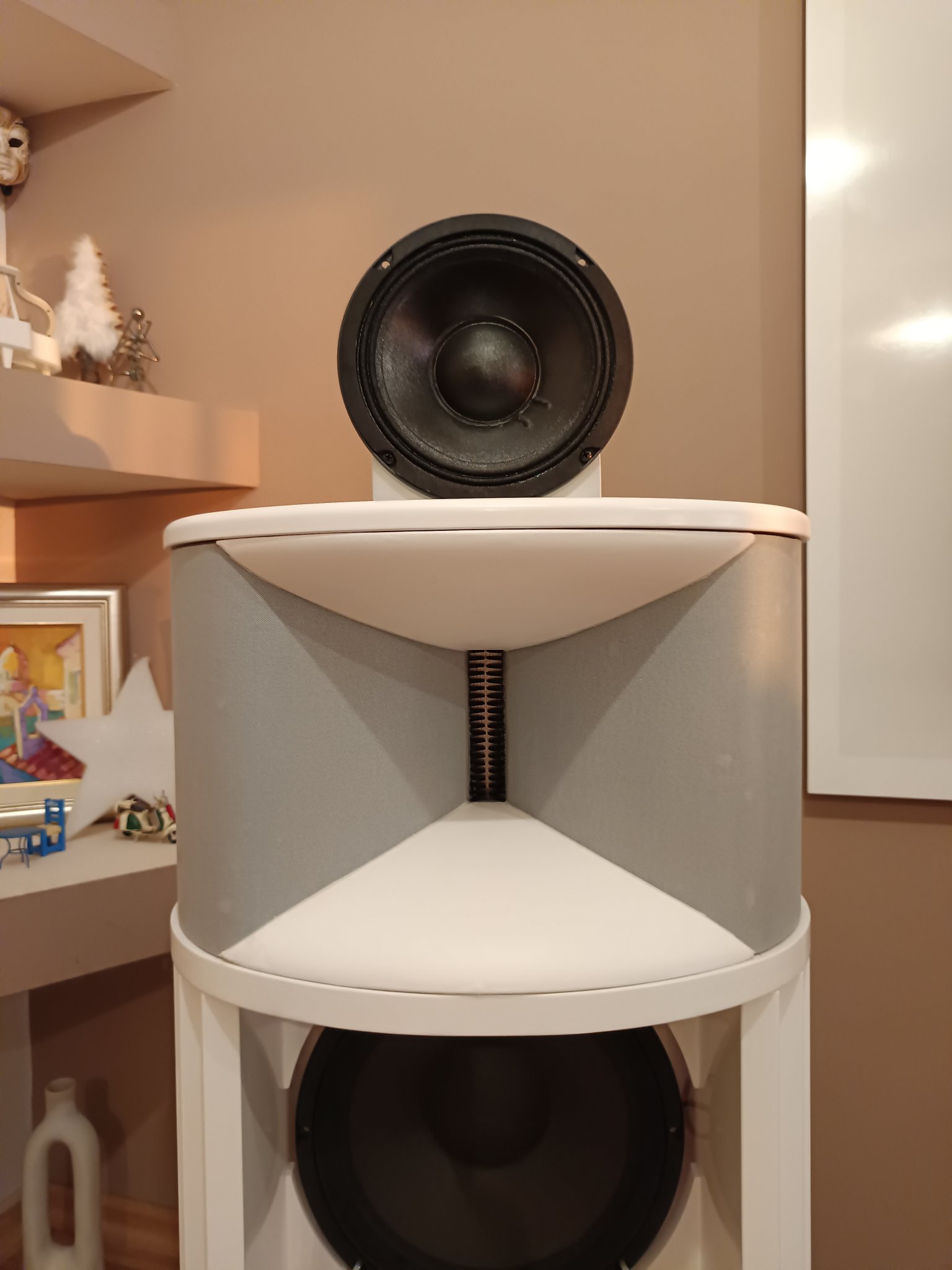

I assembled couple months ago below wg and ob speaker. Wg is designed using athI'm curious if anyone has used the R-OSSO curvature to create a waveguide / horn for a planar driver? I have some Heil ESS AMT's that I bought on a whim, and I previously 3D printed some tractrix horns that seemed to do something good for the frequency response. Could make for an interesting experiment.
Yeah, I'm not telling you to switch. The 5950X was the best option for me because I already have an AM4 motherboard.Dell T5810 E5-2697 V3 ($15) vs the Dell T5810 E5-2697 V4 ($45) vs the AMD Ryzen 9 5950x ($250)
I'd get an Epyc 7532 if I had to change motherboards, but I wouldn't settle for older hardware since I burned through 200kWh in a month with a single desktop CPU.
