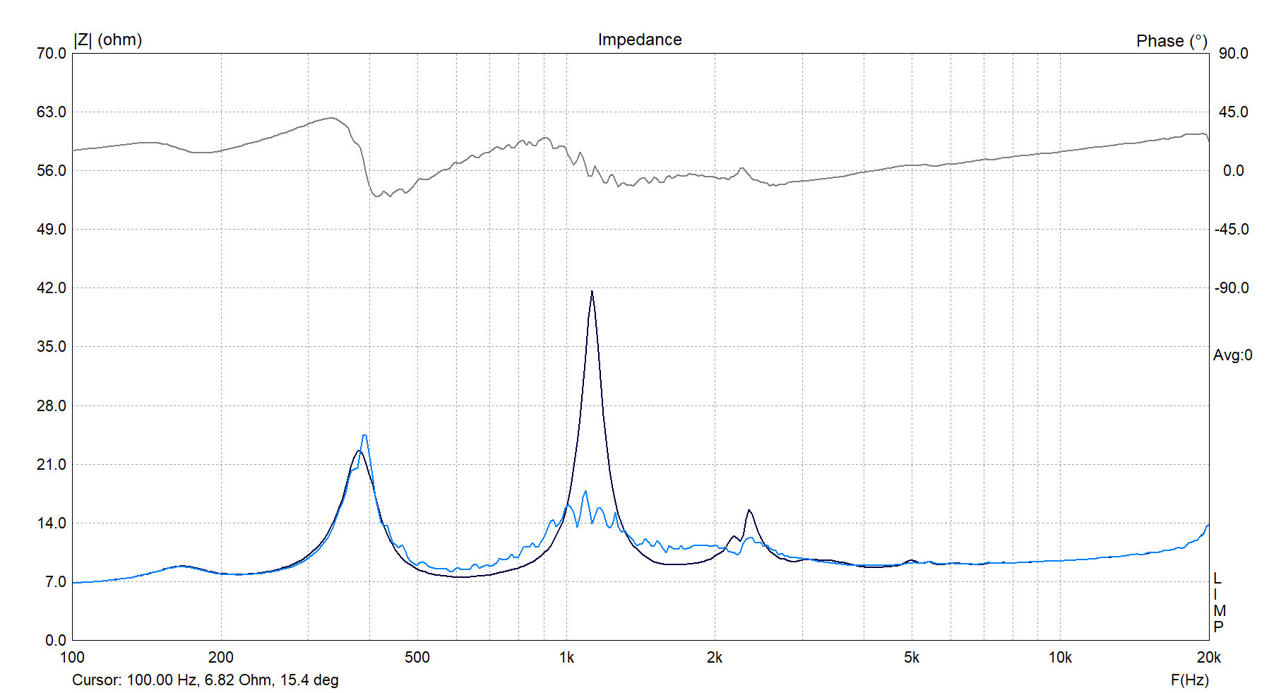

Different conditions I would say.in your first comparison, impedance peak of the old one is higher in frequency, in your second, lower than the new ones. how comes?
- Could be the way of coating, but I don't really have a clue at the moment.

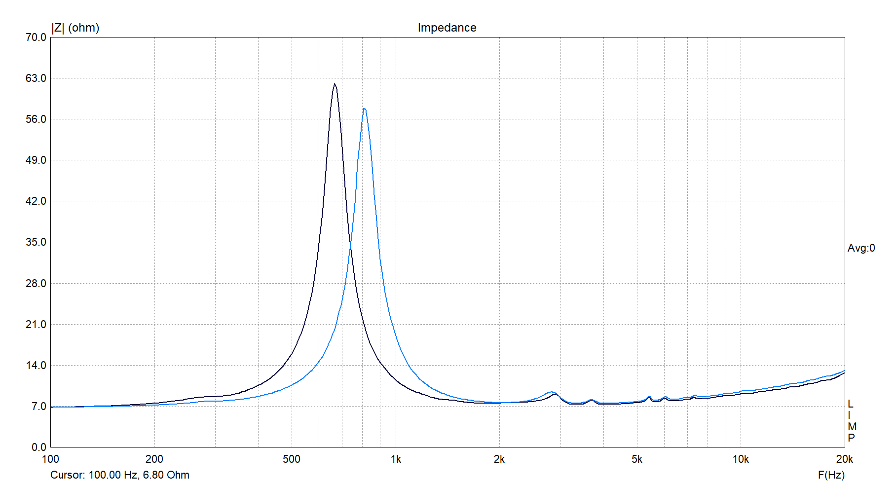

is this the old diaphragm again?
That's the same as in the previous picture, the old one and the new one (in the same driver).

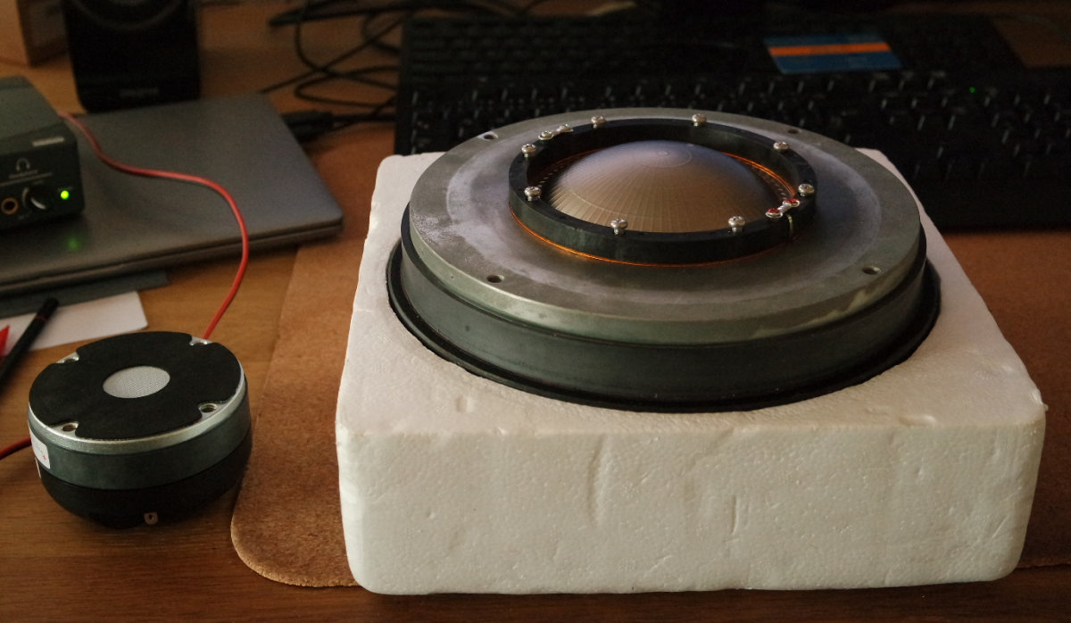

- My impression is that the diaphragms (voice coils, etc.) are not that well aligned in their assemblies. Pushing the suspension at one side improves it, while pushing at the other side worsens it further.
The whole diaphragm assembly has a pretty tight fit in the top plate, virtually without any backlash, that's good, but once you don't have the rest perfectly aligned as well, there's obviously a problem. So far it seems that putting pieces of thin shims in the right places might help.

Maybe it can be solved with dremel.
Very lightly around the perimeter of diaphragm assembly. Make it less tight fit so it can be centered properly.

I've seen something similar with a compression driver that had a very slight voice coil rub. You might try measuring distortion of the old vs new to see if the new one has elevated high order harmonics. Impedance changing significantly with drive level could be another potential clue.The black is the old one, the blue is one of the new ones
No easy mitigation that I could see now.1) This means the deviation of the newer from the older is permanently built-in into the diaphragm assembly, which is glued, and cannot be mitigated?
It doesn't necessarily mean that the fs is higher per se. This can be the result of the mechanical problems.2) fs is still higher with the new one no matter the improved impedance, do I see this correctly?
My guess is that the voice coils in these new drivers are indeed out of tolerances and are rubbing. This would need to be confirmed by someone with the capabilities to actually measure all the dimensions mechanically with high accuracy. You can't do this with just calipers.
With the old driver it's virtually impossible to make the coil rub by manipulating it, taking it in and out. It's quite foolproof, the in-built mechanical centering works very well. The new diaphragms are the exact opposite, they must simply by different (defective, I should say, but I have no other data), in some way.
Could you please do a measurement at higher spl? I checked one of my dfm with a modded Tritonia and at higher levels there was a highly distorted frequency range. Cannot remember where exactly as in this moment I assumed it was just some resonance.....the whole assembly was just placed on the table. I only wanted to investigate where could be a xo with my modded horn. However I will repeat this then....
No time to measure now but could quickly habe a look inside. I can confirm off-center glued dia on this one I tested. Visible by eye with help of the small perforations in the ketone foil. Intentional?....Cannot Imagine that.

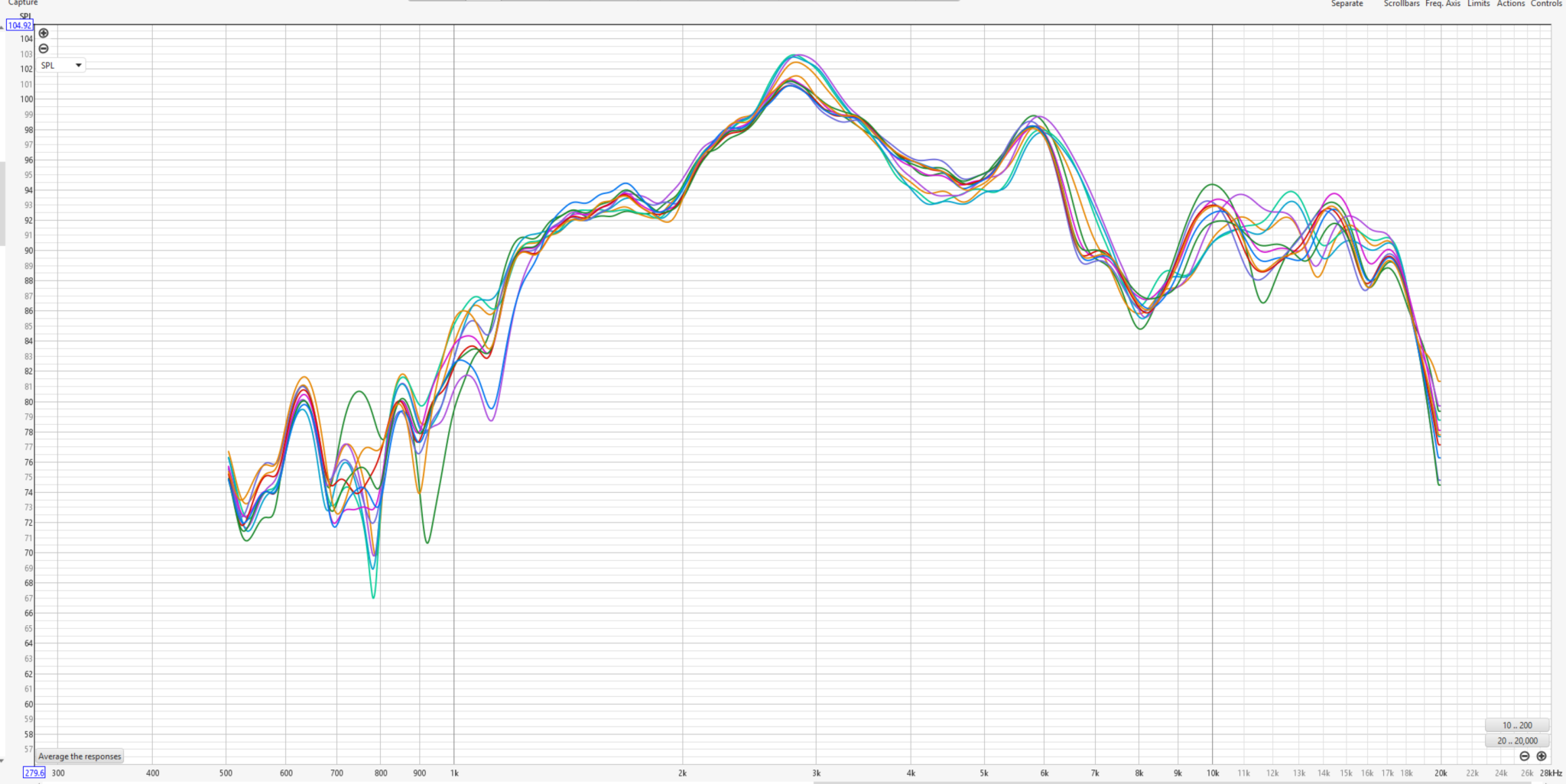

just measured my 10 drivers. Measurement taken without any horn. CD on a bit soft foam on floor. Mic ~1m vertically away. So many floor reflections.
I applied FDW 15 cycles. SPL is calibrated. Driver positions and angle vary always a few cm. The former measured resonance was not there (so that must have been driver on table or so). All in all the consistency seems to be ok. Do not worry about that HF and LF deviations....this is surely position/distance/.....

Mine sound okay /good - I've not looked inside them. You can usually hear if something big is off.All in all the consistency seems to be ok. Do not worry about that HF and LF deviations....this is surely position/distance/.....
Both mine needed the same PEQ tweaks (a good sign).

Probably the only way (except Peerless sending new diaphragms). With a bit of luck only one half of the perimeter should be needed...Maybe it can be solved with dremel.

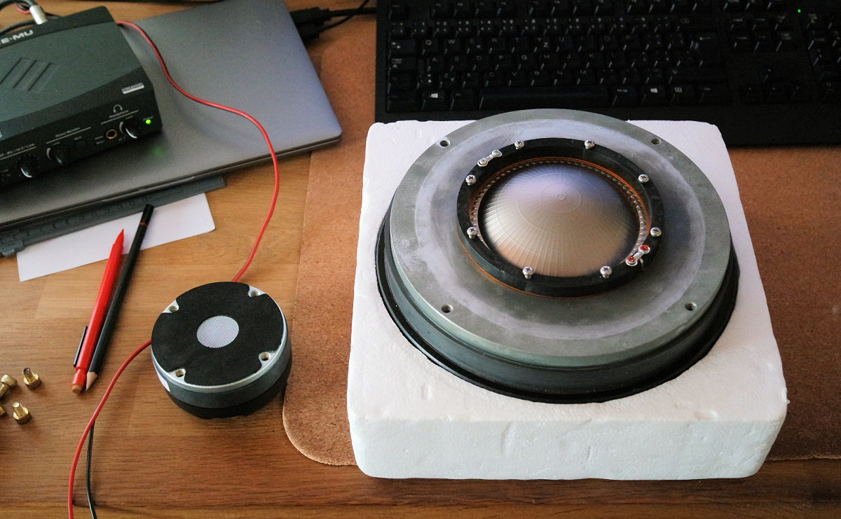

Black is the (big) driver laid on the table, exit facing up.
Blue is the same with A520G2 placed on top of it. It's obviously collecting noise from the outside via the horn...
BTW, if you can still source these old monsters somewhere, don't hesitate a minute. It's a completely different game...
See how clean it is up to 20 kHz, it's hard to believe.
