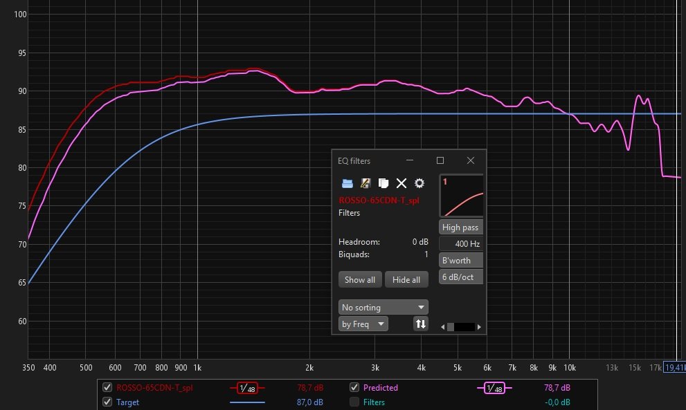

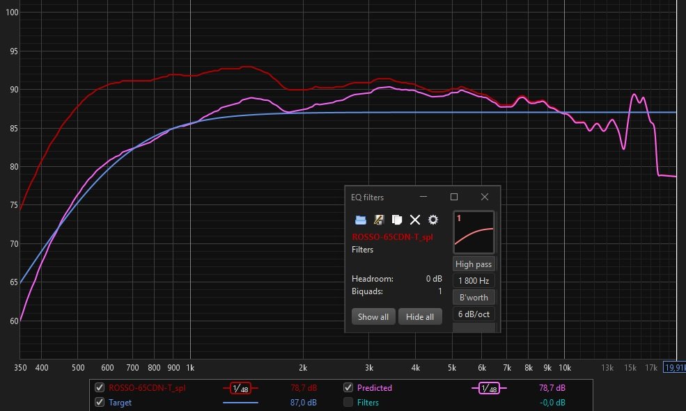

This is a quick sim with the on-axis found in @mabat website
https://at-horns.eu/gen2m.html#rosso65cdnt
In Room Eq Wizard, the target is 87dB and LR24 at 650Hz then a 6dB high pass at 1800Hz.
Then at 400Hz.
However for the first, you must already know your xo point and slope...
Then at 400Hz.

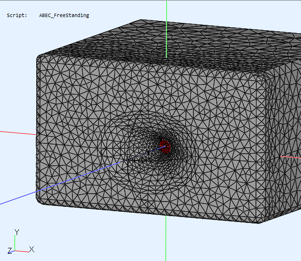

I ran into similar issues last year when i was optimizing my M2 type waveguide (yeah still haven´t given up on those) for a N151M, running very similar hardware to yours. The fastest way was to only ever play with mesh granularity and frequency range. Running tons of simulation from 500 to 14k with mesh size optimized for these results and then concentrating the effort on 14k up with way finer mesh and doing one fullrange simulation in the end to verify.

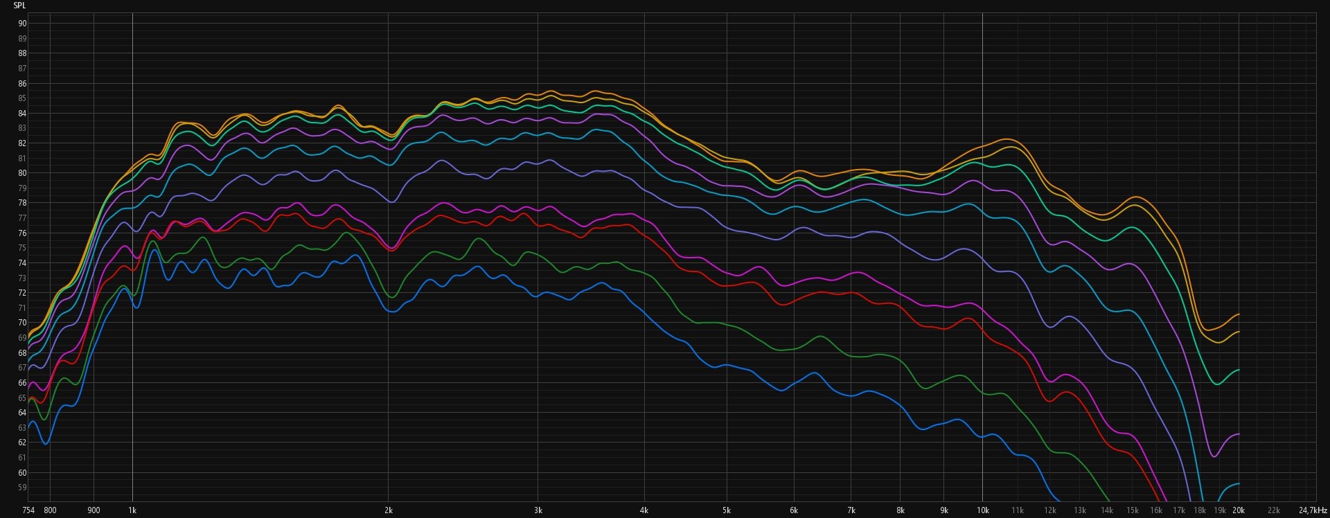

I am not sure i have drawn the right conclusion from my efforts, but yesterday i finally came around doing a quick and dirty measurement of my waveguide and cabinet. No EQ, 12th smoothing, 500mm distance, 0 - 90°.

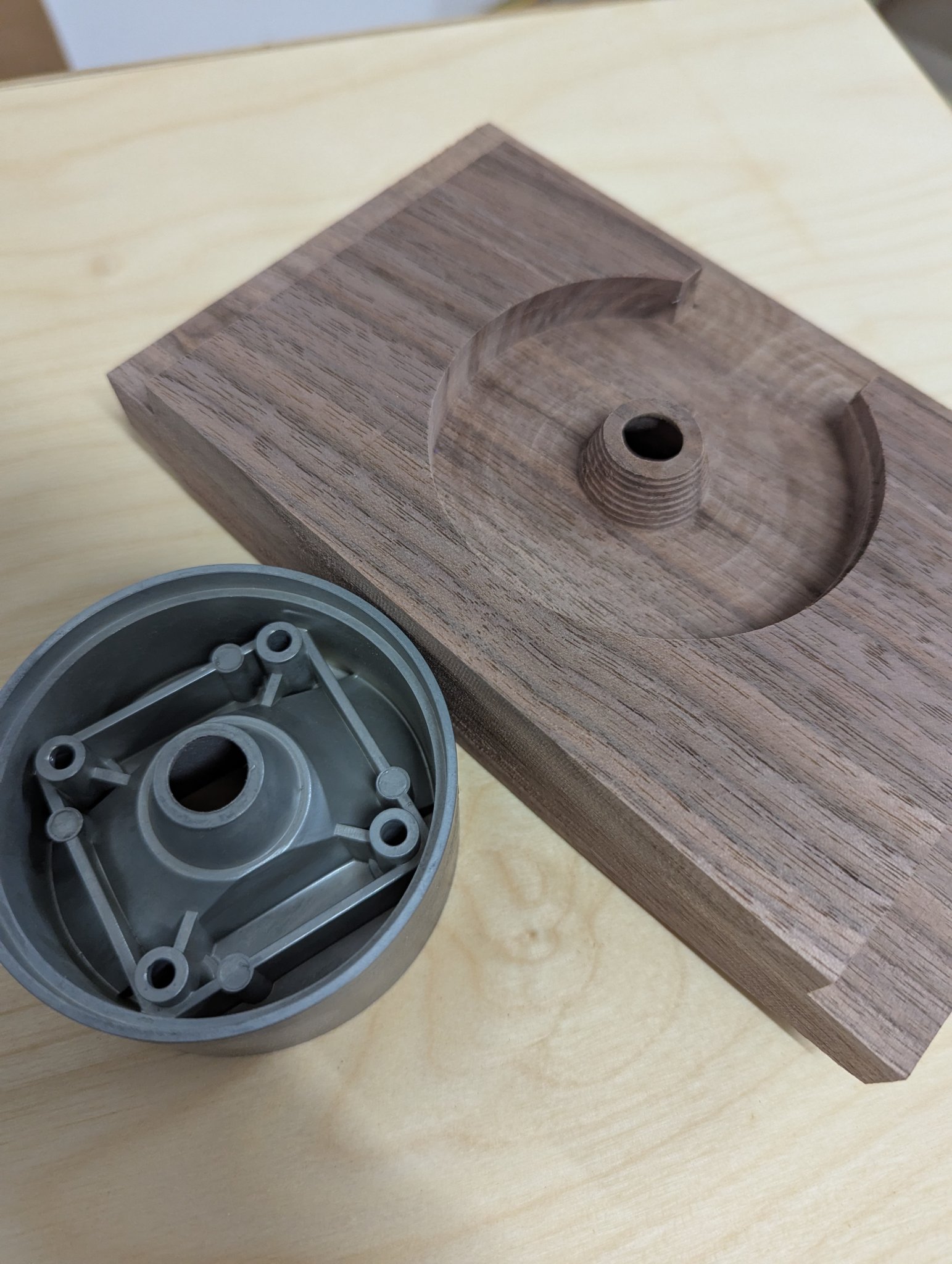

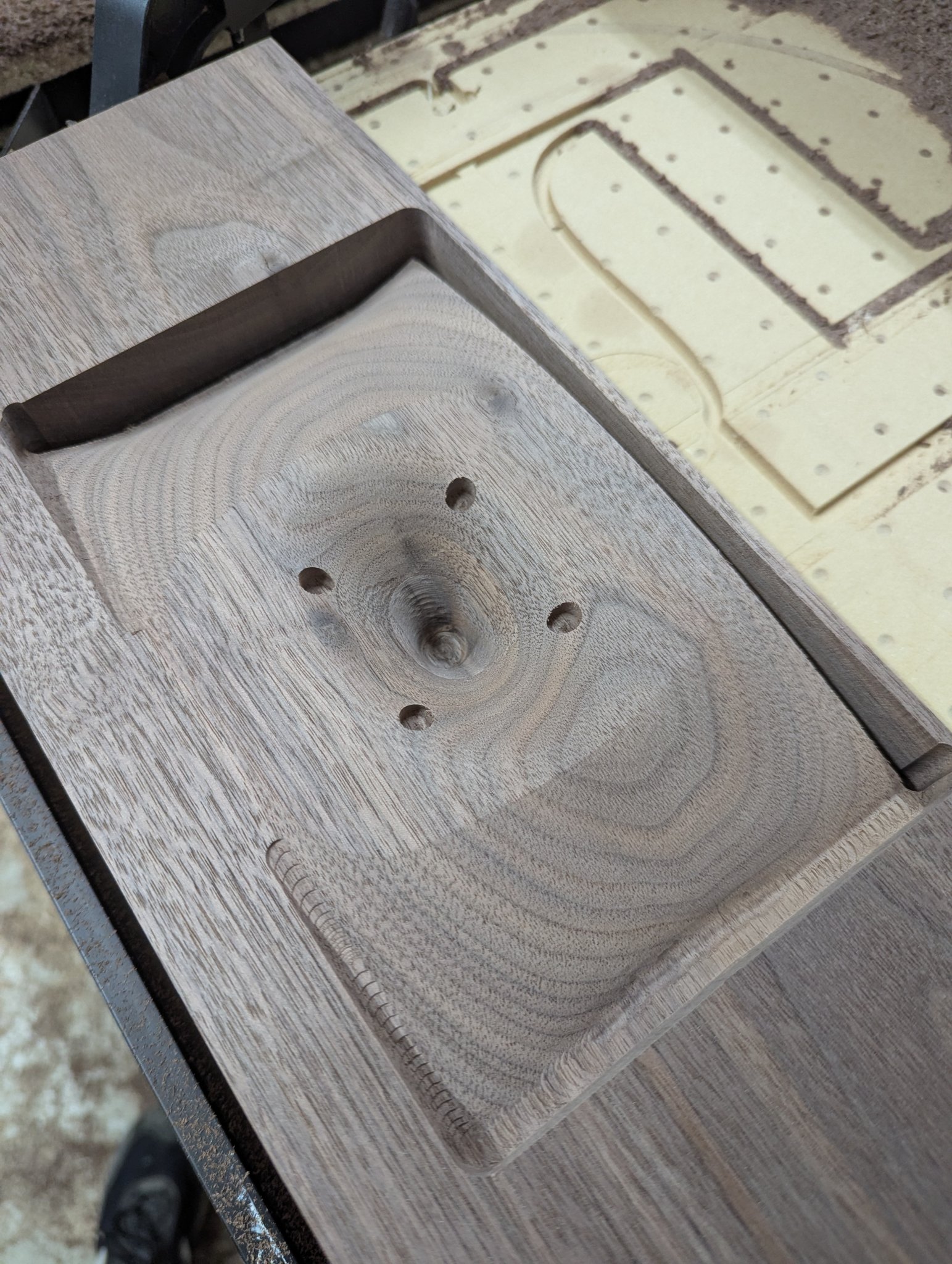

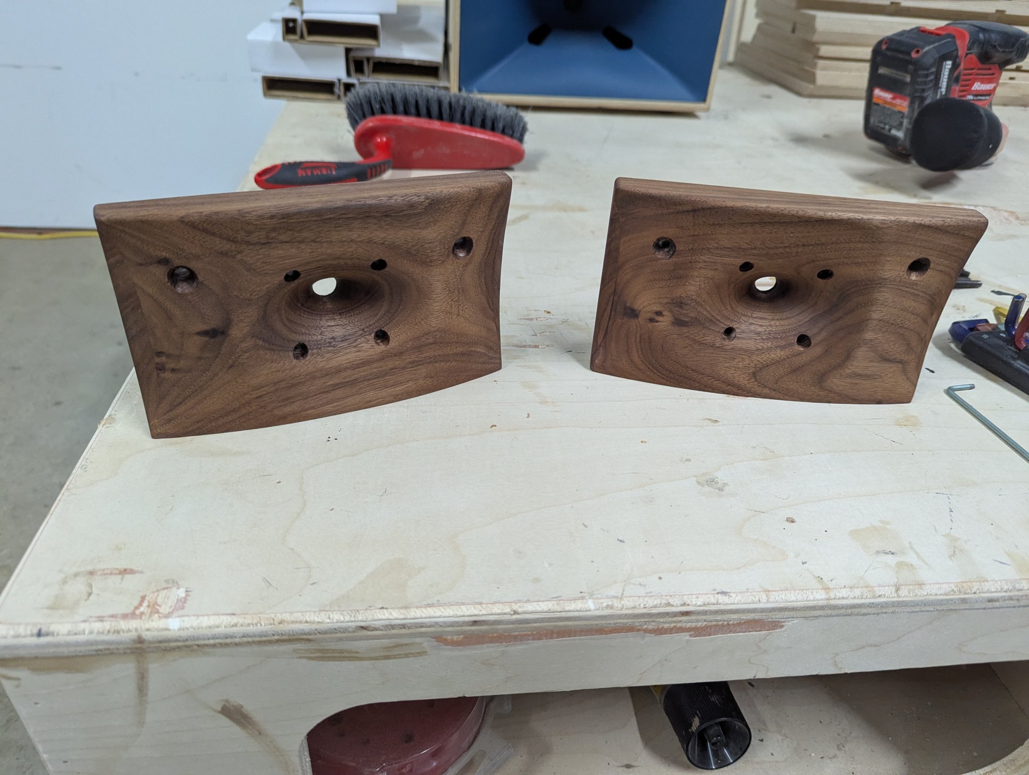

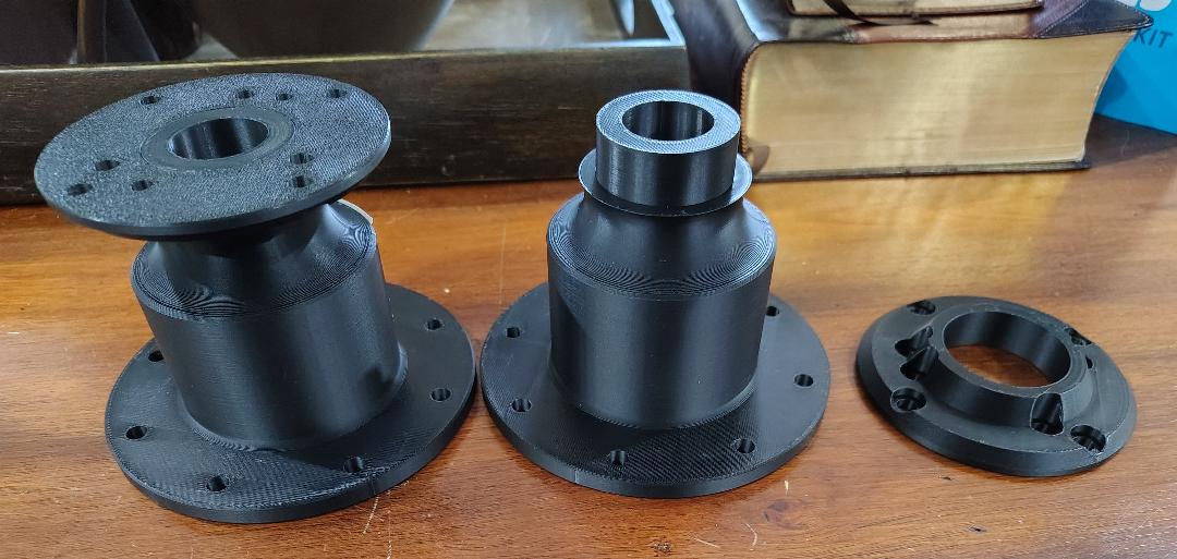

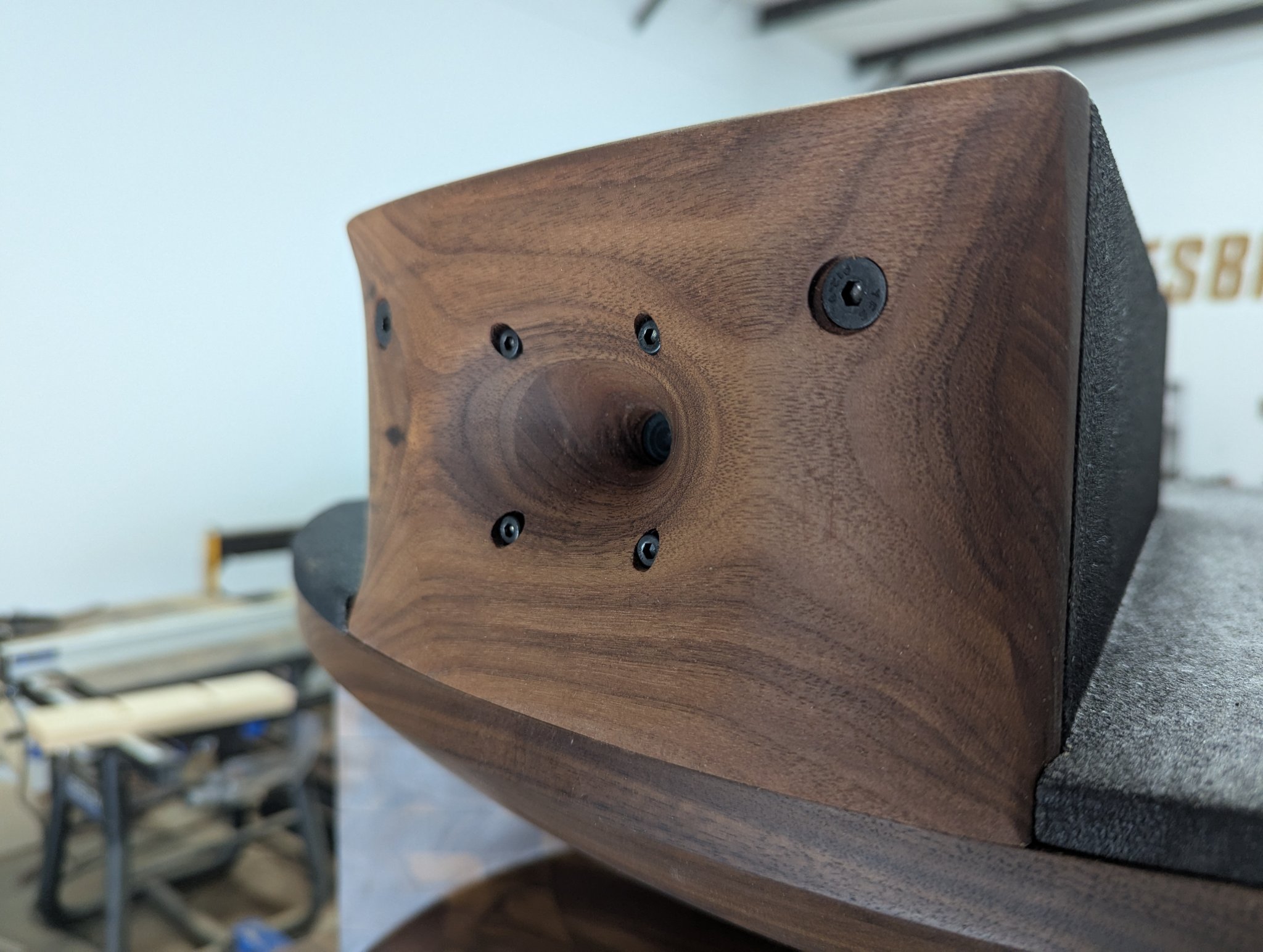

A few pics from a recent build. This is an alternative waveguide for the TAD ET703. Profile was designed in Ath, initial prototype for testing was 3D printed, and final version with the smooth baffle transition was modeled in fusion/validated in Akabak before being machined from walnut.
Thanks! The finish is Osmo 3054.
Midrange entries would be an interesting challenge at a 5khz crossover!
Really nice! 🤩 Do you have any measurements?A few pics from a recent build. This is an alternative waveguide for the TAD ET703. Profile was designed in Ath, initial prototype for testing was 3D printed, and final version with the smooth baffle transition was modeled in fusion/validated in Akabak before being machined from walnut.
