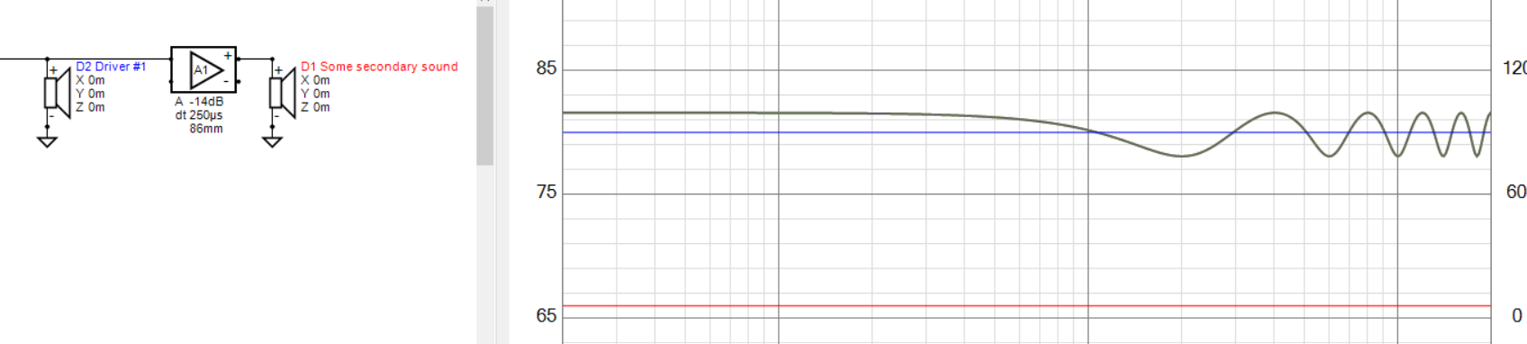

Here is how to solve your mystery:
~4kHz period on the individual horn measurement interference indicates there is secondary sound. 4kHz wavelength is ~8.6cm long, delaying a secondary sound 8.6cm would make opposite phase at 2kHz and you've got your pattern and secondary sound source solved: Something is making a reflection, which arrives to mic 8.6cm later than direct sound.
Further, assuming your graph has 2db grid so that the individual L / R measurements have ~3db peak to peak in the interference pattern it means the secondary sound is roughly 14dB down relative to direct sound. This is quite much attenuation already for such short path length, so I think it's from your measurement rig. Perhaps your mic is on the sofa, and it's reflection from the sofa attenuating the sound some, or something like this. It cannot be diffraction inside the horn for example, because it would yield different interference pattern. If one wants to analyze further, the interference amplitude reduces toward top end, which indicates horn directivity affects it, so it's reflection of something between DUT and mic.
This stuff is easy to resolve using vituixcad with ideal drivers, just adjust delays and attenuation until you have similar interference pattern.

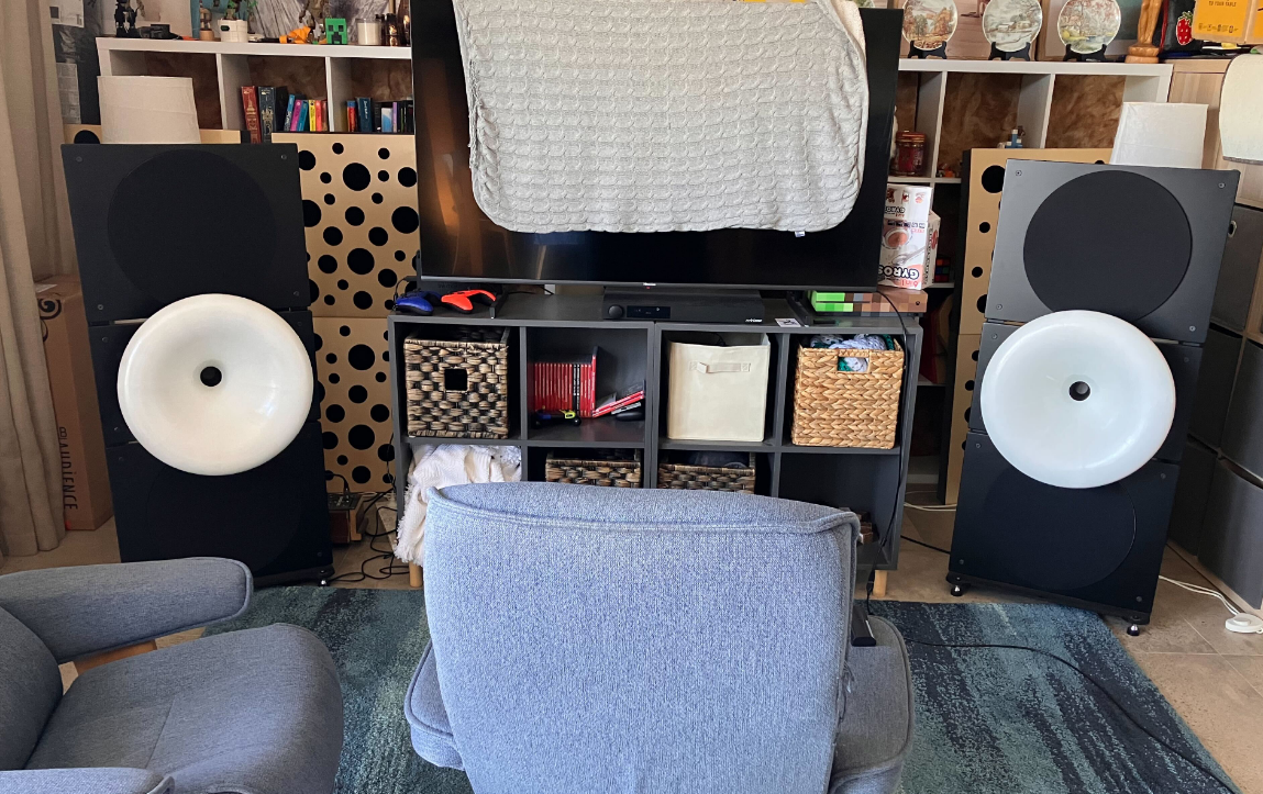

I have them crossed over at 800hz now - They sound amazing - which just seems to conflict with what the REW measurements are showing me.
I don't feel like my ears are uneducated either - I went to the store near me and had a listen to the Kii three speakers to make sure i was not going mad and these sound better to me.
Yeah my mic is resting on the sofa for all measurements... the horn itself is 13cm in front of the baffles....
I did a proper time alignment with REW last night. On all drivers and subwoofer too (previous time alignment was done with measuring tape) The imagining is uncanny now. Maybe the 2nd best i've heard in my life. The best being a system that used the full range raven ribbons from 300-40khz
I did a little bit more tuning and tweaking just with my ears - it sounds fantastic. I think im just going to leave it for now - very happy

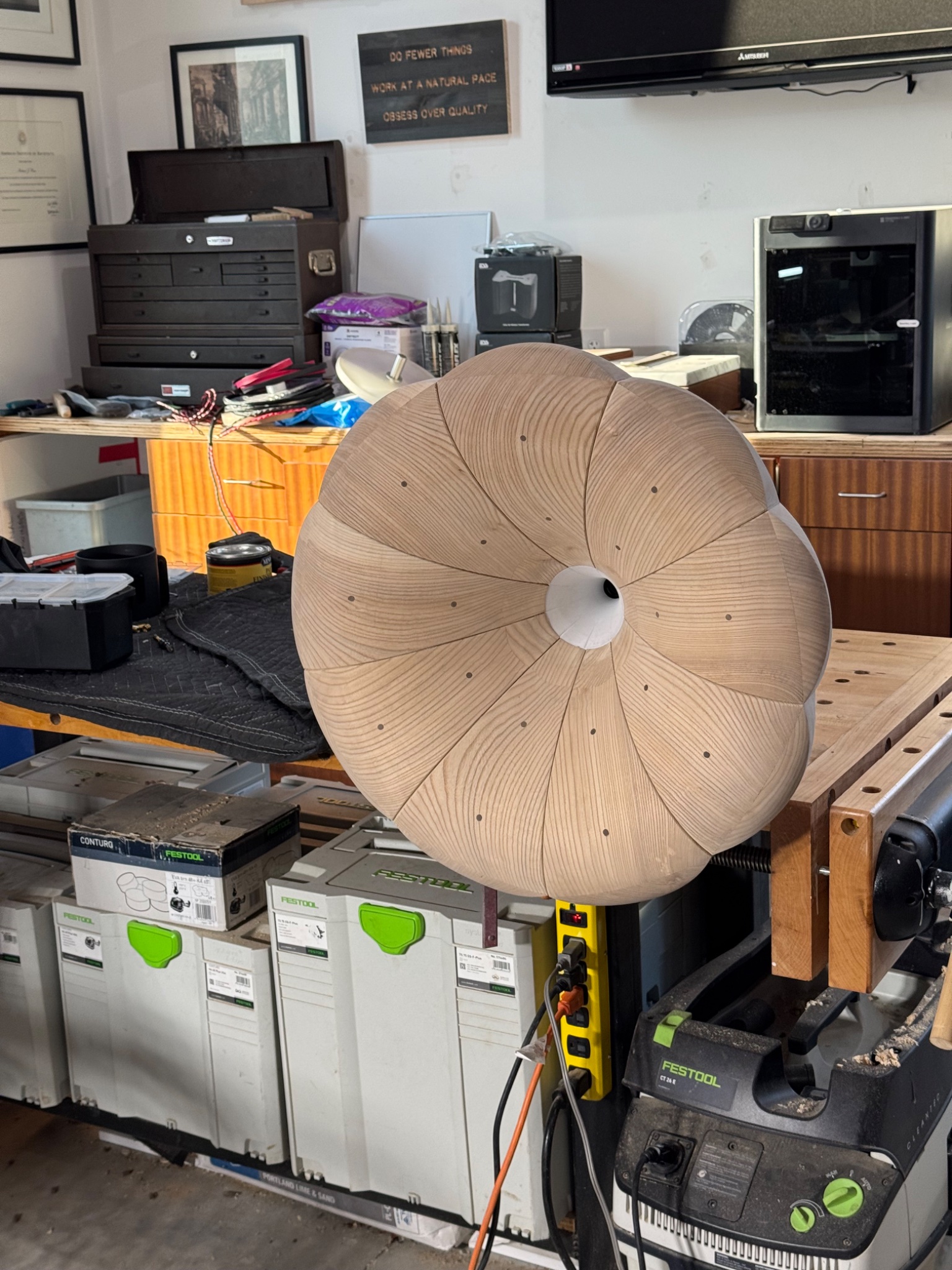

This is the final result i got: I did not spend as much time as i should have with the glue / sanding process but this is just a first draft 😀

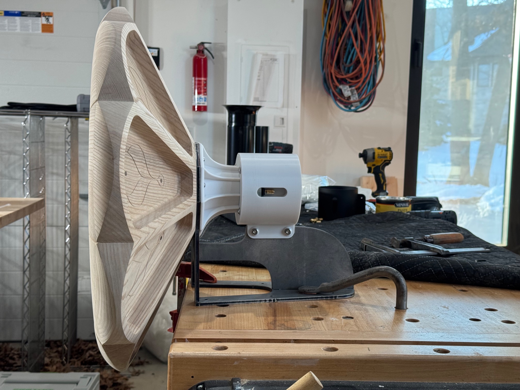

I’ve been sanding for what feels like an eternity but am almost ready to put a finish on the horns. I had to rethink the support because they ended up being much heavier than expected - so now the adapter slips through a steel ring which connects directly to the horn stand. I’m not too far away from firing it up!

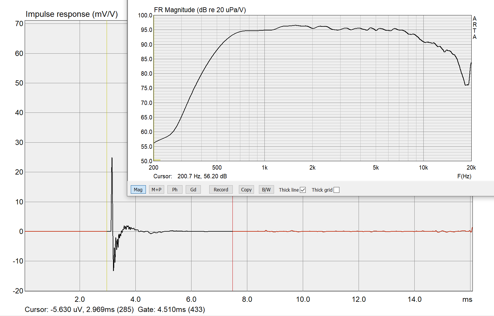

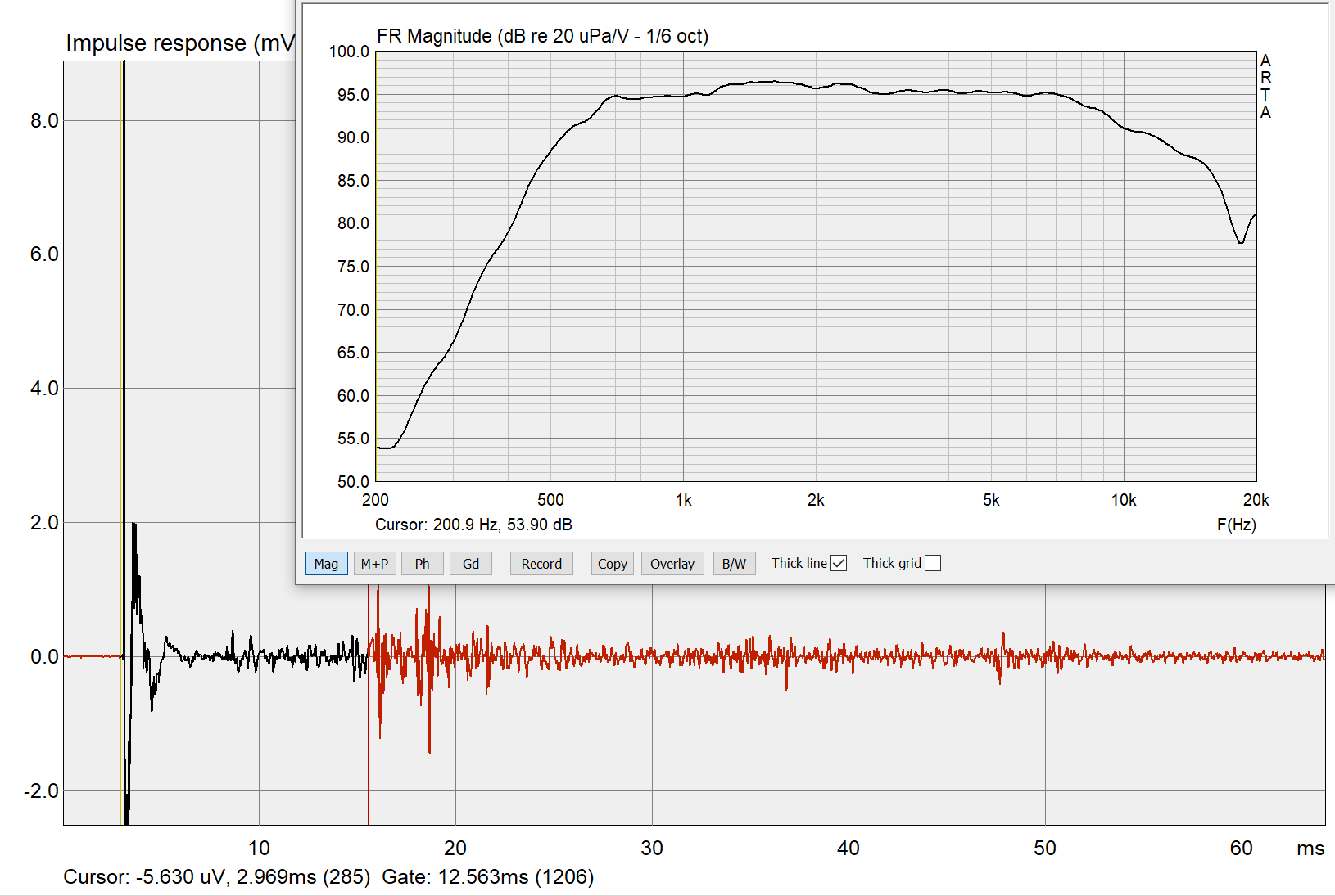

- BTW, this is a new Gen2 adapter for the Celestion CDX1-1720:
Raw unsmoothed response (4.5 ms window):
12 ms window, 1/6 oct:
Available soon
Available soon
