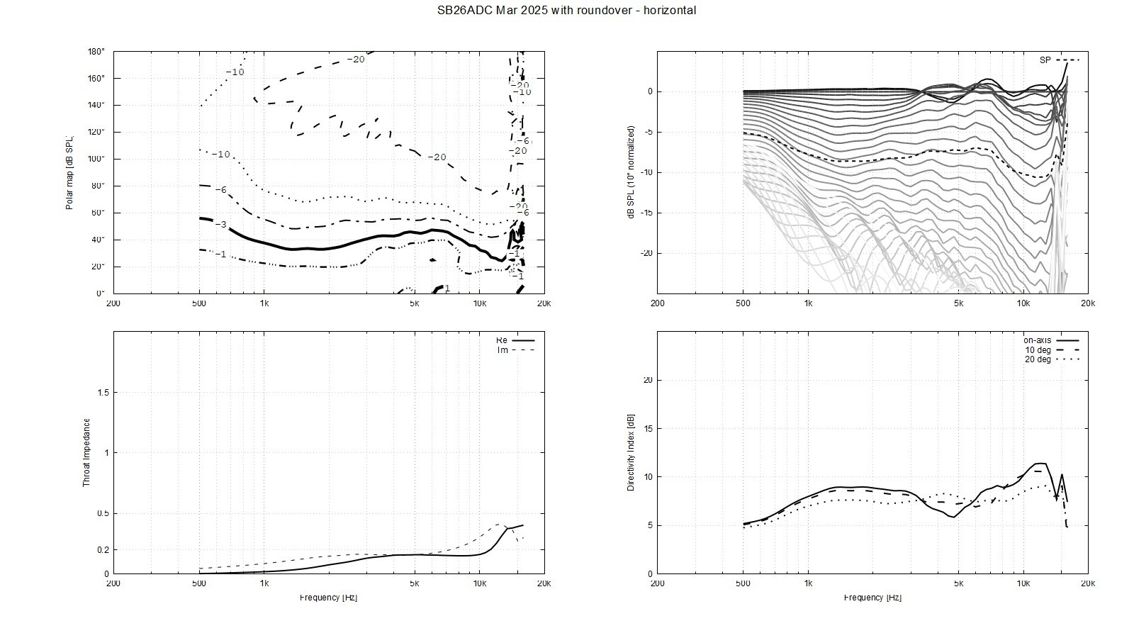

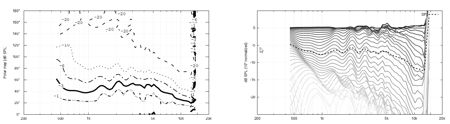

I think I may have found the culprit for a problem that's made ATH basically unusable for me.
If anyone has any suggestions, solutions, please clue me in.
Here's the issue:

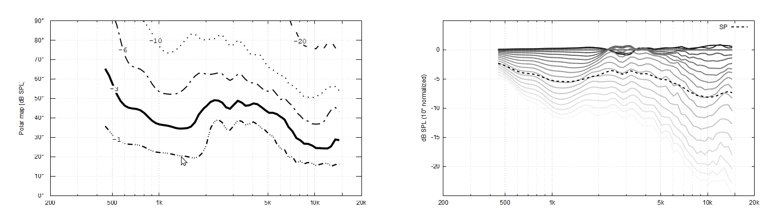

1) I have basically zero interest in waveguides unless they're in a speaker enclosure. I know that ATH can make some very nice freestanding waveguides, but I really need something that I can install in a baffle, because WAF
2) The issue I've been seeing, is that the high frequencies of my ATH sims look TERRIBLE:
(See second attachment, named "ath 1000Hz.jpg")
According to the prevailing knowledge on this forum, "ABEC.MeshFrequency" should be set to 1000Hz.

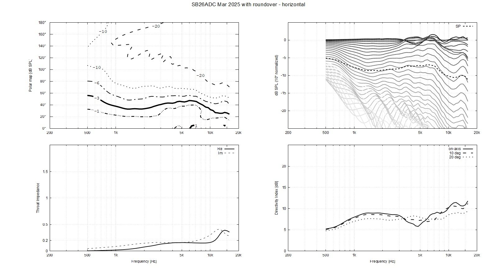

What I found, is that the simulation of the top octave improves DRAMATICALLY if I increase "ABEC.MeshFrequency" to 20,000Hz.
(See first attachment, named "ath 20000.jpg")
That would be a viable solution, except IT TOOK FOURTEEN HOURS to run the sim. That was with fourteen E5 Xeon cores and 96GB of RAM.
Third attachment is the config file.

The whole idea of setting 'ABEC.MeshFrequency=1000' (i.e. a very low value) is to make ABEC to not perform any further subdivisions. But then the mesh resolution must be high enough to begin with. So, if the mesh turns out not to be good enough for the frequency range of interest, increase the mesh resolution in the first place (by setting the items Mesh.*Resolution [mm]).
Setting ABEC.MeshFrequency to a high value has a similar efect in the end, but the drawback is that it doesn't further improve the accuracy of the mesh shape itself, contrary to the other way. It's just a suboptimal way of doing it. With Mesh.*Resolution you can also set different values for different places of the model - typically, you can save quite a lot of elements this way.
You can also split the calculation into several frequency bands with limited number of frequency points in each, with different mesh densities.

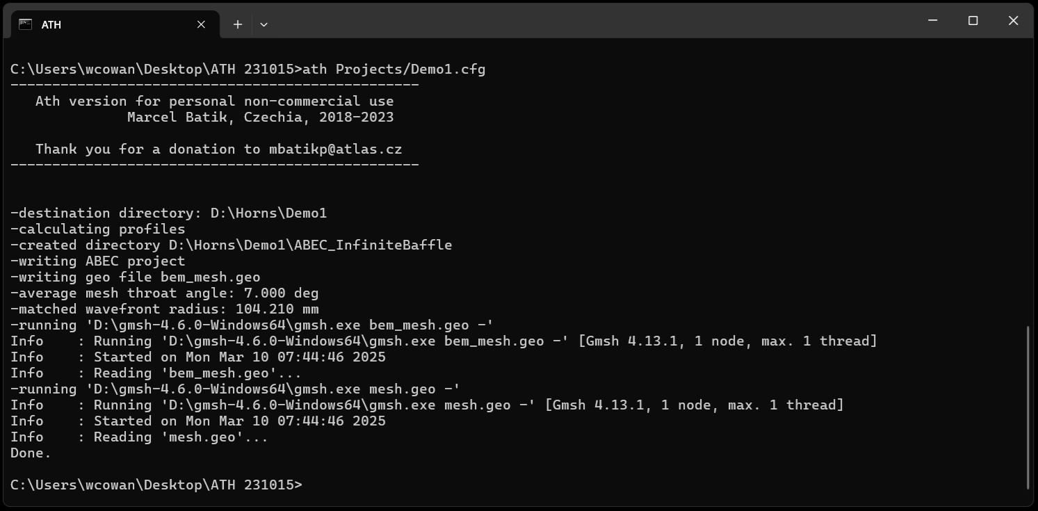

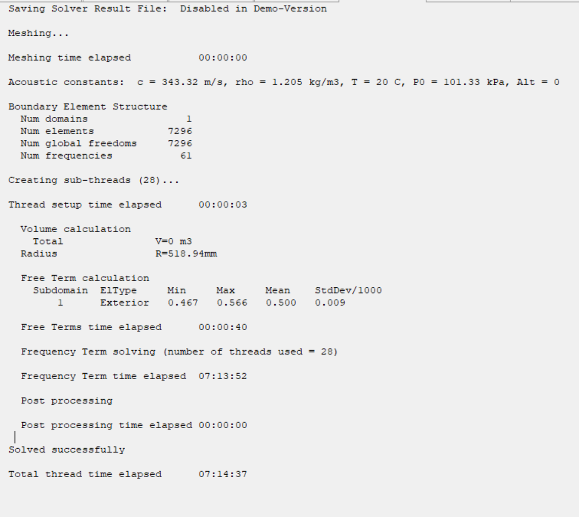

Thanks John, I appreciate your offer to have a look.@cowanaudio post your config and I'll run it on my end and see what happens.
I've attached the screen grab of the result and the file I was running. I renamed Demo1.cfg to Demo1.txt to upload here, but it still appears to work in ATH as a txt file. This file is the demo in the documentation. Turning the abec file on and off doesn't appear to change the result. It does generate an stl for me. I've also tried the Tritonia-S file from Marcel's website with the same result.
I haven't installed ABEC yet, but all other required programs appear to have installed correctly.
My ath.cfg file points to the correct location for gmsh and gnuplot.
Many thanks for any help you can offer.
calculation + results optimized would be if ath would script a double simulation run: first with low mesh (i.e. 1000) for 0-15kHz, store abec results, second with high mesh count for 15-20kHz, combine. and prepare combined output data + plots.
Problem solved by rolling back to ATH 4.8.3b2
I'm not sure why the current version didn't work. I DL'd it again, with no luck.

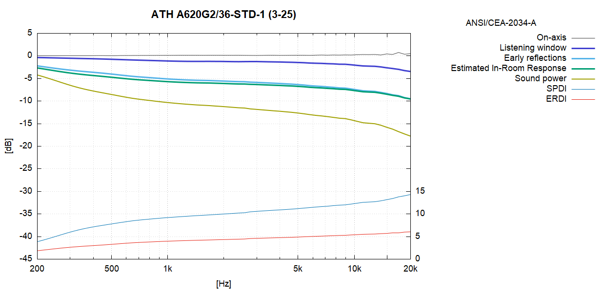

- That said, I have A620G2 in the making 🙂

I tried what @mabat recommended yesterday, and that seemed to work (no surprise.)
Basically:
1) my sims had high frequencies that looked terrible
2) when I increased my "meshfrequency" to 20khz, the high frequencies looked great, but the sim took fourteen hours
3) when I kept "meshfrequency" at Mabat's recoomendation (1khz) but increased the granularity of the mesh, the high frequencies looked great, but it took seven hours
So, basically, follow Mabat's advice. Use a meshfrequency of 1khz. I'd add a caveat that "if your high frequencies look like a mess," consider increasing the granularity of your mesh.

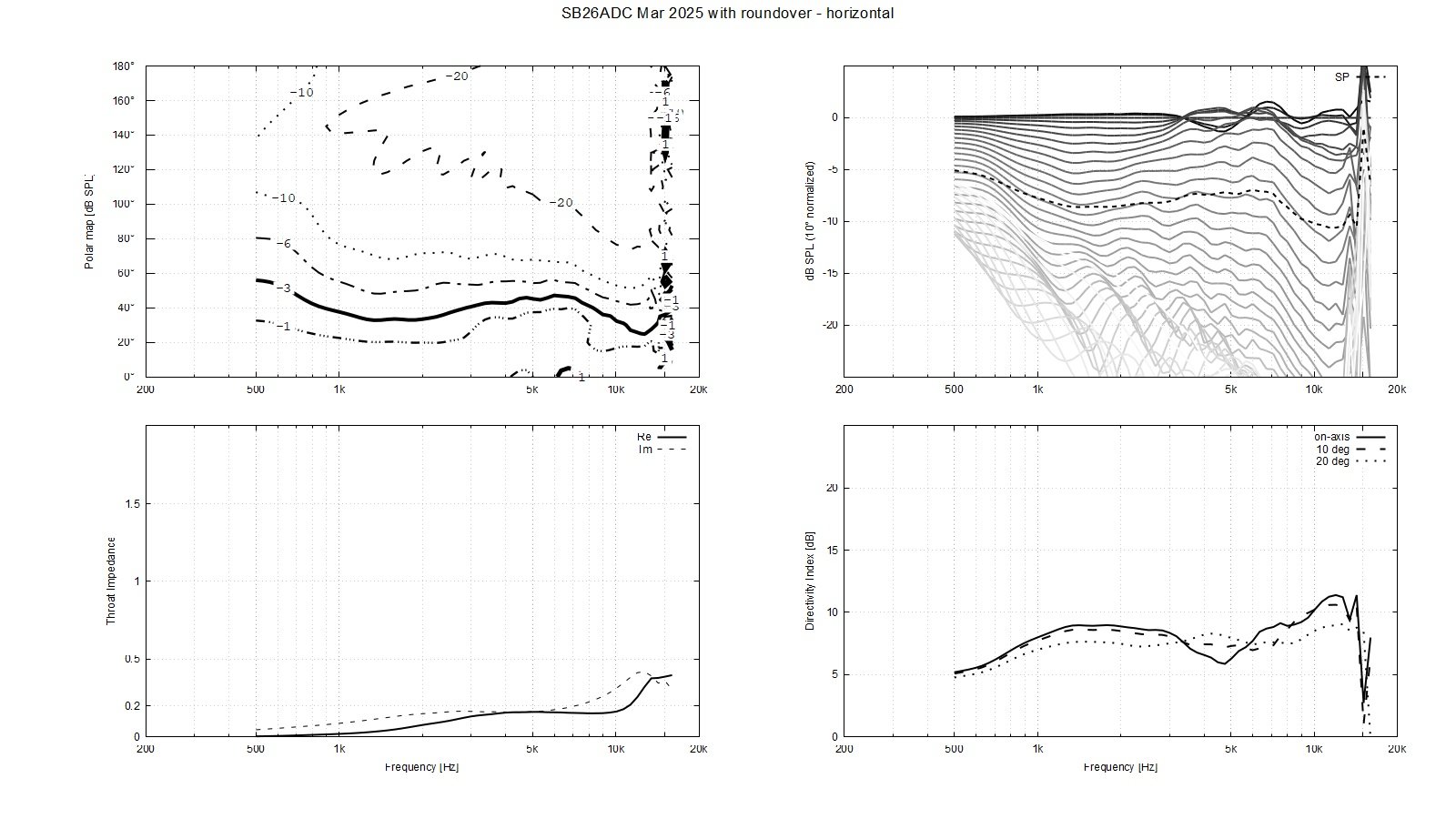

"A picture is worth a thousand words."
Here's a comparison of two sims; there are a handful of changes between sim 1 and sim 2, but I believe the main difference is that the one that looks good has a 2mm resolution at the throat and the one that looks bad has a 2.5mm resolution at the throat. Just half a millimeter of difference!!
And to put that in perspective, 14khz is 24mm long.
So we're talking about a resolution of 8% of wavelength versus 10% of a wavelength!!
Having said that, I've made plenty of waveguides IRL, where a difference of 2-3mm made a difference at the throat.
Here's the one that looks messy. Note that the scale on this one is twice has wide as the other one.
Here's the one that looks better. Note that the scale on this one is half as large as the first. Of particular note is that the highs don't look CRAZY.
