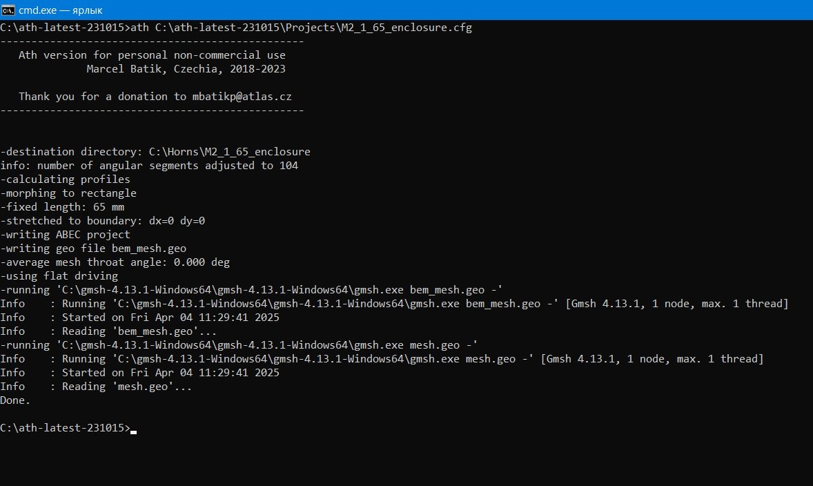

Does anyone know where the measurements of the waveguide went in the latest version?
In previous versions, when you ran the ath.exe binary, it would print out the size of the waveguide being simulated.

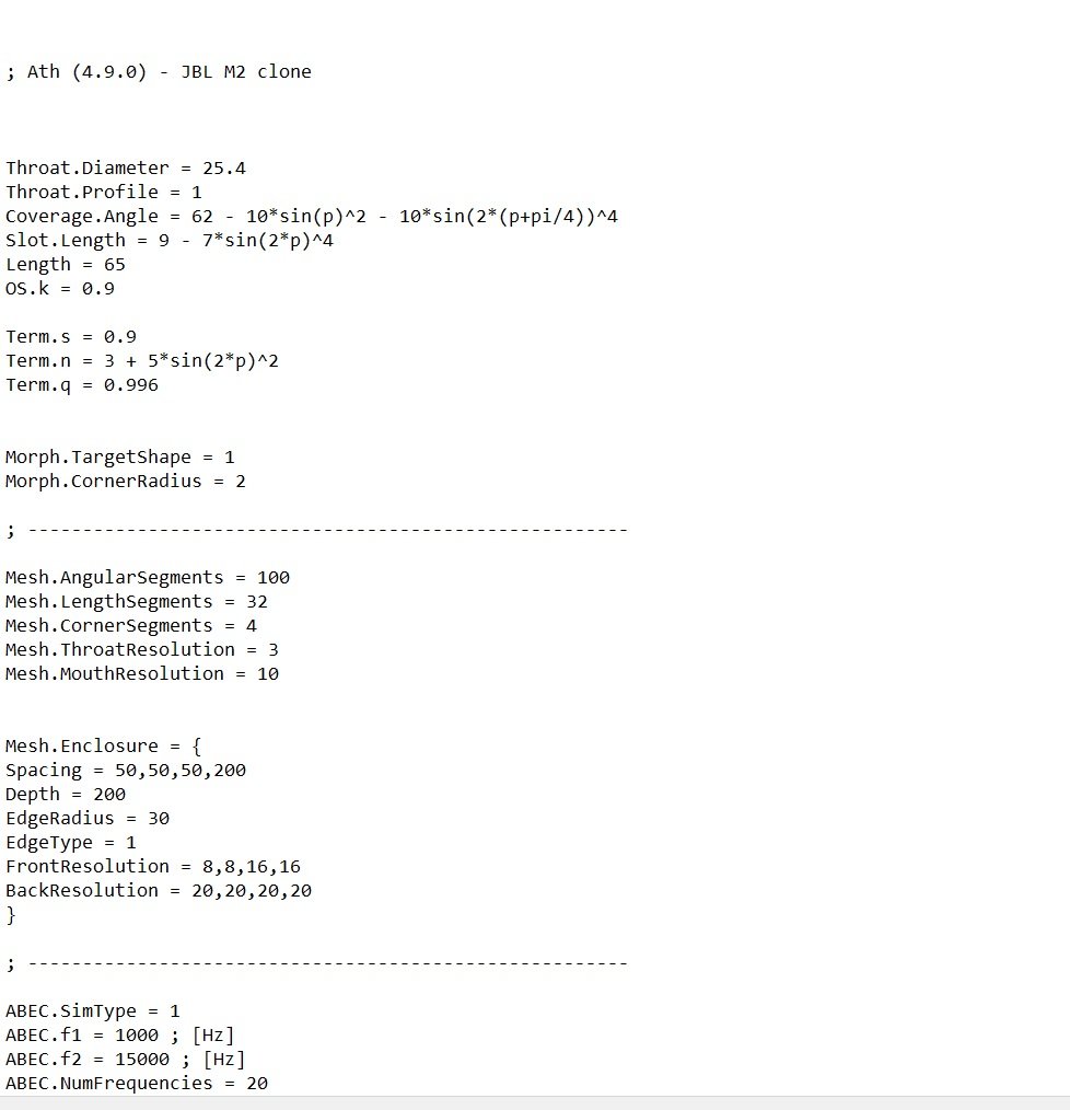

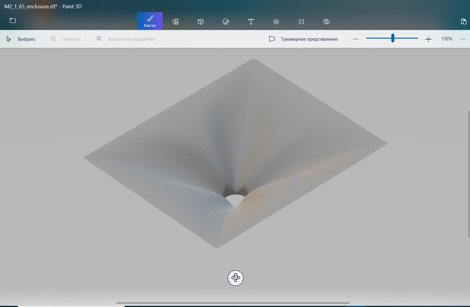

another question. why doesn't the "bottom" parameter change? i want the height of the cabinet to be 1300 mm. i tried different values, but the result is the same as in abec
Mesh.Enclosure = {
Spacing = 220,50,220,1300
Depth = 500
EdgeRadius = 30
EdgeType = 2
FrontResolution = 8,8,16,16
BackResolution = 20,20,20,20
Mesh.Enclosure = {
Depth = 500
EdgeRadius = 30
EdgeType = 2
See page 56 of the manual:
"To use more quadrants we simply set the item Mesh.Quadrants to the desired value (see 4.1.4). For example, to simulate an enclosure in half-space symmetry, with a space left for a low frequency transducer under the waveguide, we need to use quadrants 1 and 4, i.e. set Mesh.Quadrants = 14:
That's a quote, but read the whole chapter, there's a lot of flexibility in the enclosures.

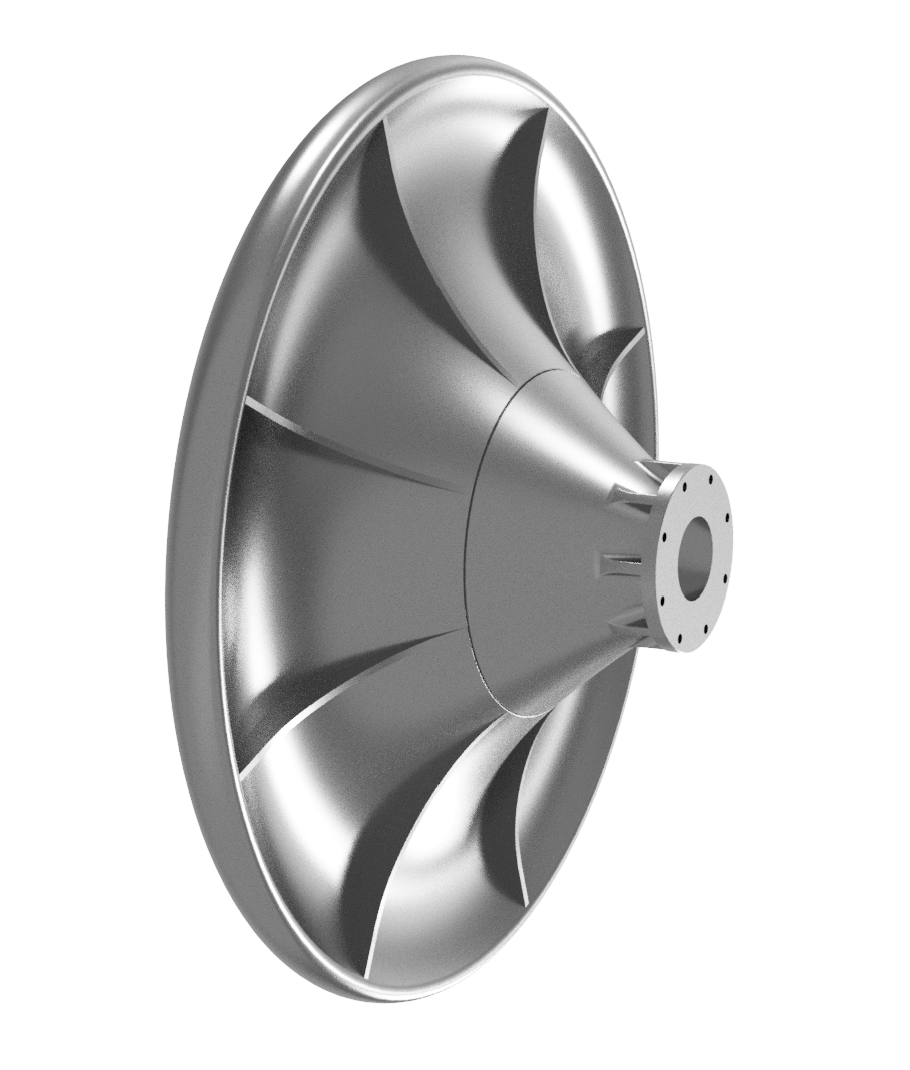

A620G2 is available for those brave enough (see Cults). Some datasheet/manual will hopefully follow.
Of course this one is meant for the biggest drivers that are able to utilize such a large device in the first place.
For 2" throats I'm finishing a spherical-wave plug as a Gen2 adapter. The idea is to transform a flat wavefront into sherical, improving the HF directivity considerably. Simulations are looking good but I won't buy Axi2050 just to verify (it really depends on how flat the input wavefront actually is). Otherwise, the 2" throats just start to beam too much at HF, IMO.

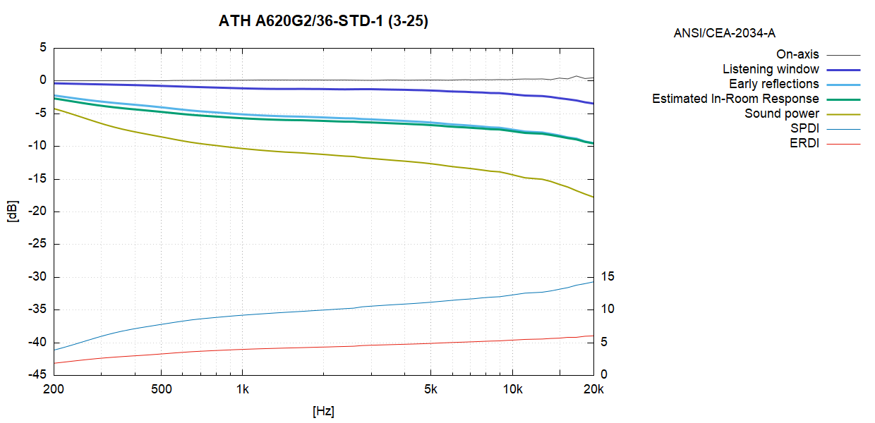

I already showed the A620G2 performance, but here it is again:
It really calls for being crossed as low as possible. With some of the bigger drivers 400 Hz should be no issue (the wave shaping plug promises even lower usage). The DI at 400 Hz is still pretty high but if you use the waveguide this low, you gain a very smooth and even curve(s) all the way up, and especially through the whole midrange.
Best used with a dipole bass cabinet, I would say.

The A620G2 feels like a nice foundation to build a MEH upon so please don’t limit your curiosity to a 2” entry.
And also consider adding the step files to the cult sales page as a bundle or separate sales item.
It's not limited to 2" entry, as it's a regular Gen2 device compatible with all the existing adapters...
BTW, there's an ATH script file as a part of the package, so it's easy to get the profile coordinates to be used for whatever custom design.
