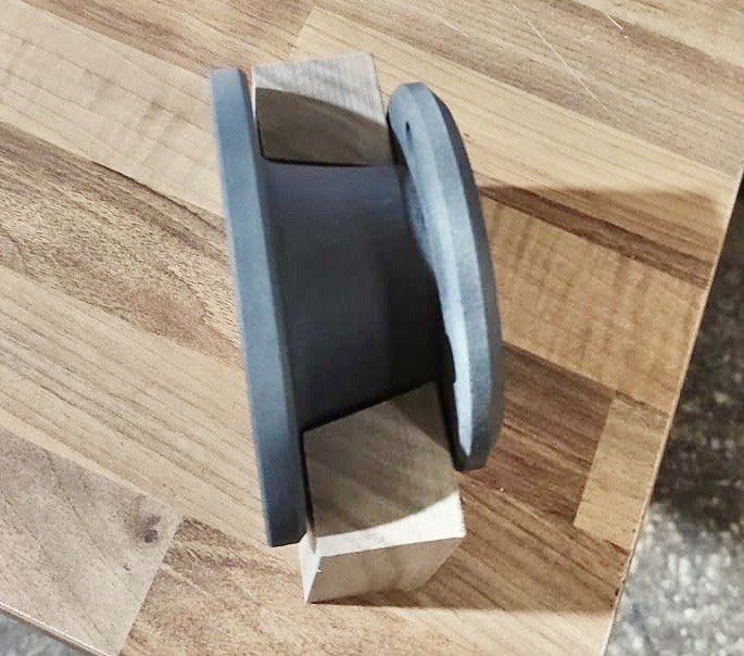

We are lucky that even standard pla that it’s easy to print can achieve a great result of stiffness will do it and post the results , with the parameters I used if I can help somebody, thanksA solid adapter should be to most sturdy (if you had the determination), but not really necessary, IMO.
I just took my 460G2 and knocked on it holding free air and another time damped by putting it on my leg. Very interesting how this soft external damping reduces knock-ringing to nearly 0. I was really suprised by this small experiment.
Maybe for final print I will design a small Support with some sylomer contacting the horn. This is available in various stiffnes.
You could print something with TPUI just took my 460G2 and knocked on it holding free air and another time damped by putting it on my leg. Very interesting how this soft external damping reduces knock-ringing to nearly 0. I was really suprised by this small experiment.

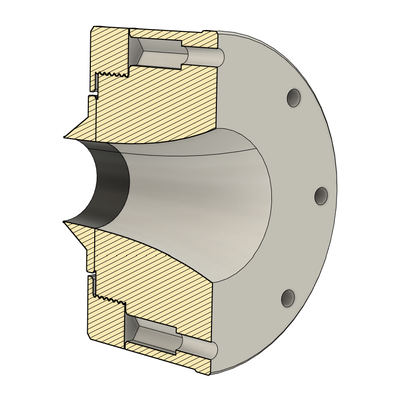

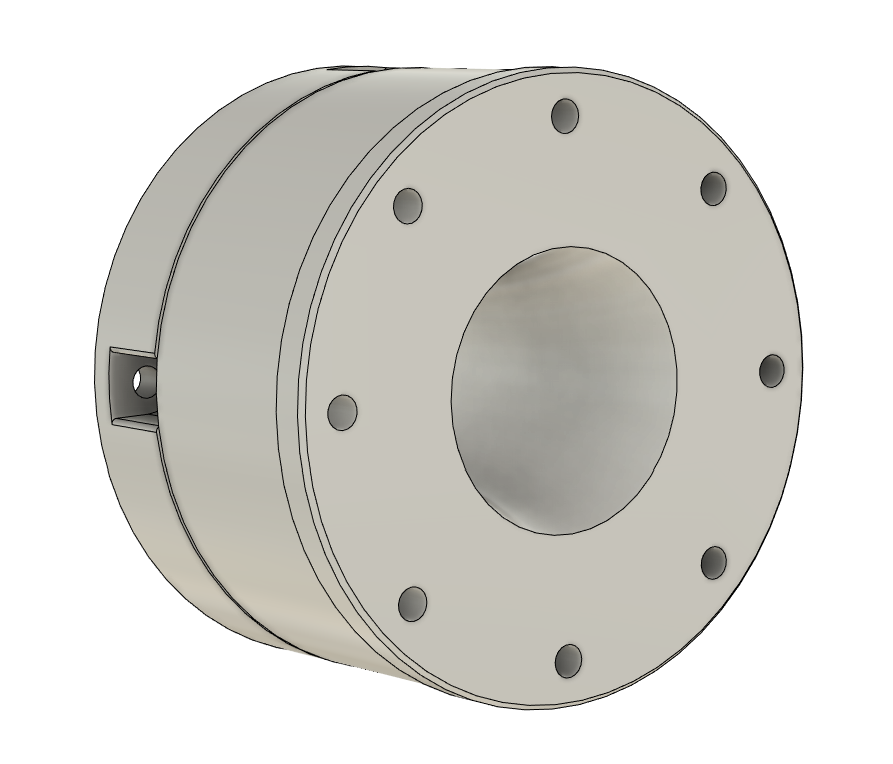

I'm going to try PCTG with the next adapter prototype.
Indeed I have a multi-material capable printer (Prusa XL). I already thought about making joints from TPU interlocked into the PetG. But that would be massive printing time and I did not yet figure out how to generate this type of mechanical interlocking between 2 printed materials in the slicer. If a local damping works that good I see no need to investigate this further.
You could just try to decouple the horn from the speaker cabinet , I had great success with sorbothane on a set of speakers , under their base , but an horn doesn’t produce much vibration

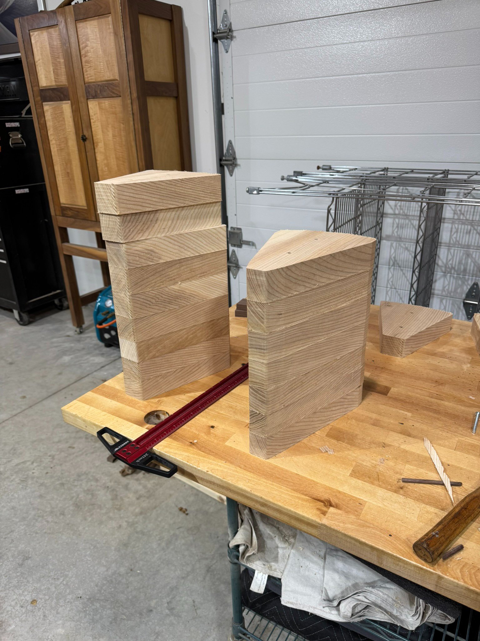

I started making sawdust fly on the wood portion of my horn - given how precise this all needs to be (9 miters with even a small amount of error adds up quick) this is really stressing my CNC skills! This is the first stack of rough blanks for the horn - each horn needs to have 18 pieces milled and assembled (9 petals, 2 pieces of wood per petal). This stack here represents 9 "tops" and 7 "bottoms" - hoping to mill the remainder tomorrow and then actually start shaping soon.

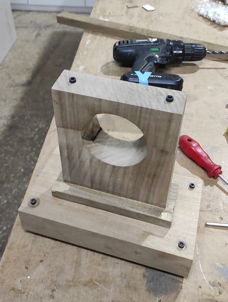

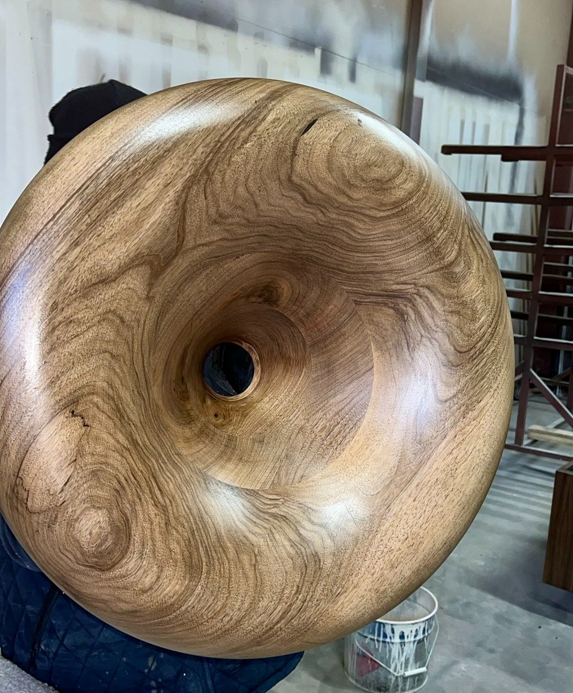

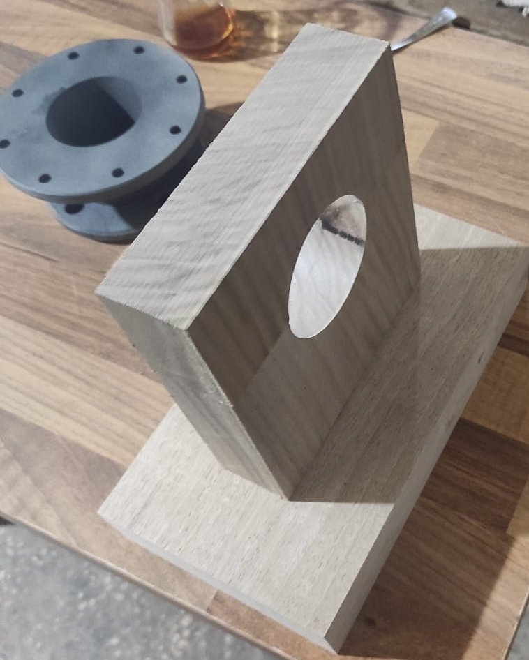

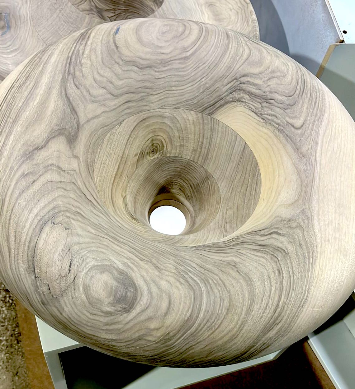

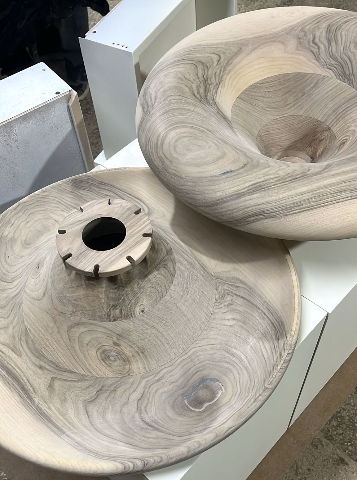

I have also made them out of wood, but sliced them differently. Here are some pics for reference, both raw and then with oil applied. These are made from solid walnut. I am working on their stand. They are now going to be held by two pieces of wood screwed around the adapter but I do not find this solution elegant.I started making sawdust fly on the wood portion of my horn - given how precise this all needs to be (9 miters with even a small amount of error adds up quick) this is really stressing my CNC skills! This is the first stack of rough blanks for the horn - each horn needs to have 18 pieces milled and assembled (9 petals, 2 pieces of wood per petal). This stack here represents 9 "tops" and 7 "bottoms" - hoping to mill the remainder tomorrow and then actually start shaping soon.
I will now make another pair, and add a straight portion on the backside to be able attach them to any stand.
I'm really eager to see the first measurements, as these are probably the most accurate builds so far. Great work.
They must weight a ton, awesome jobI have also made them out of wood, but sliced them differently. Here are some pics for reference, both raw and then with oil applied. These are made from solid walnut. I am working on their stand. They are now going to be held by two pieces of wood screwed around the adapter but I do not find this solution elegant.
Top job. Would you mind sharing the details esp how did you do about round overs. How much does it weigh? Looking forward to the measurements .I have also made them out of wood, but sliced them differently. Here are some pics for reference, both raw and then with oil applied. These are made from solid walnut. I am working on their stand. They are now going to be held by two pieces of wood screwed around the adapter but I do not find this solution elegant.

Contrary to what people might think, it is actually lighter than my 100% infill pla print. The wood I found was really dry so it does not weigh too much but it does not resonate with taps either.
The cnc is used on both sides, so no problems with roundovers. I just laminated wood thick enough to cover the depth of the horn and the cnc I used was capable of drilling the whole depth. So one side first and then the reverse. Some details on the cnc file for keeping it aligned/straight but not much else. This is without the throat adapter so I can variety of 3d printed throats and cd's with it.
