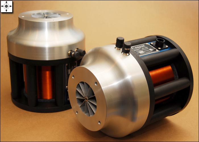

I also have some question regarding the STL file(s) provided by @mabat, since I have an unusual driver - a replica of an RCA-1428. Replica in the sense that the field coil, the phase plug, the phase plug/diaphragm/voice coil assembly, and the magnetic circuit are the same, but the overall construction is different, see attached picture. As a consequence, the mounting screw pattern is non-standard.
5. As this is 1.4 in exit flush with the front face, is there an adapter that might fit, or will I have to somehow design and print my own?
6. If the former, is there some application that allows modifying the adapter’s STL file to account for the non-standard interface? I tried several times to import an STL file to Solidworks and convert it, but the results were inconsistent; for some files all the features were recognized, for others only certain features were recognized.
7. If the latter, did @mabat posted some guidance, I have not found anything? Or, is it as simple as extending the wave-guide curve to 1.4 in diameter with 0 deg entrance angle?

Hi mjhara,
the driver was developed by my friends as a replica of the RCA driver I mentioned above, and was produced, more or less for custom systems, by my friends' company Cogent. As it differs from the original it was designated as DS-1428, you will find more details by searching. The original DS-1428, and, as to the best of my knowledge, now a derivative is also used by OMA in some of their speakers.
Kindest regards,
M
Kindest regards,
M

p.s.: quite the esoteric driver
Only the last one added to the full ring will tell you how accurate they are 🙂[...] they came flawless
But it looks perfect indeed, congrats.
If you provide the numbers, I can make a new adapter, even if for just this driver, it's no big deal.As a consequence, the mounting screw pattern is non-standard.

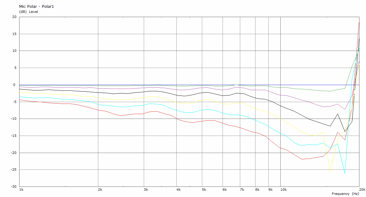

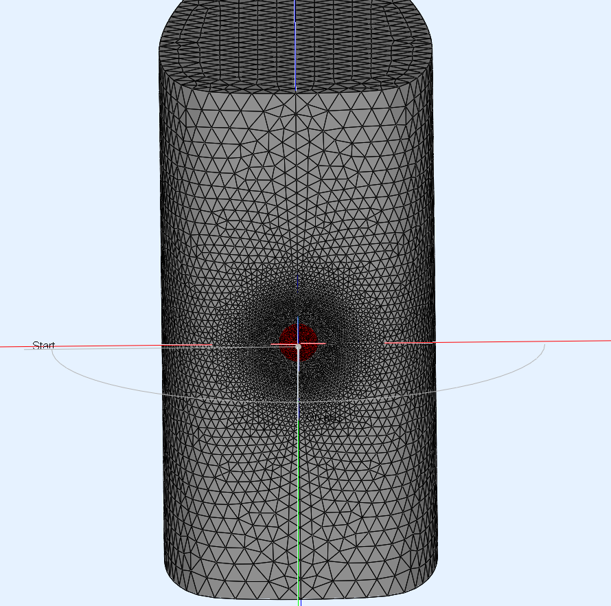

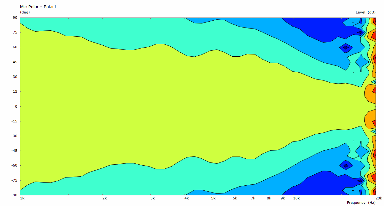

Hello, yesterday I found some time to make a measurement with Akabak. I was already despairing with gmsh and finally managed to control the resolution of the mesh.
I made a measurement with the waveguide from mabak with a housing.
Unfortunately I get some artifacts or let's say results that I can't explain.
Does anyone of you have an idea why the frequency response above 15kHZ looks like this? Is it a flaw in the cabinet design? Is it due to the mesh resolution or the Akabak sim setup?
I am grateful for any help
This typically happens when the mesh is too coarse for that frequencies. I would maybe suggest to distribute the mesh density more evenly across the front face of the enclosure. It seems very high near the tweeter, this may not be necessary. Try to spread it more evenly.
Overall, I'm a bit surprised how worse it gets in such enclosure. At least it seems worse.

Indeed, very esoteric driver. The original design was tested on Plain wave tube (PWT) between 100 - 13,000 Hz.
Hi @mabat,
Thank you very much for the offer. Although it may not be a big deal for you, it is a big deal for me because as I understand from following this thread;If you provide the numbers, I can make a new adapter, even if for just this driver, it's no big deal.
The exact adapter shape can make surprisingly big differences.
Regarding the "internal expansion" I have an accurate CAD drawing of the phase plug, so if you could advise, how to calculate the expansion, and it would be helpful, I could do it.I always do this by running an optimization algorithm, it's unlikely to find the best one manually, there are still several degrees of freedom. The only problem is that even for a known exit angle and diameter, the internal expansion is typically unknown, so there will always be a bit of luck needed.
