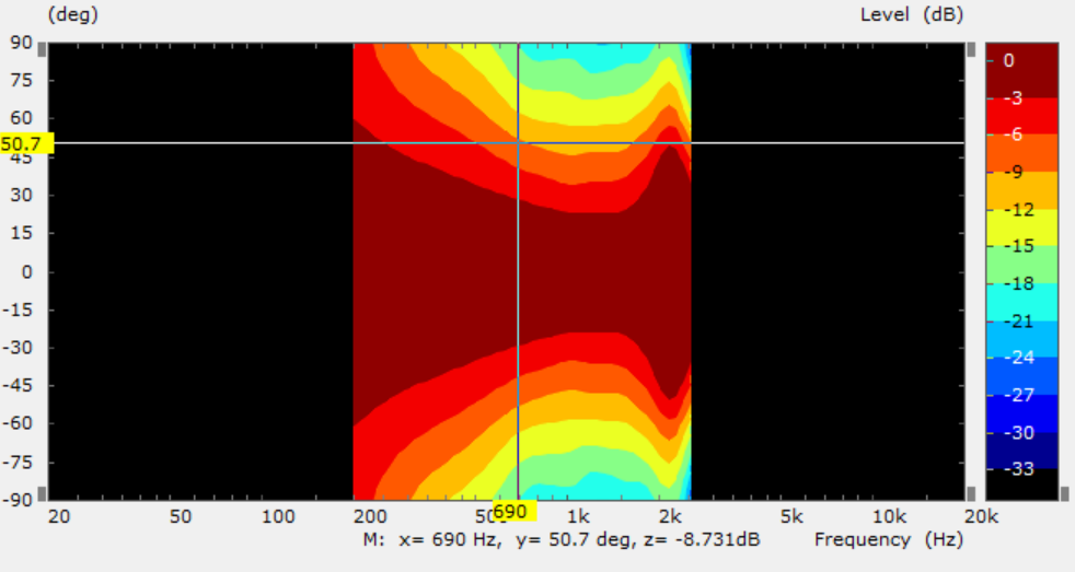

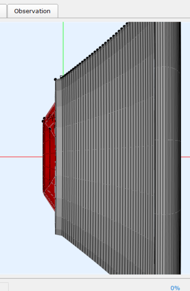

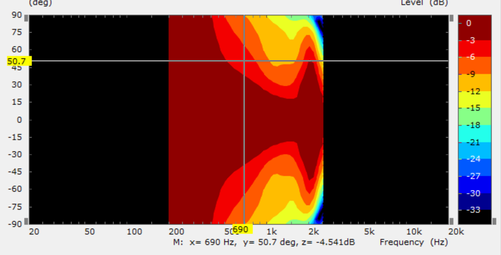

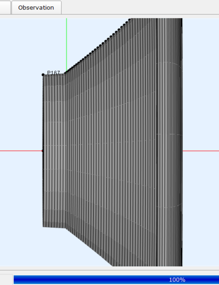

I did as suggested and edited the 2 nodes. Well...it makes a "slight" difference.
Original script with horn back going through driver membrane:
With the 2 nodes edited:
Difference in 3D view in ABEC:
It is point 167 & 168
Please ignore the horrible dispersion. Just the results of trying around more and more weird values and beeing confused by their results before you gave me the hint how to solve the problem.
Is there any chance this can be changed in script directly? Open nodes.txt for every iteration is making each iteration x2 the time....
Maybe easiest to change my source contours script somehow? It has point in + an - direction of z set point...

For the purpose of this particular simulation, you could try this (the shape can be different):
So the promised user-defined back side as a cubic Bezier curve:
Mesh.RearShape = 5 ; closed back
Mesh.RearCubic = -60,2,50,-80,5 ; [mm]
https://at-horns.eu/ext/ath-4.9.0-pre-230109-2.zip
You will lose LF directivity this way. To regain, you will probably need to increase the overall size. That's the drawback I see.

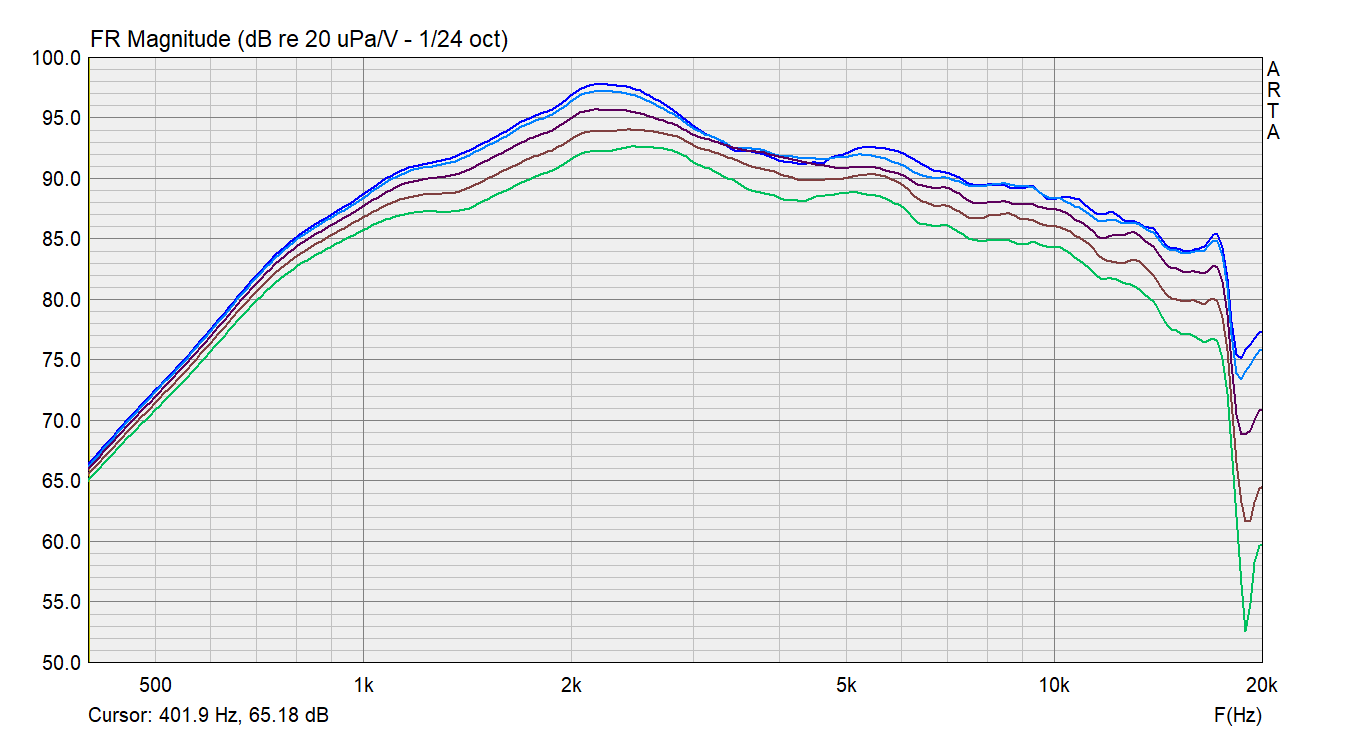

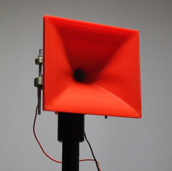

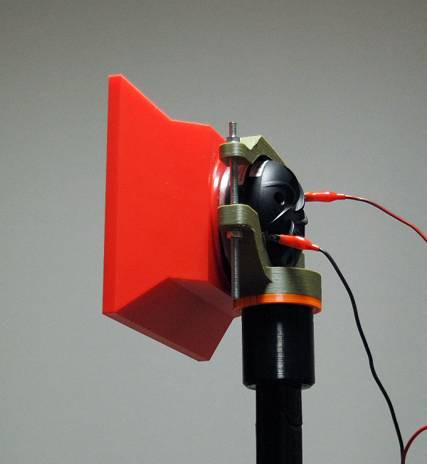

Tritonia-S prototype for verification, from the printer directly to the speaker stand -
(roughly 0 - 50/10deg)
This is of course absolutely not how it's supposed to be used, but I know people will use it like this anyway, so why not.
It's certianly not a complete disaster, which I assume is due to the rectangular shape. Measured with the Peerless DFM-2535.
In an enclosure this should be textbook. Printed in one piece, essentially, this is a no-brainer.

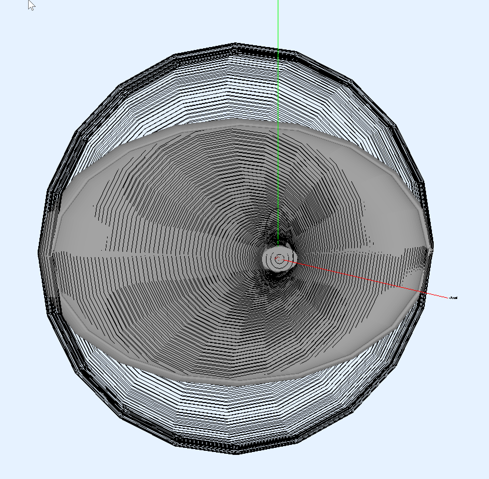

I'm slowly learning and already printing one but when I open it to abec it's oval. What's the problem?
Hmm where did attached image go... I bought 520 horn and attached that script to ath. Then used that .abec file in abec but it's oval.
Hmm, I've never seen this, nor have an idea how this could even originate. Puzzling.
Is it really ABEC, not AKABAK?
