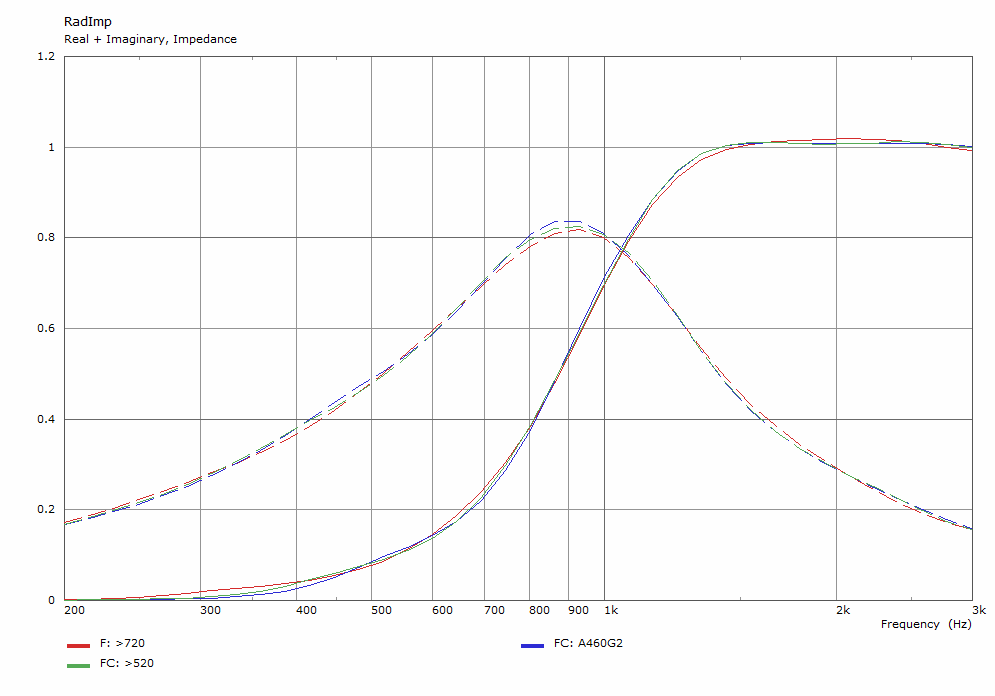

Here's some BEM data. I took A460G2 and changed just the R to 260 and 360 mm (i.e. mouth diameters 46 / 52 / 72 cm).
Throat impedances with the 25-STD-1 adapter:

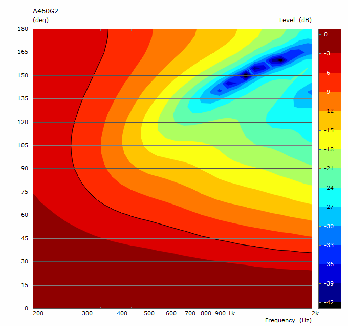

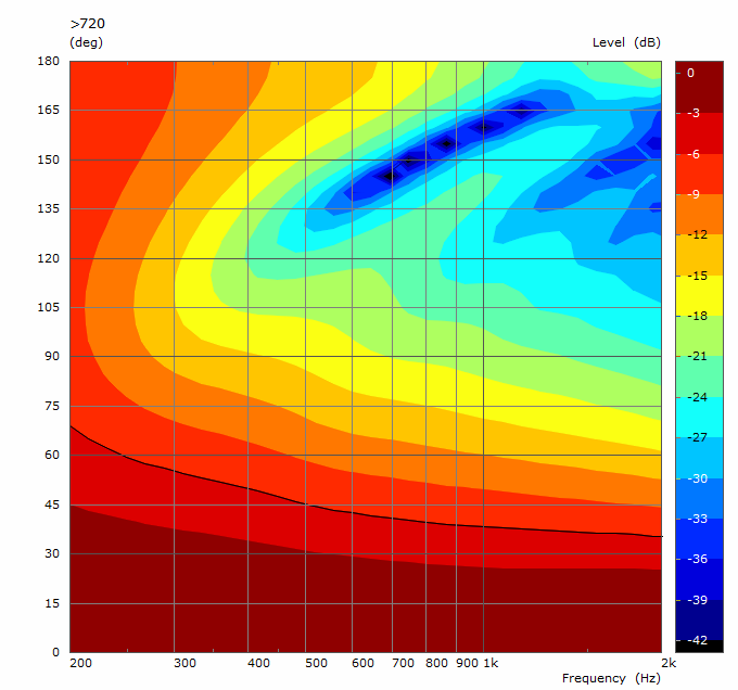

Polar maps for mouths 46 and 72 cm (with a -6dB marker line):
I would be also interested how to calculate an on-axis SPL gain from this. Maybe it's not so easy after all, I don't know.

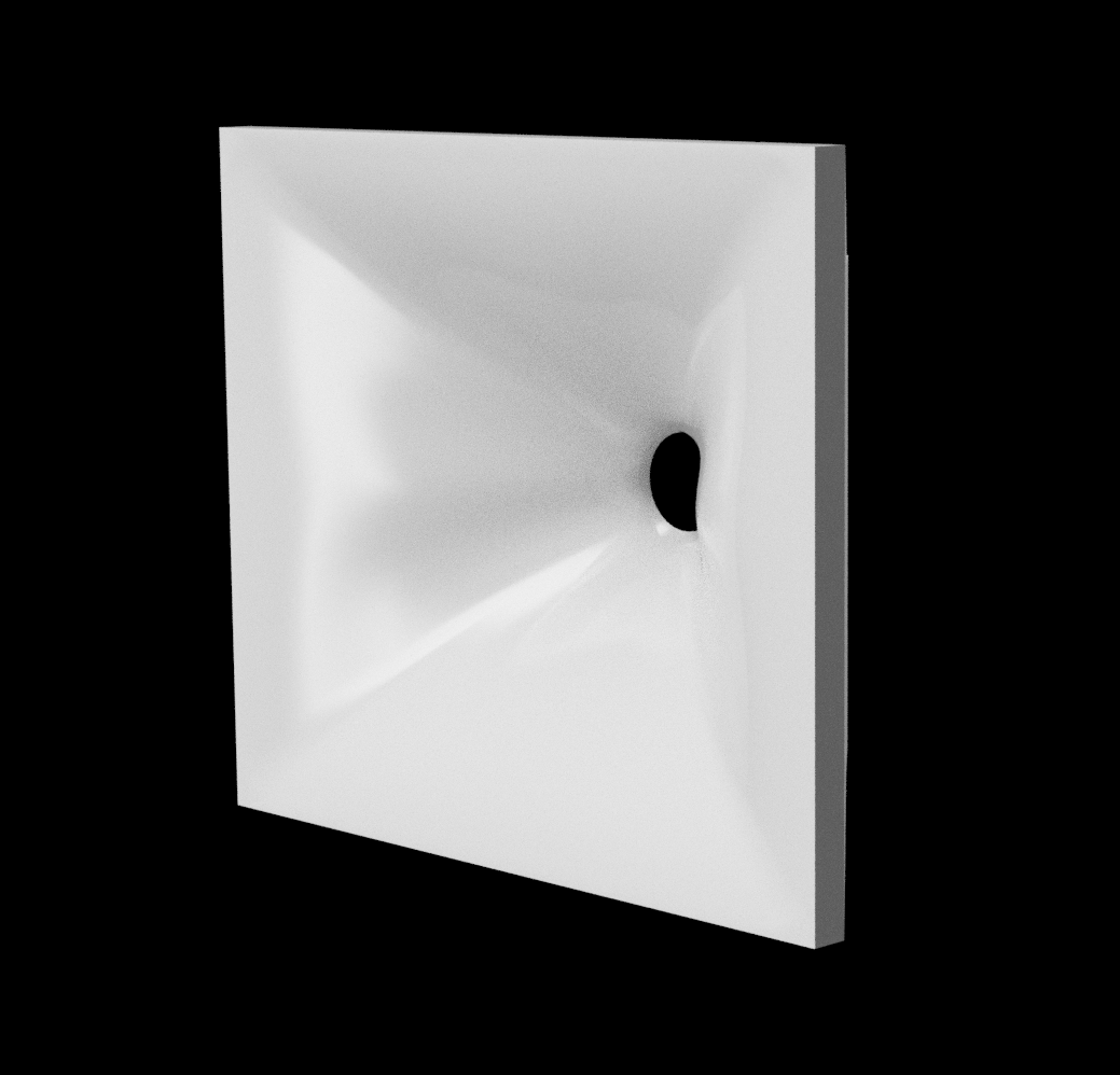

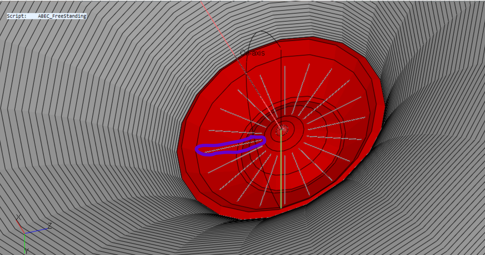

I am playing around with source definition script to make a LF-horn matching the A460G2. So far successful to scan the real driver, extract the geometry and build the source contour. But I have the feeling something is wrong as I cannot get any beaming in lower frequencies. It might be the source contour itself and all true.....or....there is still a mistake. I am worried about those lines forming a plane right at start of the horn. They truncate the source contour. What is this (marked in blue)?
I guess it depends on your expectations 🙂
- The lines you see are probably the back side of the horn shell as seen from the front. You can try to move these (two?) nodes further back manually in nodes.txt, but I don't think this should be an issue. (You can display individual nodes in ABEC Drawing - "Views - Nodes", and turn off "Symmetries".)
For my eyes that directivity looks quite nice. If there’s still some directivity left at 300Hz it should increase gain too. Is it enough is another question of course
Of course it will. How much, I can't say. My guess would be "not much" 🙂If there’s still some directivity left at 300Hz it should increase gain too.
Yeah, as one sees on the 72cm device sound at 300Hz to 180deg is about as loud as in front, which means it's about 2pi radiation. Increased directivity, SPL to 120deg (90-180) is reduced due to sound doesn't come to that direction just from the closest side, the shortest path aka direct sound, but all around the device, with extra path length making destructive interference. This makes the characteristic "ridges" to polar map that start from lower frequency and angle, and extend toward higher frequency and angle, due to wavelength getting shorter while the object size stays static of course 🙂

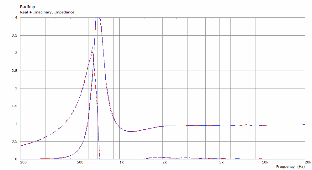

BTW, these are the throat impedances of the 46cm and 72cm Gen2 horns with the 4554-EXT adapter (17mm throat) -
Here's a considerable "lift" centered around 700 Hz - this is the kind of increase of the radiation resistance to actually make a difference.
Otherwise the two impedances are virtually the same.
