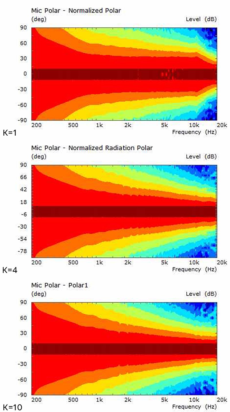

I've been playing around with the formula and trying to understand how the variables might affect loading and dispersion - I simulated 3 horns, all with identical parameters except for K - where I did tests at K=1, K=4 (I think the Gen 2 Horn var.), and K=10. I used an exit angle of 0 to theoretically match the DCX464. I'm still rather new to this, so I don't exactly understand how these things would affect the horn loading, but the results are below - what is interesting is the magnitude of difference between K=4 and K=10 appears to be quite small, at least so far as I am understanding the graph (which I could be misinterpreting because I'm a complete amateur).
I dont think you see any absolut magnitude in these. They are normalised in order to show relative directivity as a function of frequency. If one spread a certain amount of energy in a wide manner it will sound weaker than if the same amount of energy was more focused to one location. There is no magic 😉

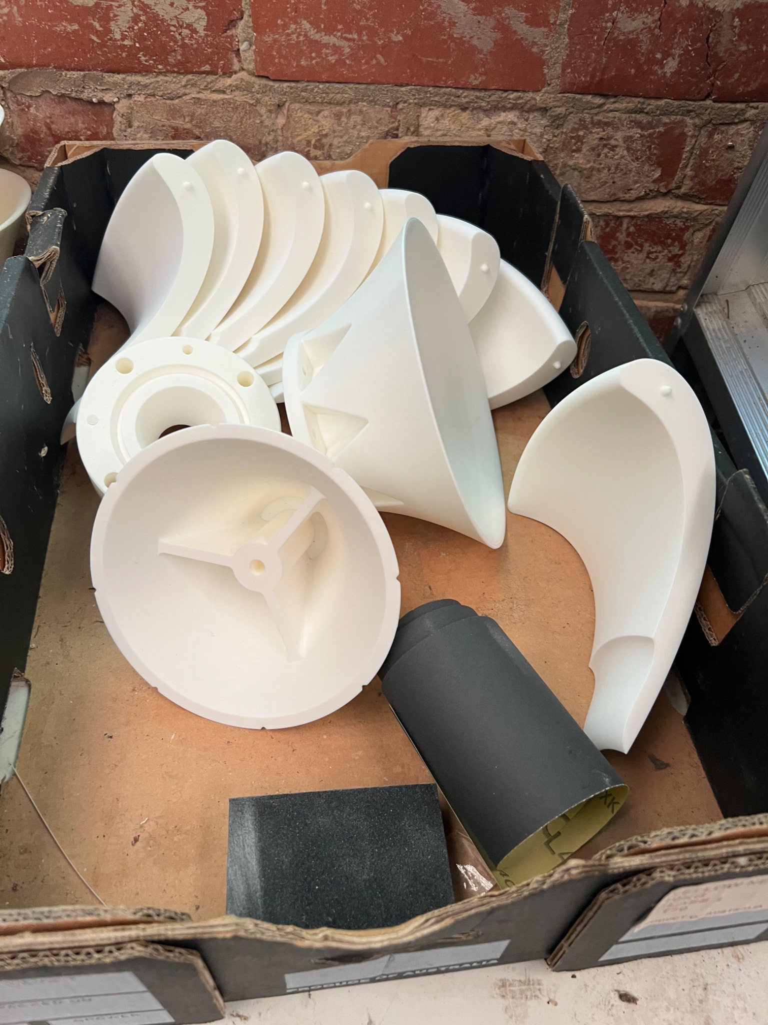

I just printed out a ATH 420G2 kit on my Bambu Lab printer and am excited to start building it. I've seen the published results, done my own sims to compare and they look terrific.

That's true but not the full story. Say around 800 Hz, those horns with k=1 and k=10 will have very different throat impedances, although the beamwidths will be already similar.If one spread a certain amount of energy in a wide manner it will sound weaker than if the same amount of energy was more focused to one location. There is no magic 😉

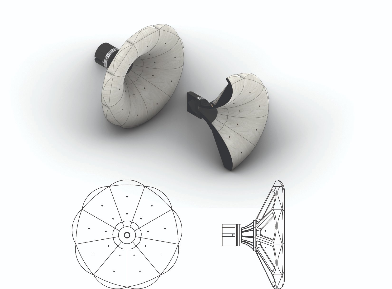

So after following this thread for a while I decided to settle on the SB Audience Rosso CDN-T for a CD, and I purchased the files from your site to get the initial geometries. I modified the curve a tiny bit to accommodate a larger horn (about 600mm diameter) with a slightly higher K (I think 5 instead of 4) in order to try to squeak out a slightly lower F3 than the model on your site - not much, but around 600 would help my c2c spacing on the drivers. I rebuilt all of it so it was surfaces rather than a mesh, then shaped it so the majority of the horn can be fabricated out of wood, with a small 3d printed throat and throat insert like your model. Attached is the 3d model I'm working from - the biggest challenge IMO is going to be getting that last petal to fit without gaps. Using a CNC to cut the wood petals.

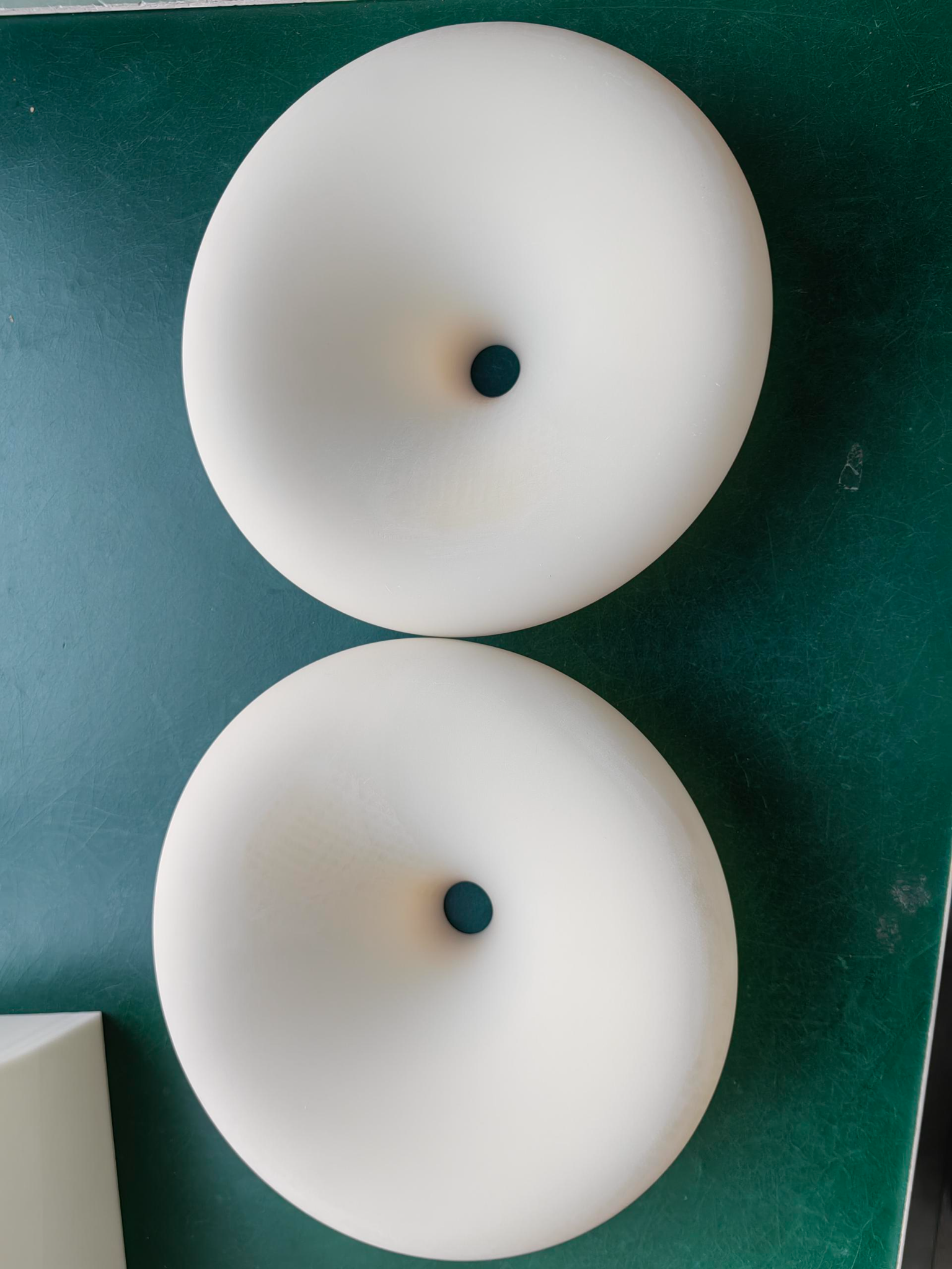

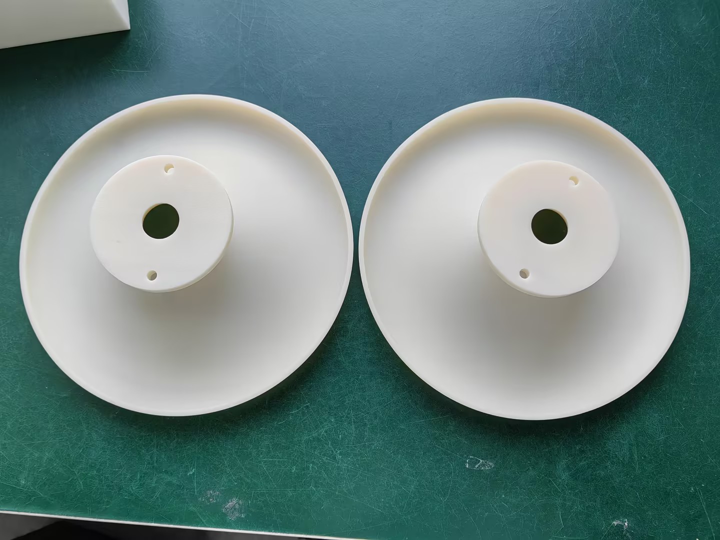

After following this thread for a while and realizing I’m getting a bit too old and busy to design a waveguide myself, I decided to take the plunge and have these made. They’re the ST260, printed with an SLA printer, so 100% infill. I went with Somos Ledo Resin—it’s a bit more expensive, but known for its strength and smooth finish. I’ve always found FDM prints to be a highly unattractive, so I’m really happy with how these turned out! They were printed as a single piece without supports—no idea how they managed that, but they look great. Each one weighs 450 grams, so they’re pretty solid. They where made by Unionfab in China, a firma that is an absolute pleasure to deal with. Total costs including import taxes and shipping around €230,-. I could not find an adress anywhere near that could do it for less than €300,- to €350,- each in the same quality so it was worth it to go abroad. Next weekend I have time to give them a try.
