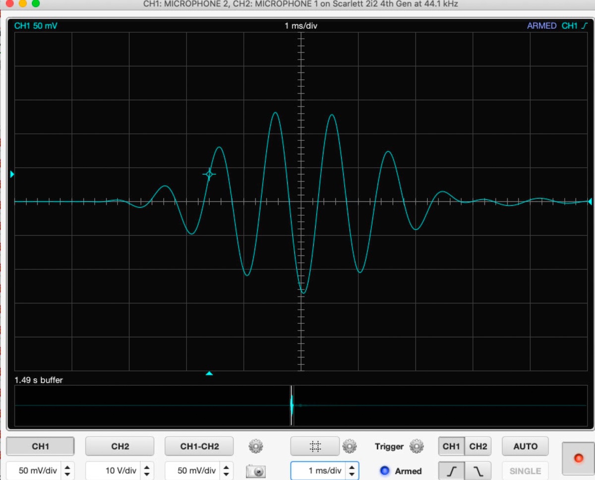

Did the wavelet - looks OK I think?

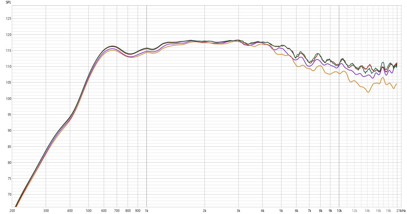

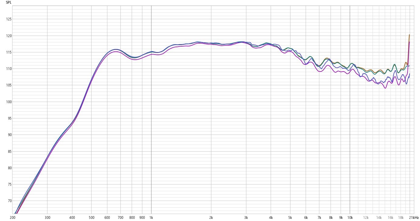

I have recently printed and assembled two ATH520G2 horns with the BMS 4554 drivers coupled to the T520-4554-EXT.
Below are frequency responses for each, along with an impulse response and a step response. The step size off-axis is not calibrated or measured. There is no smoothing or FDW.
I also let REW generate EQ for them. A FR of the equalized response for a LR4 at 600Hz is also attached. 4 bi-quads and a shelf filter.

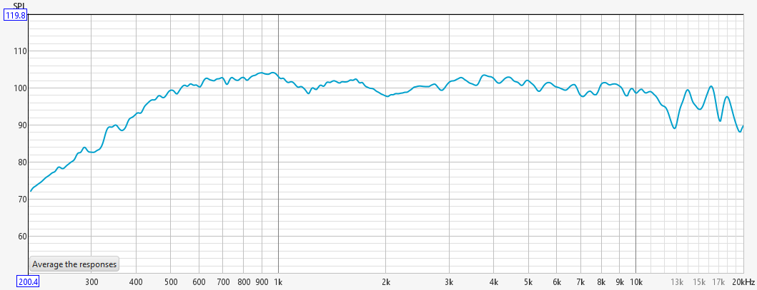

raw measurement eminence nsd2005-16 with prototype metamaterial back. a520g2 extended throat. i bought the pair for $90 shipped, i guess that's cone breakup on the top end? idk i just did a crude measurement holding the mic and horn in the air by hand. i think it can only get better. maybe ill apply some aquaplas to the diaphragm.

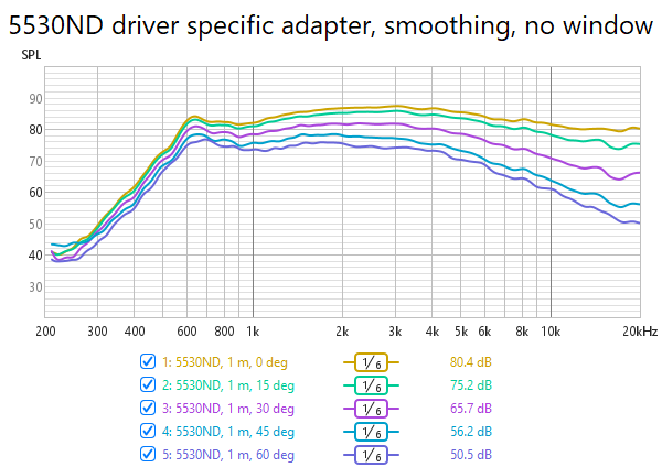

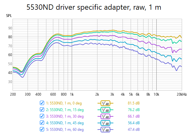

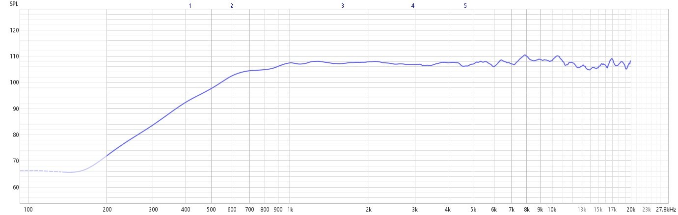

I've printed, sanded, assembled and tested the 5530ND and here are the spectacular results (as expected 😀):
No smoothing, 6 ms window. With no windowing and 1/6th octave smoothing:

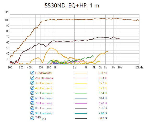

Distortion on axis with 2nd order BW HP at 600 Hz and EQd flat:

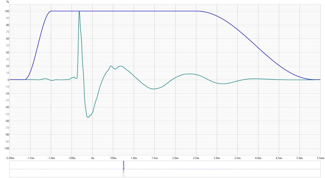

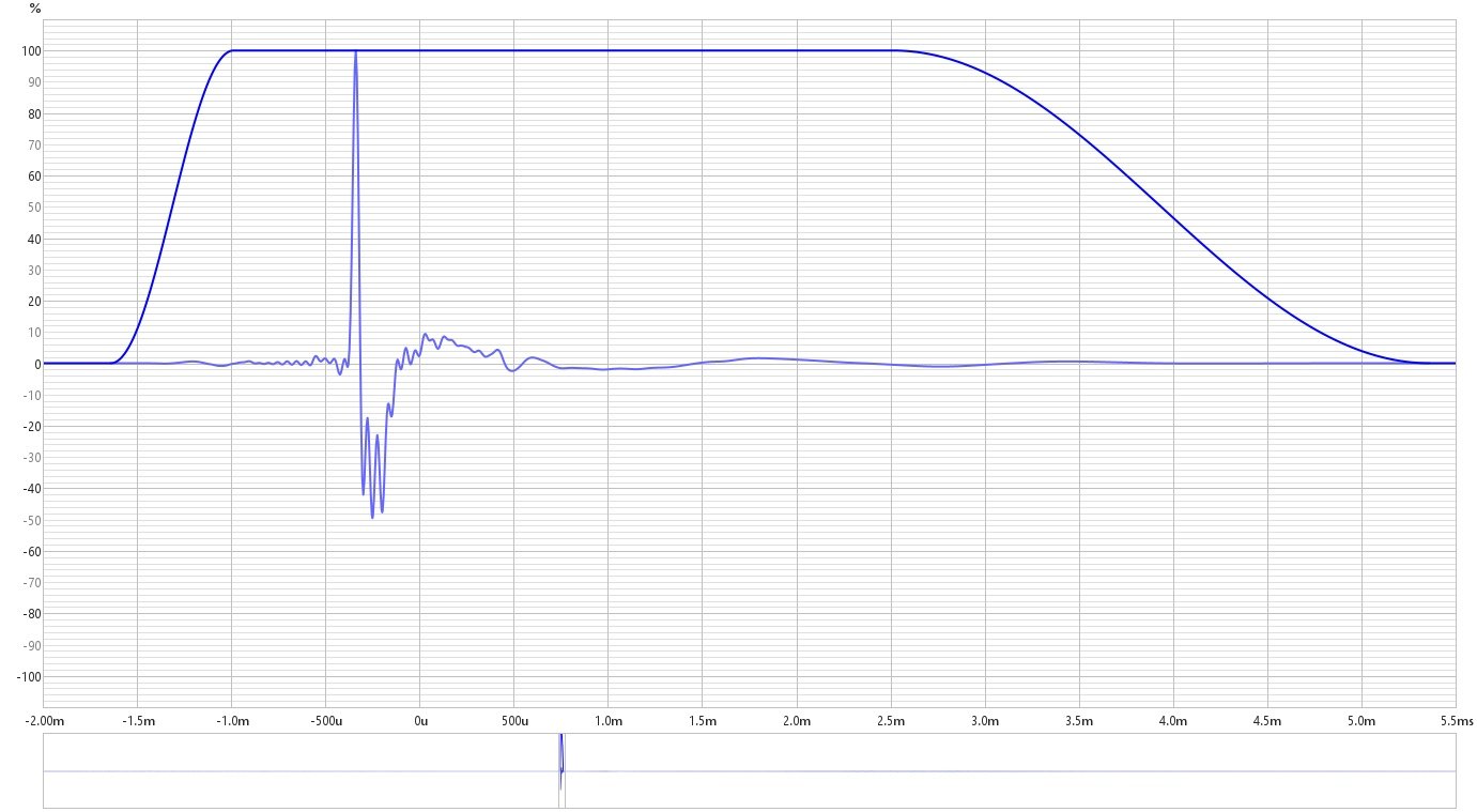

Impulse response on axis looks like this:
Probably the best device I've measured. Great work Marcel and everyone else involved!

Is it just me or is the HD2 mis-coloured?
Edit: Never mind, it’s just that the THD covers HD2 for almost the entire curve. The HD3 is really starting to rise at the low end but the -50 dB down is likely not audible. Fantastic.
Edit 2: any possibility you could try an LR4 filter and re-measure?

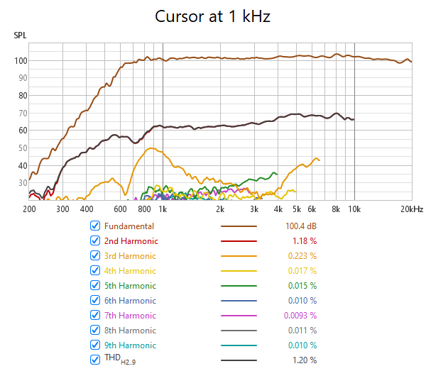

Distortion figures seems "odd".... what happened there? Are you playing 139dB?
As kodomo says, cursor was at 200 Hz. Here is with cursor at 1 kHz:
I would say that the HD3 curve has a bit of a bump around 860 Hz, but is other than that very low. It peaks at 0.3 % at 860 Hz with a 100 dB fundamental, low enough for me.
LR4 electrically or acoustically? BW2 electrically already gives a slope around 6th order. Not sure why the raw system is 4th order acoustically.
