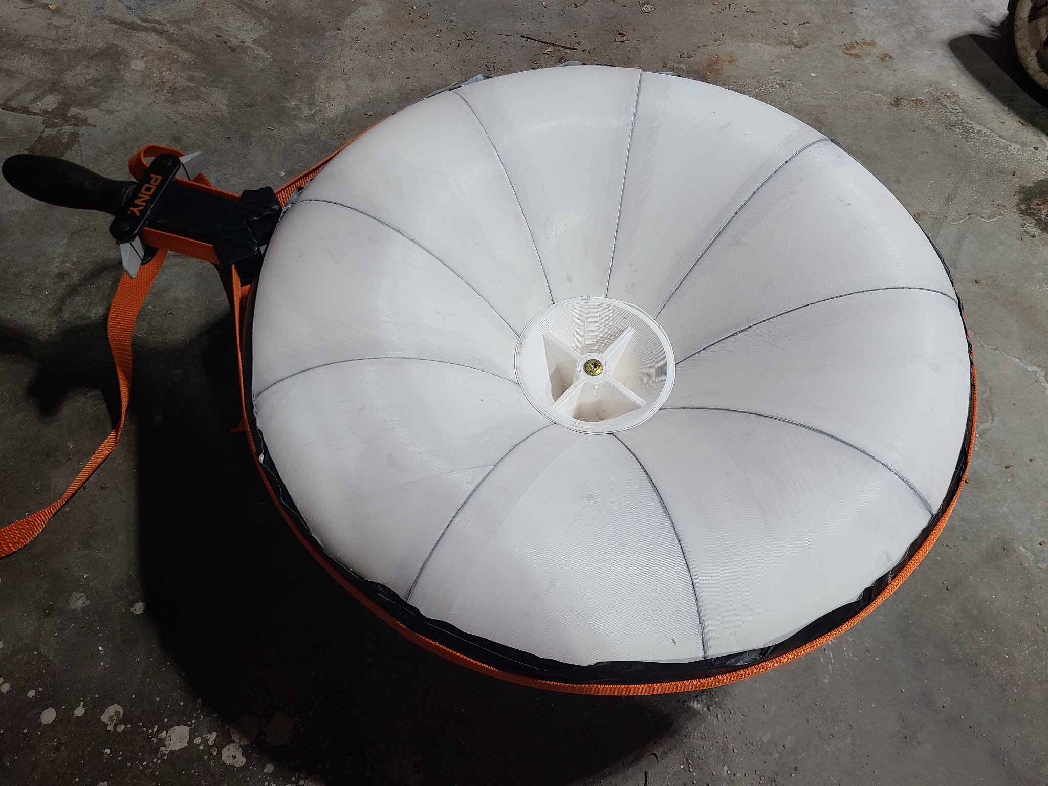

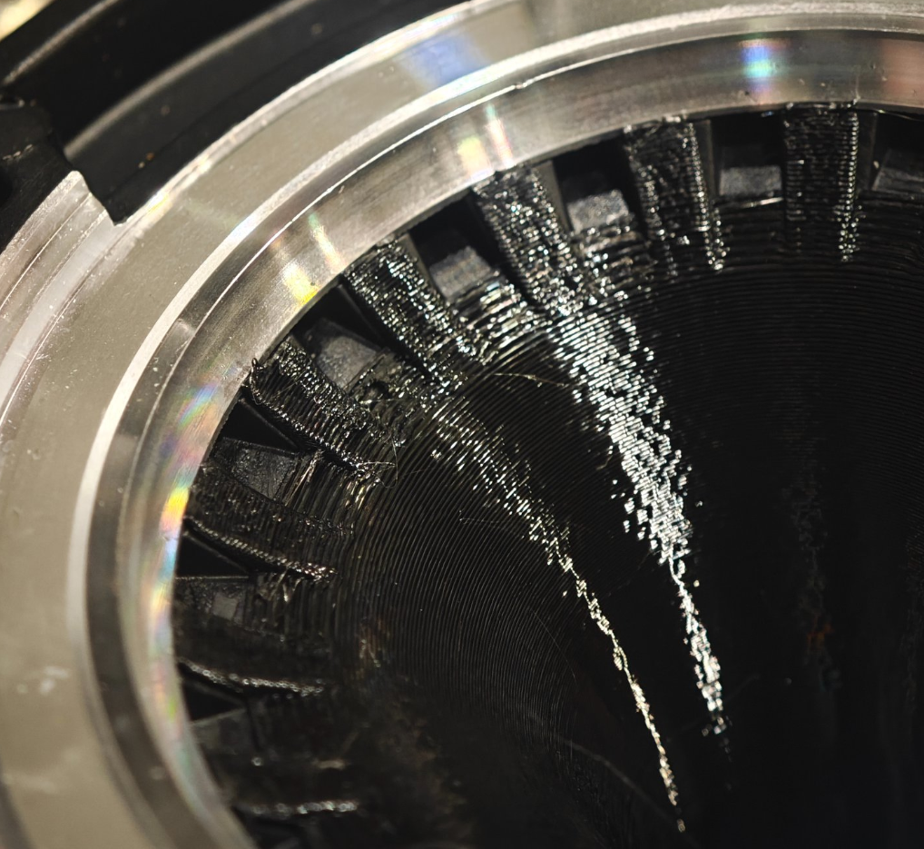

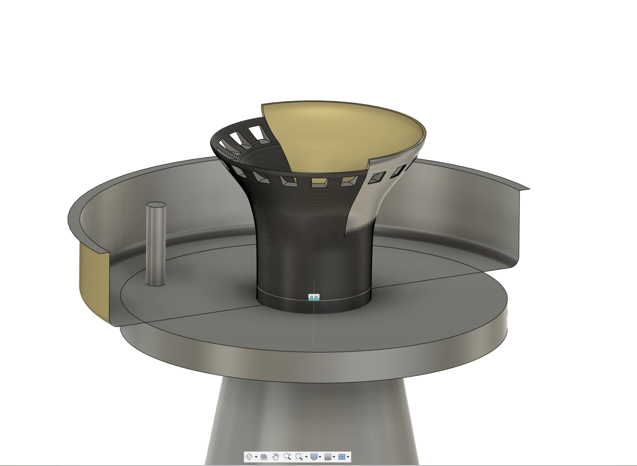

This shows my printed insert IN the dcx. The original thorn is kept and this adapter modifies the outer geometry to fit your stuff. It morphes the cross section area according to your bms adapter. The ports you see here are the LF entrance ports in the dcx around 5mm away from the HF diaphragm.But maybe I still don't get it. What we're looking at here? - Are these the MEH entrances of the midrange into the horn or not?
The black thing is the insert. Between thorn and outer wall of the original driver. Understood? Not at home can do more pics later...
No. In this pic:
Top: back side of driver
Bottom: horn outlet
No 180* turn like on the bms. Diaphragm exit shows towards horn
Bottom: horn outlet
OK, now I get it! Thanks.

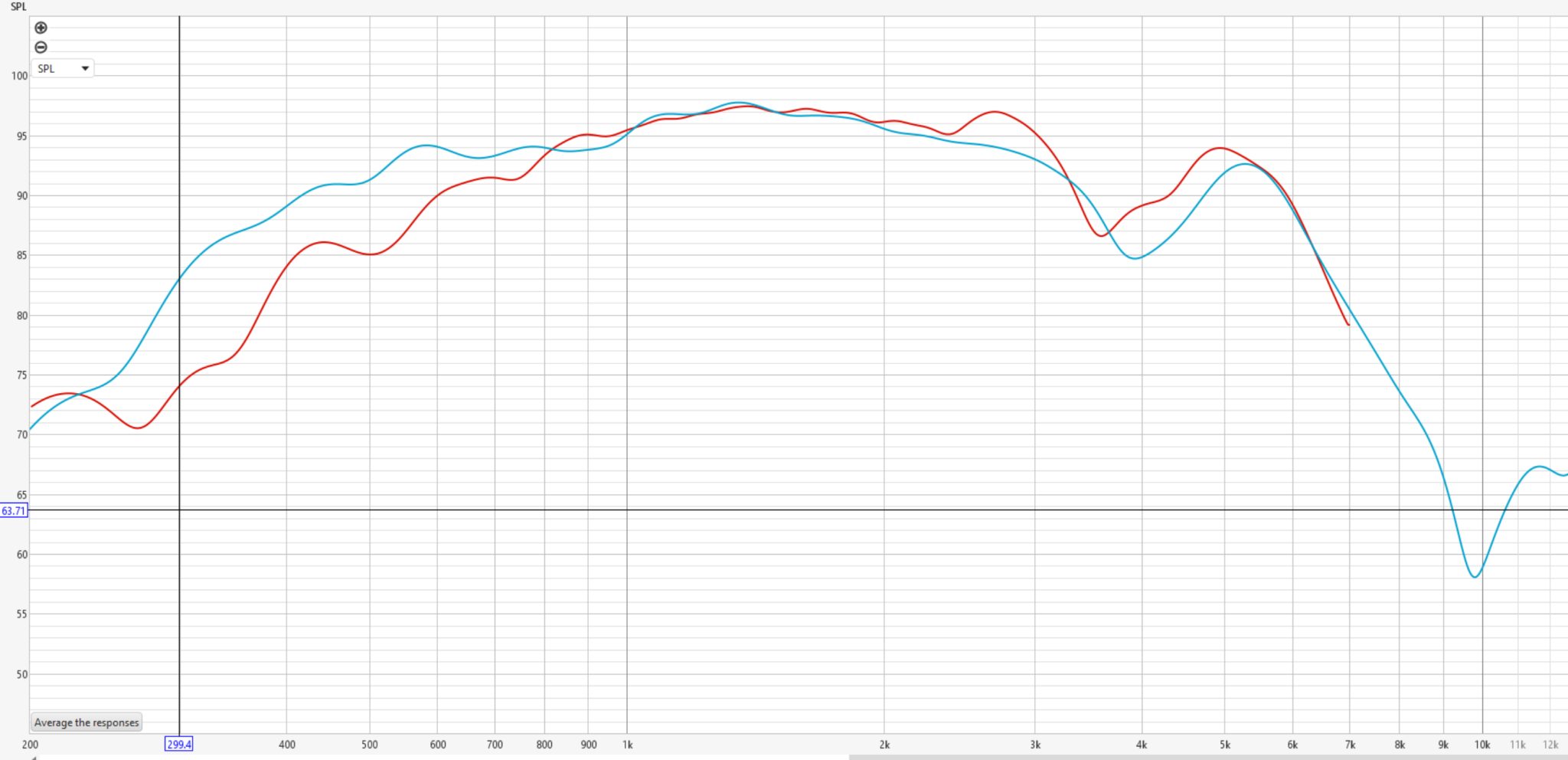

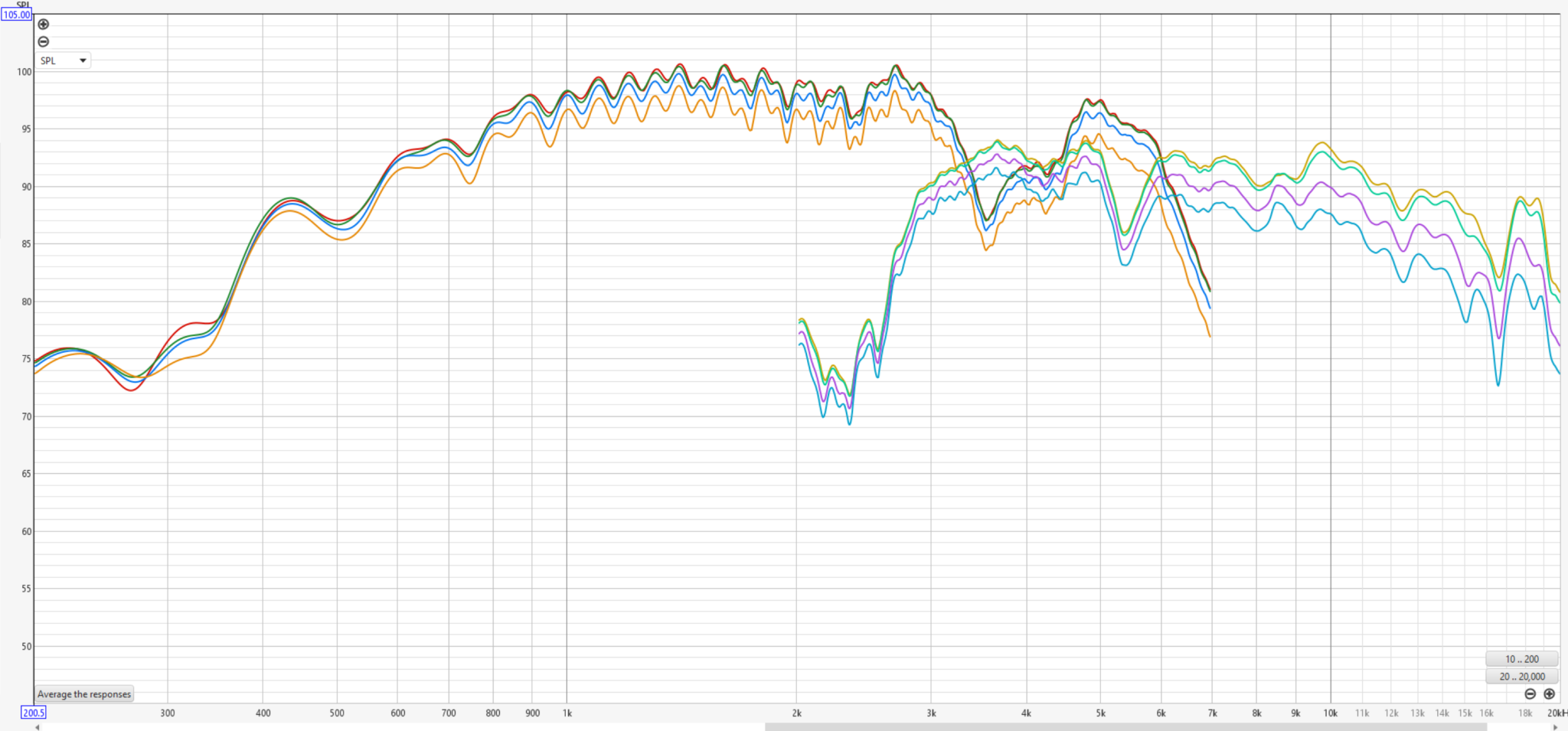

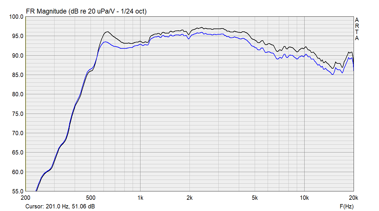

As requested by Marcel the windowed responses without FDW. We measured with the mic in front of a acoustic foam. It reflected more than expected....so please ignore the constant waviness. No smoothing; only gated 12ms.

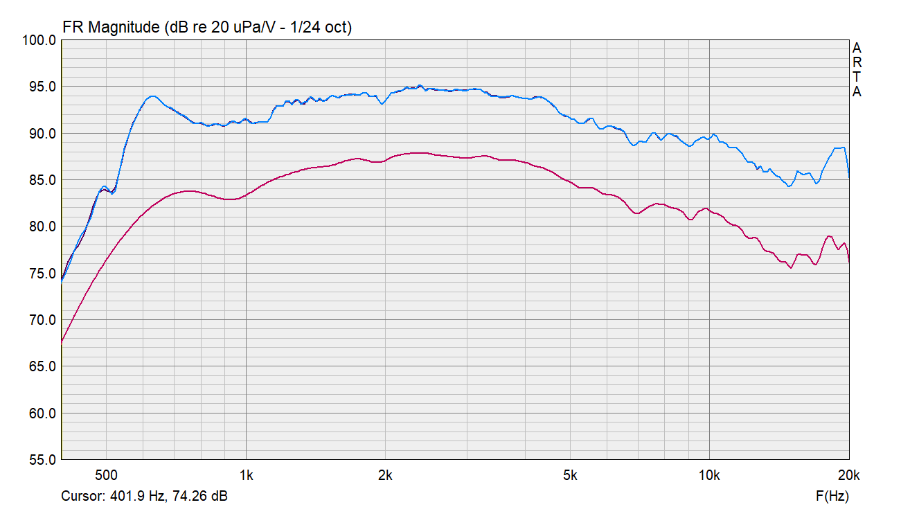

I tried the throat mic probe today, just a quick excercise to see what it does.
red = far-field response (4.5 ms)
blue = probe response (4.5 ms)
black = probe response (20 ms)
(red/blue levels are arbitrary)
I sure plan to spend more time with this (and will probably get rid of the needle to avoid a compensation),
but from the data I already have for the A460G2/4554, it seems to me that there's not much of early reflected sound from the mouth. At least I would think it would look differently. What's apparent though, is that the short 4.5 ms window is too short to fully describe the main resonance and I assume that this is the same for the far-field data. We really need to measure these devices in larger reflection-free spaces. Also the EQ must be done much more carefully to really compensate this resonance in its true shape.

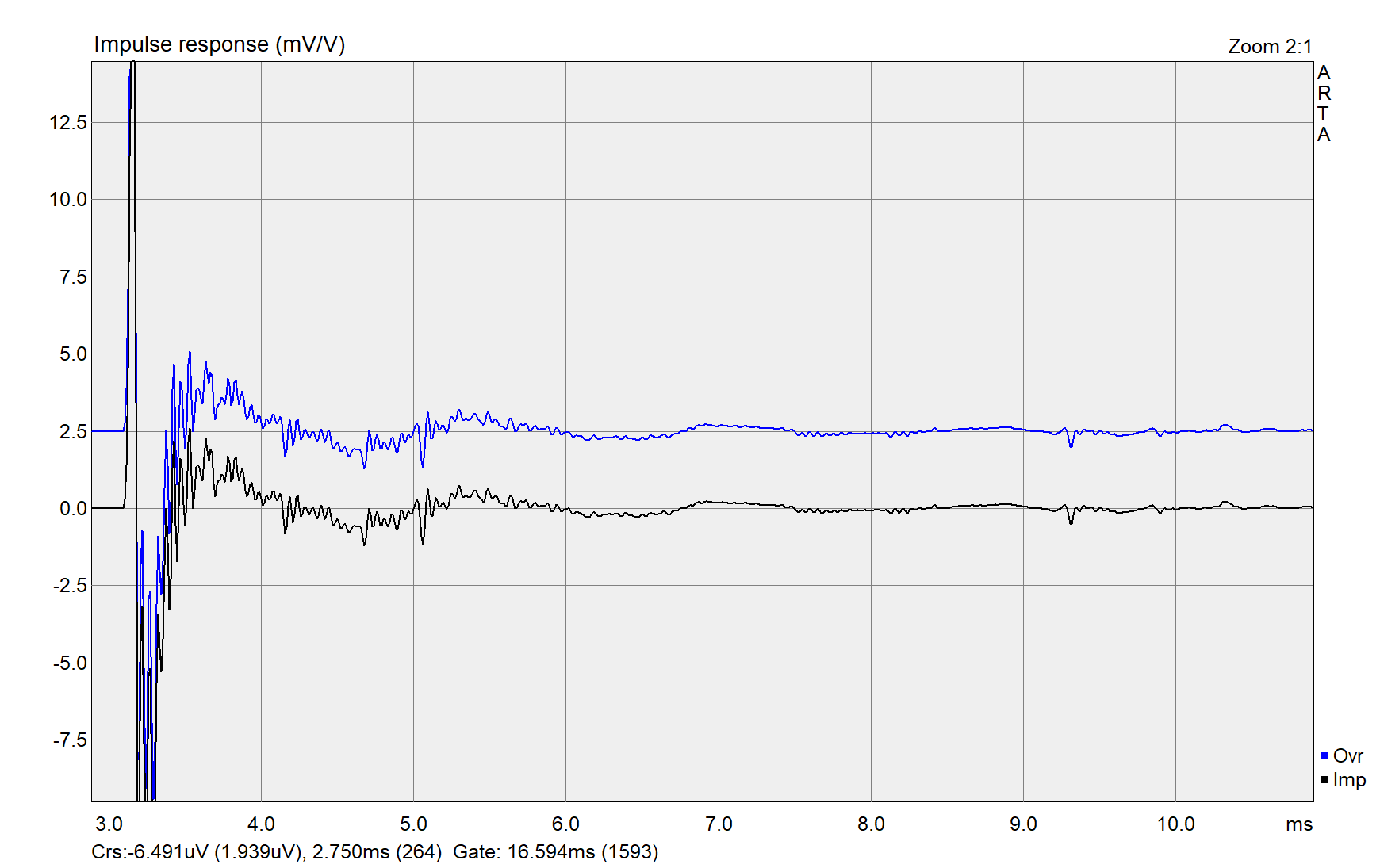

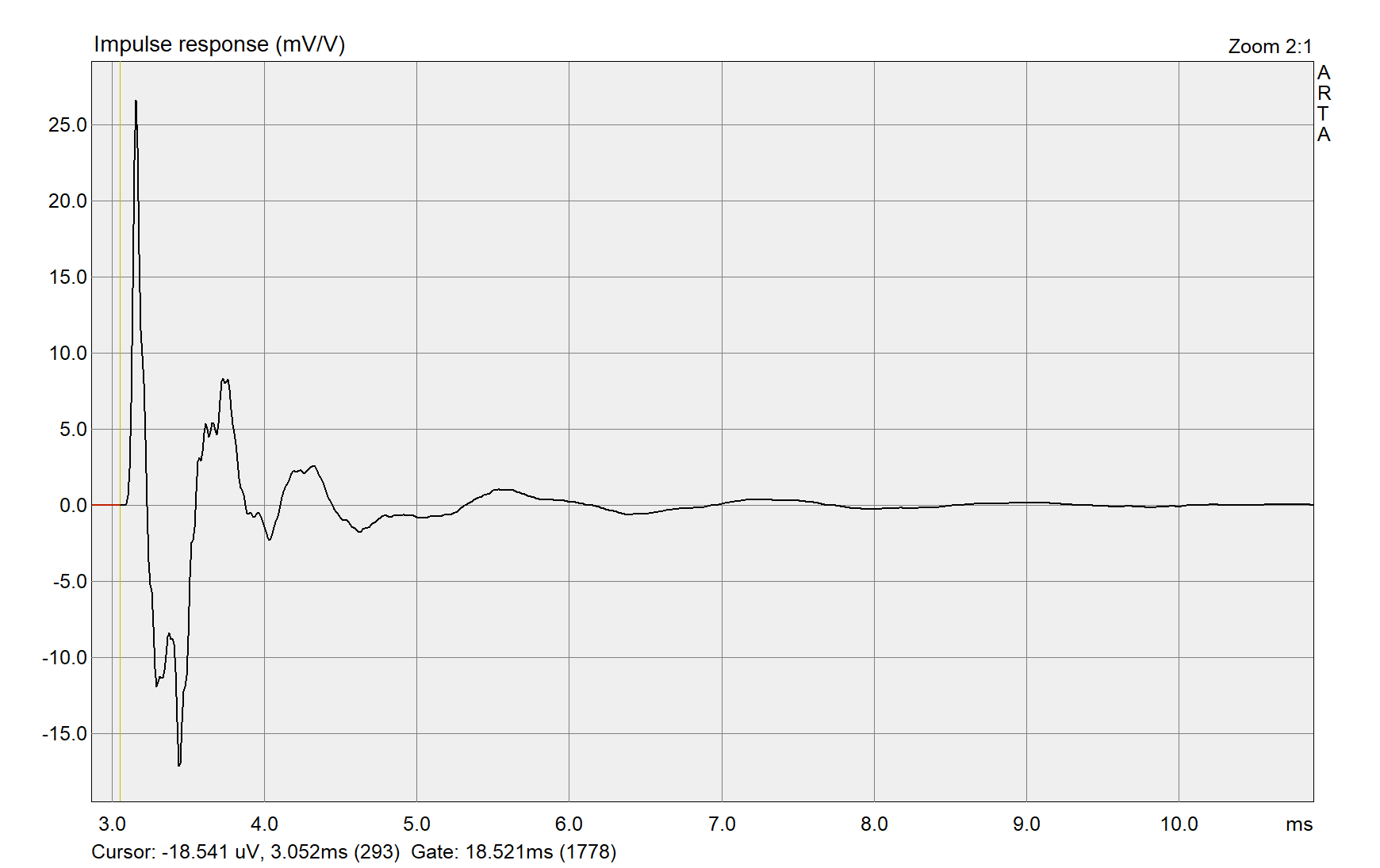

- This is the raw IR at the mic probe position (in the wall roughly 20 mm in front of the driver front face):

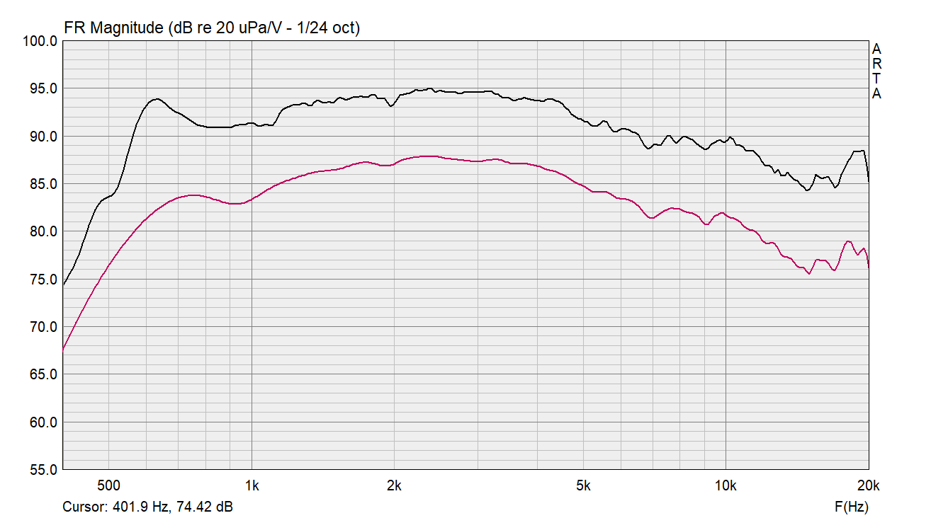

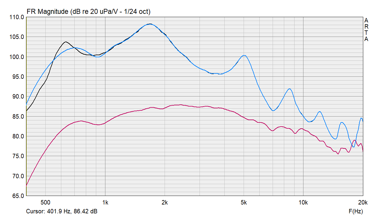

Here the black curve is the FR measured ~10cm from the mouth, 16 ms gate (red = 4.5 ms).
And it doesn't change further with a longer window, this is for 25 ms (blue):
Even more difficult than a good measuring technique is to know what one's actually searching for. For example on this scale, are we even trying to find the small wiggles from the far-field measurement?
The probe measures pressure at a single point. What if the wiggles only build up in a field? Just within the bandwidth of the wiggles is the biggest sound pressure, maybe it's "too much".
But iff it does not result in distortion, we shouldn't be bothered. Maybe this is asking too much, leave it to future generations 😎
Edit:
Edit:
Reveals a strong mode at ~ 620 HzHere the black curve is the FR measured ~10cm from the mouth, 16 ms gate (red = 4.5 ms).
The idea is to measure all the three G2 bodies I have at hand and search for possible differences that would correlate with the far-field differences. If there won't be any noticeable differences, the far-field differences will be just mouth related.Even more difficult than a good measuring technique is to know what one's actually searching for.
Sure, that's the fundamental resonance of the added throat extension.Reveals a strong mode at ~ 620 Hz

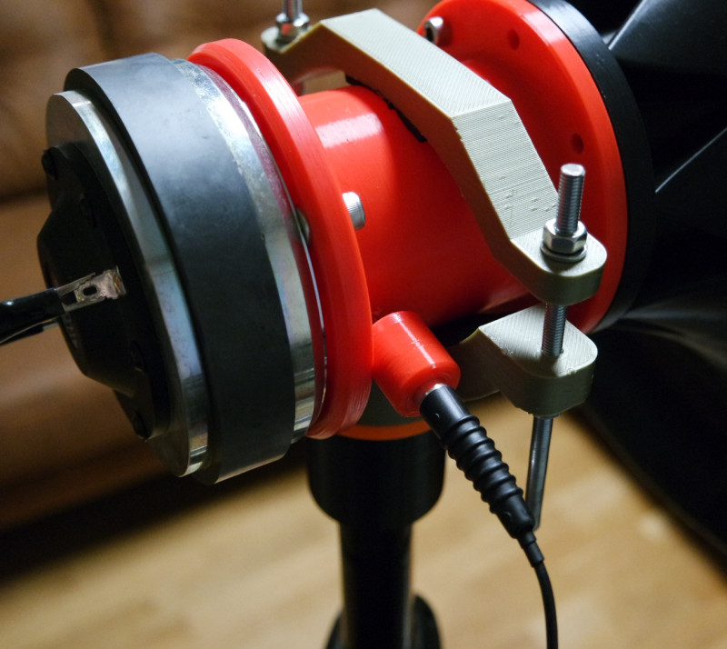

I don't know how all of your 3D printed devices sound when you just hande them, all of mine have crazy loud resonances, easy to trigger with any vibration anywhere in the structure like handling them in your hands.
I haven't ever seen such graph mabat just posted, the throat mic, so I speculate the frequency response peaks ~600, ~1600, ~5kHz, 8.5kHz ... are structural resonances.
I'm pretty sure that those are mostly resonances of the needle probe. I guess I need to print a special adapter with a mic directly in the wall. Anyway, it should be possible to compensate for this.so I speculate the frequency response peaks ~600, ~1600, ~5kHz, 8.5kHz ... are structural resonances.
I should have mentioned that the FRs measured anywhere outside the horn were taken with my regular mic, not the needle probe.
