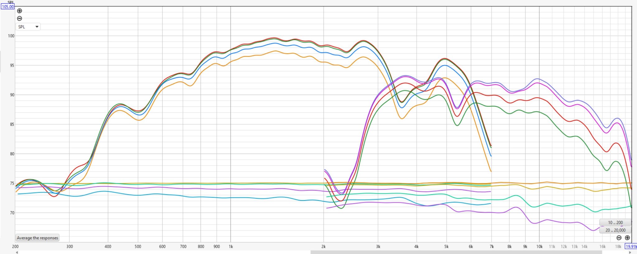

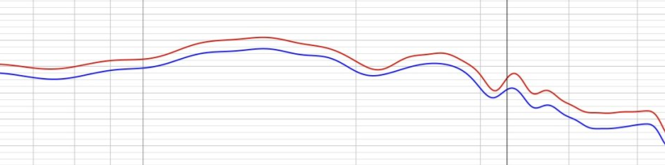

An other data point. NB its not an original mabat 520.. Same conditions as Naturlyd above.
80cm above floor, 15 degres, 30cm, 4ms, level cal. SB ROSSO. 300Hz 4th.

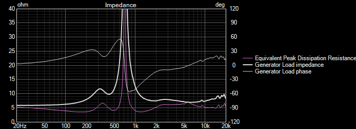

Here is a recording of the impedance of the JBL 2452SL driver in the A520 horn with and without 24.6 Ohms of series resistance. Measuring with DATS the overall level of the impedance varied from measurement to measurement on the bare driver. With series resistance it was very consistent. You can clearly se the various tones I used to exite the impedance measurement. I used the bass/mid driver in the cabinet underneath the horn as a source for the test tones while doing the impedance measurements.

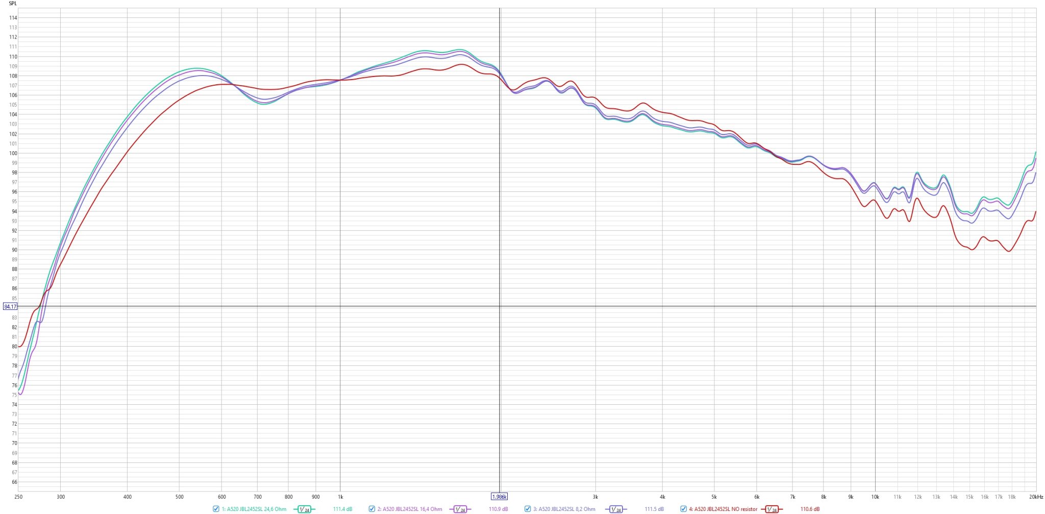

To check how the series resistance changed the frequency response I did some sweeps with 8.2, 16.4, 24.6 Ohms compared with the bare driver in the A520 horn. Using DSP its no problem to compensate.
How would one go about to establish if the horn/driver system is more immune to external influence with current drive? Will the distortion measurement in REW be accurate?
On the DATS measurements: the uppermost set of measurements were done with only 600Hz, 800Hz, 1000Hz, 1200Hz as well as none external exitement during testing. The other set of measurements without serial resistor includes several other frequencies of external noise.
That's a crazy difference for a non reactive component. What kind of resistor - wire wound? These wide band differences are easily detected by ear. I did this test also and measured distortion after introducing a resistor... I found out that one need to re EQ for every change before distortion measurement as things change so much.
This is simply a frequency-dependent voltage divider formed by the resistor and the driver impedance.

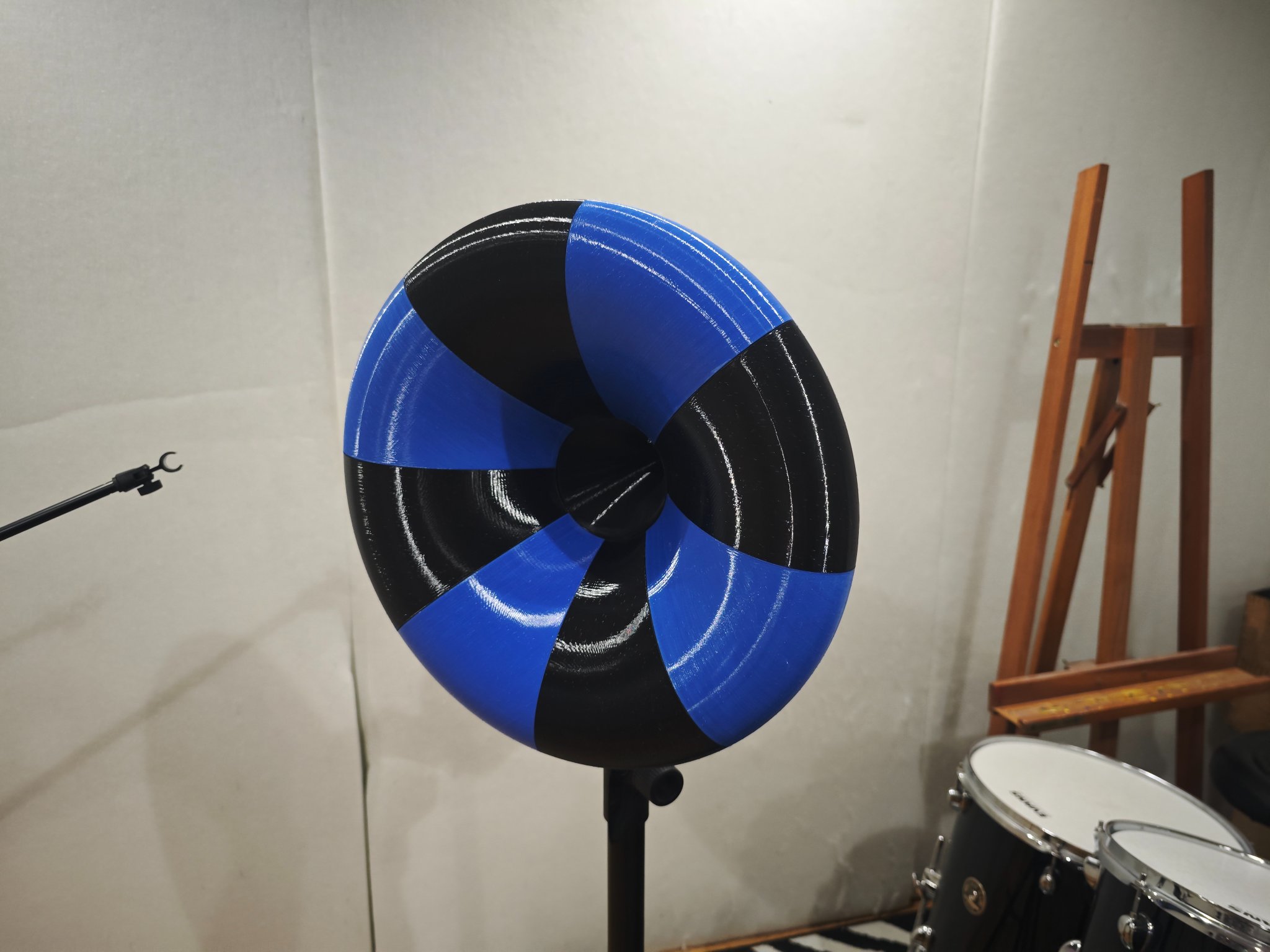

Anyway, to make at least a partial conclusion, I think it's clear that the 520 doesn't need any surface warping, as @Naturlyd showed in his measurements, which seem to be very clean. What's still not clear is the mechanism how the midrange "non-cleanesness" originate in the smaller horns. I'd be surprised if it were just my specimens.
Now I'm going to measure the acoustic response inside the same 4554 adapter with all three horns. The assumption is that the 520 should get the least amount of reflected sound back into the throat.

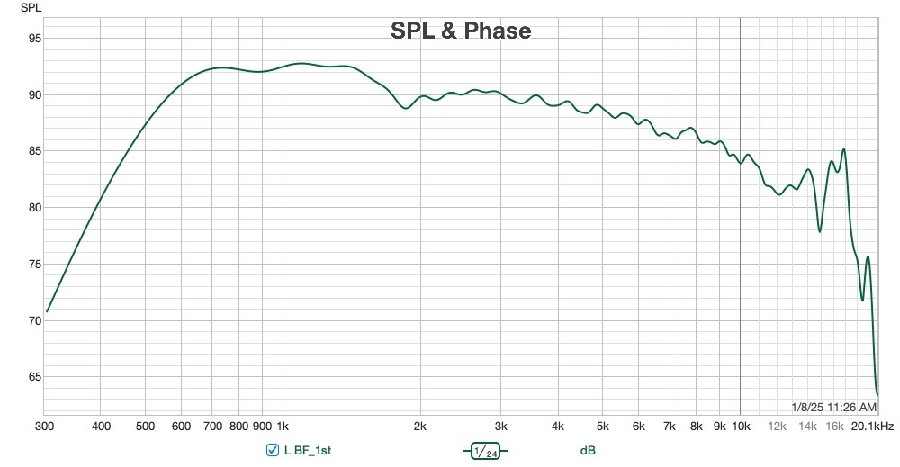

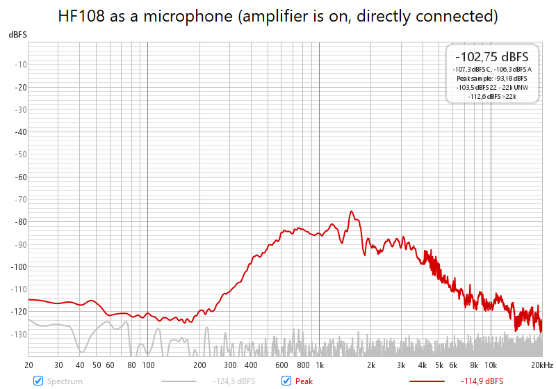

Recently there was a discussion about a driver picking up noise from the environment during the impedance measurements. I tested something similar with clapping and hissing close to the Faital HF108 (8 ohms) driver I use in my speakers.
In these measurements the driver is connected directly to a low noise amplifier (Topping B100, set to 0dB gain) and a microphone input of the Audioprobe Spartan A is connected in parallel to the faston connectors of the driver. The graphs are not calibrated, but the 0dBFS is about 1Vrms.

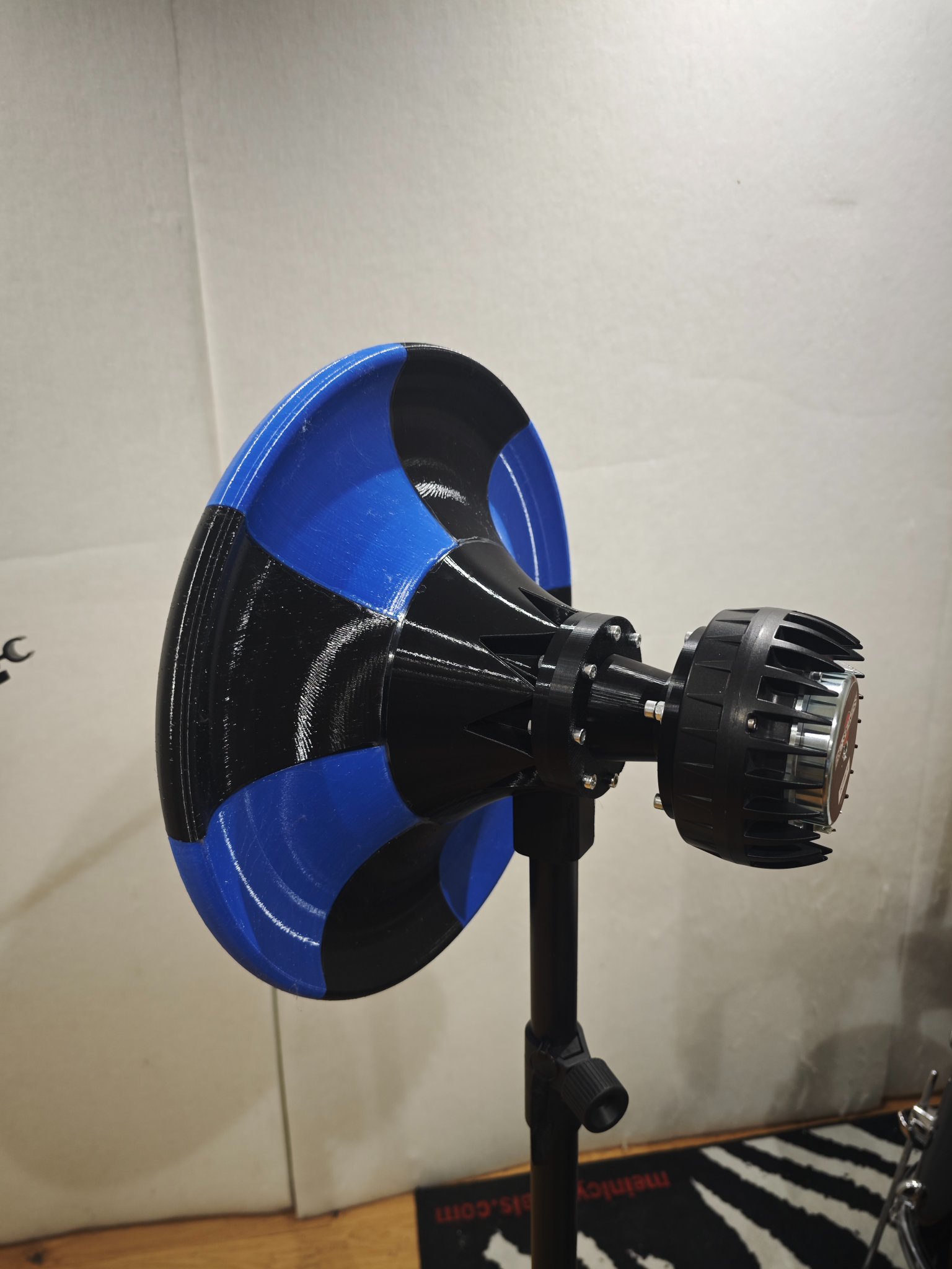

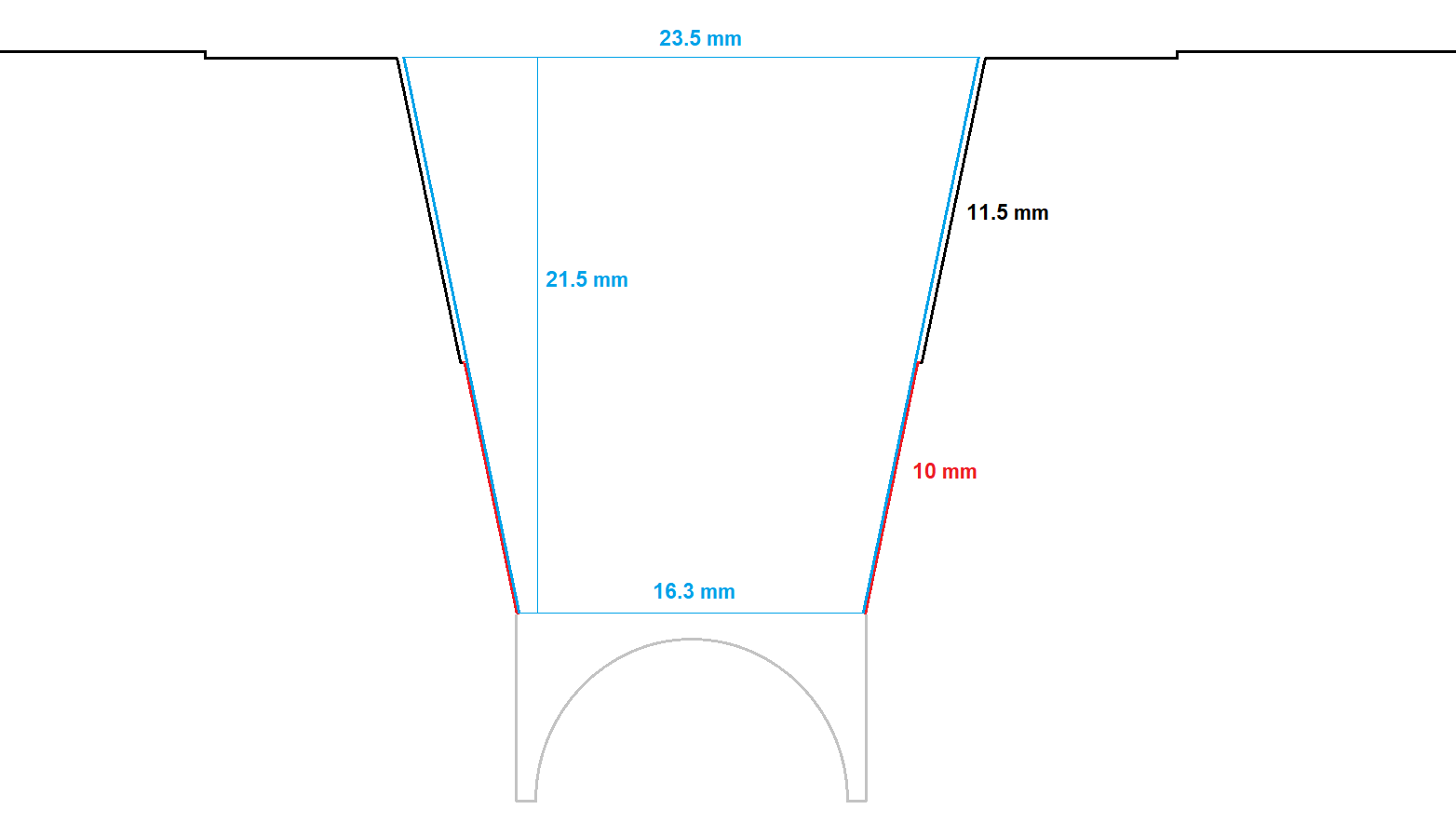

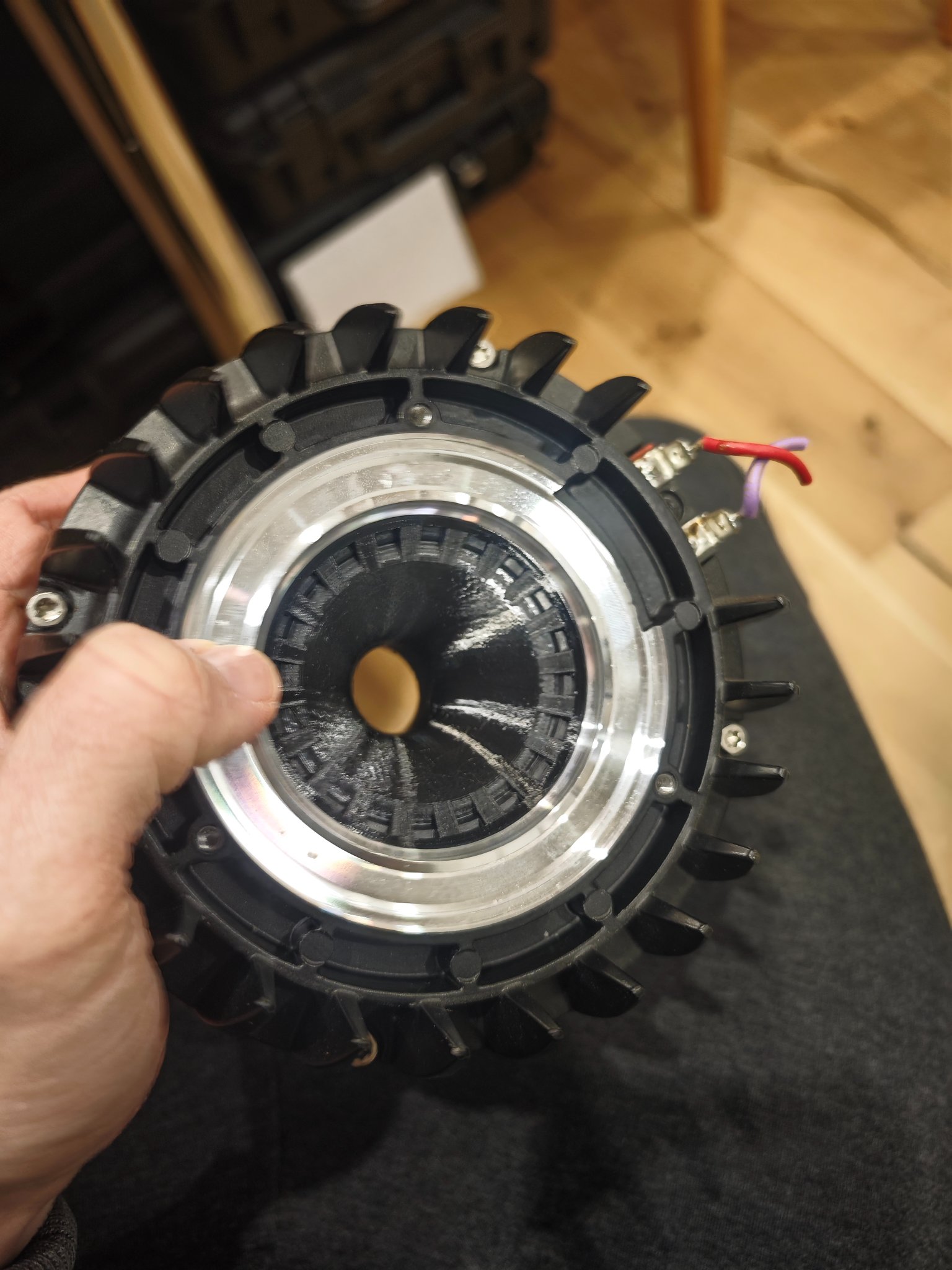

It took some time but finally I could measure the DCX 464 with modified internal geometry on a G2 460.

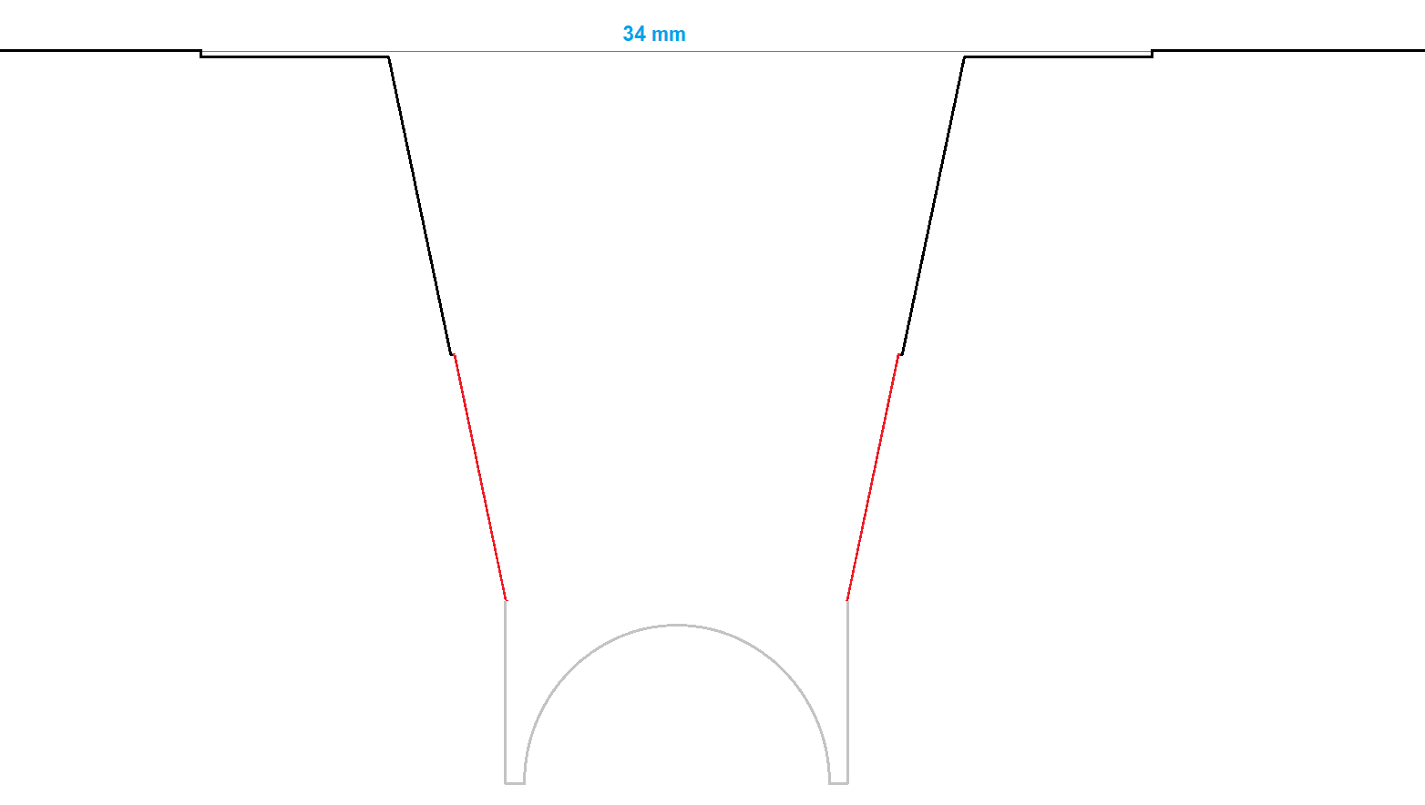

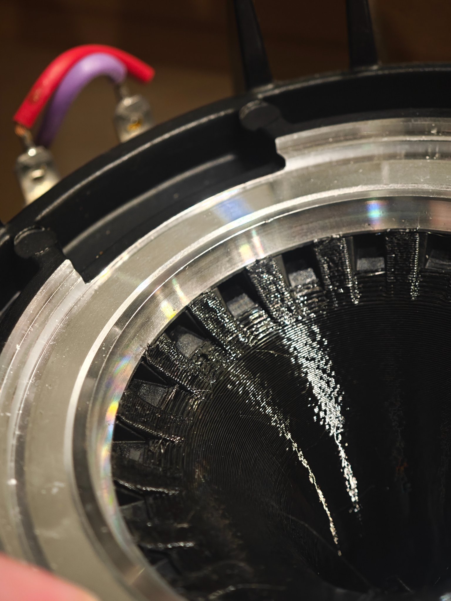

The new insert features Marcels BMS 4554 geometry starting right at the entrance of the midrange channels; a few mm below the HF diaphragm. Thank of the help from alex who overworked my 3D scans the first adapter was already 90% perfect. Some minor adjustments made the second attempt fit completely. The outside adapter has at its end the usual Gen 2 interface.
Black filament was out of stock so....something different 🙂
How does it perform?

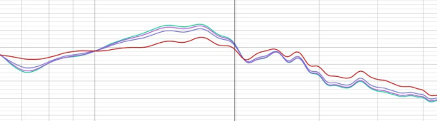

I attached the REW file for whoever wants to check the results more in detail.
I measured 0 / 10 / 20 / 30°
No smoothing applied.
12ms windowed with additional FDW 12 cycles
Accidently level at mic pre was changed between mid and high measurement. Please ignore absolute levels. All was at ~90db
So.....any comments on this?

- In the image below I tried to generate additional curves in relative values to the 0° measurement for better comparison.
- Waterfall, Decay, Spectrogram are all without issues
- This HF drop @5,4kHz is not visible in any way in distortion. I tried to measure 5,4kHz and raised loudness. There was no issues in distortion also on higher levels. This seems not to be a resonance and can in my opinion be EQed without issues
- I also measured at 105 and 117 db. There the measurement mic started distorting. I need to check why (maybe the preamp or levels).
