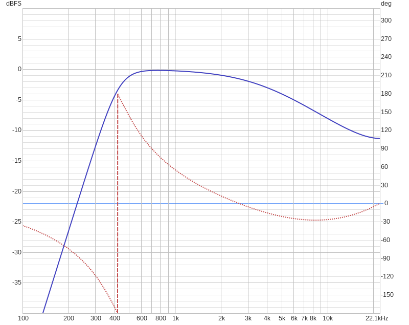

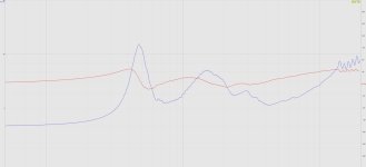

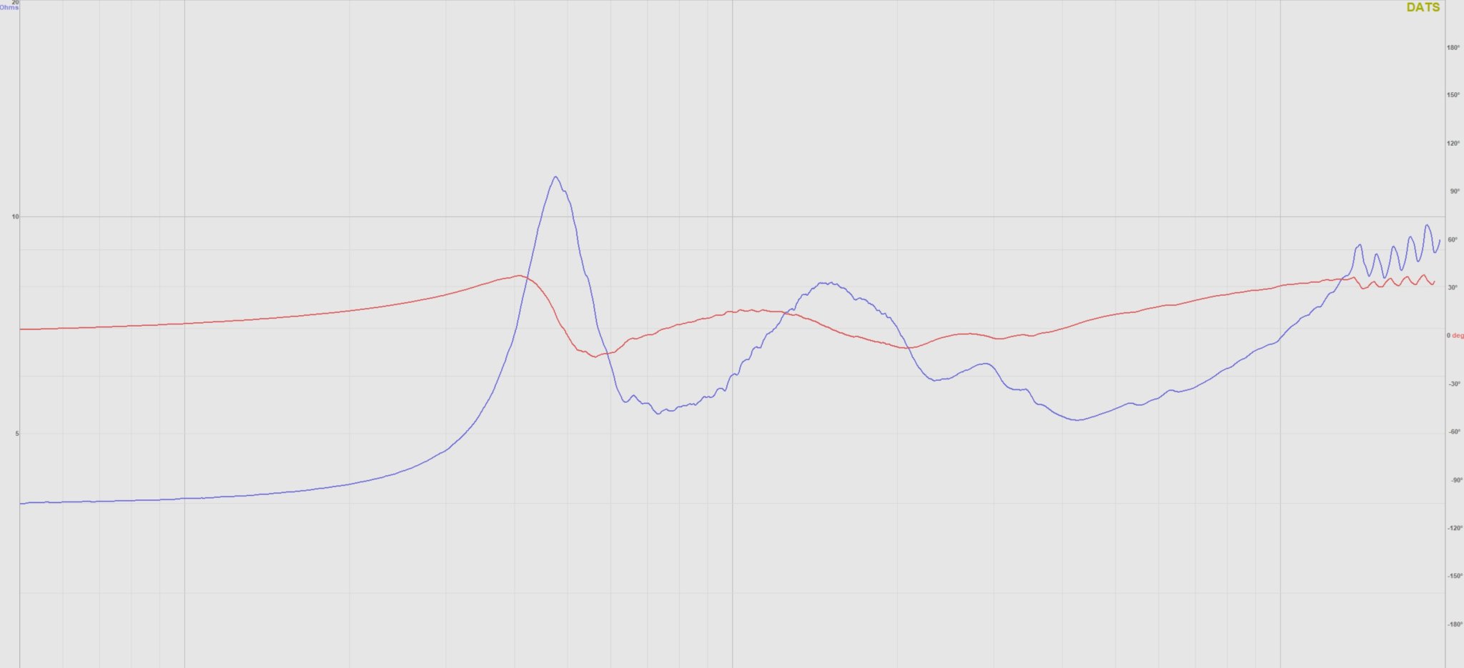

Impedance A520 horn with JBL2453 driver.

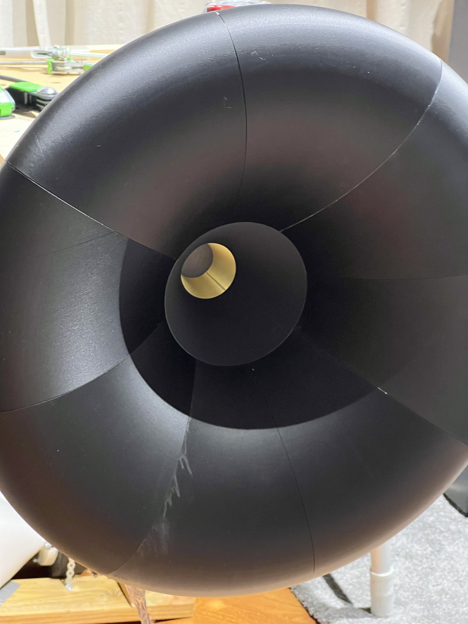

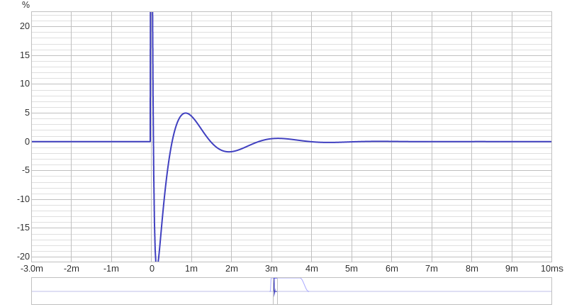

There are some imperfections from the assembly and the printing but overall quite good compared with most printed horns Ive seen online. The distortion graphs do not show any obvious problems but I would have preferred to be able to thighten the whole structure together a bit more.

Regarding electrical damping at the drivers resonance: I bet similar physics are at play as with a woofer, which can audibly ring at resonance if there was high impedance preventing electrical damping. Posted a fun test on another thread that describes ringing sound when no electrical damping 🙂

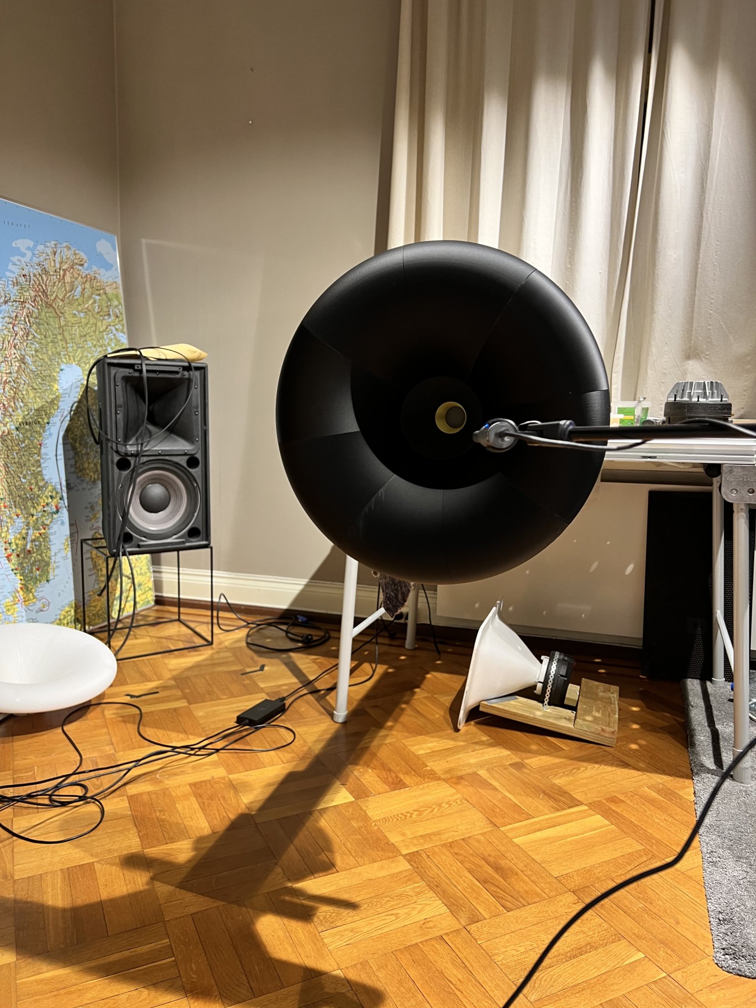

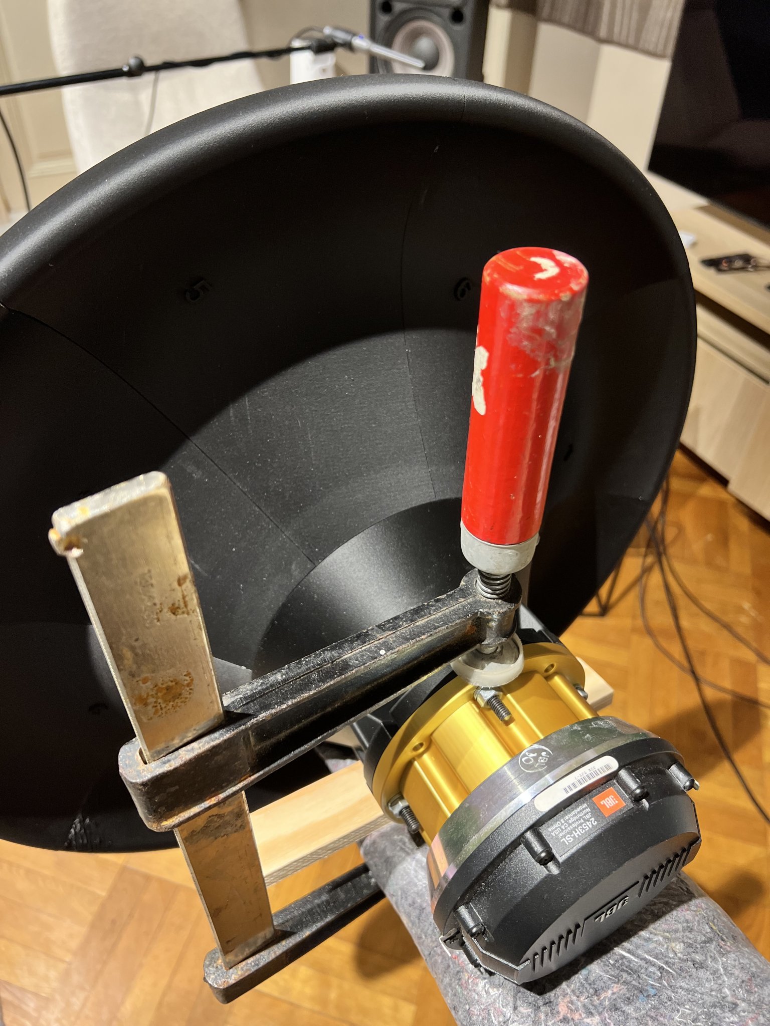

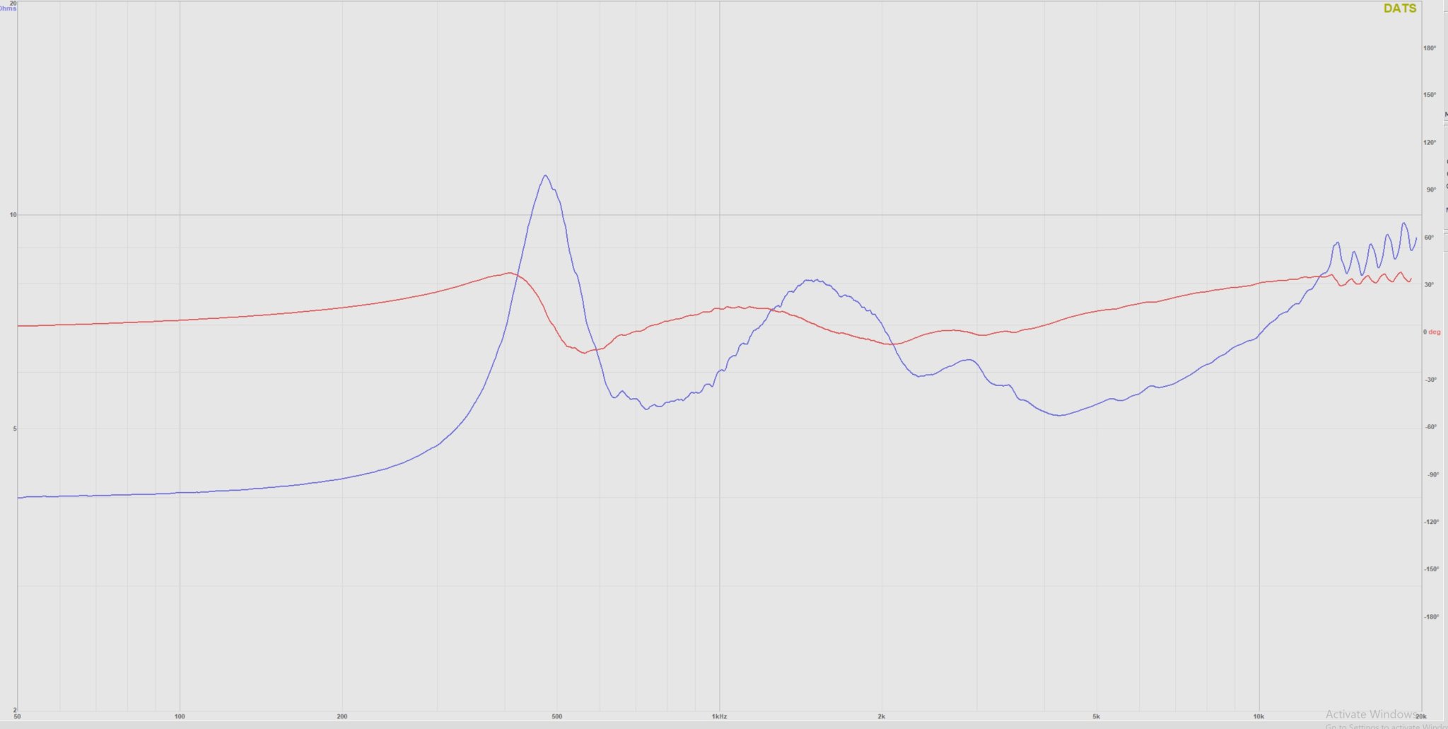

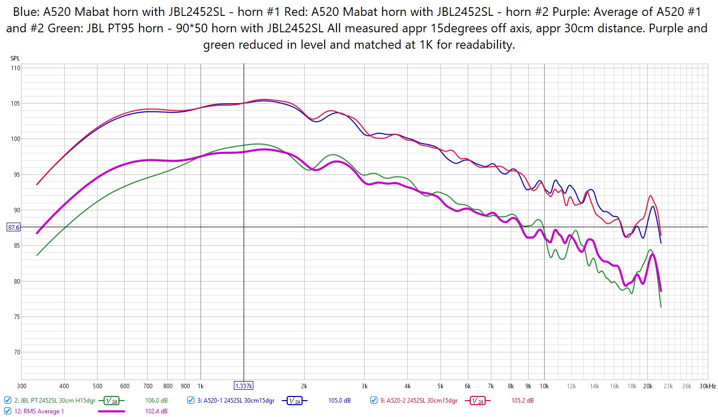

Borrowing the 2452SL compression drivers from a pair of JBL VP7212 I measured two of my A520 prototypes. Both used Mabats JBL2450 adapter which is a perfect (at least physically) fit. The measurement where taken with the middle of the horn at 90cm above the floor. There is a picture of the setup in an earlier post. Gating at 4ms, 24dB smoothing. I also screwed out one of the JBL PT waveguides to compare. Worth noting that the JBL waveguides are not designed for free standing operation.

If "horn loading" means a high acoustic damping (even dominant over the electrical one (?)), then this damping has an obvious problem of not being constant. The degree to which this has an effect on radiated sound and its subjective perception is still not clear to me.
I think it's low damping the higher the electrical impedance is spiking above Re and Le, the diaphragm moves more easily "than expected". Basing on the current-drive article I linked earlier I think the electrical damping would function only when force affecting the diaphragm turns directly into velocity, iow when spring cancels the moving mass. This happens at least at the system resonance. If the mass is cancelled also by the acoustic loading I guess electrical damping would dampen that as well. On a quick think the acoustic loading likely affects the spring and not mass though? I've not dug into this acoustic loading thing yet to fully understand how it plays out.
So I think the electrical impedance peaks show where the diaphragm likes to resonate, but doesn't necessarily mean electrical damping does anything to it, except at and around the main resonance frequency for sure. The high acoustic loading bandwidth could resonate due to external excitation, perhaps enough making some distinct sound signature, like boomy drum sound in my drumming test with a woofer.
While this is speculation, it would be a fun test for sure to try and find out whether it matters or not. Since throat adapters manipulate the loading without much effect in directivity, I think this is relatively easy listening test to figure out whether there is audible trade-off with the loading (a resonance due to external excitation that makes audible sound signature), with or without electrical damping using high pass cap and compensating frequency response with DSP. It seems plausible, since external sounds show up in the electrical impedance plot meaning they affect the diaphragm, and reasoning from high electrical impedance due to acoustic loading further indicating the diaphragm moves quite easily, which might make distinct audible sound like woofer drumming test indicates could happen.
