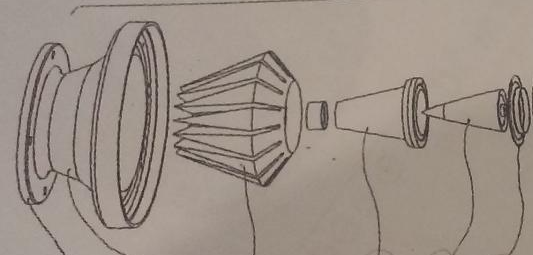

"negative expansion" - I doubt a bit that the area would actually decrease. I found a drawing here - is it this?
View attachment 1395335 View attachment 1395340
It's hard to tell what the wavefront area expansion is. One could at least calculate the total area of the input and the output quite easily. Maybe it's a linear change in between then (in this case), I'm not sure.
Yes, that drawing looks right. And everything considered it's probably not negative now I see. Although how to calculate!

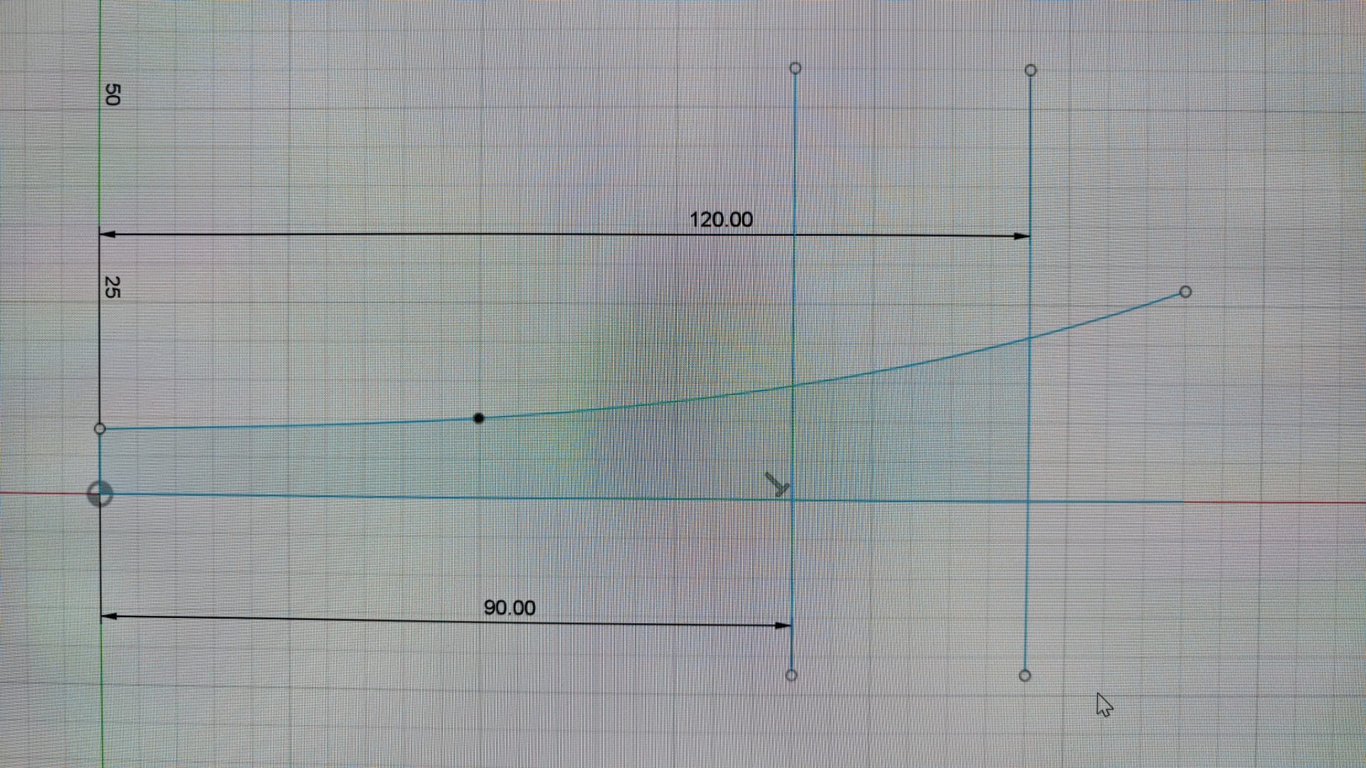

I checked before for xo 700hz based on your adapter. You see....not much expansion there. Ignore the 90mm..
You mean little expansion at 120mm length?
In post #16270 I've sketched a 2:1 combiner for the 5530ND, without expansion because that just easy to draw by hand. The extension length outside of the driver was 67.048mm. Expansion could start after that.
