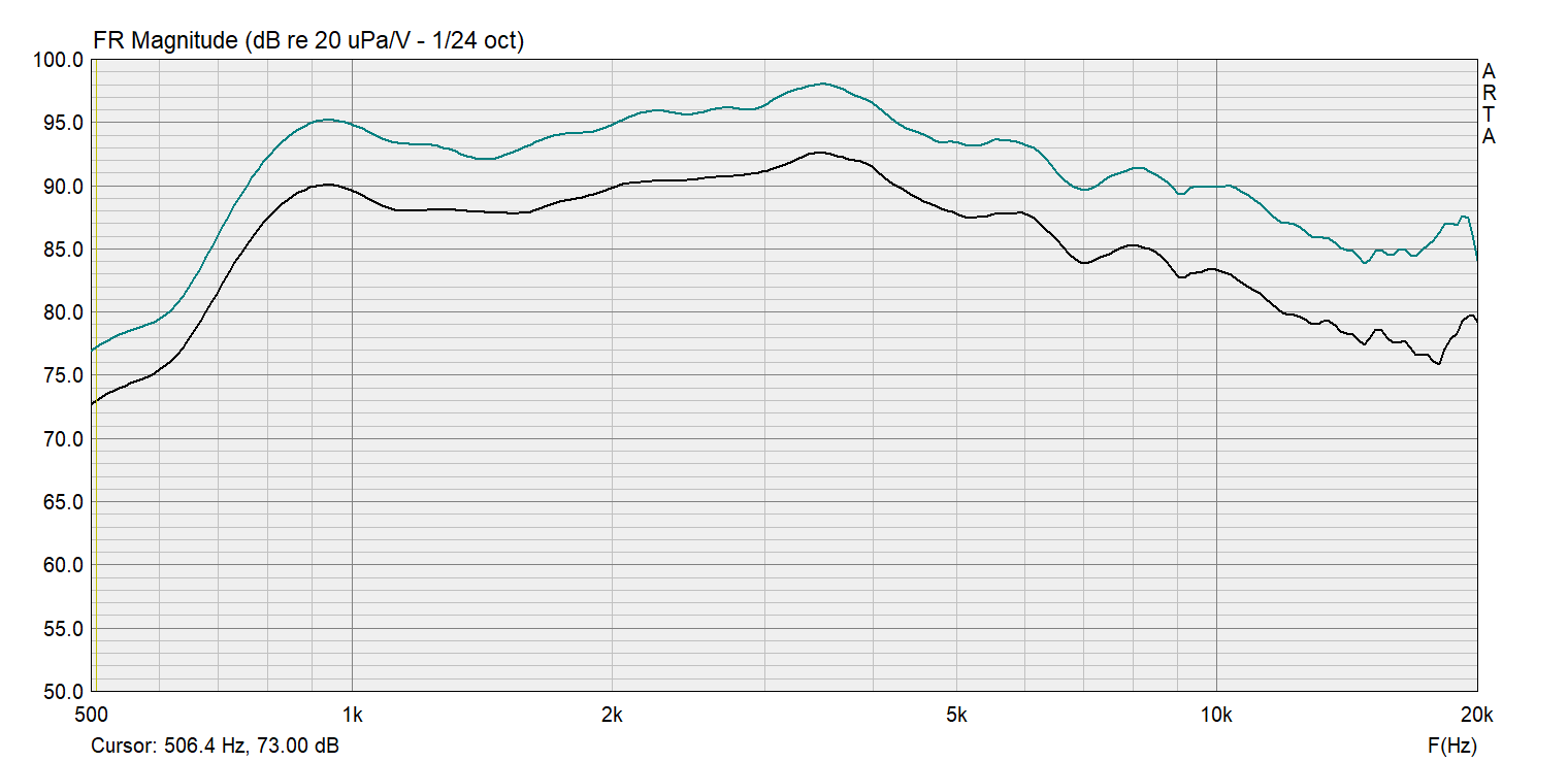

This is the 4550 on another waveguide. The angles are 0, 15, 30, 45, 60, 75, and 90 degrees. As you can see, the peak just below 20 kHz is most pronounced on-axis, and it's gone when you move beyond 30 degrees. Therefore, I presume you didn't measure your 5530 precisely on-axis.

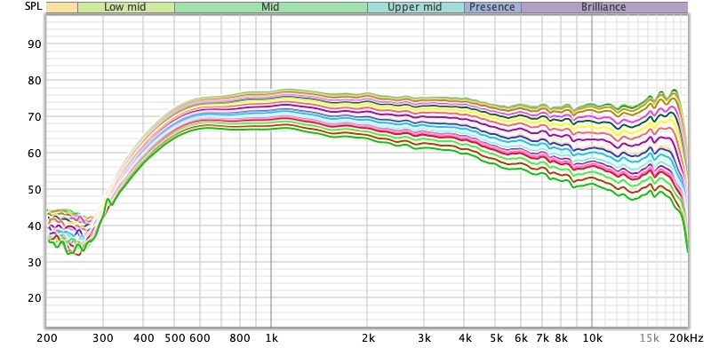

In my case it was measured at the center of the horn mouth. The measurement was definitely very close to on-axis. At most +-5 degrees off (and even that I find doubtful). The result was also consistent across multiple measurements at multiple distances after readjusting the microphone. Measured vs simulated results of the waveguide in question (note that the waveguide measurements only go to 80 degrees):
Measurement distance for the waveguide is a bit too short also, which is likely where the low frequency discrepancy comes from, other than the noise.
You can see how there isn't any particular off-axis angle where the off-axis is louder than the on-axis, which would indicate an issue with centering the waveguide/microphone. There is a slight on-axis dip as evidenced by the slight widening in the top octave, but nothing that could account for ~5dB of difference. This measurement was done with a 16.4mm throat piece, which is cylindrical for about 15mm of length before quickly expanding.

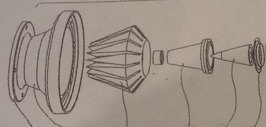

I tested them with a negative angle conical adapter to 35mm and thought they sounded as good as it gets. I'm sure Mabat could work out the ideal throat extension - unusually, the phase plug comes right out to the mouth, inside a negative expansion. Sadly I can't find the plots right now - if anyone is interested I could make them again at some point. They go to about 12k. I would have continued with this approach but the complication of adding a super tweeter (which only contributes a tiny bit) put me off. Eventually I found that the generic paper cone piezo sounded really good, but only with a very steep very highpass filter necessitating an extra dsp channel.
Reactions: isitone
[...] unusually, the phase plug comes right out to the mouth, inside a negative expansion.
"negative expansion" - I doubt a bit that the area would actually decrease. I found a drawing here - is it this?
It's hard to tell what the wavefront area expansion is. One could at least calculate the total area of the input and the output quite easily. Maybe it's a linear change in between then (in this case), I'm not sure.
Looking in more depth at the DCM50 (which is apparently the DCX50 without the central coaxial HF channel), it may be possible to reduce the throat somewhat (which would benefit the dispersion) - the missing central piece should allow a more gradual area change, to some extent, IMO. As it is now, it's not quite pretty.

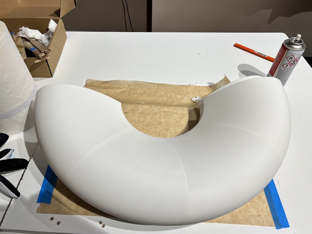

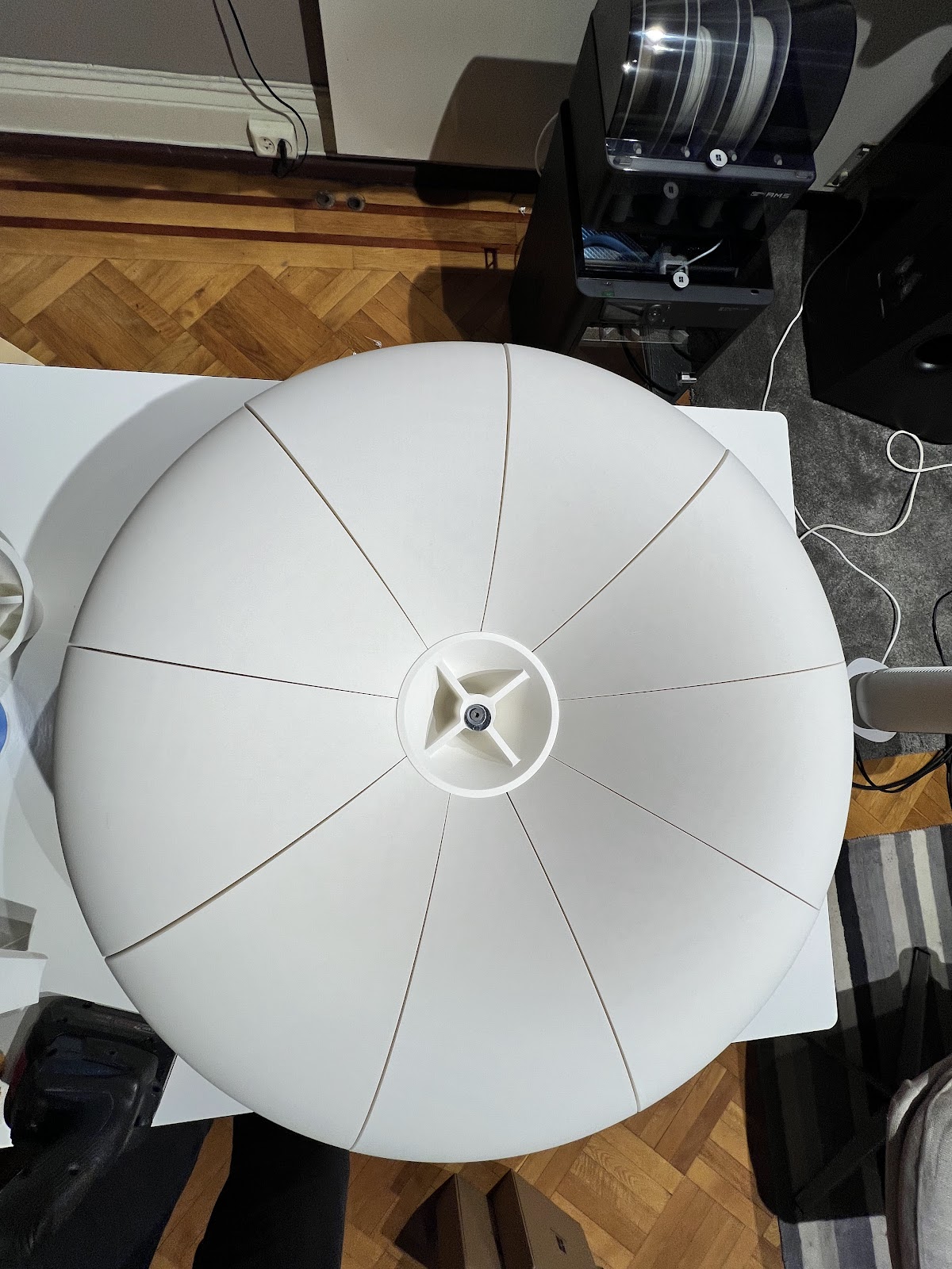

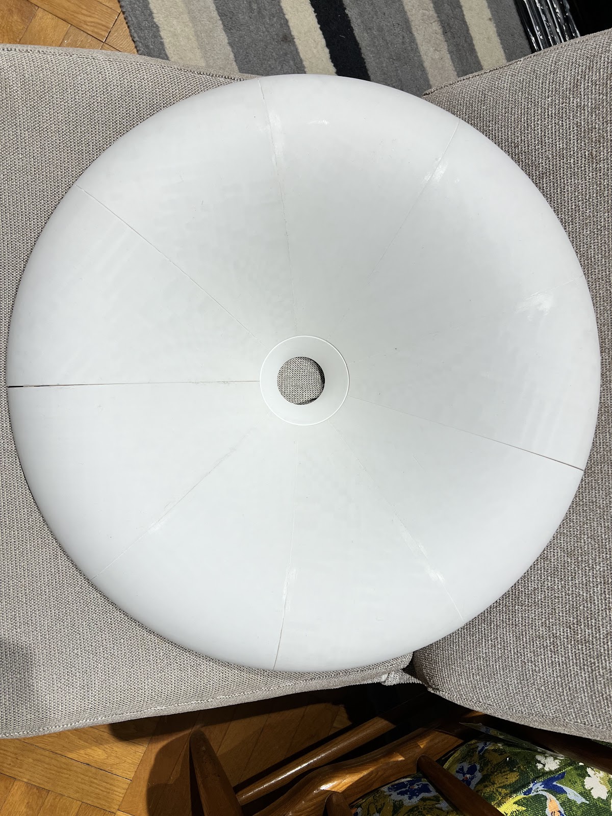

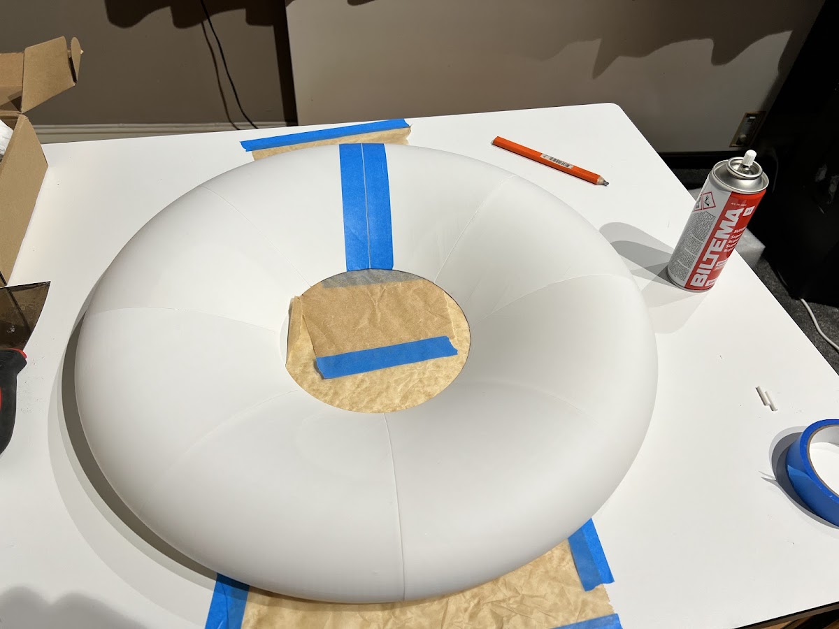

@mabat : A question regarding the assembly of the A520G2, did you leave/cut some space for adhesives in between the petals and the base in the pre cut stl? If so, how much?
I tried using the supplied jig but gave up. Is it supposed to make the petals line up perfectly and press them together? I did have less than perfect dimensional accuracy on the first few prints, too much infill seems to make the petals less accurate. Printed all the jig variants and even tried printing a tighter one. Still too much slip/sloppiness, the petals not being tightened towards each other.
I then assembled one A520G2 without the jig using a small string of Tec7 construction adhesive around and close to the perimeter of the side of one petal and then 4-5 blobs of superglue in the middle. Then I sprayed activator on the other petal and squeezed them together. Sticks in 1 second and the Tec7 fills the gap nicely. Made 1 part with 5 petals and 1 with 4. Those were connected first on one side with the same method. I was able to insert a wedge between the last two surfaces to glue. With approx 1 cm opening I tried using Tec7, superglue and activator but it takes some practice as the superglue will harden the very moment you apply activator. If I use the same method again I will use clamps and ordinary superglue for the last glue job.
I appreciate that you supply an uncut version of the horn so that we may cut and slice our own varieties. The last experiment was cutting the A520G2 into 8 petals, no room in between the petals and with dowels to steer the glue job. Its slightly scary using superglue and activator so having perfect guiding is a bless. This worked out well as the pictures will tell. The last joint is still a challenge tough.
The jig doesn't have the ability to press the petals together. It "fixes" their basic position but a tape used as shown is still a must. I only hope you kept the locks on the petal sides. Those, together with the tape(s) and the jig should ease the assemebly as much as possible. There's some fraction of a millimeter left for the glue for the base-petals joint, I would need to check.
This is probably the cleanest build I've seen so far, BTW. 👍

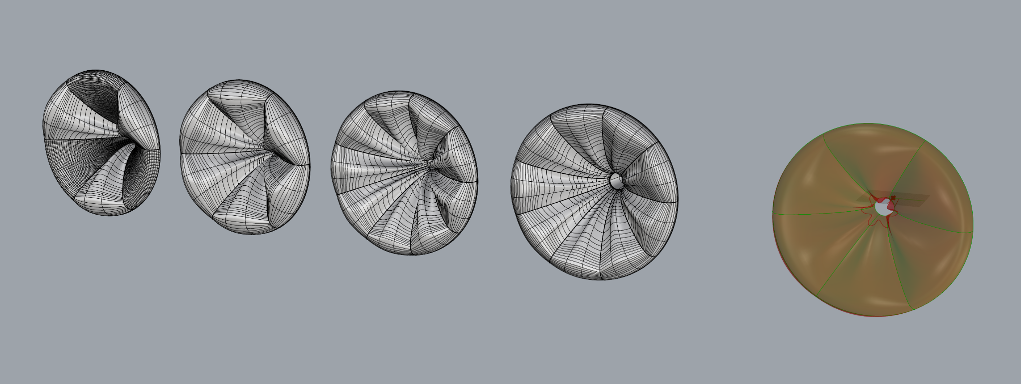

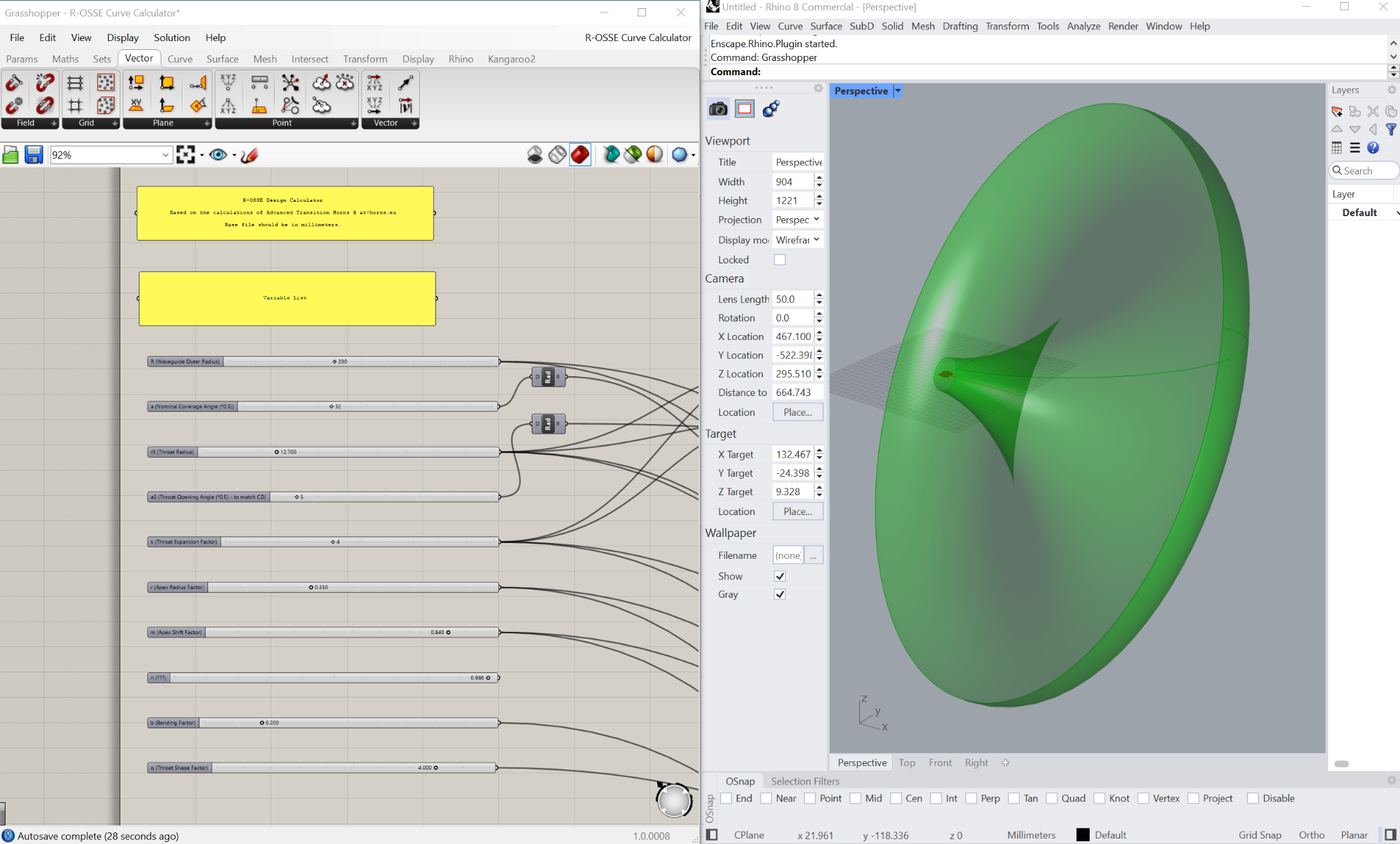

Here's another image that I quickly whipped up that shows the horn being subdivided into different segments, with the segments being able to be pleated or shaped (if that's a good thing or not I literally have no idea - its just geometry to me). In any case, it allows for super fast iteration and testing, which is exciting.
