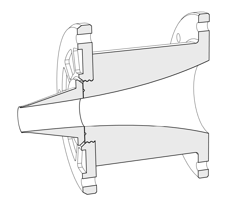

I'm interested in a version for the 5530ND if you can make one. Do you need some measurements?
The electrical impedances published in datasheets are the last thing I would make any conclusions on, as those are often unbelievably worse than in a good horn. Sometimes I wonder how can they even achieve such bad curves...
Sure, you can try to measure the dimensions. Seldom it then really fits on the first try, but that can be iterated, at least we can try.

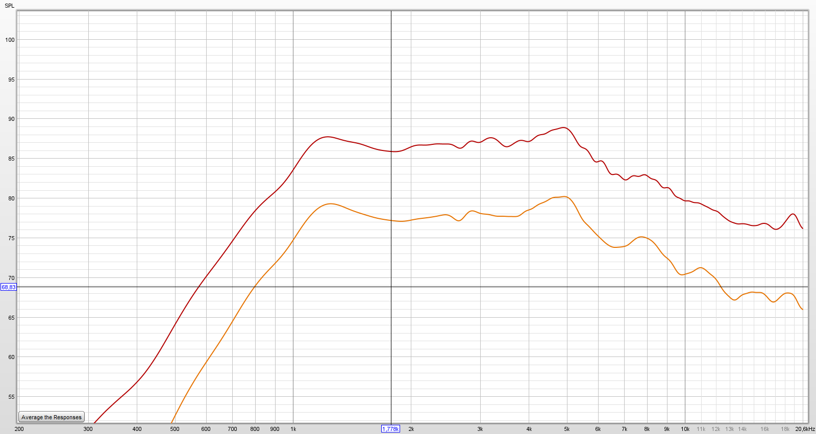

Regarding the 5530ND, here are some frequency response curves measured on a flat DI 340mm waveguide:
Neither of these have a perfectly smooth throat, but the red one is with a somewhat smoother one. The orange is measured with a 25mm cylindrical exit from the driver's phase plug, and therefore less smooth. Smoothing 1/12th octave. I'd show with less smoothing, but didn't save these measurements (rest assured that nothing big is hiding in the smoothing). The only strange thing is the small dip at roughly 2.6kHz. It seems to be inherent to the driver somehow, as it has been present in every waveguide I have measured it on. Overall it really is a superbly smooth driver though.

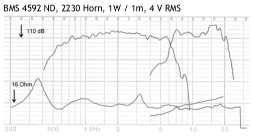

The other coaxial CDs (drivers with separate mids capable of large displacement to really push for 300Hz?) on the market are the ones from BMS: 4591 and 4592.
The 4591 is a single diaphragm mid-range river, rolls off ~18dB per octave at 6kHz.
Like the 1.4" and 1.5" coax, the BMS 4592 HF drops off steeply below 7kHz, requiring the mid high crossover point to be very close to 6kHz.

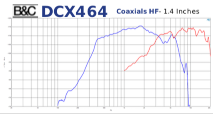

The B&C 464 HF plays an octave lower, and it's roll off is ~12dB per octave, much more latitude in crossover placement is possible.

The extra bandwidth of the B&C DCX 464 HF allows the mid to be limited to a decade (400-4kHz) of operation, reducing intermodulation distortion that accompanies high diaphragm excursions required when running so low.
Limiting the BMS midrange to a decade of operation would put it in the 600-6kHz range.

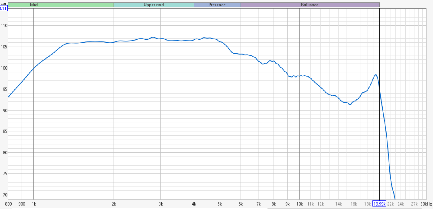

This is the 5530 on an ATH waveguide, 5.5 ms window, no smoothing.

Interesting that the high frequency peak shown in BMS' datasheet is also so clearly present in your measurements. Even in my unsmoothed measurements I only see a ~2dB peak. Mabat's measurements of his BMS driver shows something similar. I wonder where the discrepancy comes from?

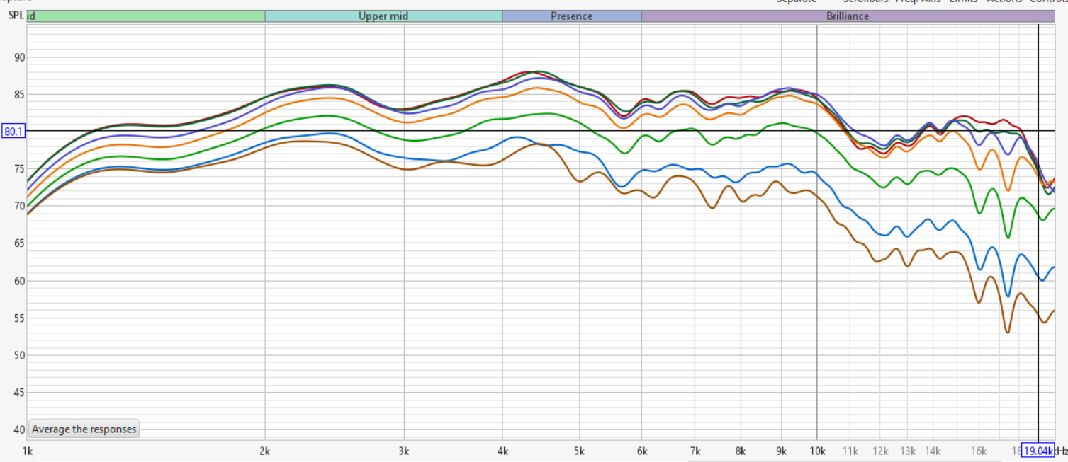

This is the 4550 on another waveguide. The angles are 0, 15, 30, 45, 60, 75, and 90 degrees. As you can see, the peak just below 20 kHz is most pronounced on-axis, and it's gone when you move beyond 30 degrees. Therefore, I presume you didn't measure your 5530 precisely on-axis.
Constant-directivity horns commonly behave like this - it's mainly a directivity issue. You can see it clearly in a simulation, for a 1" throat this starts around 15 kHz. It's also a sign that the actual wavefront is clean, as it behaves exactly accoring to the model.
Gen2 horns are (intentionally) not CD and this region is then a lot smoother, directivity wise. Balancing act, I guess.
If you have a flat-DI waveguide, you should find the same when looked closely, IMO.
Yes, in the simulations you do see that sudden increase in directivity in around 15k for a 1" throat, but I think the peak in response around 19k that the BMS drivers have, is designed to be there. It's a controlled resonance to help extend the CD's response to 20 kHz.

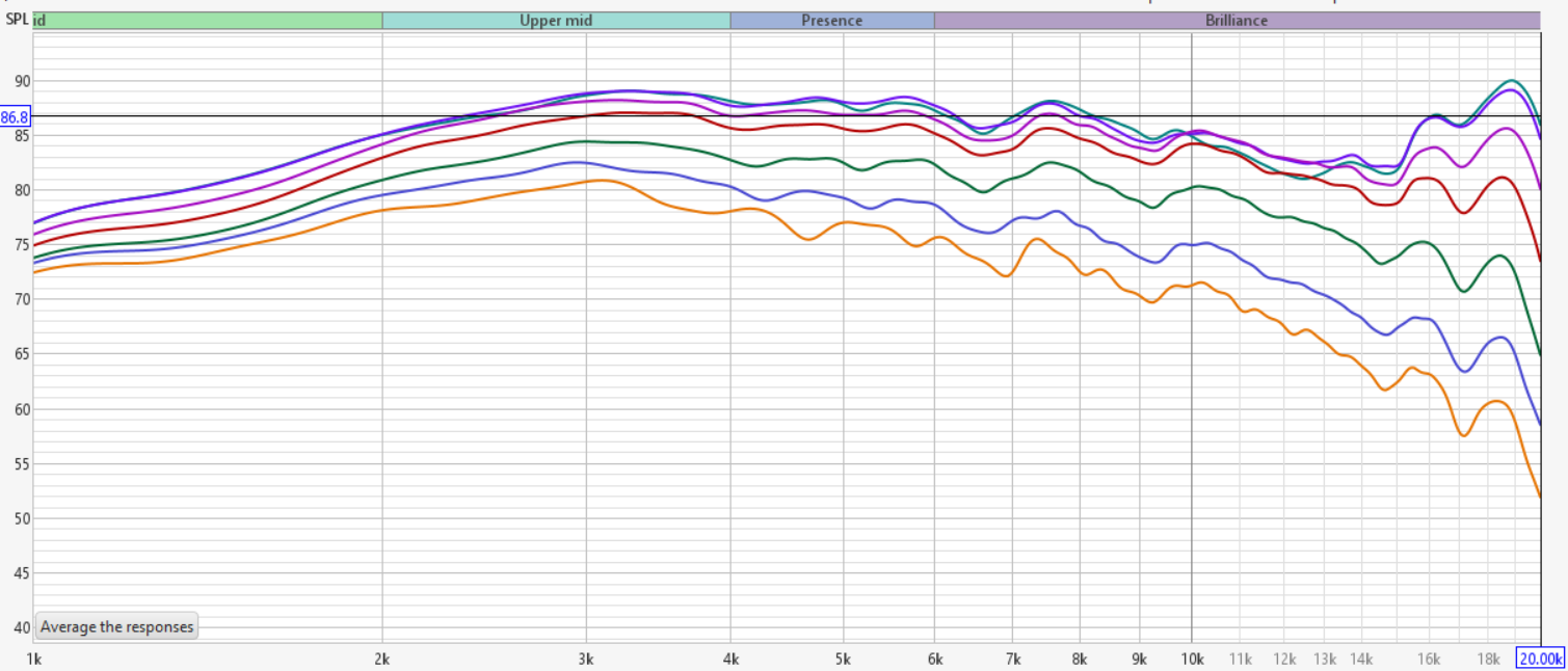

For reference, below is a 1" Beyma 171 on the same waveguide as the 4550. Quite different behavior in the top octave.
The difference in directivity can be only due to a different wavefront "shape". BMS is simply closer to the prediction for an idealized wavefront. It can also have an intentional resonance in that region, that doesn't go against each other. In an ideal case, the on-axis SPL increase happens even without any resonance though, and corresponds to the large increase of directivity. You can see this behaviour in a simulation for a constant-acceleration source, without normalization.
