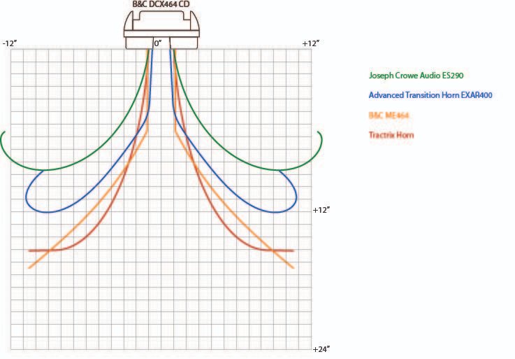

Where I quickly fall apart is trying to determine what exactly the geometry of the actual horn/waveguide should be. I have read a lot of different opinions, but realistically what I'm looking for is good sound that works on a relatively wide dispersion - it doesn't have to be the same EVERYWHERE, but I'd like to avoid a full-range pin-point sweet spot if at all possible.
I've been looking at a lot of other precedents for contemporary horn drivers, including the Oblate Spheroid waveguide, Joseph Crowes ES290 horn, the Advance Transition Horn EXAR (I purchased the 3d files yesterday just to get the curves and geometry), and tractrix horns in order to try to find some commonality between all of them in the design. I have drawn all these in CAD and plotted them for comparison.
I'm also curious about the "pleats" in the X-Shape waveguide (mostly because I could fabricate and think it looks cool) - but don't really understand what it is doing acoustically. https://audiohorn.net/x-shape-horn/
Attached is the curve plot comparison, as well as a couple of early renderings of what I think the cabinet would generally look like. I was looking at the Faital Pro FR400 for the lower end. I'd be doing an active system with maybe a passive crossover for the compression driver. I'm looking for opinions - about horn design, general thoughts on the speaker design, etc. Thank you!

I think @Olombo made some experiments with the DCX464 in an ATH horn already. Can't recall seeing any other measurements. Scaling the EXAR400 for a 1.4" throat is certainly an option (that's what @olegtern did), although I'm not sure it's the best choice here, as you shouldn't need any LF boost with the coax. My bet would be an A520G2/36-STD-1 - that's what I would try first if I had to use that driver 🙂. Midrange clarity should be exceptional. I'm still not sure about the high frequencies with a coax in general, I just remained unconvinced. Can't comment on the other options.

If some 1 inch drivers operate from 600 Hz, you can find quite a few 1.4 drivers that can operate from 400 without the need for an additional crossover, eg.RCF nd950, nd940, Faital Pro HF1440 can be crossed at 400 Hz in a domestic system (as I remember, RCF uses a crossover around 450-500 Hz even in some PA applications). I am very happy with the 940 driver in 520G2 WG with the 400 Hz crossover.so if I could get that to play to even 400hz I could make the design work.
You would need to insert an acoustic numerical solver into the loop to see also the actual performance. Otherwise the formulas are pretty much useless, I can tell you this right away. Typically, what looks good also performs well, but that's still far from what could be called an optimization. What you get e.g. in the Gen2 horns, are mainly the results of such optimization.@mabat I actually discovered on your site last night that you have the formulas available open-source, so I started to build a parametric model in Grasshopper to make a fully-parametric 3D model that can enable one to experiment with all the variables you described, along with construction constraints [...]
Well, I have no first hand experience, but from what I've seen, I'm not convinced that the HF range is not quite seriously compromised. I guess that's just given by the construction of these drivers - I think this was even discussed here a few pages back. If anyone has data that would speak otherwise, please share it, I'm ready to change my mind (and would like to, in fact).I noted your reluctance on the DCX464 - any particular reason?
