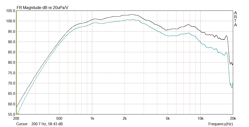

I tried a ring plug in the DFM-2535 with a smootly expanding adapter. These are unsmoothed frequency responses:
What seemed as a very smooth profile overall doesn't turn out that way. I think the expansion inside the phase plug is just as critial as anywhere else. Here it apparently doesn't match the rest. So, with the ring plugs it's also not that easy. The DFM-2535 is obviously optimized with the existing conical exit section.
But I can try some more rings, this was just a first try 🙂
But it still sounds fantastic. It can be well worth it, even if some additional EQ might be necessary.

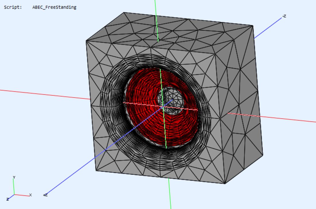

You can place a woofer inside a waveguide using Source.Contours. I attached a config file that does it with a coaxial driver as an example.

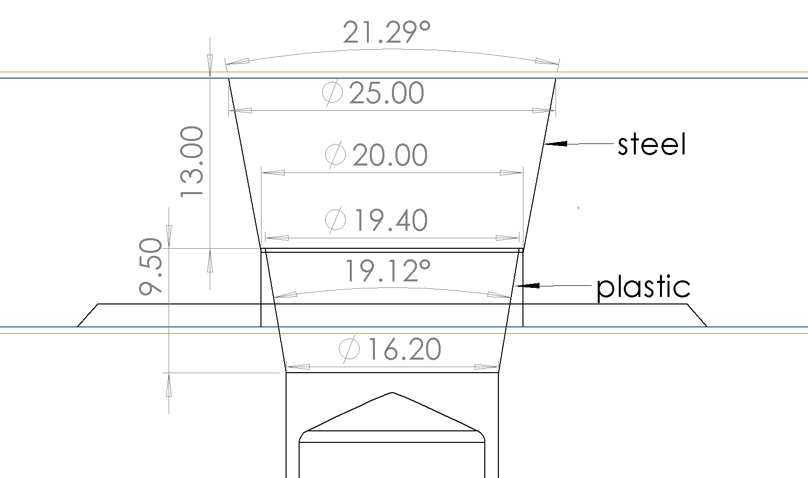

Here is a stab at measuring the BMS 4552nd parts. Take the angles here with a grain of salt however the angle of the plastic is for sure more narrow than the steel. There is an ~0.3mm lip between the plastic and steel parts that accounts for the 0.6mm diameter difference between them. I don't know if this helps with any of the other BMS neo CDs but I would surely like to see an optimized adapter for this one (because I have several of them...) 😀

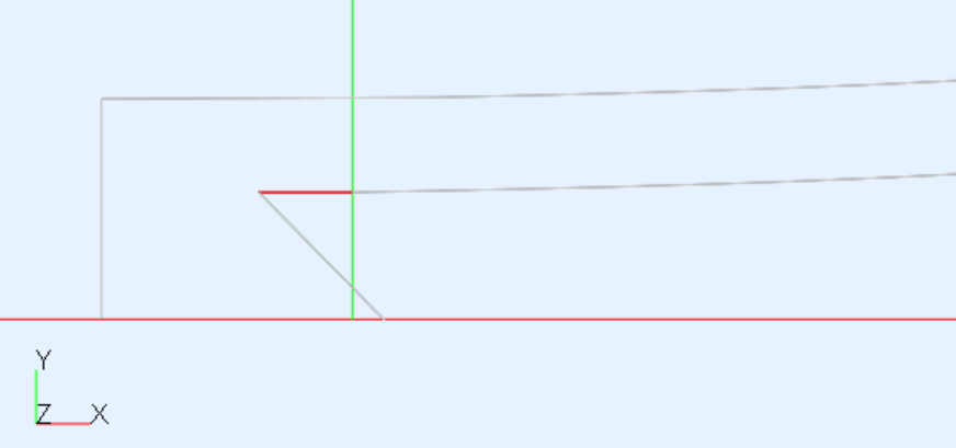

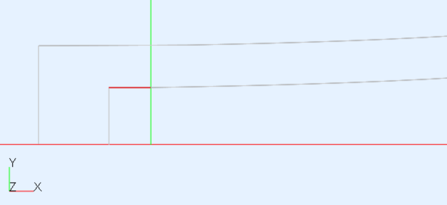

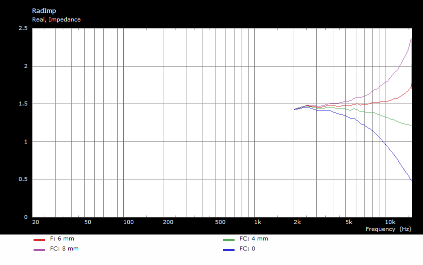

I was curious about the effect of the central part of the BMS phase plug.
So I've tried a few different geometries, basically the heights of a central cone -
For instance, 0 and 8 mm:
These are the corresponding acoustic impedances:
Assuming the simulation is correct, it would seem that the shape of this detail is pretty important for the HF efficiency of the driver.
It has absolutely no effect on wavefront/directivity below 20 kHz, as it's still very small relative to the wavelengths involved.
View attachment 1396544 View attachment 1396543
Does this mean that it is that little pointy cone that is responsible for the peak in the response between 10 and 20khz on most all of the BMS cds? If so it's too bad that park isn't easily removable for the purpose of optimizing its shape. I'm tempted to possibly sacrifice a diaphragm to get some better measurements and play with the shape of its guts.
With fresh eyes and mind this morning I refined some of my measurements of the diaphragm part and would now call the exit angle of it 19 degrees.
That was my first thought as well, but I don't know, the simulation is still overly simplified.
- I think that it shouldn't be difficult to get rid of the central part by milling it off from the back side. The question is if there's anything to be improved - I tend to believe that the BMS engineers knew very well what they were doing. Maybe with the slow-expanding throat it's a bit different, I really don't know.
