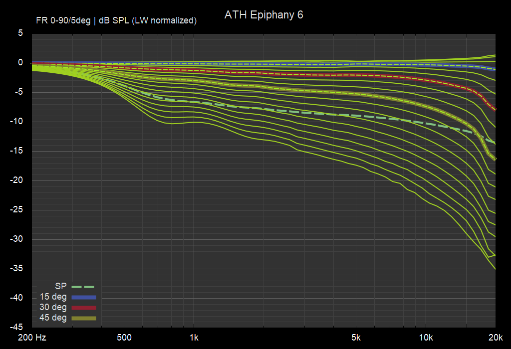

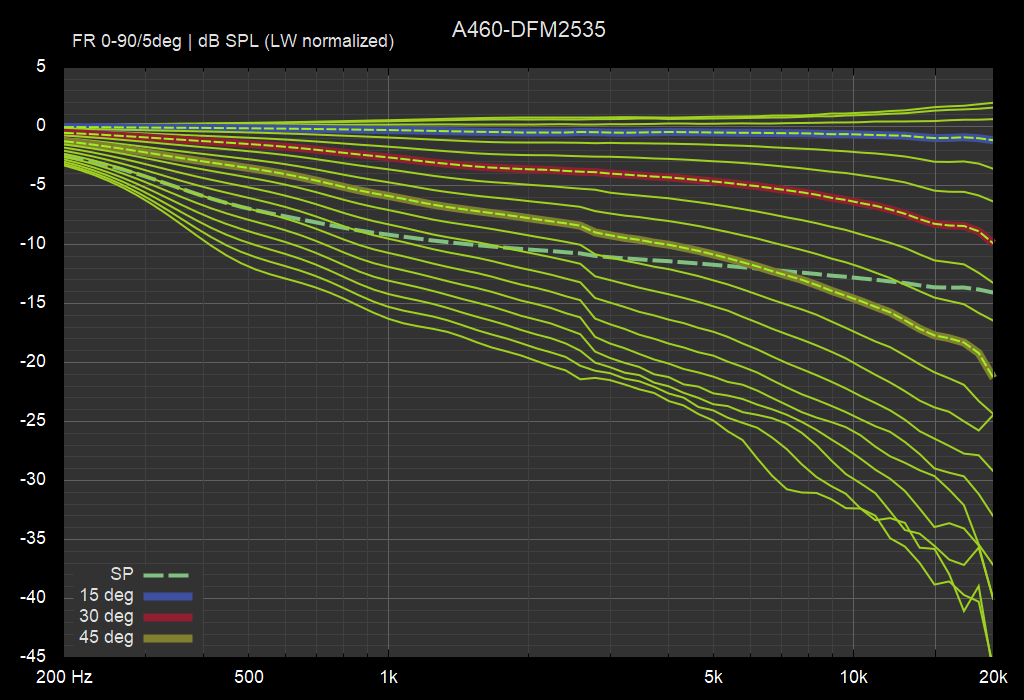

BTW, here's a comparison of two pretty different waveguides. One smaller (28 cm), moderately wide-radiating, the other larger (46 cm), moderately narrow (and narrowing). Notice the SP curves though (i.e. the total radiated powers) - except the absolute values, given by the different beamwidths, their slopes are virtually identical. This means that the "timbre" of the reverberant field in the same room will also be the same, even if the polars of the larger one fall more rapidly off axis. I found this a bit unintuitive at first but this is how it is (the far off-axis polars simply contribute less on the bigger horn, as they are of lower level).

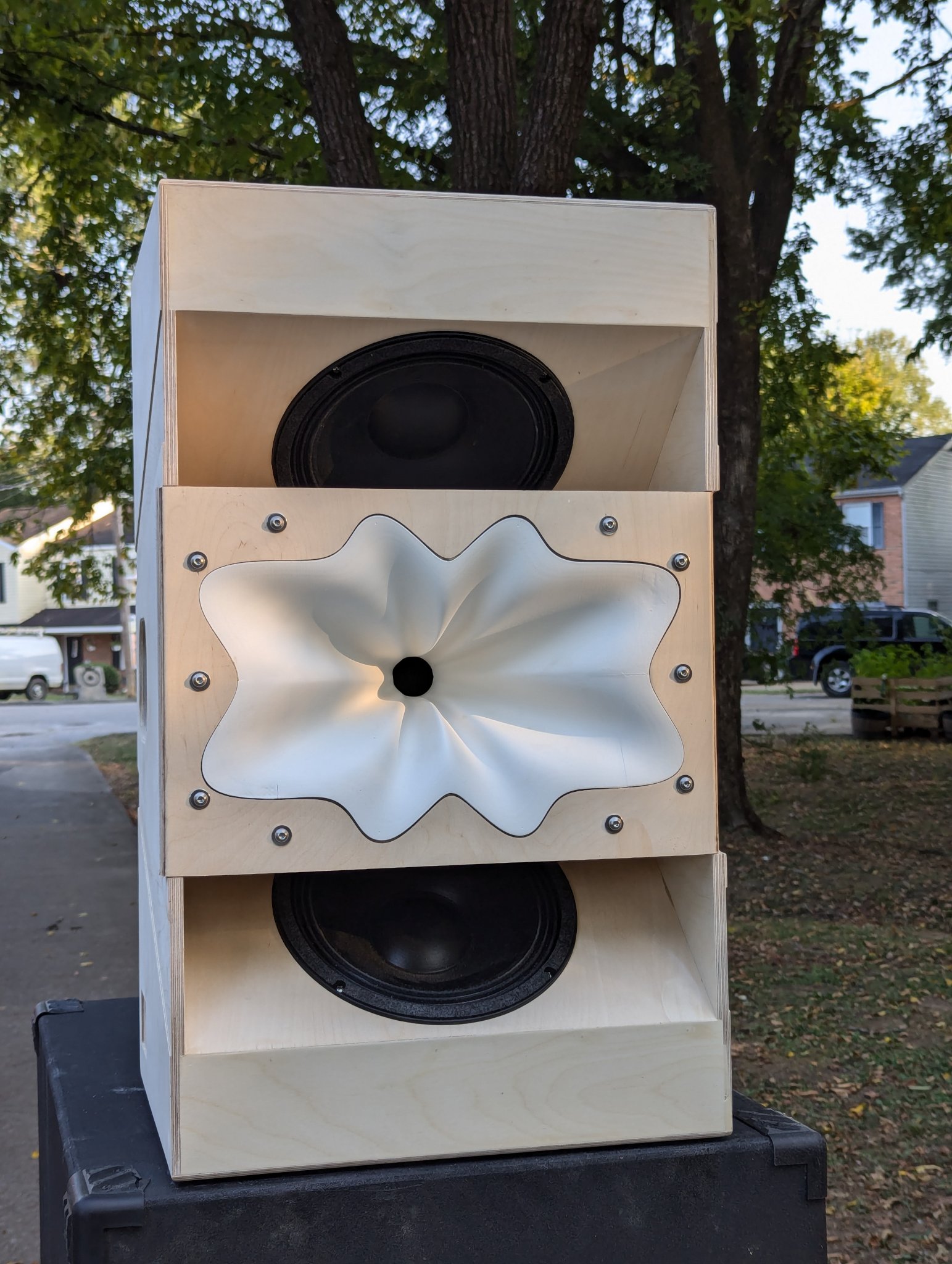

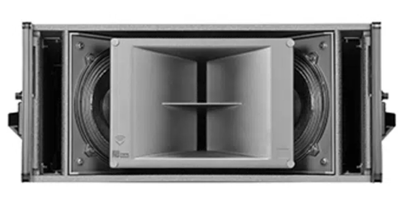

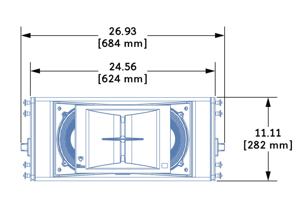

When I was an assembler at Meyer Sound, I could see a resemblance between the Leopards I was assembling and Bill Waslo’s fade-to-array trick he first used on his Small Syns (explained here) and again on his 3D-printed co-entrant waveguides where he eventually moved the woofer array slots to the sides of the cabinet (here).
Here’s the Meyer Sound leopard arrangement:
I’m wondering if a pair woofers behind one of these Ath horns could be employed to do something similar without many deleterious effects.
Apologies if this is threadjacking.
I've tried a few variations of that with several different waveguides but was not overwhelmingly happy with how it sounded. It's also more or less what's being done with the Meyer X80 as well. You can get the woofers pretty close but still need to use a low XO (700hz in my case) and there is some lobing that still occurs. Might work better with a coaxial compression driver but that doesn't hit the price mark I'm aiming for with this box.

The Leopard's slot loaded woofers require extensive processing to correct what you may consider "deleterious effects".I’m wondering if a pair woofers behind one of these Ath horns could be employed to do something similar without many deleterious effects.
The Leopard high frequency driver uses four exponentially expanding waveguides coupled to a diffraction grate, allowing a lower crossover frequency than a typical Ath style horn of the same depth.
The center to center side slot spacing of the Leopard would cause off axis cancellation if the crossover frequency was raised.

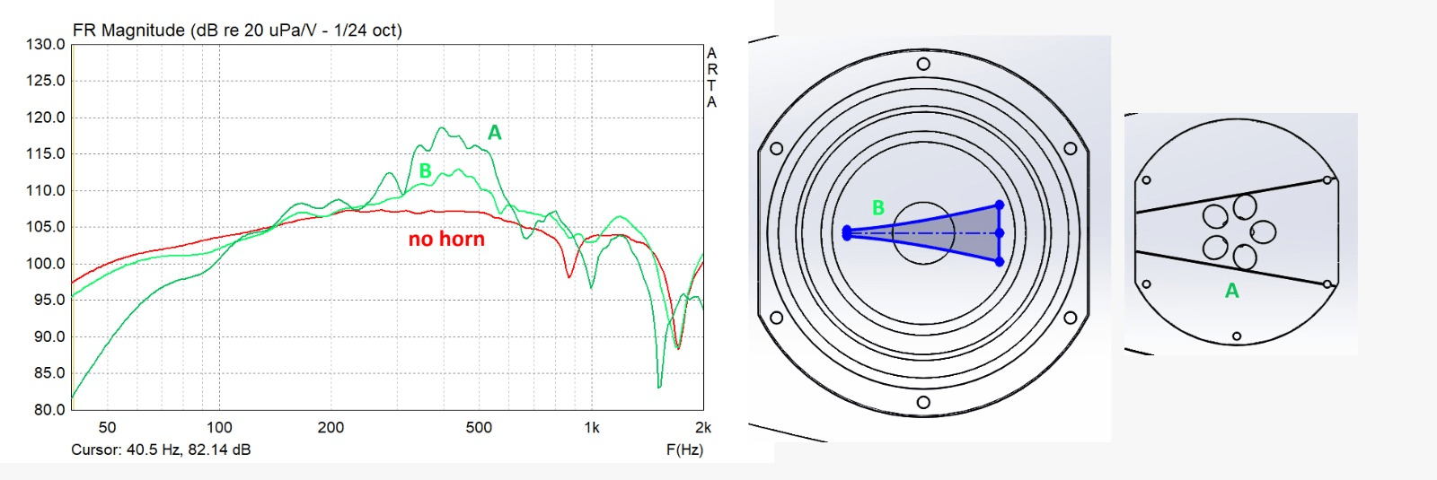

Some experiments using A600G2 MEH and 13cm low sensitivity midbass.

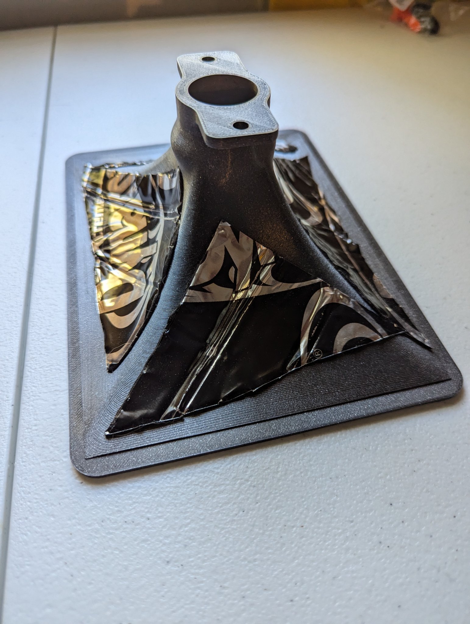

I'm curious about the acoustic properties of a nearly hollow plastic petal. Specifically, does it resonate or behave differently compared to aluminum waveguides or solid ABS with 100% infill?
As an experiment, I 3D printed one A520G petal from PLA with 0% infill (hollow) and filled it with acrylic mass. Afterward, when tapped, it produced a completely dead "thud" sound. There was a good deal on acrylic mass at a nearby hardware store, so this approach would not be too costly, one tube of 400gr was 1,99€. However, the total weight of the petals might become an issue—each A520G will then weight around 9 kg. I'm not sure how to handle the assembly or stand design to support a front-heavy waveguide if I continue down this path.

For this particular waveguide, I tested before and after adding dynamat car sound dampening material. I wasn't able to see any measurable difference in distortion or frequency response "smoothness".

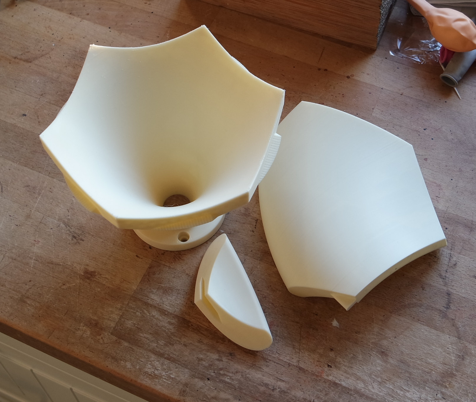

This way of printing it is so beautiful! You are a good designer Mabat 🙂I also have the first A460 printed and waiting. I would need someone for assembling these things... 🙂
It was really an easy print, seems to fit nicely so far. (It was a little less than one 1kg spool of filament per waveguide.)
Thanks. One of the nice things about this division is that almost all surfaces of the joints are planar, i.e. it's very easy to sand them.
