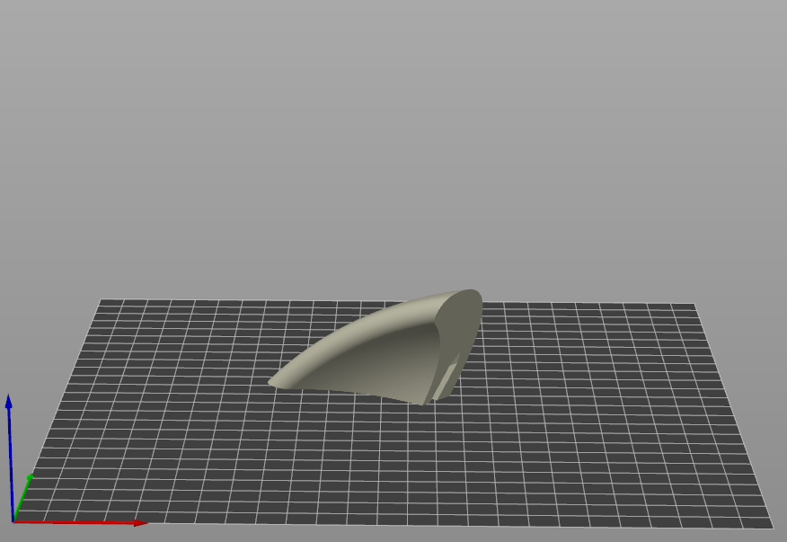

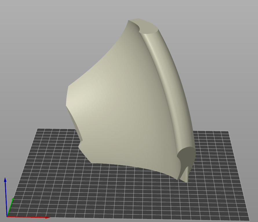

will you also release the STL file for the ATH A460 from post 15,578?
Sure, why not.

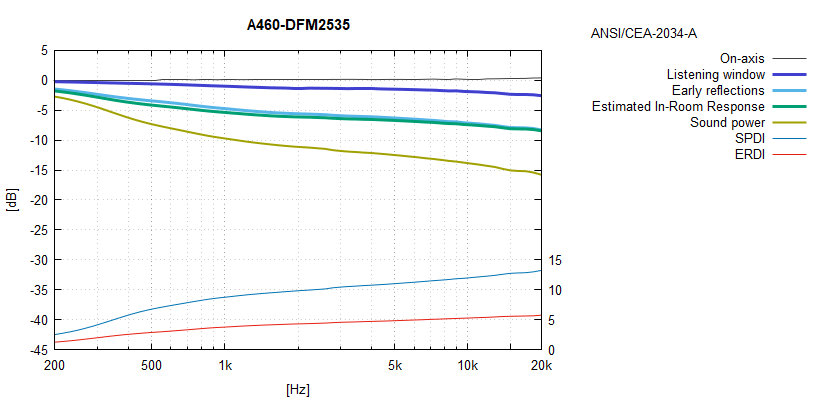

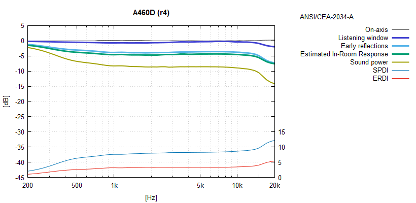

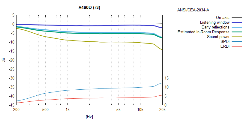

The DI is more flat but this doesn't directly mean it's better in the end. There are some conjectures on this, all sound, but still nothing verified, as far as I know. What we know "for sure" (circle of confusion?) is that a flat power response sounds too bright in most cases. So it comes down to what's the best way of dealing with it. There are several options of different dimensions, DI being one of the variables. I tend to think that the approach chosen for the Gen2 DI slope (and also the former A460) is a pretty good one.

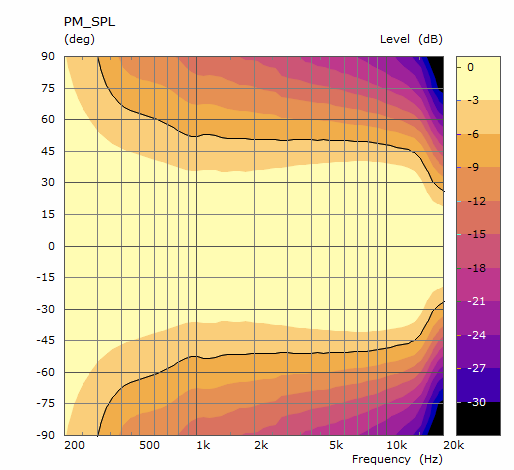

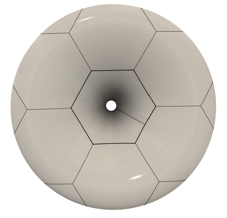

...This is all readily possible:
The bottom one with DI ~8 dB, that translates to coverage angle ~100 deg:
And it works like this to almost 15 kHz, which is not that bad after all.
