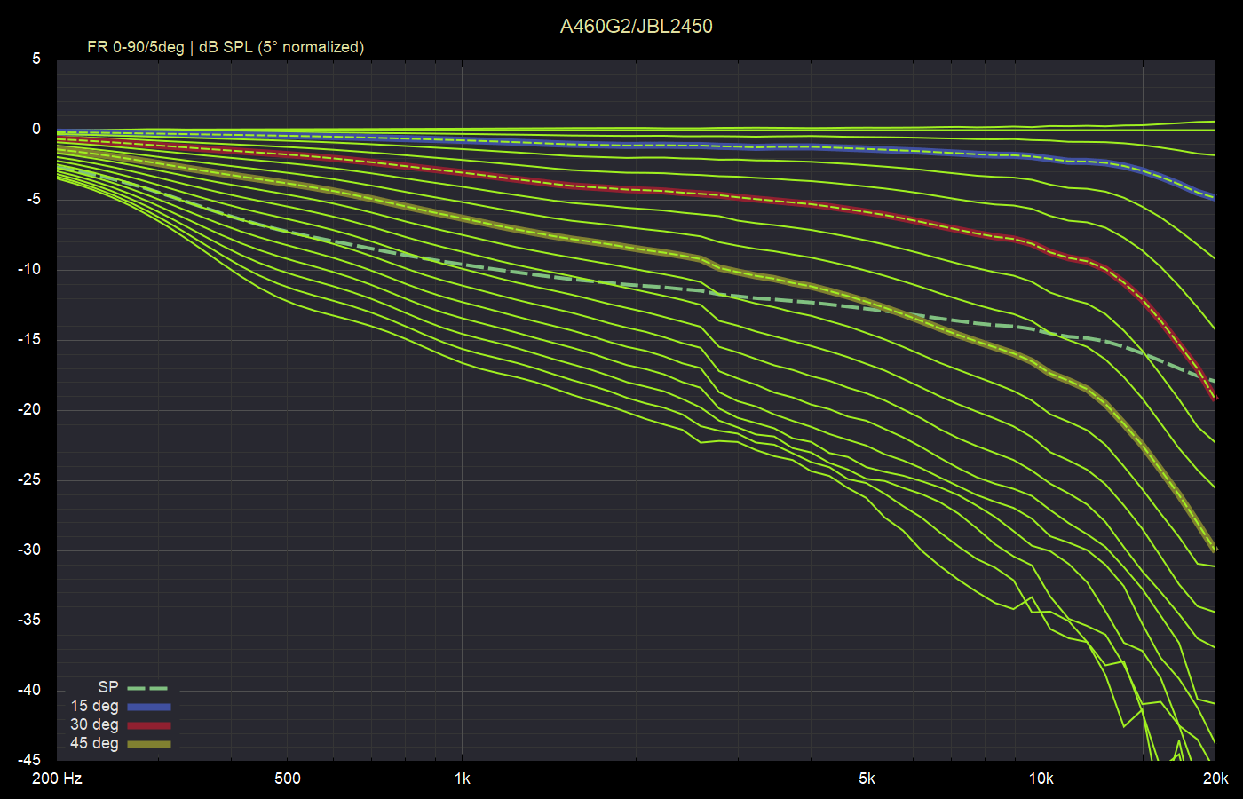

here's no need to upscale, I'll just add a 1.5 inch adapter. That was the idea behind the "Gen2" series
You are awesome, I do not care what people say about you. 😉
So, 1.5 inch - that's how many millimeters exactly, in your case? 🙂
The driver is JBL 2450SL, the attached drawing lists it as 38.1 (1-1/2). I rechecked with calipers and it is indeed 1.5 inch - or 38.1mm for us Moravians. 😀

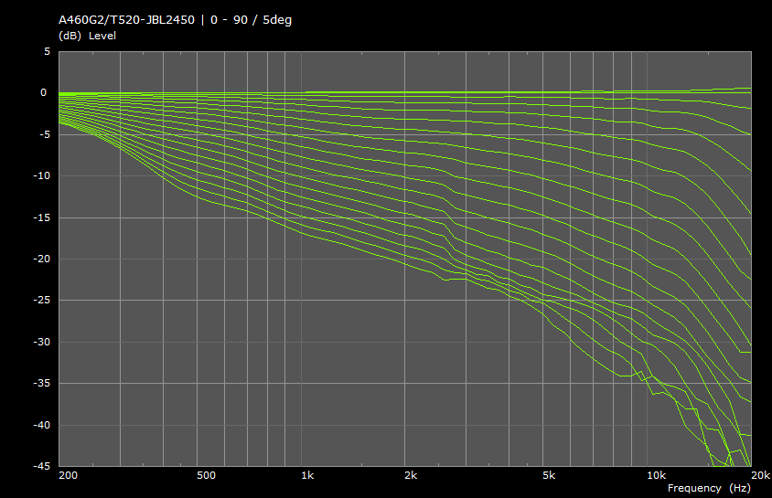

the phase plug ends at the face-plate of the driver; therefore, the exit angle is 0 deg.
As a side note, I'm not sure this is the whole causality, actually. If there was no expansion in the phase plug itself, 0 deg would be the right continuation, but do we know this expansion? I've never seen it mentioned anywhere. If there was a non-zero expansion, the horn should probably continue with the same rate (at least locally), but what to do if the phase plug is designed to produce a flat wavefront at the same time?

All I can say is that this should be ideally designed/optimized as one single system. Otherwise, you just have to work with what you have, and in that case this ideal may be simply unreachable. (The small Peerless driver, for some reason, allows this ideal to be actually reached.) Exit angle mismatch between a driver and a horn/waveguide can have only a small to negligible effect on directivity, but at the same time can pretty strongly affect the overall "evenness" of the frequency response due to the throat reflection (which can, in principle, be equalized, though). Not sure about the higher order effects, but I suspect these will be typically high enough in frequency for not to matter much. To me, having a smooth directivity with as least diffraction as possible (as observable in a normalized graph), is the primary goal. The rest is manageable on the signal level.

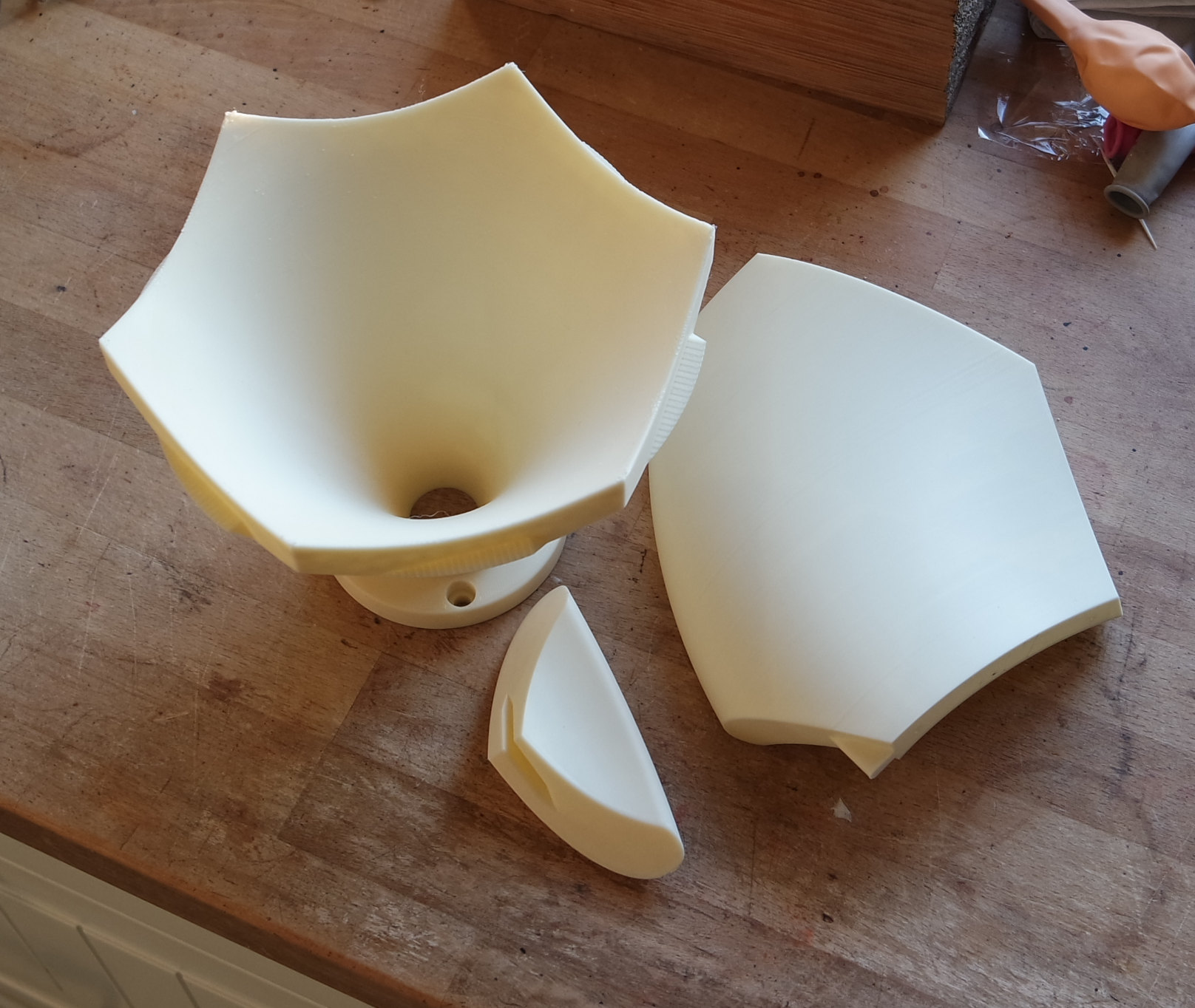

I would suggest simply something you're familiar with and what gives nice and accurate prints on your printer. I haven't done any research regarding mechanical or acoustical properties, as I still do mostly prototypes, and for that I'm quite happy with the cheapest PLA (the above is PLA Meta made by SUNLU, virtually warping free). After epoxy coating, I believe these could do just fine. I still tend to make it very light, basically hollow.

Hm, I certainly to not have your mathematical prowess, but what I gathered from Geddes' papers was that he was trying to find a shape that would allow a flat wavefront (presumed to be at the exit of a compression driver) to a wavefront at the selected wave-guide coverage angle with the least possible disturbance.

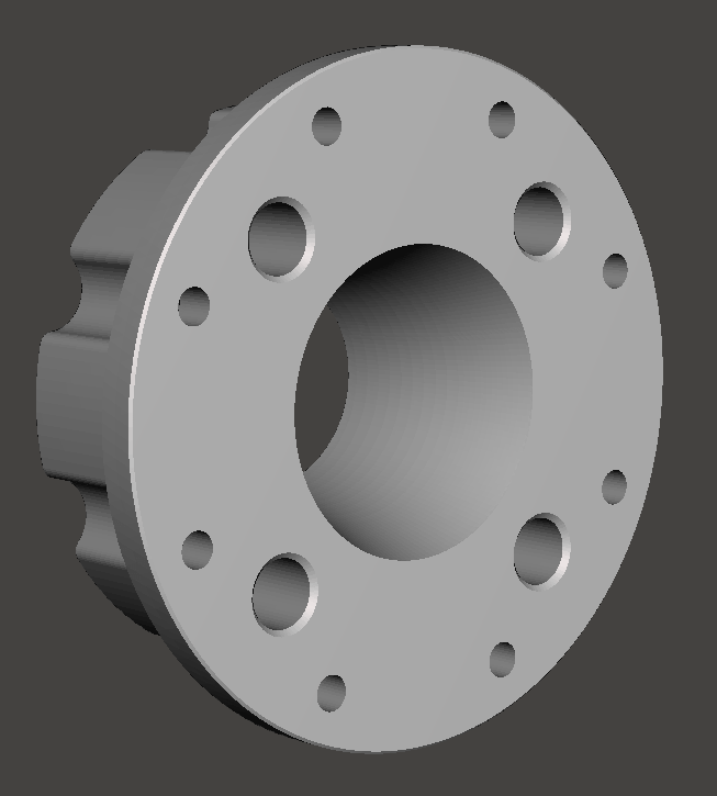

Done, here it is (i.e. an adapter for a Gen2 horn).
Thank you, very much, I though that it would be for the wave-guide in post post 15,578 as we discussed. Well, I will go with the Gen 2 then. Will it work both on the 460 and the 520?
Kindest regards,
M
Ah, then we misunderstood each other. For a 1-1/2 inch throat it's a bit different situation and I doubt it can be done better than with the current Gen2 (above). Yes, it will work basically the same either on the 460 or the 520.
