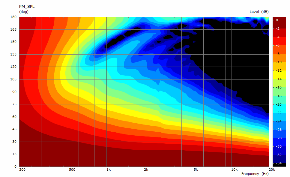

BTW, for the Peerless DFM-2535 (see the group buy), I took the A460G2 and let it optimize again for this particular driver, this time releasing the constraints for the common Gen2 body. Here's the result, it's a tiny bit less narrowing towards high frequencies. Not sure yet what to make from it, I'll probably just upload the profile template/DXF to Cults.

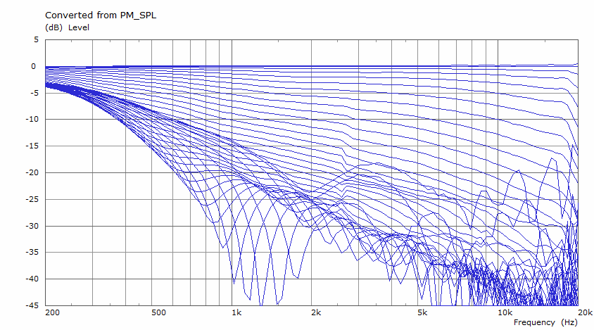

BTW, for the Peerless DFM-2535 (see the group buy), I took the A460G2 and let it optimize again [...]

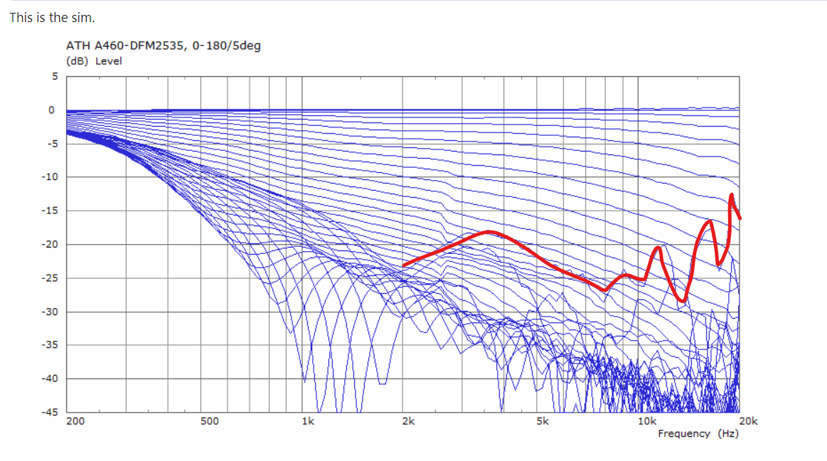

This is the sim (normalized@5deg). It should be pretty much the same in real.
Asymmetric waveguide would drop that mixing path lengths, if it's important. On the other hand strong constructive interference there indicates good profile, sound diffracting nicely around not losing much intensity to diffraction back wave.

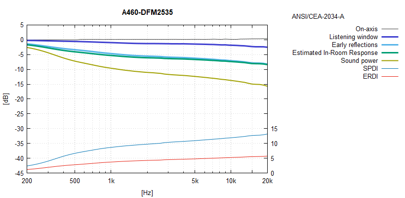

I consider this pretty much irrelevant. In terms of radiated power, this is just nil.
It's included for completeness, mainly to calculate the DI in the proper way, in principle, but otherwise it just doesn't mean anything, IMO.
For sure, I found it as an interesting detail in the sim. Although, most interesting detail is the top octave overall, if it measures like sims it doesn't get better than that.
Above ~15 kHz it depends on the driver in the end, on the coherency of the produced wavefront. There will be only a few that work so well that high. But then, there's no reason why it shouldn't measure as predicted. Up to 15 kHz, it virtually always matches very well (for a 1" throat).

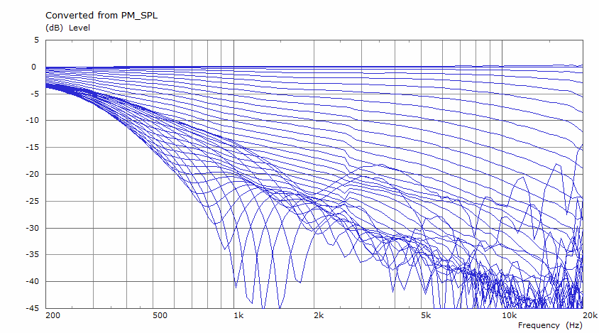

This is a simulation including the exit conical section of the driver (DFM-2535), in case it was driven with a) flat and b) spherical wavefront:
a)
b)
The DFM-2535 is usable up to 17 - 18 kHz, this should be good enough 🙂
