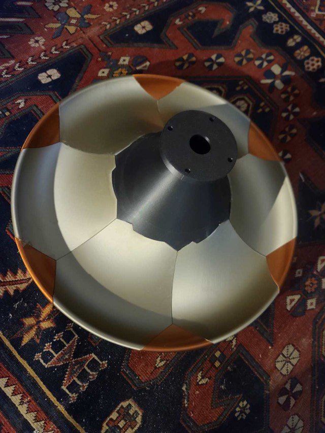

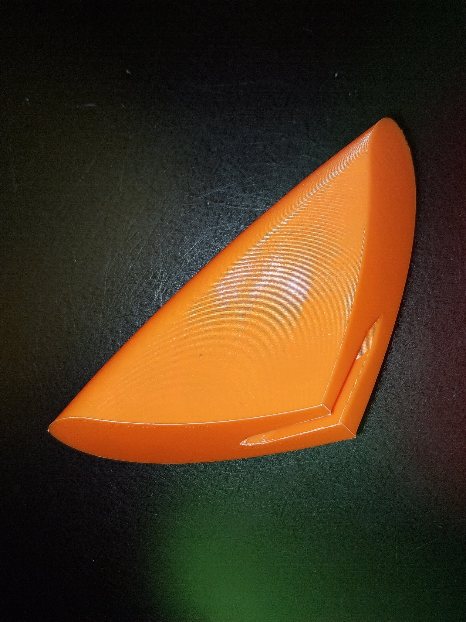

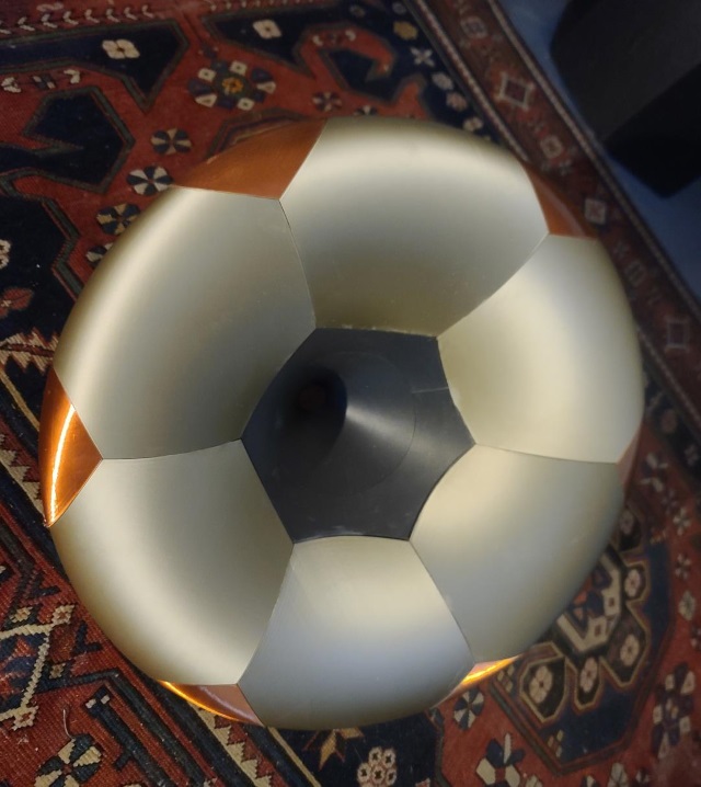

So, I couldn't resist giving it a go. This was printed on a Bambu A1 mini - £169. I wanted to try various metallic filaments. Since I last had a 3d printer - some 6 years ago or something, this machine is a different experience completely. The print quality is astonishing. And I've had ZERO print failures so far. It has a 180mm cube print area so I had to slice the throat horizontally - no problem though.
So, the good - well its so almost possible to get a final finish right off the machine. I've not tried epoxy or any other coatings yet.

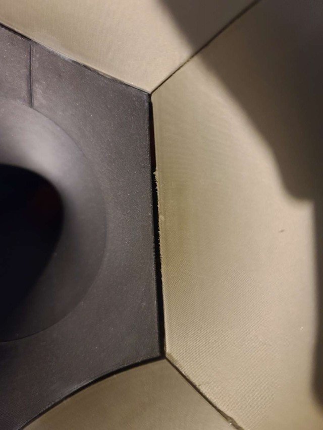

The bad - I ended up with a 3mm gap on the last leaf. And I'm not really sure of the best way to fill it. My fault - I think that I could do it better the next time. The trouble is, as amazingly accurate that these prints are, there is no room for error at all. There are some strategies that can eat up errors that I use when making wooden horns - but this would mean some design changes.

@maravedis - So what's your explanation of the gap?

On textured PEI gaps due to warping 3-4mm are common from open enclosure and PLA. I'd like to see non filled filament that can do better.
I did a dry run with tape (carpet tape from lidl is the best) which worked vary well. The small inaccuracies then distribute themselves. I got over eager with CA glue and until I was left with a final piece that I couldn't sand to fit. I'm sure it could be done better.
Next time I would split it up into 2 halves, which can be flattened at the join on a large piece of sandpaper.
But, even if it all goes well the joins look like joins (and there are very small gaps everywhere if you don't use foaming glue) And, there is still a risk of ruining many days of print - and you dont know this until the very final glue moment.
Of course, none if this is a problem if one is going to fill and paint.

The joins will always look like joins as long as the printer nozzles are round, I'm afraid.
It would take quite a big printer to circumvent this.
Maybe the CA glue is not the best approach here, as it indeed leaves no room for even smallest later corrections. The Gen2 kits with the mounting jig seem better in this regard, after all (when used with a slow glue). Hmmm, perhaps I should reconsider returning to that 🤔
