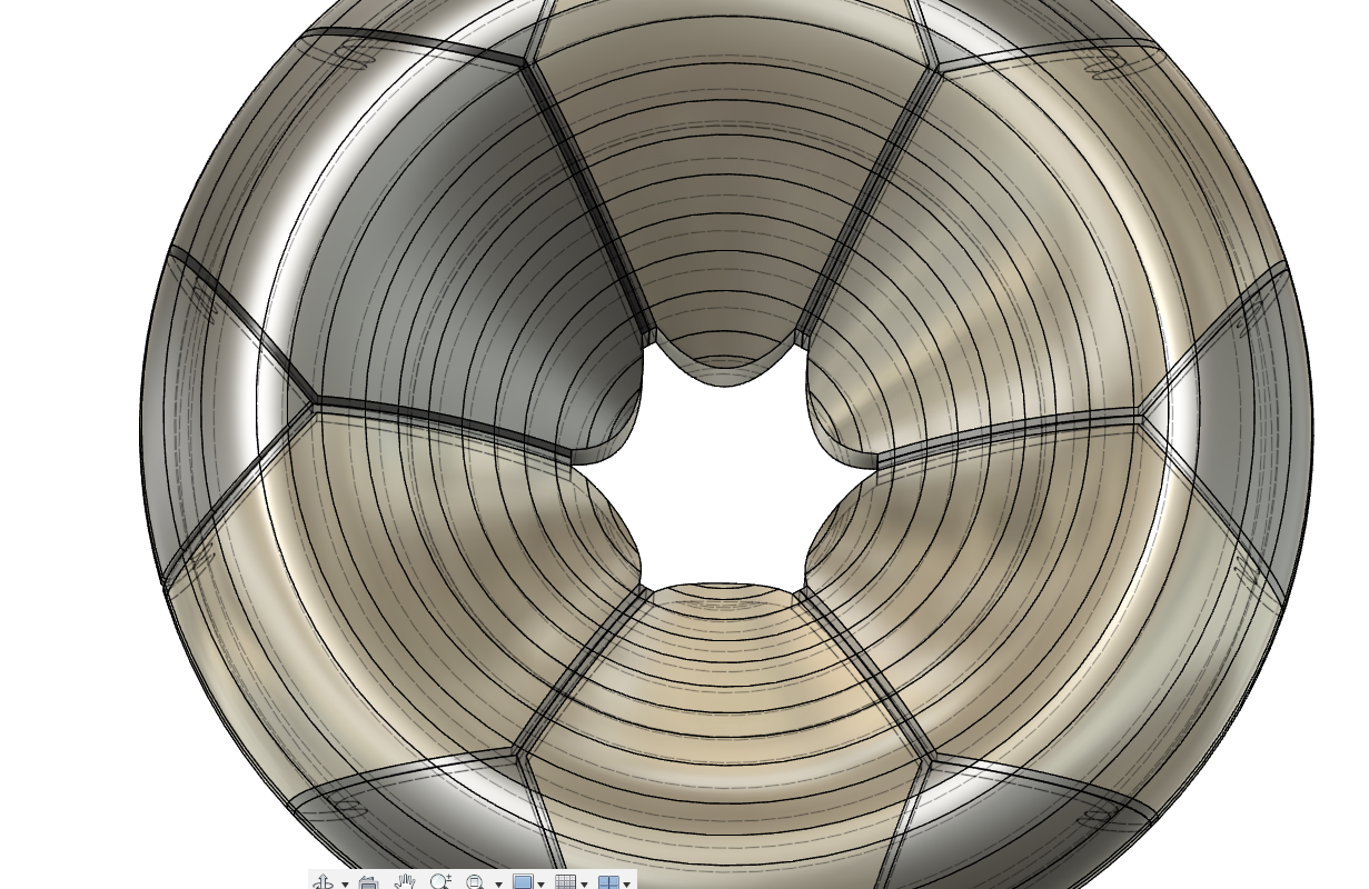

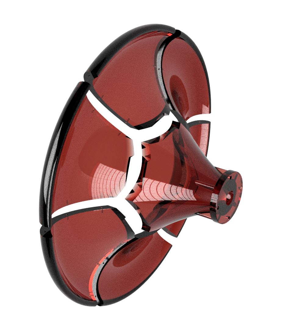

Could you include some circumferential grooves so that some string or rubber cord could be used to pull everything together evenly? Perhaps 2 or even 3 of these grooves would be necessary, but it would be similar in concept to assembling a glued mitered box together using painter's tape.I'm keen to improve it. Could you post a sketch?
Or include some holes in either the front or back so that using shafts/pegs all the pieces can be suspended above a bed or platform in the "correct" position, which would avoid accumulated error.
Also, I'm thinking maybe latex caulking could be used as the adhesive, since it's cheap, easy to use, has a long working life, and is paintable.

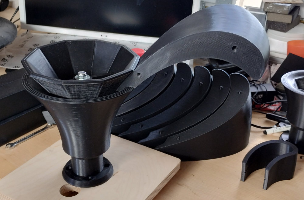

I think this is getting too complicated. It's clear that to avoid the accumulation of inaccuracies, the petals must be assembled all at once, preferably with a filling/foaming glue that leaves room for adjustments and fill all the small gaps. This is actually what I already have with the "base + petals" kits, where the mounting jig holds everything in place until all the petals are added and can be fixed together with a tape or whatever.
I think I will just redo the A460 kit like this. At the moment it still seems as the best approach, i.e. the most immune to imperfections.
@miero, thanks, that would be good enough, in my book.

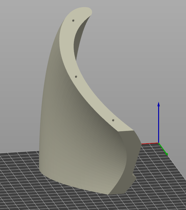

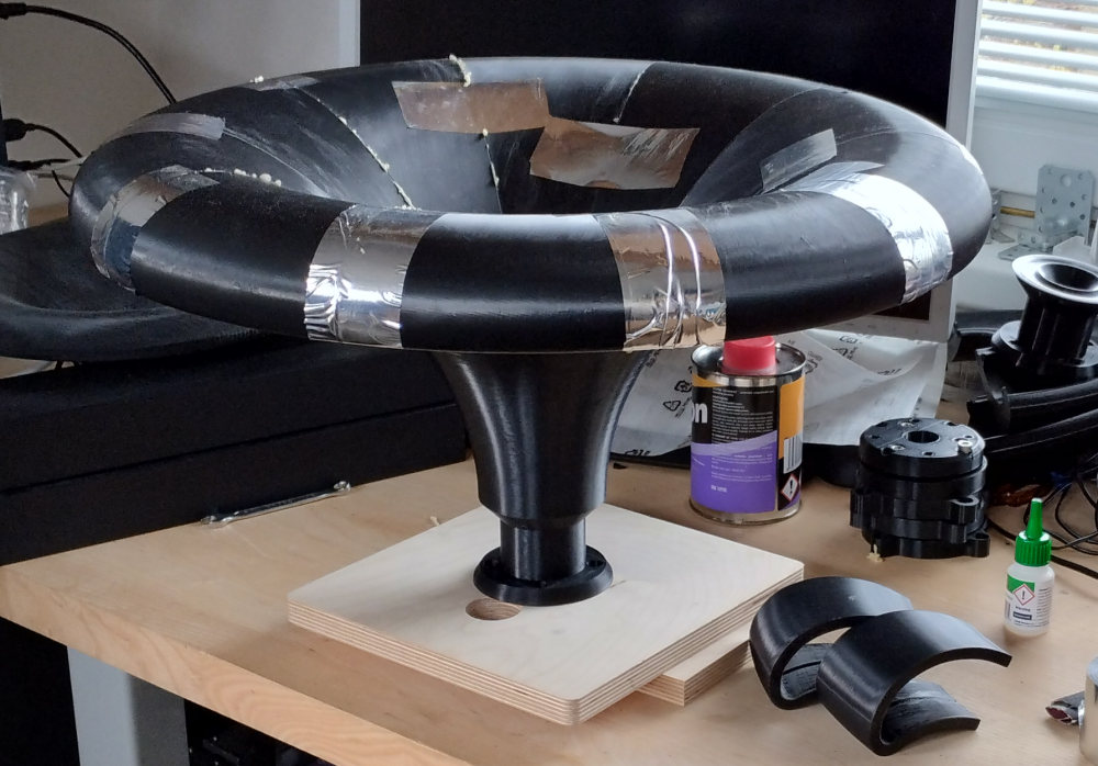

As for the current A460 kit, maybe it's best to form a full ring from the petals with a slow glue first. A tape should hold everything sufficiently, IMHO (there are alignment holes for small bits of filament in the sides of the petals (*)). And then glue this ring to the throat part.
(*) you may need a 1.8mm drill to assure the fit

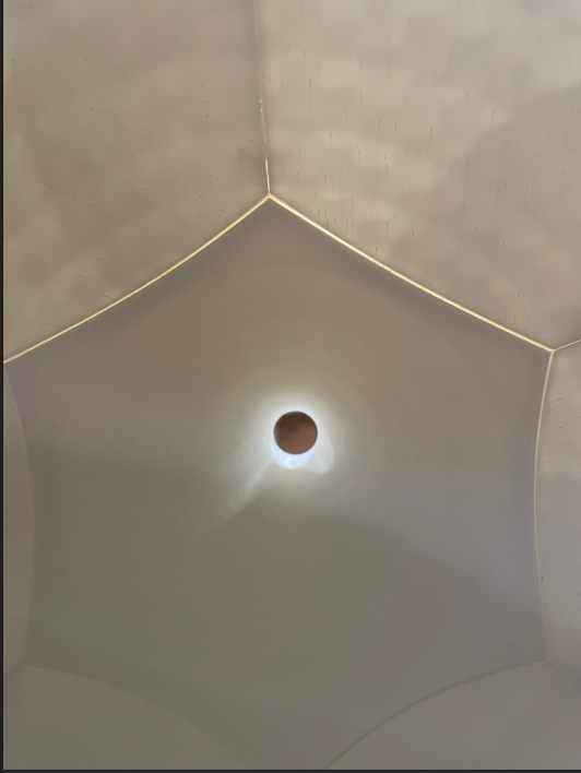

I think the new kit design as-is is pretty good. I like it better than the old version. The most challenging parts of the assembly is this piece:I think I will just redo the A460 kit like this. At the moment it still seems as the best approach, i.e. the most immune to imperfections.
It would not separate this from the petals. The tongue and groove is a tight fit, even after sanding. If you can simply have 6 petals with at least three alignment pinholes per petal (e.g., 2mm holes, so one can use 1.75mm filament for attaching).
I really like the way the base attaches to the petals in the new system. In my glue up, I still had gaps - but overall it was still a very satisfying fit.

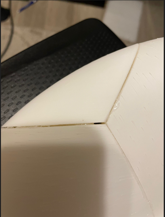

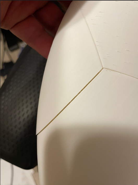

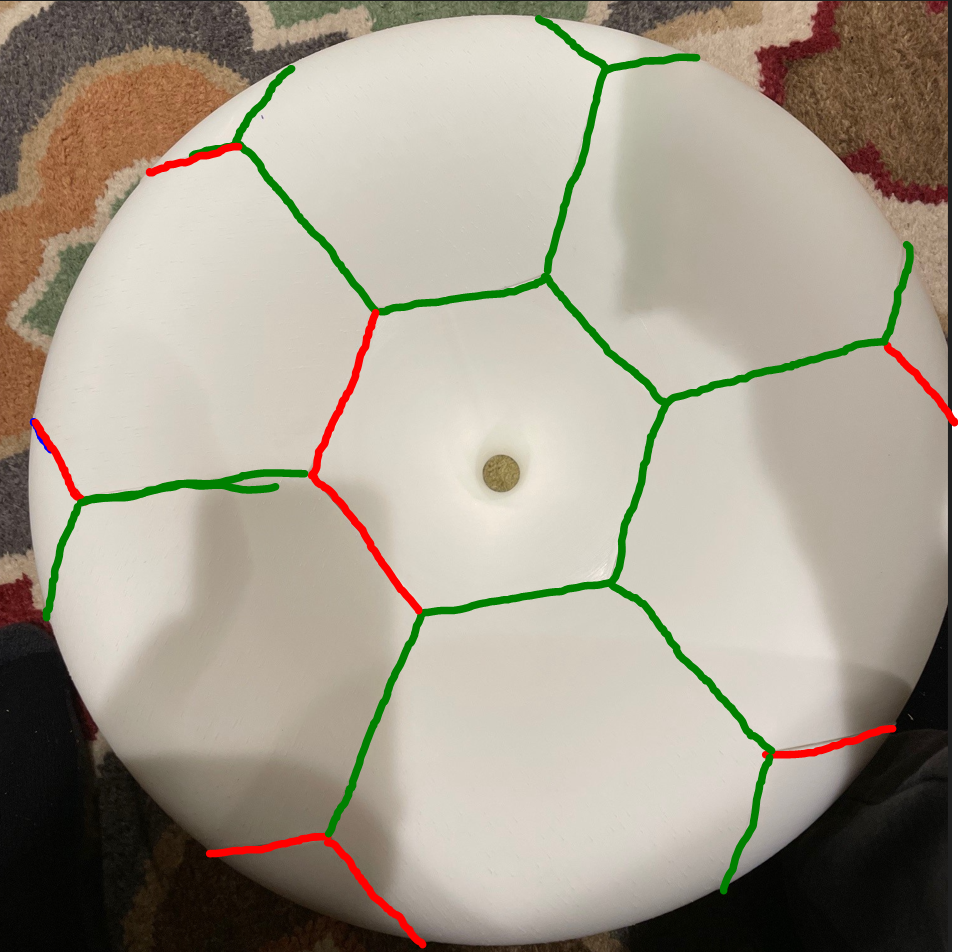

Some pics below, In the first pic, I'm trying to highlight the joints that went together really well (in GREEN) or poorly (RED). Notice how:
- all joints between the petals came out perfect.
- The edge (smaller triangular) pieces were problematic.

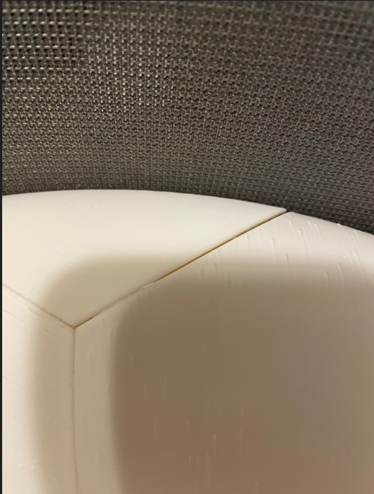

- tongue and grove were a tight fit.
- once you glued the petal to one side, it was hard to perfectly align with the petal on the other side
- the base attachment also went together well, but it ended up have 0.75 mm gaps on one side.
If we just keep the full petals and include one more alignment pin hole (so at least 3 total) --- that would vastly improve the accuracy of assembly.
The other thing worth thinking about is using CA glue for all tight-fitting parts (because its shockingly strong) and using some other filling glue with better filing ability for areas where some gaps are expected.
Thanks for your elaborate report, much appreciated.
Did you sand the sides of the petals prior to gluing them? (Those not lying on the print bed.) These need to be really flat for a good fit of all the other parts.
- If you or anyone else encounter a too tight fit, just let me know, I can easily provide parts with a bit larger clearances. This depends a lot on particular print conditions and there's no one value that fits all. I guess I should always include several versions in the kit.

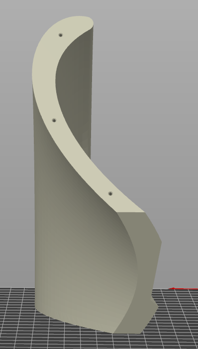

When I was putting large horns together from more smaller parts, I used alignment holes and pins. The printed hole is smaller than nominal, so it needs to be drilled. I used pieces of threaded rod or even wooden pins. For a good fit it is critical to remove all the overshoots in the corners - with a sharp knife or a scraping card. If the alignment holes/pinsa are to be printed, pyramid shape worked really well.

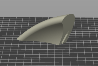

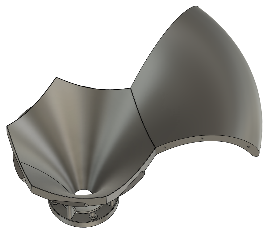

So, this would be the full petal. There's an increased overhang near the top but it doesn't present a big problem, IMO.
Even if it doesn't print perfectly, it's still the back side.
I left the pin holes 1.9 mm in the STL and I also couldn't fit a filament pin. I can make it 2 mm (or more), but maybe it just needs a drill. I just don't want to risk they arew too loose.
I think this would work better. If you're comfortable sharing, I don't mind starting another print this evening with this design.So, this would be the full petal. There's an increased overhang near the top but it doesn't present a big problem, IMO

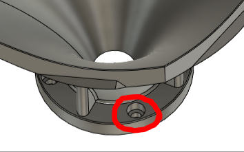

Also - can the recess of the mounting holes be removed? Given the curvature of the horn, it's sometimes challenging to get an L-key at the right angle to bolt the horn to the driver. Having a straight-through bolt that can be tightened from the side using a wrench may be a bit easier. Certainly not essential.
Good point, no problem. I have a short(ed) L-key for all this work. Couldn't imagine doing without 🙂
