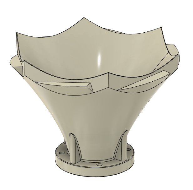

I've updated the Cults file, you should be able to download the new one.
The throat part is the same, I only added a version without the recess.
I am almost through printing the 6 petals. I still need to print the throat.

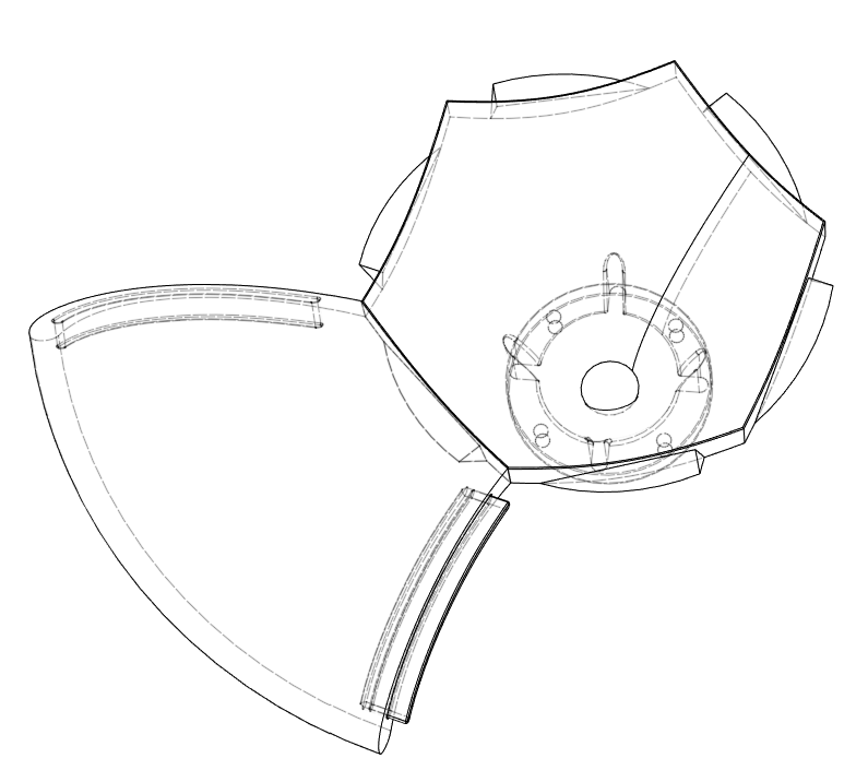

One or two additional suggestions:

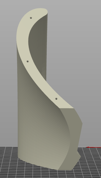

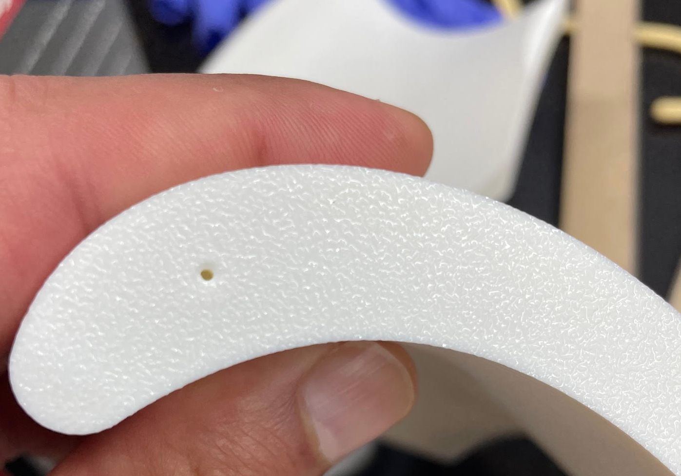

1) Are the alignment pinholes smaller on one side than the other? If so, I would make them of similar size.

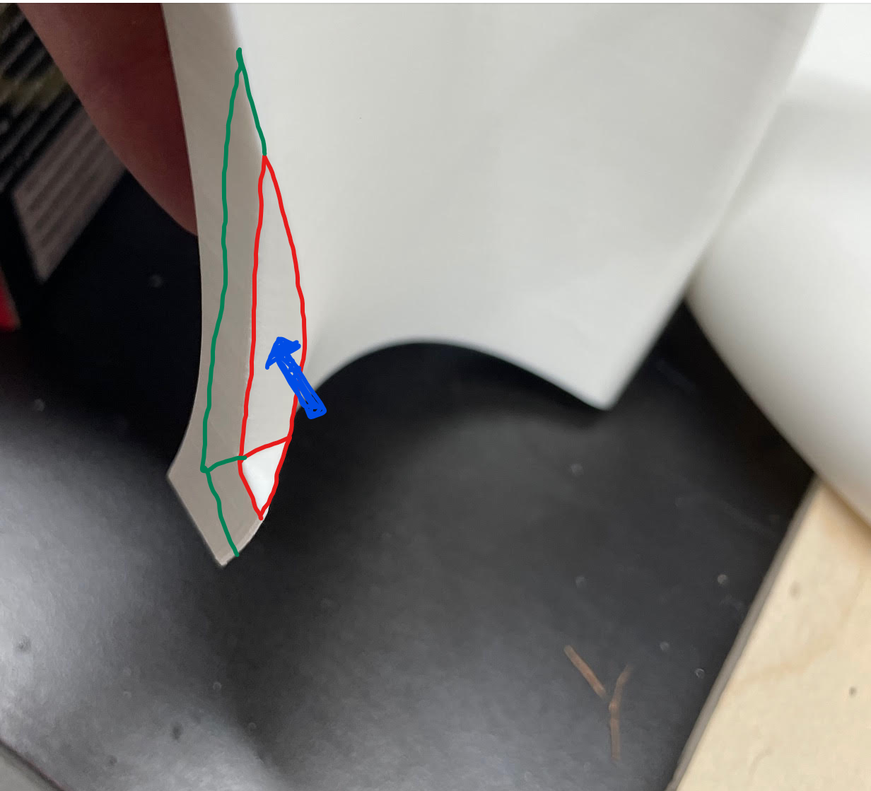

2) I don't know how to describe this modification accurately, but I would make the following feature larger. Modify from RED to GREEN (e.g., if using software like Fusion360, use push/pull tool to push the marked red surfaces below further into the horn).

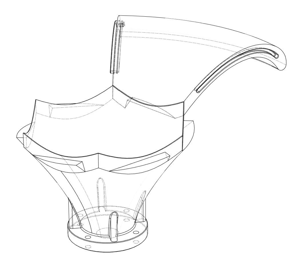

From my experience, it makes sense first to assemble all the petals and then insert/attach the throat. You would typically do this by laying the petal face down on the floor and inserting the throat from the top, or resting the throat on the on the floor (facing up) and laying the assembled petals from the top. As currently designed, when gluing the horn following this assembly technique, there is more vertical glue space than there is horizontal glue space ----- this has the impact of glue being removed from the two surfaces (if the mating surfaces are too tight) or leaking out (simply due to gravity) if the gap between mating surfaces is too large. If this feature was larger, you would now have much larger glue space in the horizontal orientation and the glue is far more likely to remain between the mating surfaces, creating a stronger bond and provide better gap filling. I hope that makes sense.
That's pretty cool. This would considerably save time on printing. How would the petals attach to the throat?Anyway, I'm giving it a chance 🙂
And I really like the mounting idea shown in #15,721, as it solves more than one problem (for me). It doesn't have to be so thin after all.
OK, understood. Which one do you prefer? -
(The one on the right would be a lot easier to sand down if necessary.)
The holes are nominally the same (⌀1.95 mm) but the first few layers typically get smashed a bit, so the holes get smaller. A drill should do.
I'm not sure if decreasing the bed temperature would improve this. In slicers there are also compensation settings for this (can't recall the name), I've never really experimented with it much.
I would say definitely the one on the right. Too much precision (at the printing level and the glue level) would be required for one on the left to work out..
This is what I did. You can tune the with of the small parts separately and print trials quickly. Then you can even dry fit them. This allowed me to use CA glue which I prefer over the slower gap filling glue and the need for the glue clamp part is gone. End result is also cleaner and needed less sanding.

I've just started assembling my kit, and the alignment pinholes are a PITA 🙂
(Seemed like a simplification, but it's really not.)
This is the only way to go -
For me, the pinholes worked were just fine. A small (1/8") drill was used to get a sufficient opening to insert 1.75mm filament on both sides with a little bit of pressure. I sometimes stretch the filament with pliers to get it a little thinner.
I also like your idea above, as long as it's a spline system and not a tongue-and-grove system. It would also help, as @Tom Kamphuys suggested, to tune the smaller parts to be ever so slightly smaller than the opening. Can the cavity be designed so no supports are required during printing? Otherwise, it would be nearly impossible to clear the cavity sufficiently for perfect insertion of the spline.
All that being said, the pinholes did work out just fine for me.

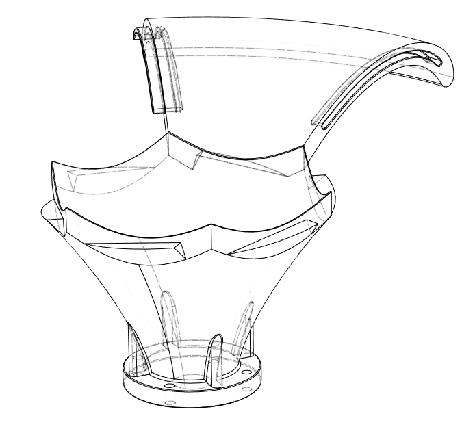

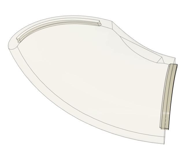

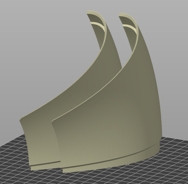

Sure, spline joint, no supports. I'll add several widths in a fine step so a perfect fit can be achieved.
OK, so hopefully this is the last one. I like the dry-run possibility, seems like a good idea.
Maybe the spline joint could be deeper. This look good to me -

I think this could work out well. I wonder if the spline system would also work well for adjoining the throat to the petals. I really like the throat+petal joinery as is - and I think the mod you already made should take the bond to the next level. But I'm just curious if a spline system would work equally well. For the spline to work between the throat+petal - you would need (I) near perfectly circular glue up of the petals or (ii) the spline to be thin enough to allow for reasonable tolerance.Sure, spline joint, no supports. I'll add several widths in a fine step so a perfect fit can be achieved.

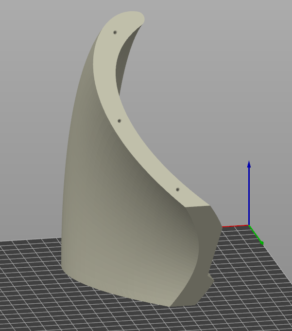

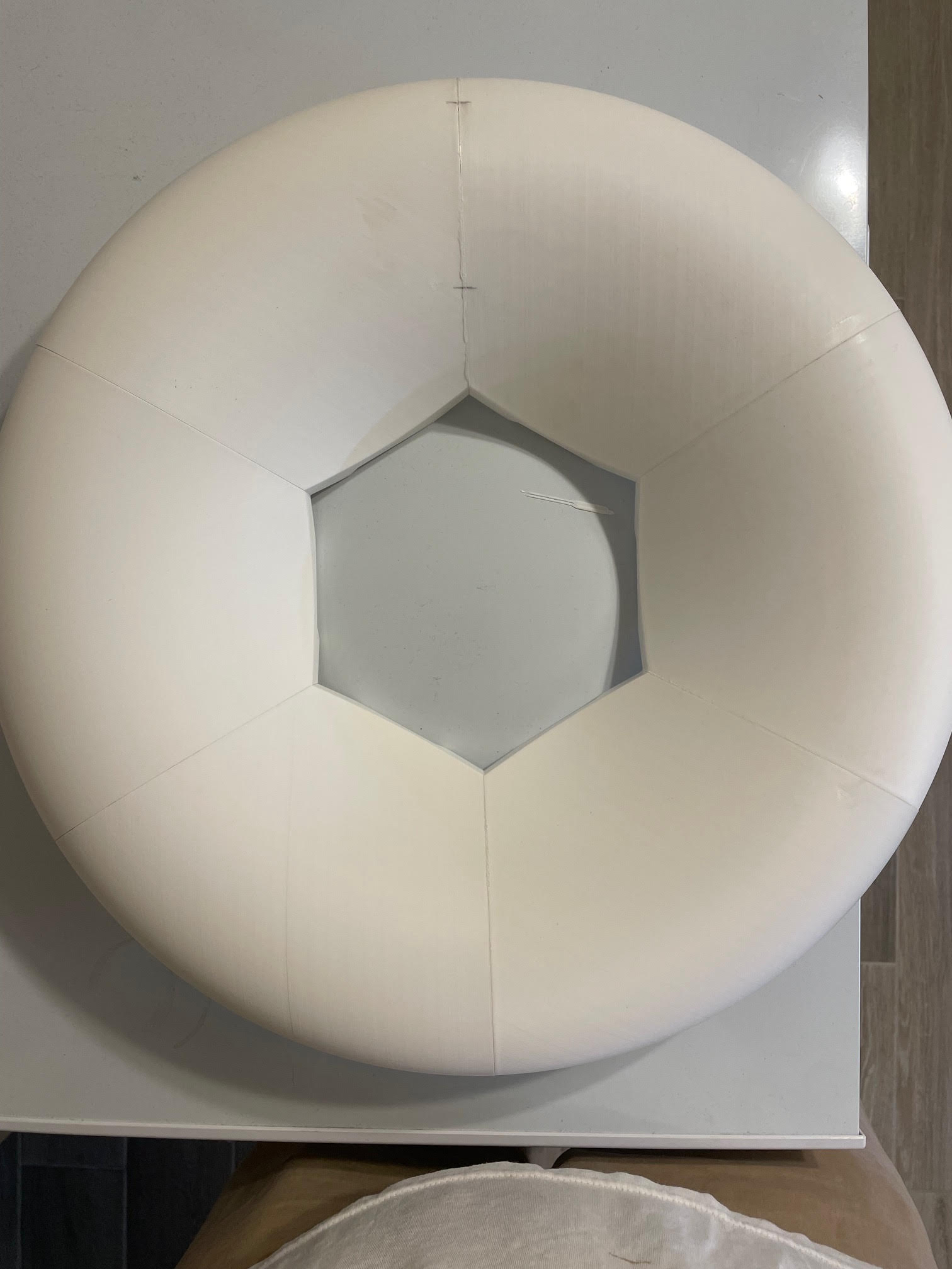

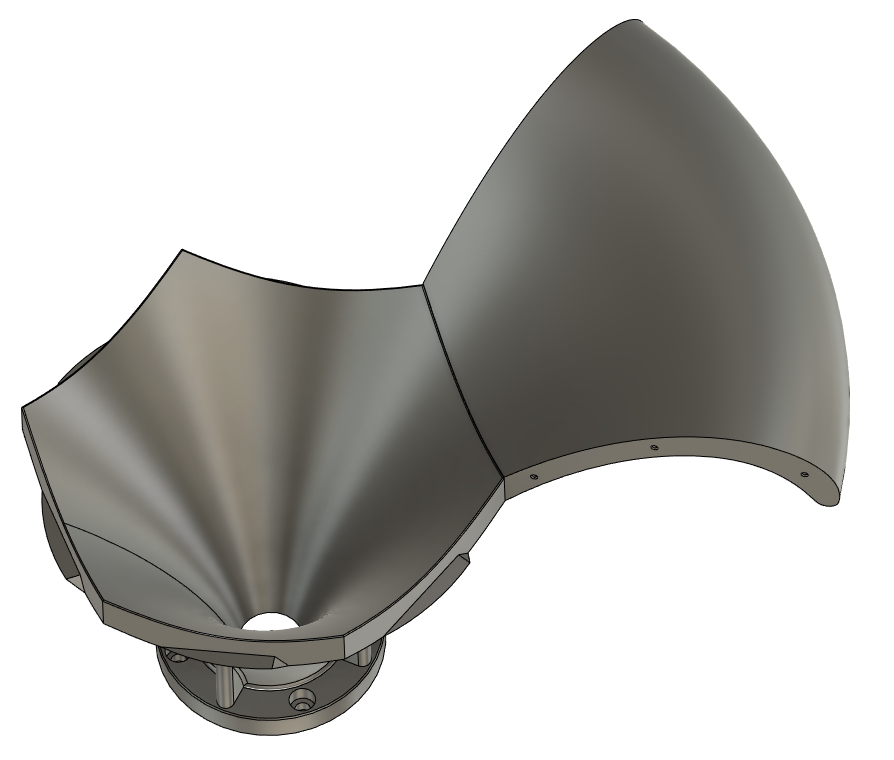

Here is a Part 1 update after the full petal modification only (and not other mods discussed in the last few posts).So, this would be the full petal. There's an increased overhang near the top but it doesn't present a big problem, IMO.
Even if it doesn't print perfectly, it's still the back side.
View attachment 1363595 View attachment 1363594View attachment 1363597
I left the pin holes 1.9 mm in the STL and I also couldn't fit a filament pin. I can make it 2 mm (or more), but maybe it just needs a drill. I just don't want to risk they arew too loose.

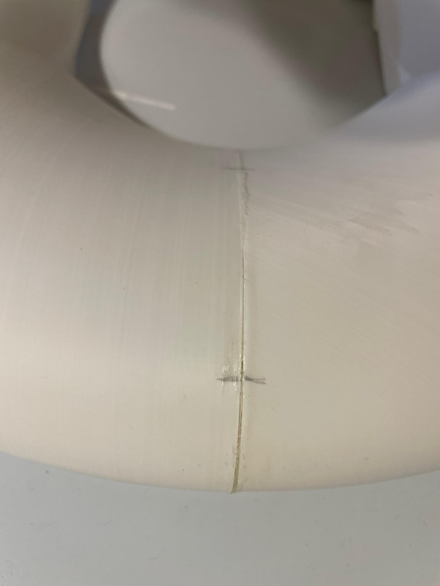

Here is a glue up of just the petal --- overall, far better than the first go around. I glue there petals together and then glue to two halfs together. Of the total six glue joints between the petal, these are my results:
1) Excellent
2) Excellent
3)Very good
4) Excellent
5) Excellent
6) 3/4 very goog, 1/4 poor. (the joint section closer into the throat connected better than the other rim of the horn). So I just poured some extra superglue and sprayed with activator. I think once sanded and painted, it would be less obvious to tell.
The three petal glue together really well. Then when attaching to two halfs, once side glues together really well but the other side requires a lot of force to pull together.
I'll update again once I attach the bass. Note the base being printed is prior to the modifications discussed in post 15,728
