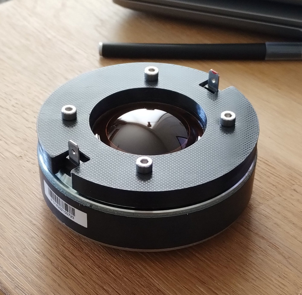

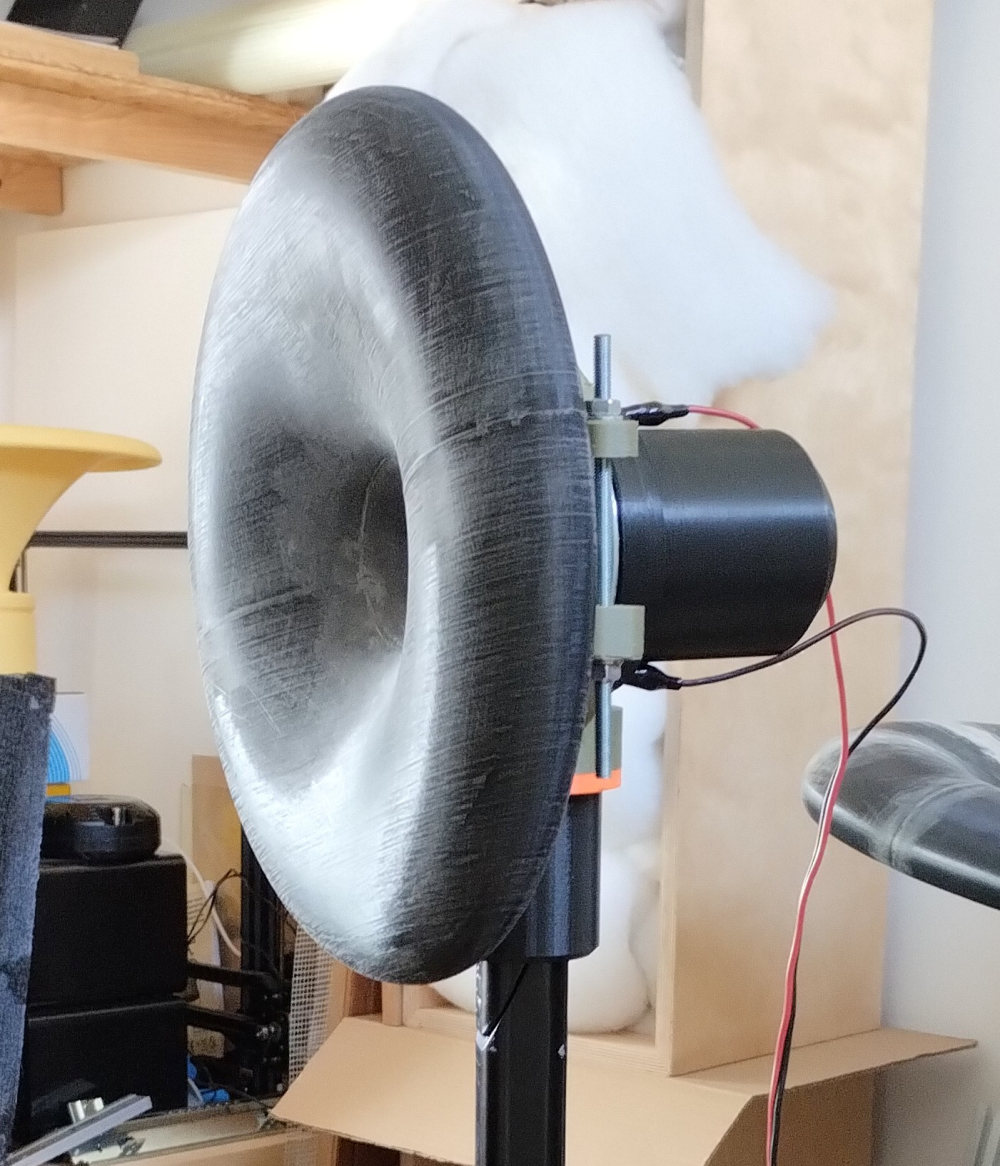

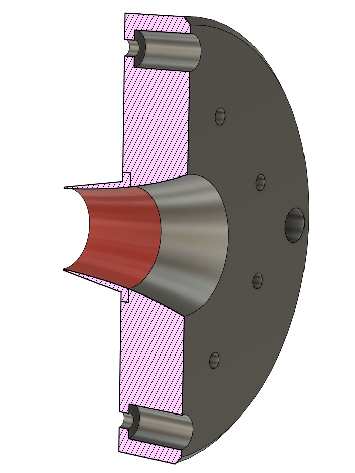

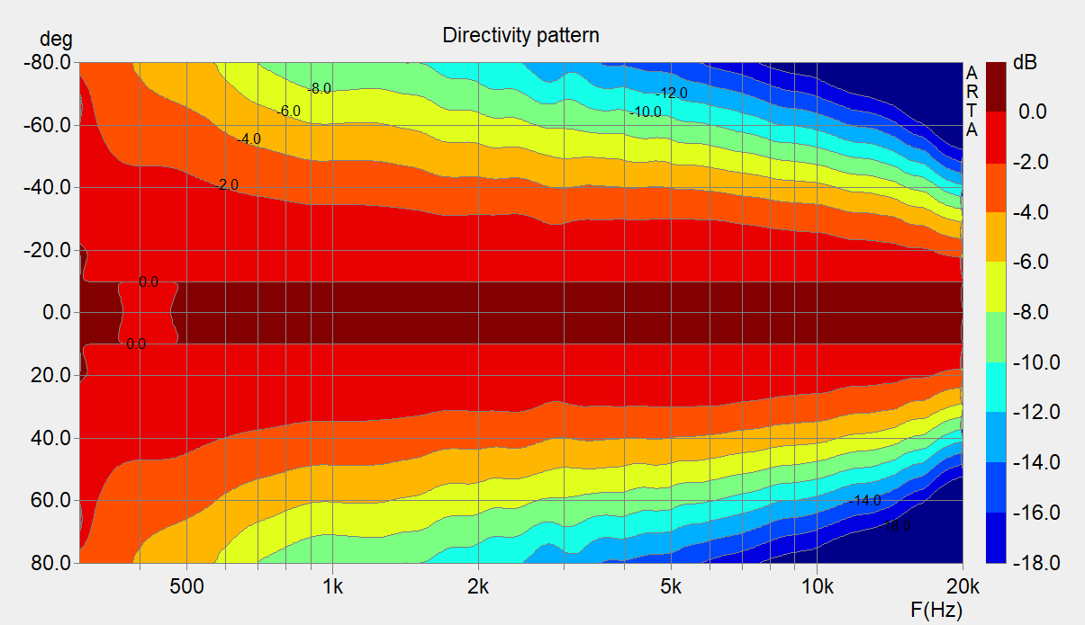

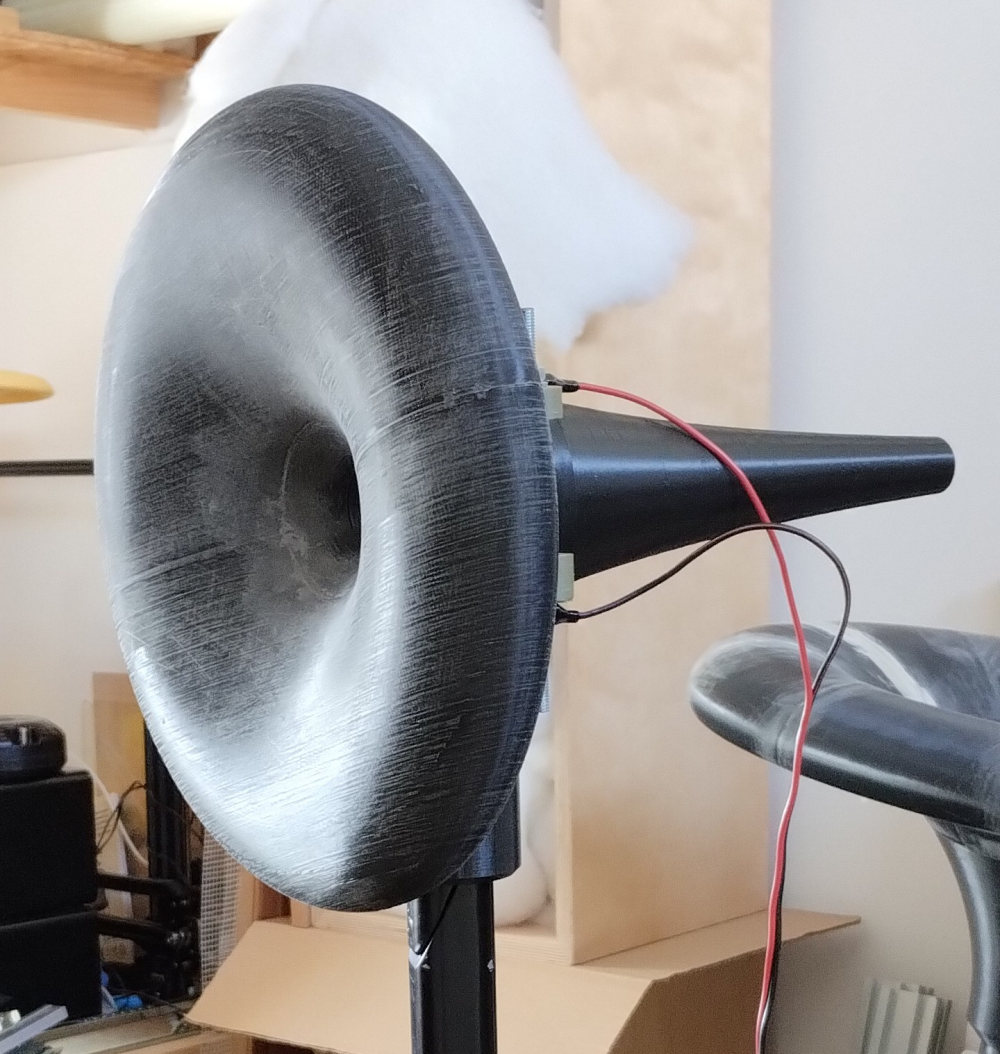

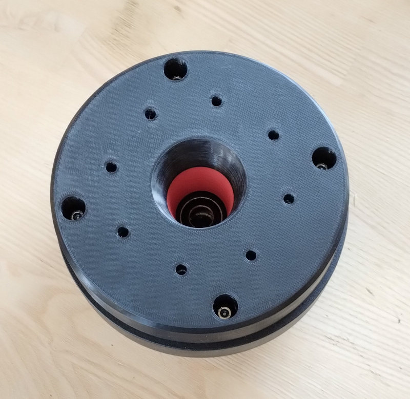

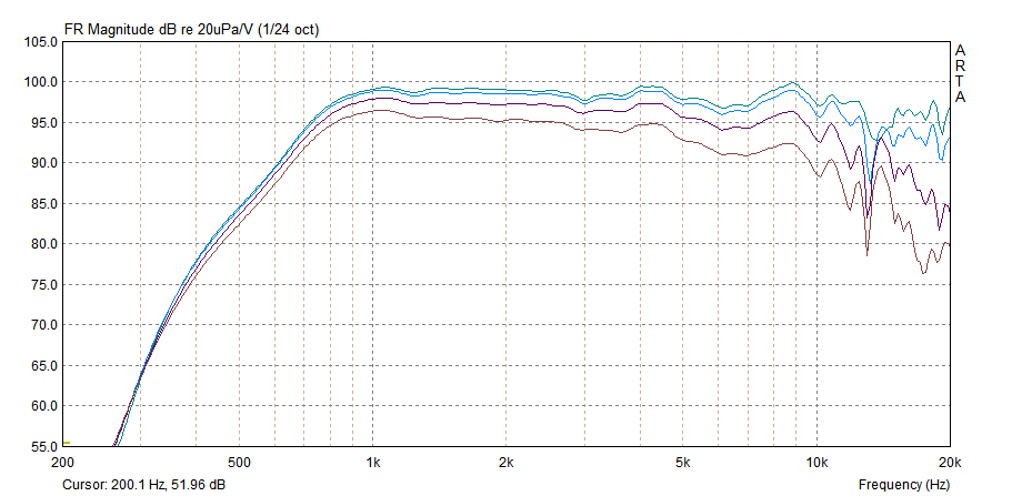

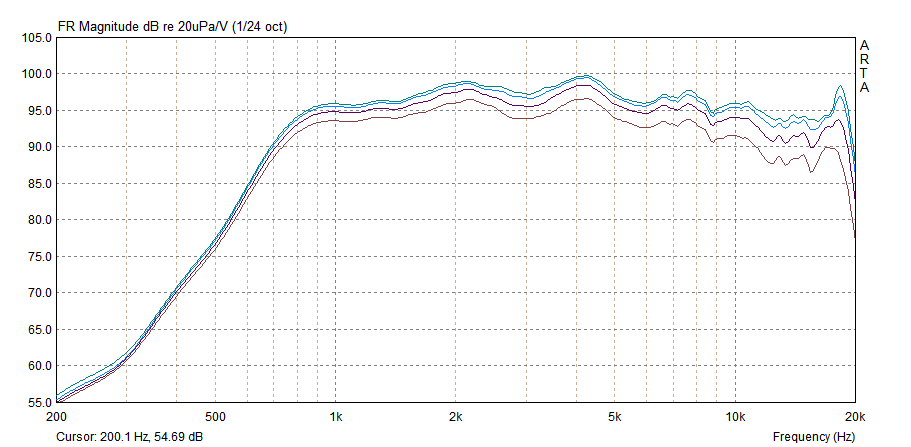

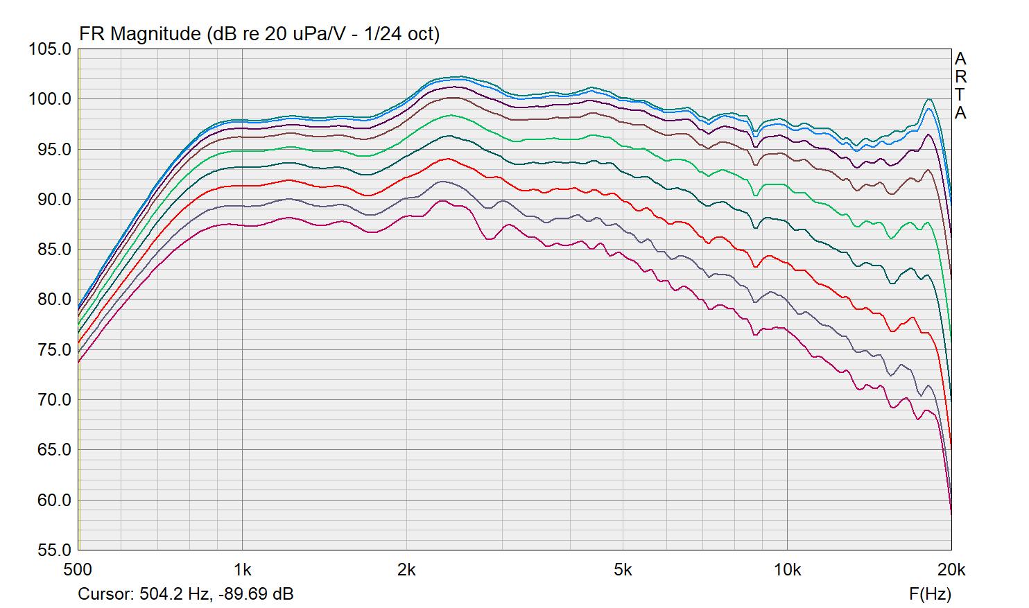

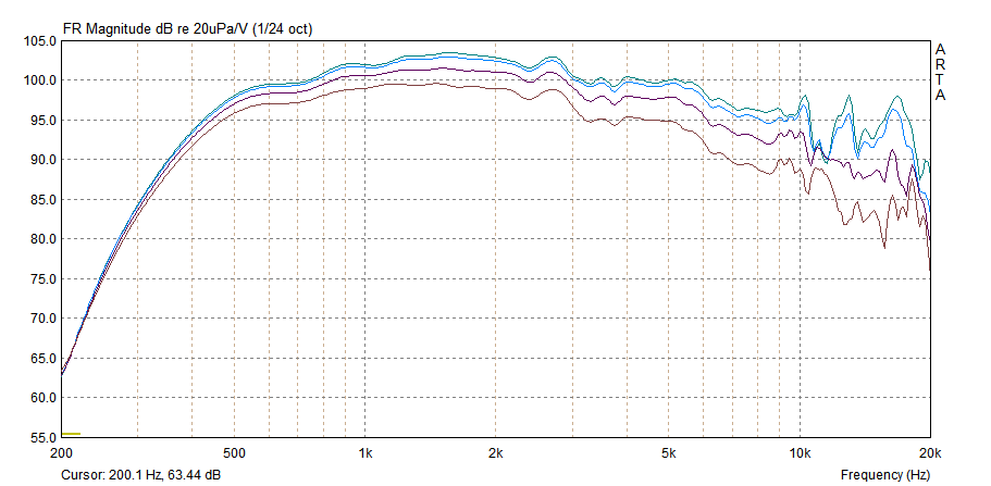

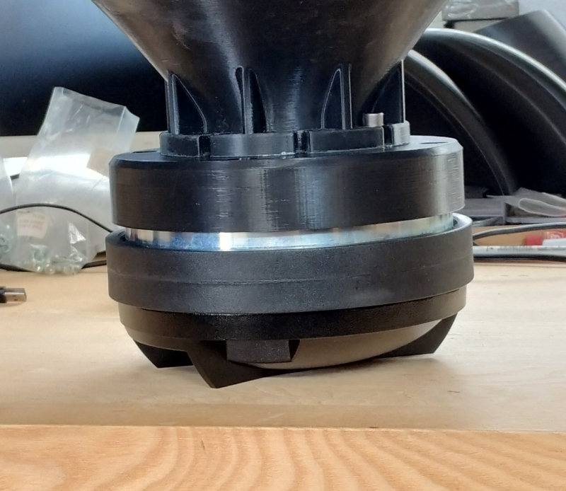

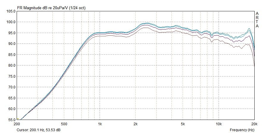

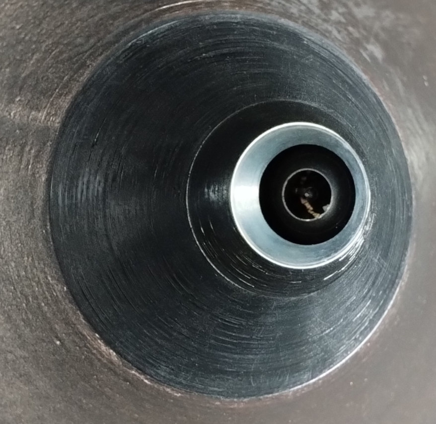

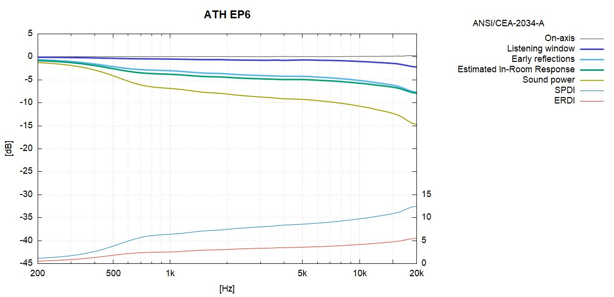

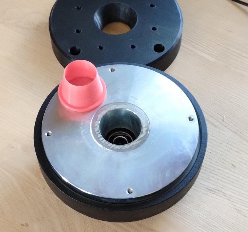

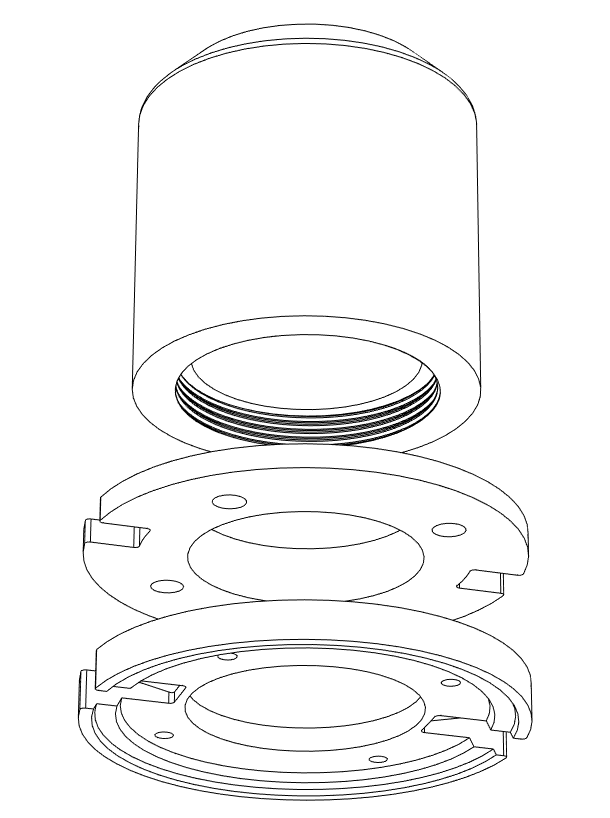

First try with a Selenium D3300Ti, originally a 2" driver, here made effectively a 1.3" (which is the phase plug exit).
The original mounting flange can be removed and a Gen2 adapter easily made.
It's not bad at all, I actually quite like the results, for a 3" diaphragm.

Interesting you post this now. I have a pair of Beyma 750ti that I have been thinking about doing this with. I was going to ask about this here but see incredibly little done with 2" compression drivers.
Is there a particular reason you tried this 2" driver or did you have it lying around?
1.5" 18Sound ND4015Ti2, 4" diaphragm.
A520G2, basic 1.5" adapter.
