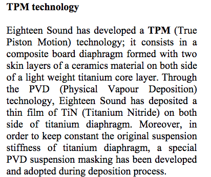

The TiN is applied to both sides of the diaphragm to stiffen it, but it's titanium suspension is masked from the TiN vapor deposition to allow it to maintain it's original flexibility.Cool, looking forward for the pics.

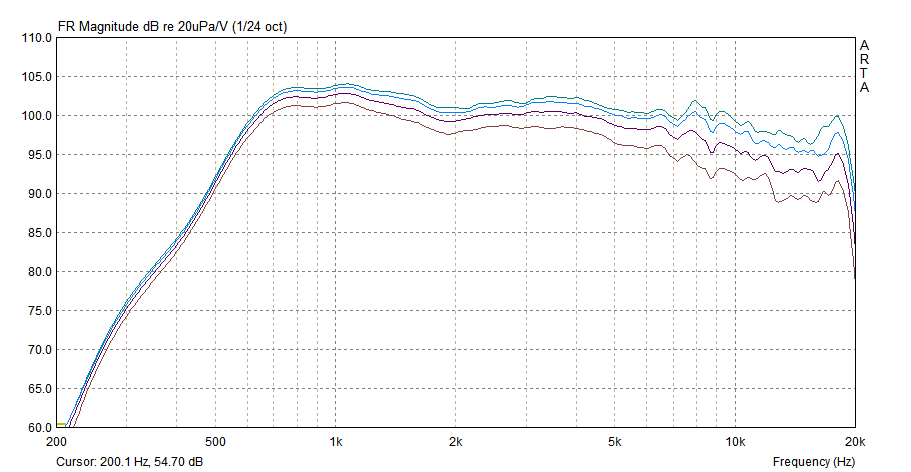

Eighteen Sound works with TiN titanium nitride coating that is applied to the convex side:
https://www.eighteensound.it/en/technologies/tmp-true-piston-motion/
Pretty impressive reduction in decay time.
The smoothness comes with a sensitivity reduction, reduced power capacity and only 0.1mm Xmax.Thanks! So the surround is not flat, interesting.

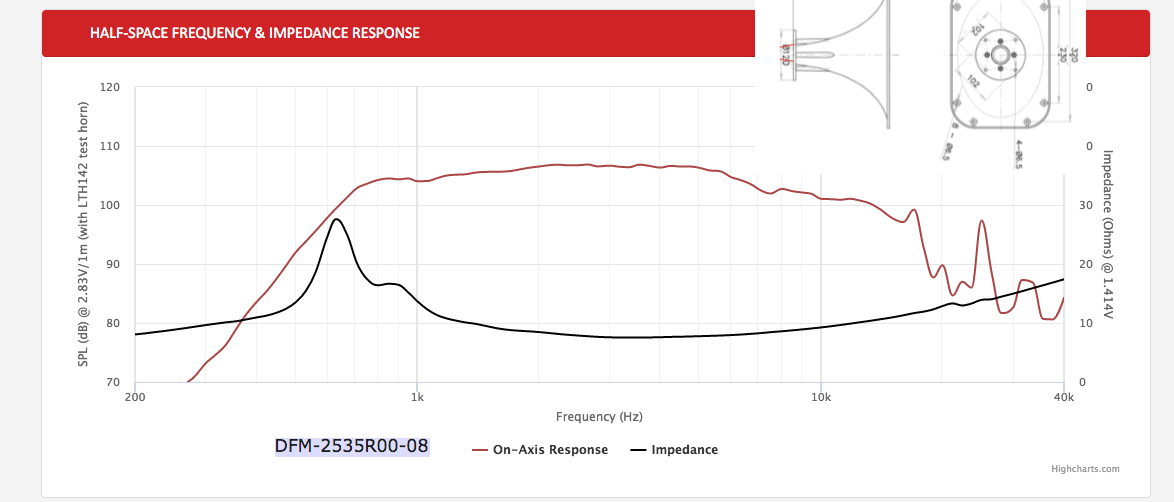

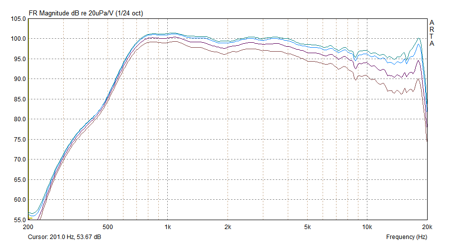

(DFM-2535R00-08 measured with A520G2 waveguide)
Using a LTH142 60x50 tractrix horn (presumably with a 1.4" to 1" throat adapter) it's sensitivity is ~105dB at 1kHz.
Rated at 30 watts (1500Hz-15kHz) ~120dB at 1kHz may be the limit, assuming the diaphragm would not be hammering the phase plug at that level.

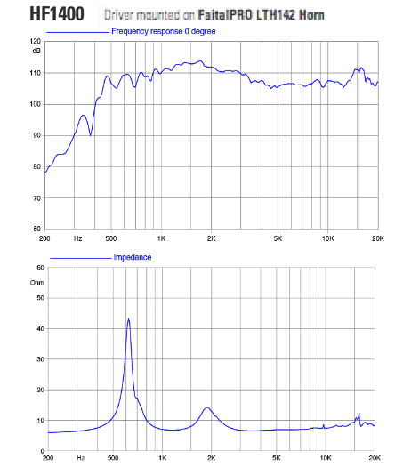

By comparison, the 100 watt Faital HF1400 is ~5dB more sensitive at 1kHz on the same horn:
That said, if you don't need the headroom a typical compression driver has, looks like a bargain!

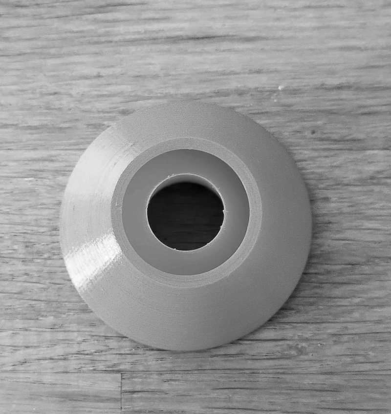

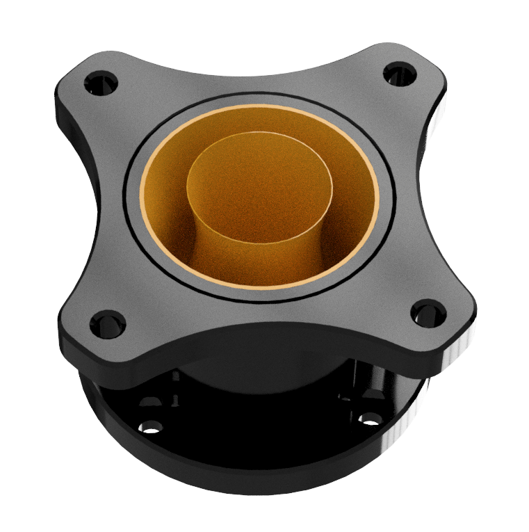

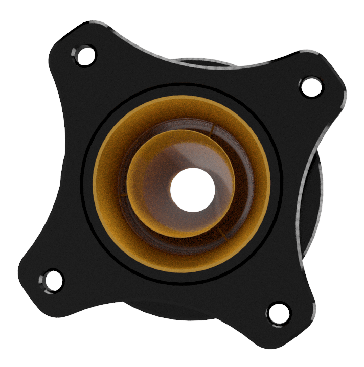

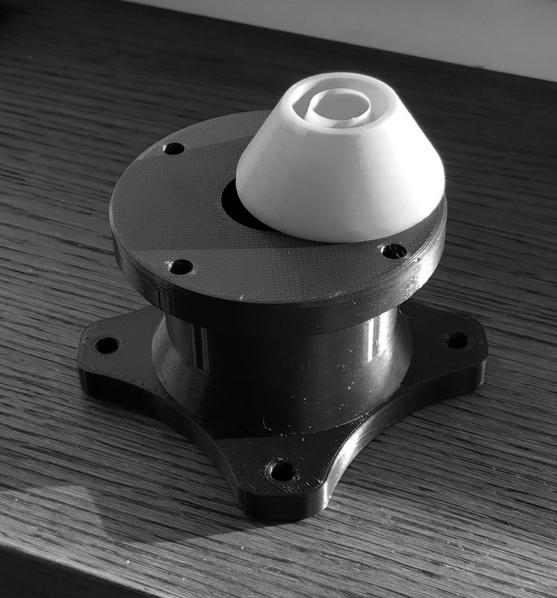

I'm giving the shaping plug a second chance. The 1" Lavoce driver seems to be coherent enough in the top octave for this to work, so there's hope.
For the start, this is still a shorter one to verify the exit wavefront shape. It's simply a Gen2 adapter -

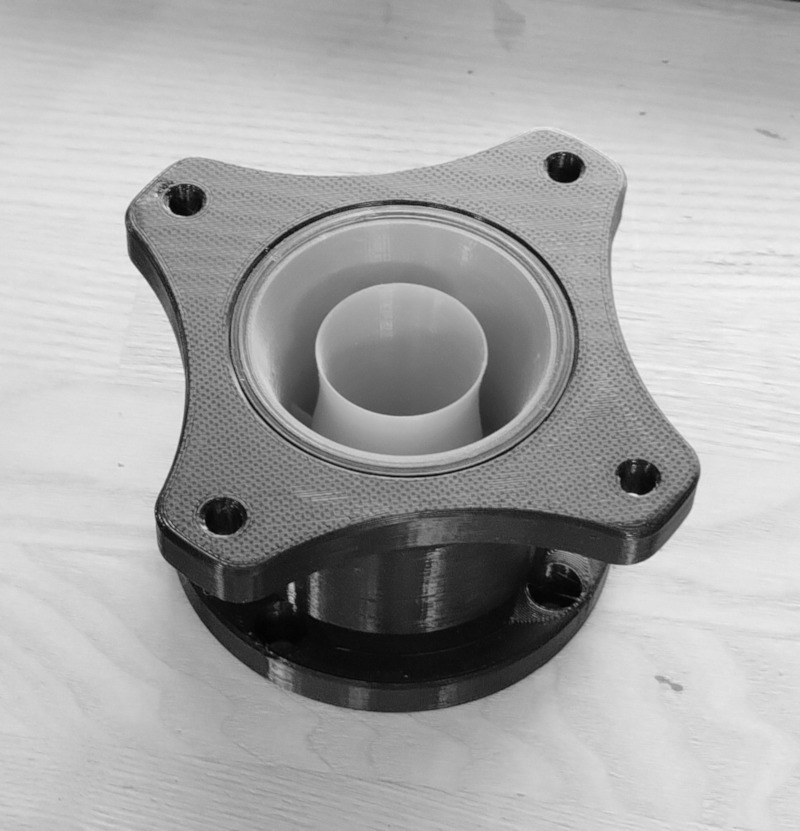

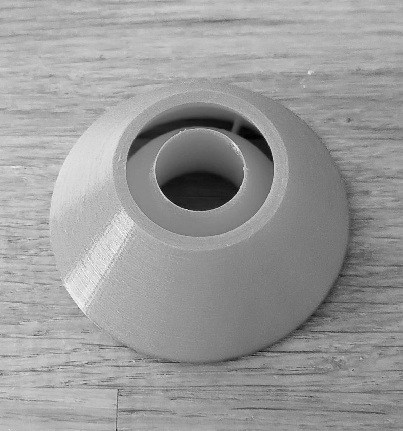

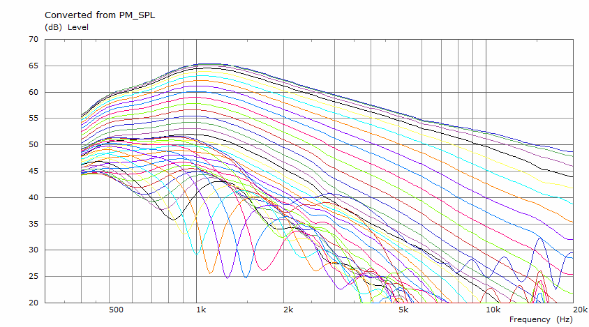

The shaping plug assembled and measured with the A520G2/DF10.171K.
Could be worse.
This is not so different from the standard matched adapter (which is good):
Now it can be worthwhile trying something a bit longer...
Could be worse.
Isn't that too soft?For rubbery stuff there are products like this, fairly available in small quantities and low cost, it's natural rubber latex emulsion if I'm not mistaken https://glorex.com/en/latex/112425-latex-moulding-emulsion-200ml.html
Not bad! It looks pretty consistent on and off axis 🙂The shaping plug assembled and measured with the A520G2/DF10.171K.

Pretty interesting how it disperses a bit of the peak at 18k
I also have a simulated version with further improved directivity above 6 kHz but that showed a worse stability of the calculation, with some visible impedance issues not possible to get rid of (probably actual resonances). It has the center channel a bit smaller at the exit - it can actually be a form of diffraction that improves the directivity, hard to say. I will surely print and test it as well, the core of the plug is replaceable.
