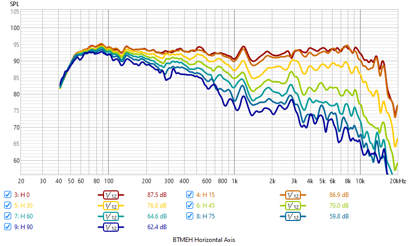

Still very new to Ath, but I've always wanted a half decent portable Bluetooth speaker and figured it would be a good project to learn with. There's still some issues to work out with the prototype but overall I'm quite happy with it. Because the horn cutoff was about 1100hz, I sized the woofer taps accordingly to match that cutoff with an acoustical crossover allowing for an 80hz LPF to flatten the 6.5" drivers response. Using a DH350 compression driver paired with 2 6NDL38s and 2 SB Acoustics passive radiators. Cheers mabat for the development.

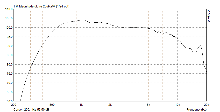

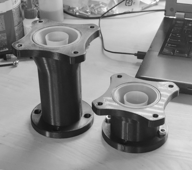

Speaking of the smaller Peerless CD, this is measured with a longer shaping plug:
There's still some issue (loss of output) above 10 kHz, not predicted by the simulation, I suspect some mechanical problems.
... Ah, now I see the problem -
This is not good, something is obviously wrong / not as predicted.
So much for the shaping plugs, I think I'm going to leave it for another while...

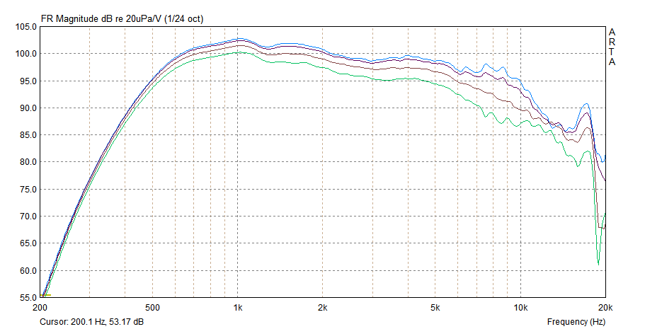

It may be that the two channels have some internal loss, each different. Next time I can try to insert some damping into one or the other. I'm trying to simulate it now, by giving different weights to the individual channel sources, and I can see a similar pattern. That could still save the day. Not holding my breath though.
Also, the vane may not be perfectly air-tight. It would need to be immersed into a thin epoxy or something, I guess.
Funny thing is that it sounds still good.
Stuff in the last octave probably doesn't audibly impact musicality all that much, I imagine. But, a straight line looks much better than a droop or wiggle, of course. 😉

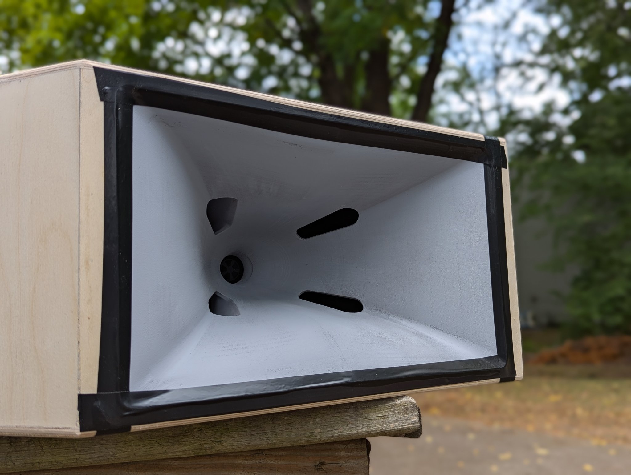

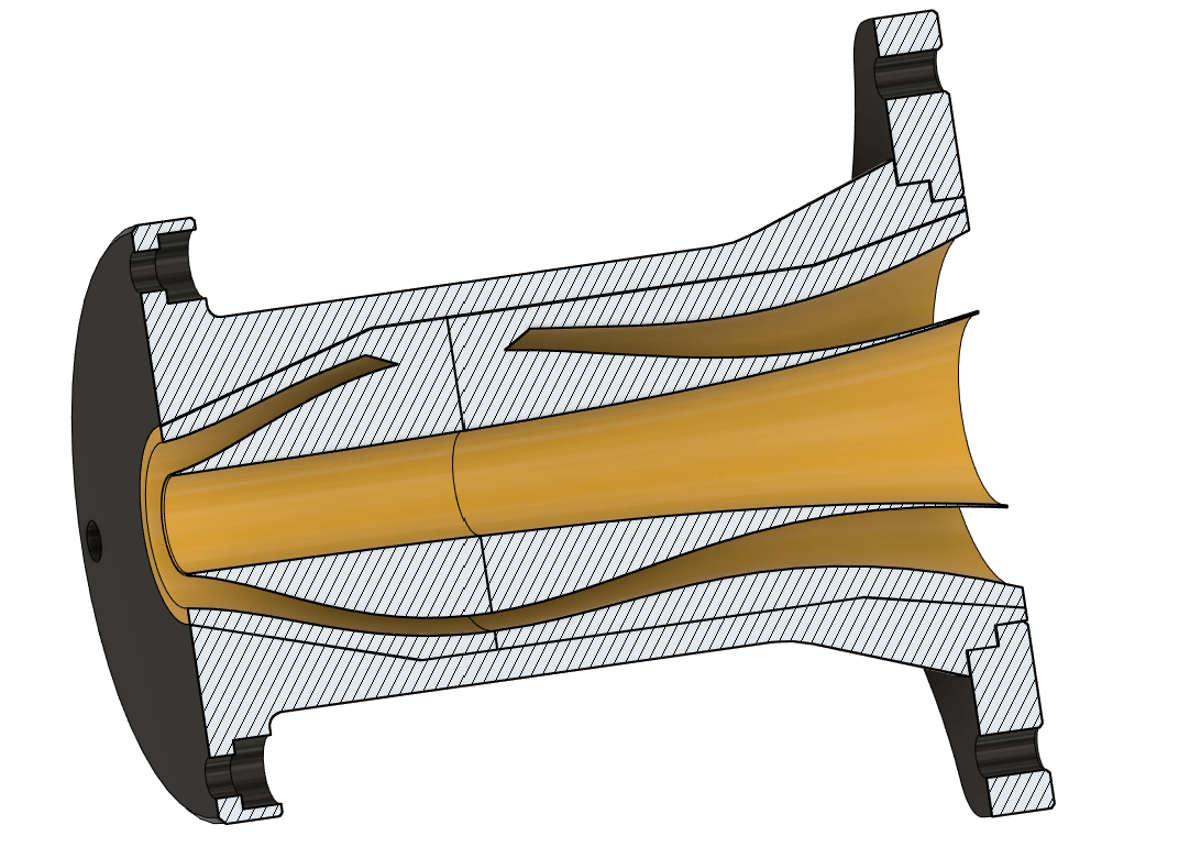

This is the longer shaping plug -
It has an exponentially increasing cross section area. The low-frequency gain is not negligible.
The BEM sim says the directivity can be the same as of the shorter one, provided that everything works as expected 🙂
Thinking about it, the central-thorn version may be fundamentally better, since it is basically made of only one channel - no summing problems.

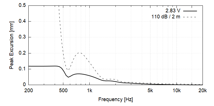

But even if the required excursion was reliably known, what does it tell about the capabilities of a particular driver? What portion of its available excursion we can use without audible issues?
As we move lower in frequency, there is typically a sharp onset of the required excursion to keep a constant SPL, like in the simulation example below of an extended throat, including a simple CD model.
I think that this will also be the frequency below which the distortion will just ramp up quickly. That's probably to fastest way how to get this information - to measure the harmonic distortion.
