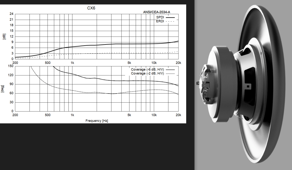

It’s quite clear that diy speakers in Germany is a widespread hobby.
This is the tweeter on the coaxial mabat is working with: https://audioxpress.com/article/test-bench-the-140fcd-1-compression-driver-from-redcatt
I asked the distributor of redcatt in Europe/Germany and the bigger coaxial with attached center horn is easy to remove if one like to fiddle with those.

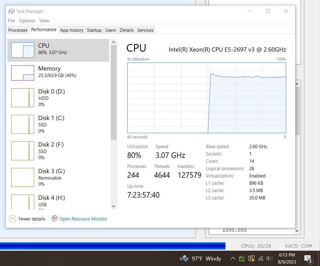

Now that CPU are reliably exceeding ten cores, I noticed something interesting with ABEC. It seems to tap out at 20 cores.
So it might be worthwhile to turn off hyperthreading on your Intel CPUs if you're doing ABEC sims.
I'm using a Xeon E5-2697 (14 cores) that I paid a whopping $39 for, and ABEC refuses to use more than ten hyperthreaded cores out of 14. (It shows up as "20" in the attached pic because hyperthreading.)

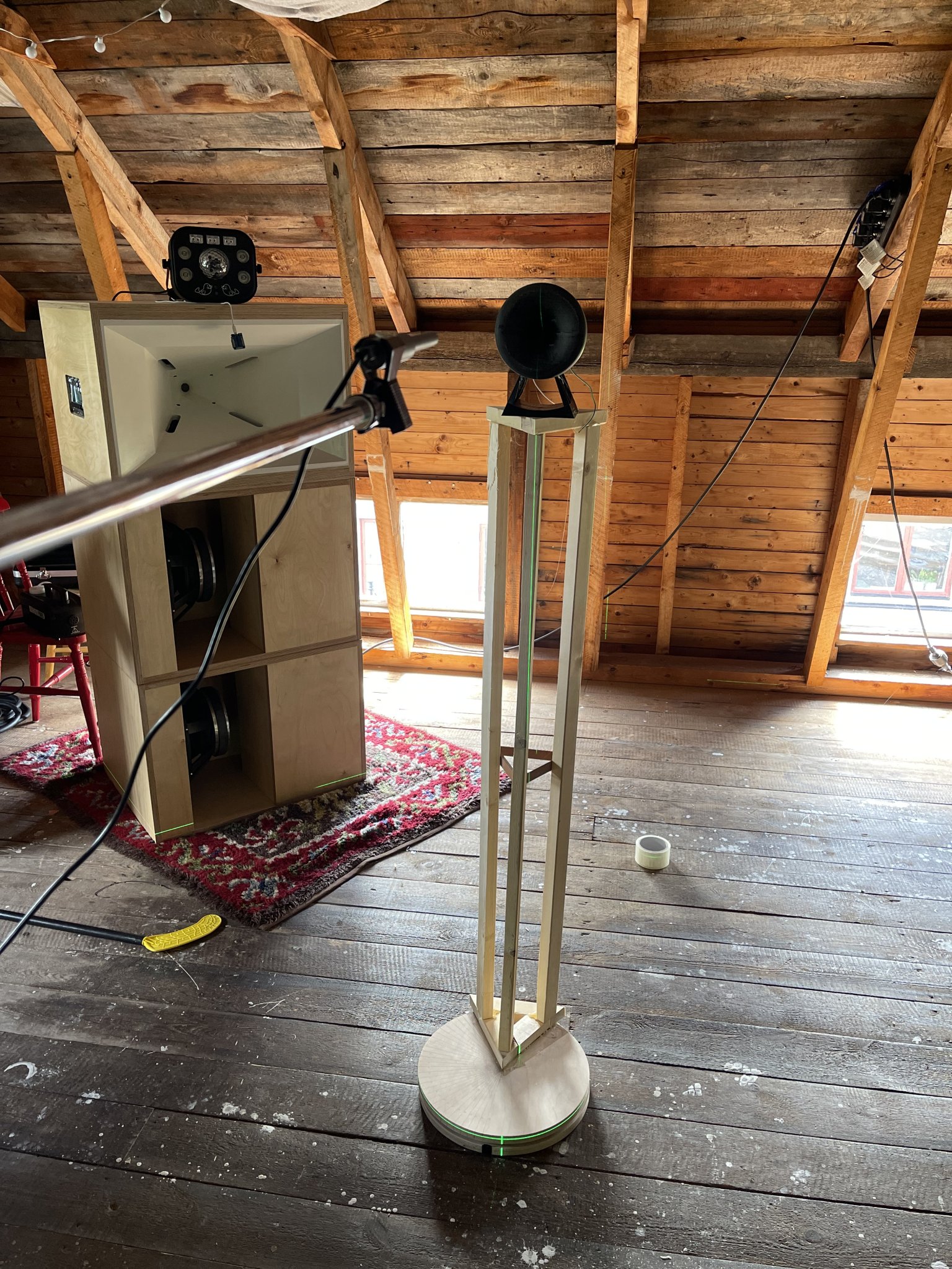

Hi, yeah sorry I noticed too late that the text was not accurate enough. I got your remark regarding about same thing earlier already, thanks straightening it up again.There is never a distance in any room where this is true. There is always a direct wave and a reverberant field, distance does not meld things together. The room and distance can have a significant effect on the timing of the direct/reverb, but no location has only reverb, there is always a direct signal which can be audibly filtered out in better and worse ways depending on the VER.
What I ment is perception of mine, sound coming from speakers direction is just different listening further away. I have simplified sound that localizes to direction where the speakers are, frontal sound, as direct sound. Being a hobbyist I'm not too familiar with exact meaning of words, mistake there. Now being corrected few times it should stick.
Further away I cannot perceive direct sound and room sound separately with my setup, they seem to be merged into one roomy sound coming from direction of speakers. There doesn't seem to be distinct room or direct sound, it's just one hazy blob of sound localizing somewhere direction of the speakers. Listening close enough sound seems to clear up, for some reason, localizes much more accurately and timbre changes some. Moving between the two distances, it appears as if influence of local room disappears when close enough.
Comparing the two listening distances perceptually, frontal sound appears to be either very roomy or opposite, rather direct. So, it's just uneducated trying to describe what's hard to describe 🙂
Have you tried to increase the Abec process priority? I have a program at work that never throttle up to its true potential until its priority is raised. The same application on a older processor always punish each and every core.Now that CPU are reliably exceeding ten cores, I noticed something interesting with ABEC. It seems to tap out at 20 cores.
1. Right-click on taskbar and select Start Task Manager.
2. Go to the Processes tab.
3. Right-click on the process you want then select Set Priority then switch it to what you want.

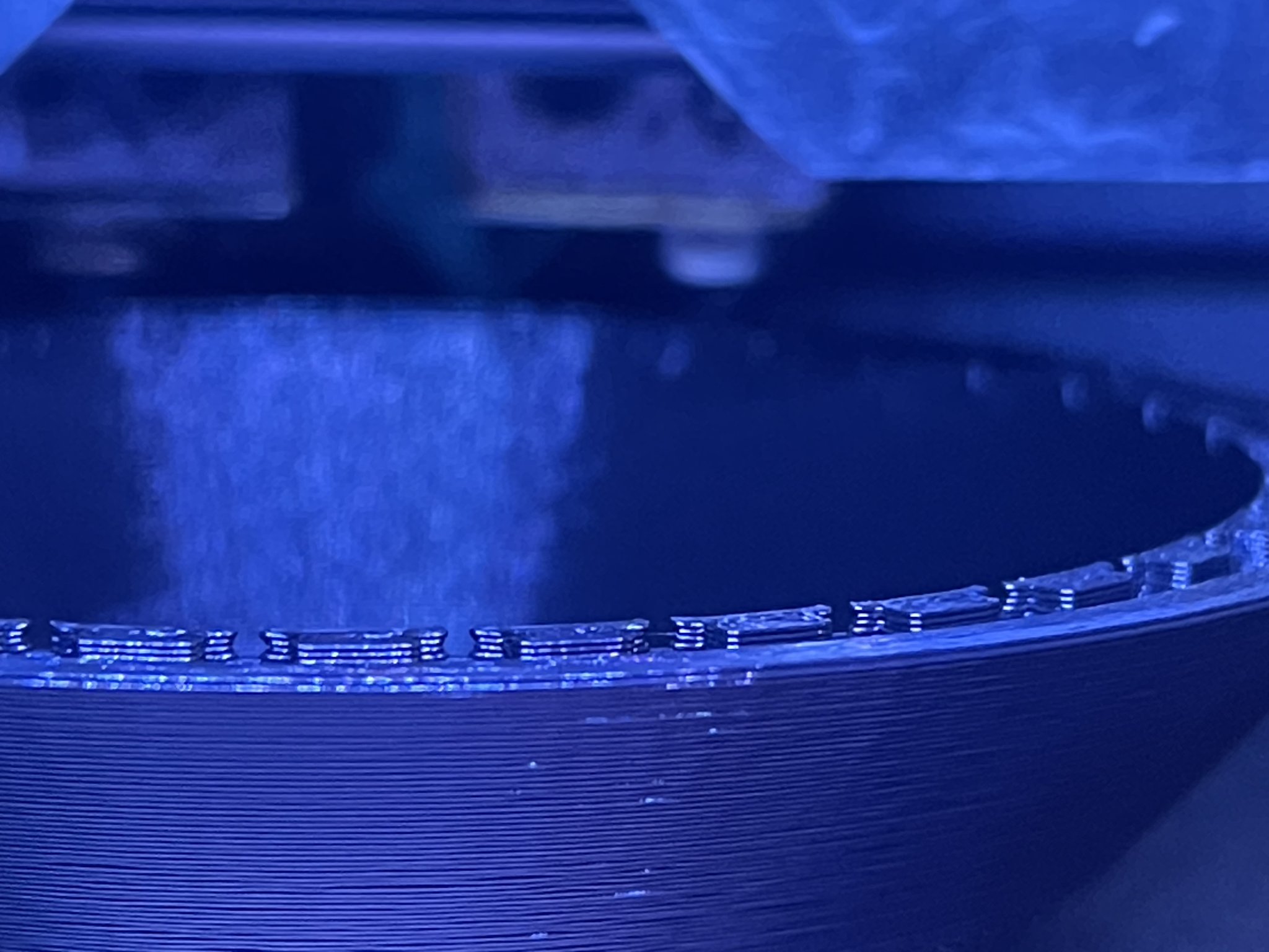

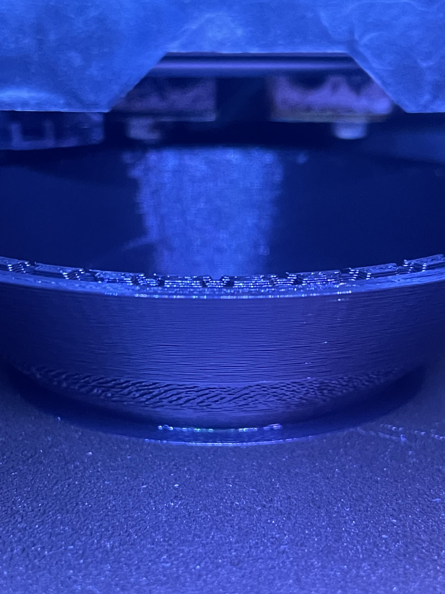

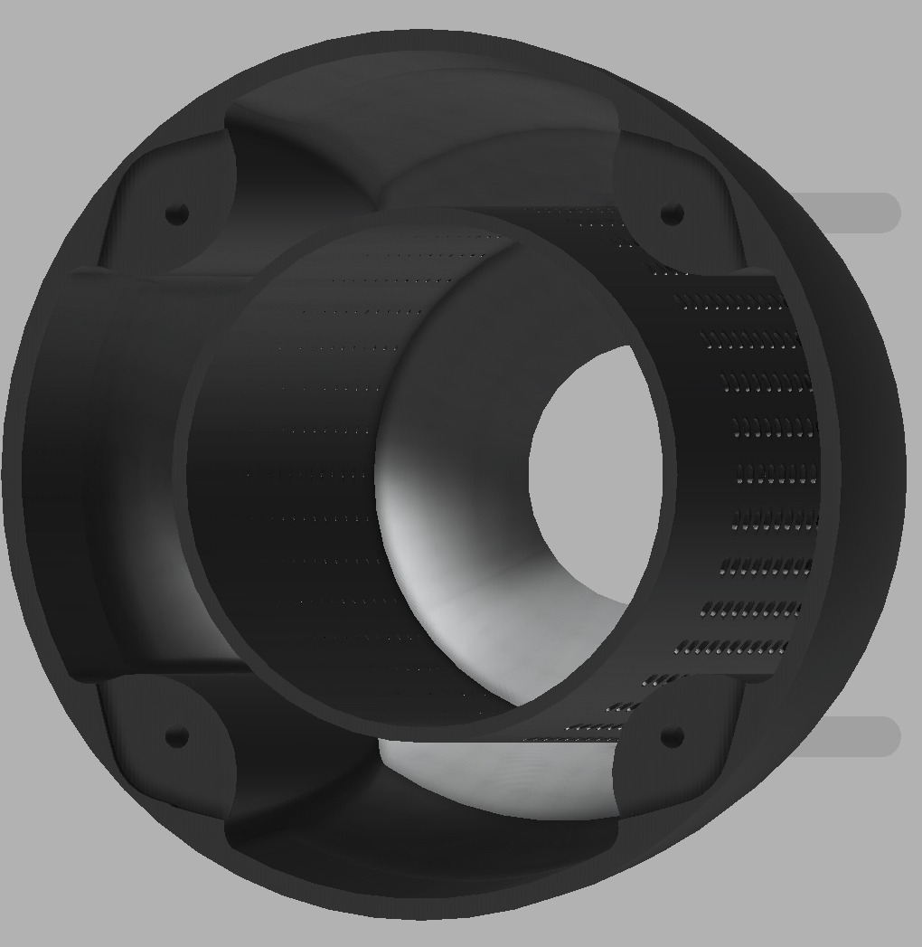

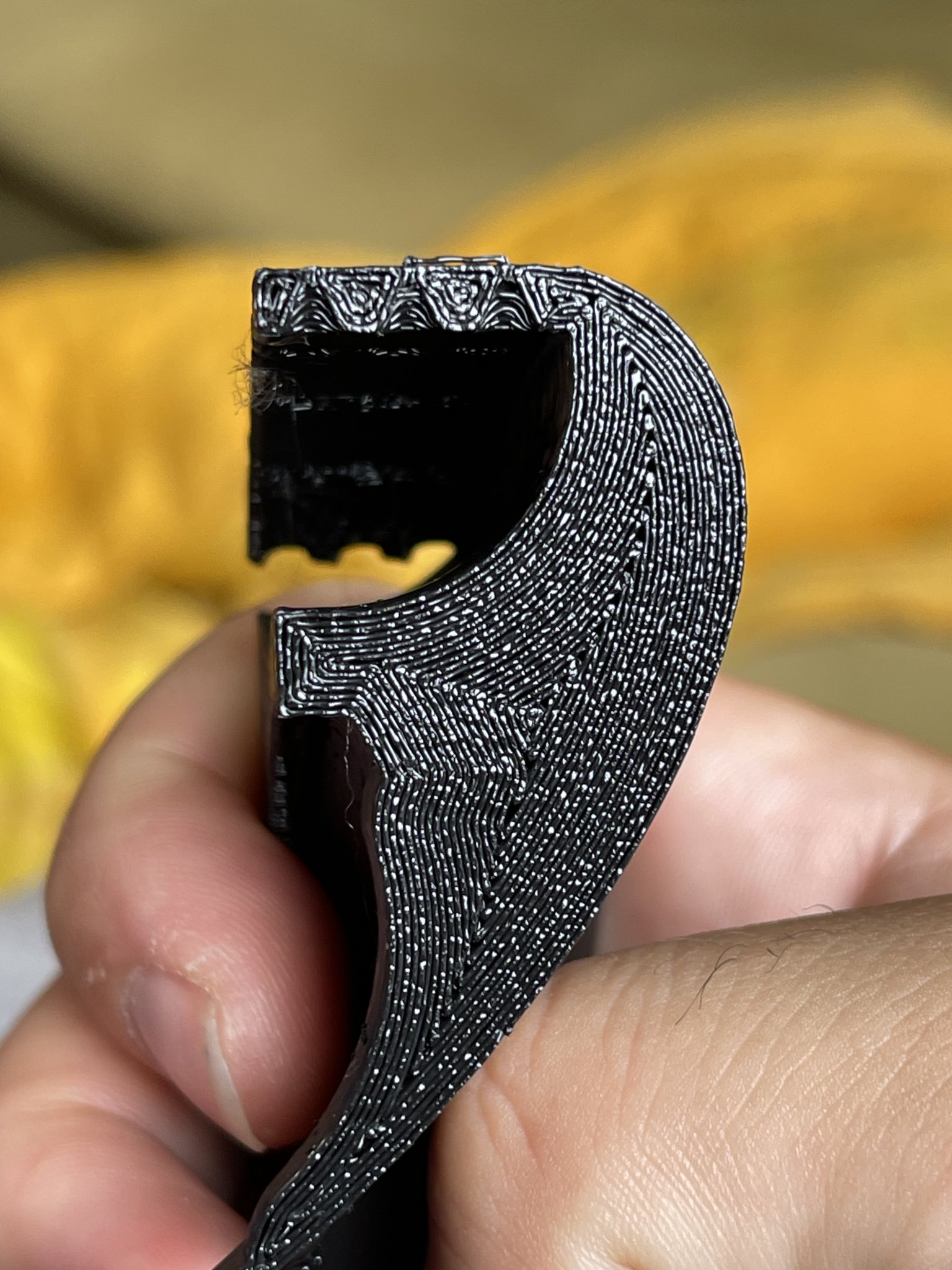

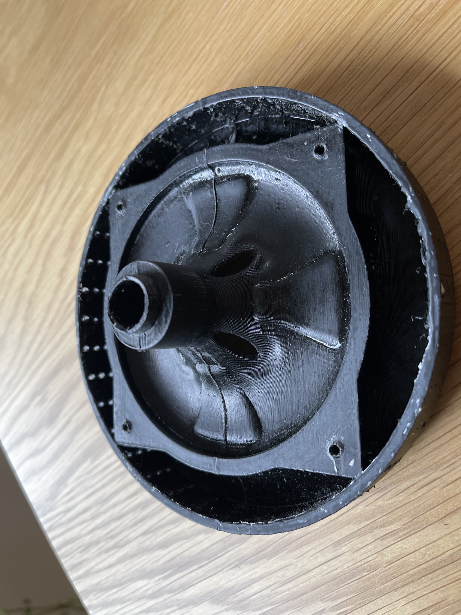

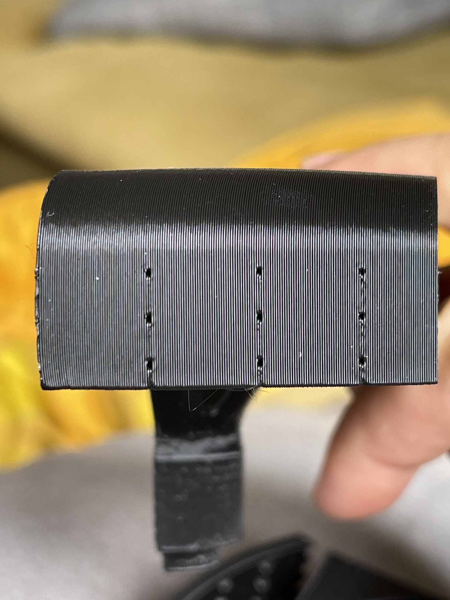

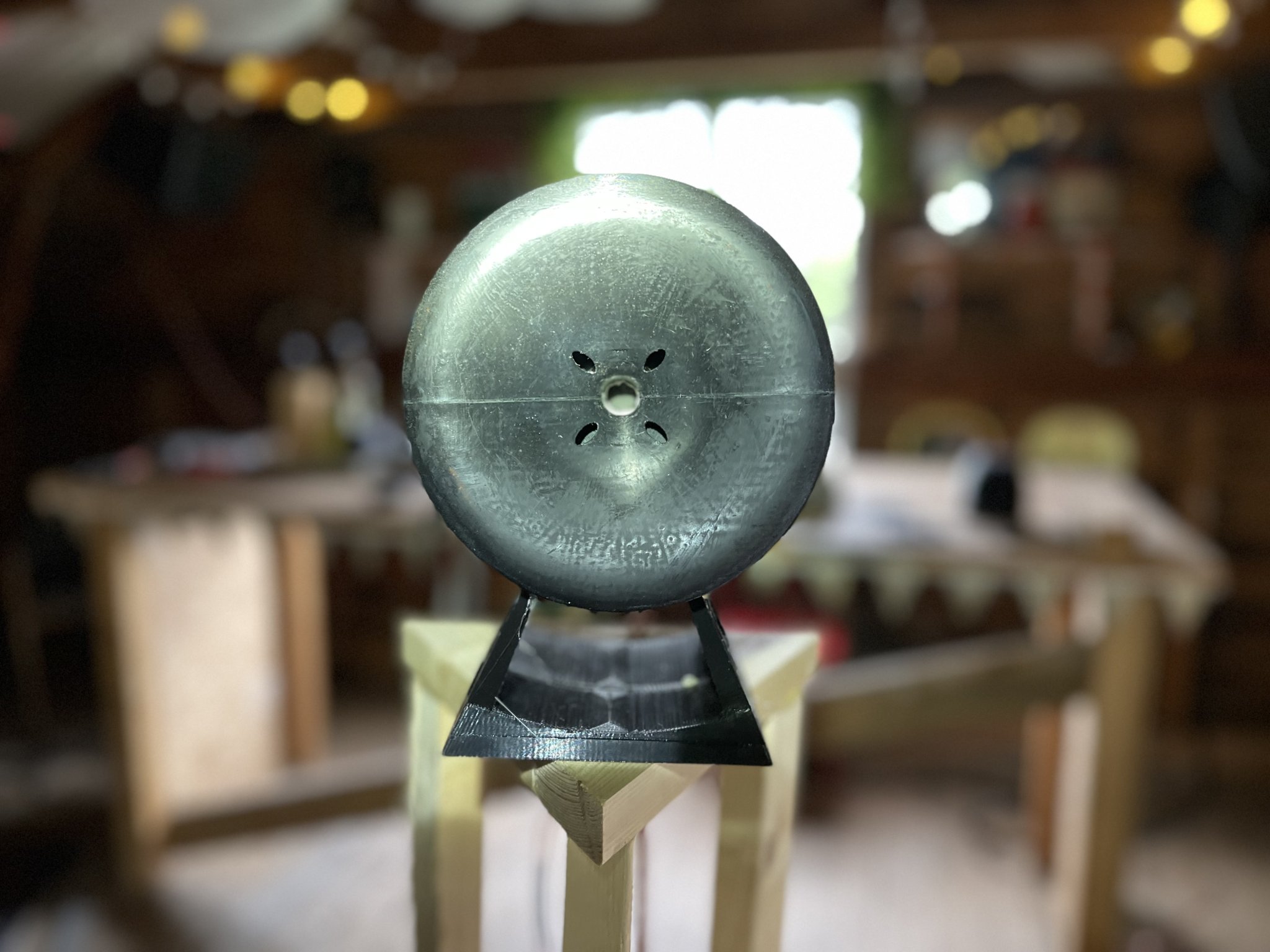

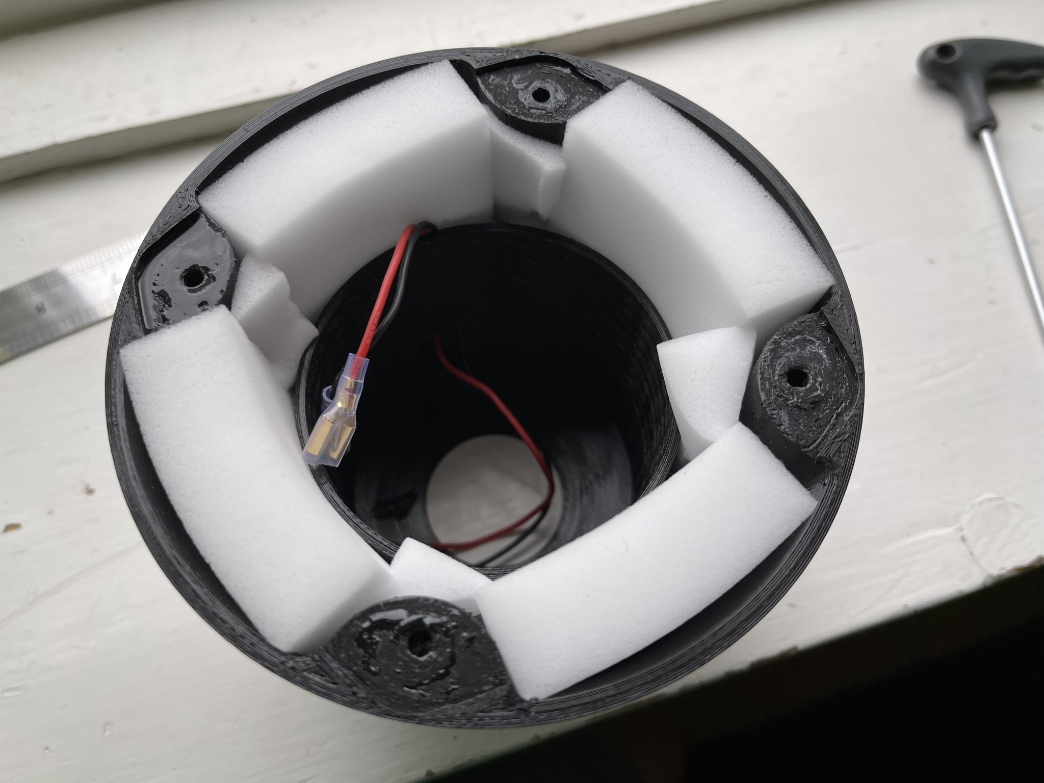

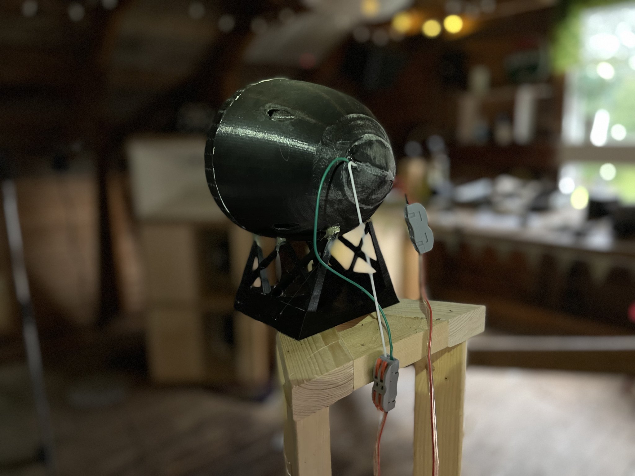

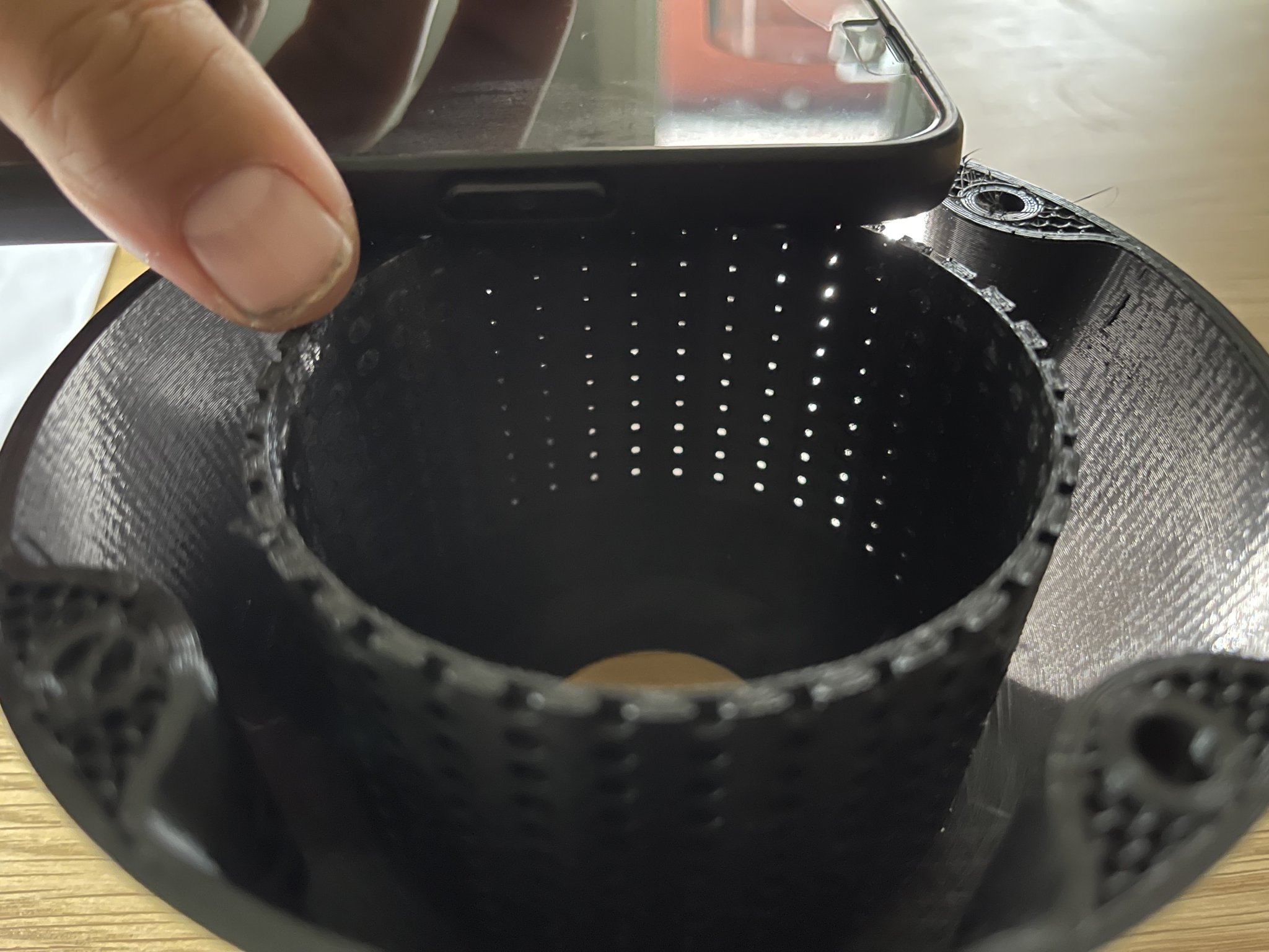

I’m not going to distract to much, but I’m continuing the work on making my tiny 4” coaxial with controlled directivity.
I have since the last time tried adding a center tube in the back chamber that is a press fit against the magnet with micro perforation like example C in this paper. https://mdpi-res.com/d_attachment/a.../acoustics-03-00031-v2.pdf?version=1625566551
So there’s three rows with 36 0,9mm holes close to the open back, then there’s 3x36 0,7mm, 3x36 0,5mm, 3x36 0,3mm.
The tiny holes is one layer thick on my 0,4mm nozzle. In the cad-model I made it 0,4mm.
So the idea was that before the sound can exit the back it needs to squeeze thru these holes first that ads quite a resistance.
Edit: ( didn’t think it through enough and the magnet actually blocks the 0,3mm holes and maybe some 0,5mm ones)
And to be honest I did this test because I was curious if I could print the mpp (micro perforated panel). And if it works it could be a more controlled way of adding flow resistance than fibers or foam. I checked the hole sizes with tiny drill bits. And it’s close but not perfect.
And because I believe that the actual distance to the opening in the back is too long for the range I’m trying to control ~500-2500Hz and the holes alone was not enough of a low pass.
I’m testing melamine foam to increase the low pass, and also I’m making a new waveguide with 3x36 0,5mm holes closer to the waveguide.

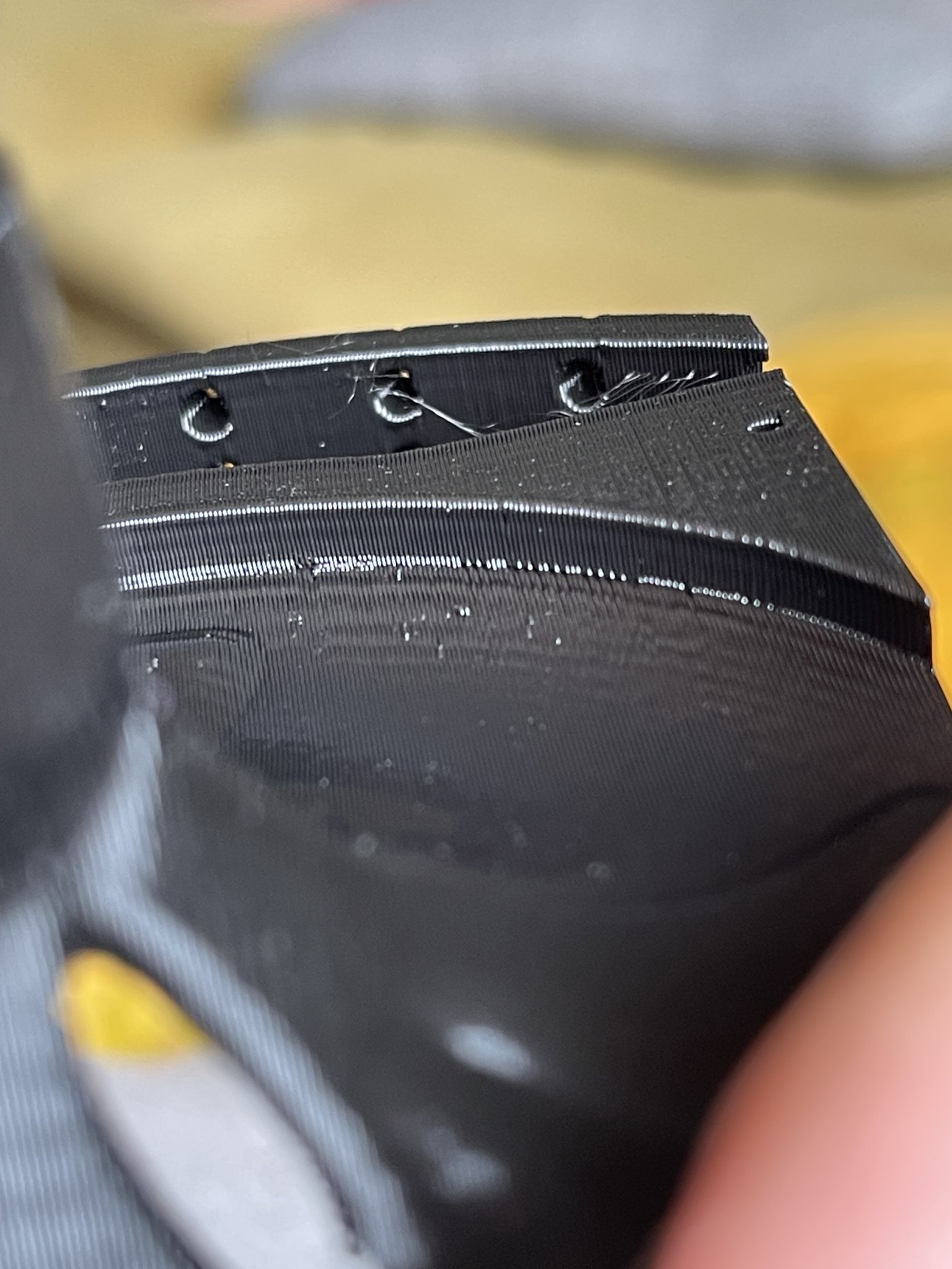

To late to Edit but I did a test where I loosened the screws so that there was a small gap between the waveguide and back chamber and this showed some potential and that’s why I’m trying the perforated side of the waveguide.

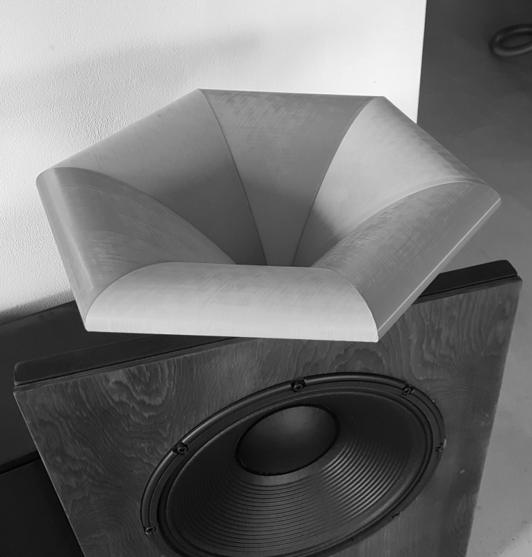

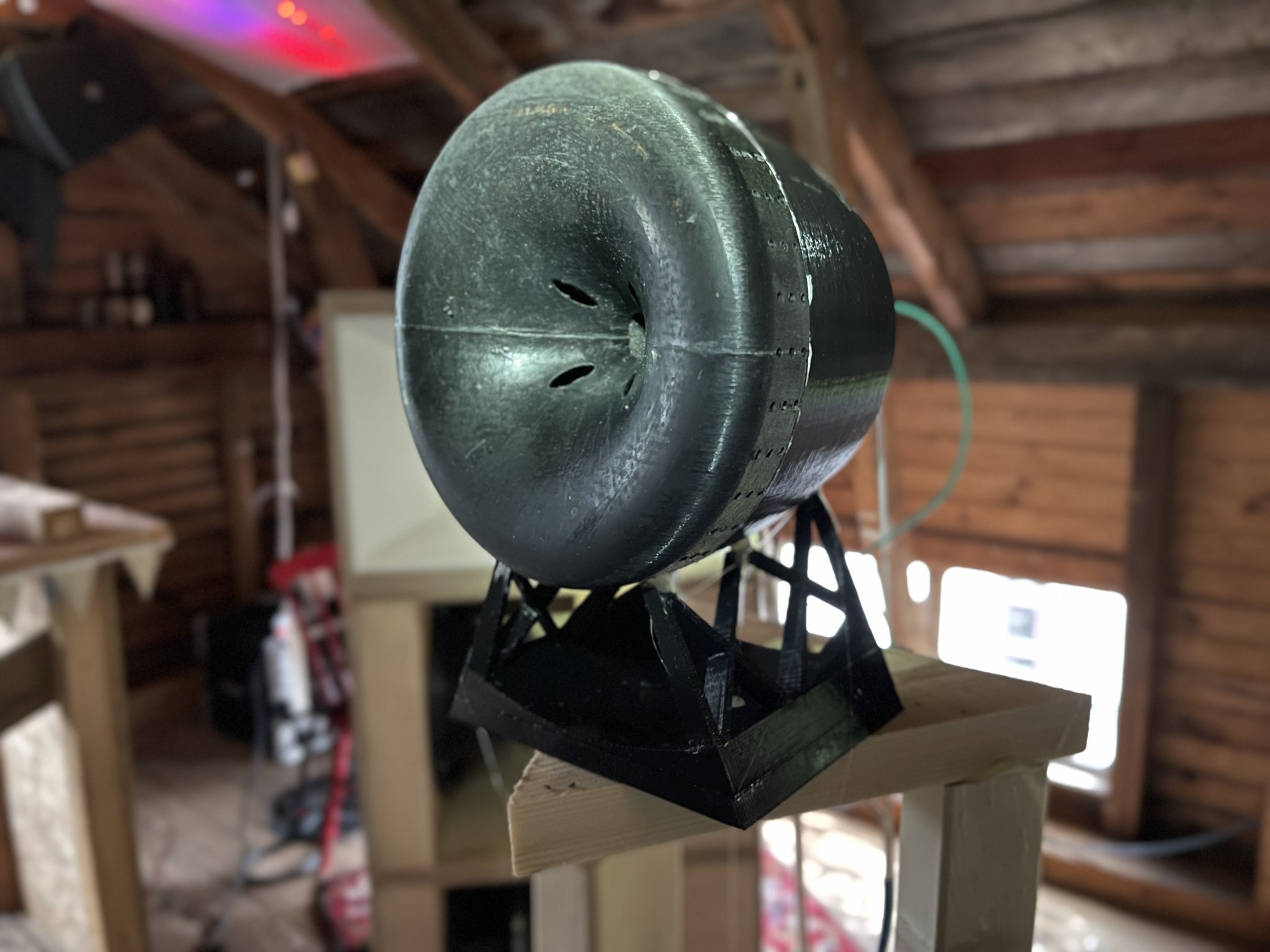

I'm slowly progressing with the ATHEX 460-36...
Compared to assembling a round one, this was a piece of cake.

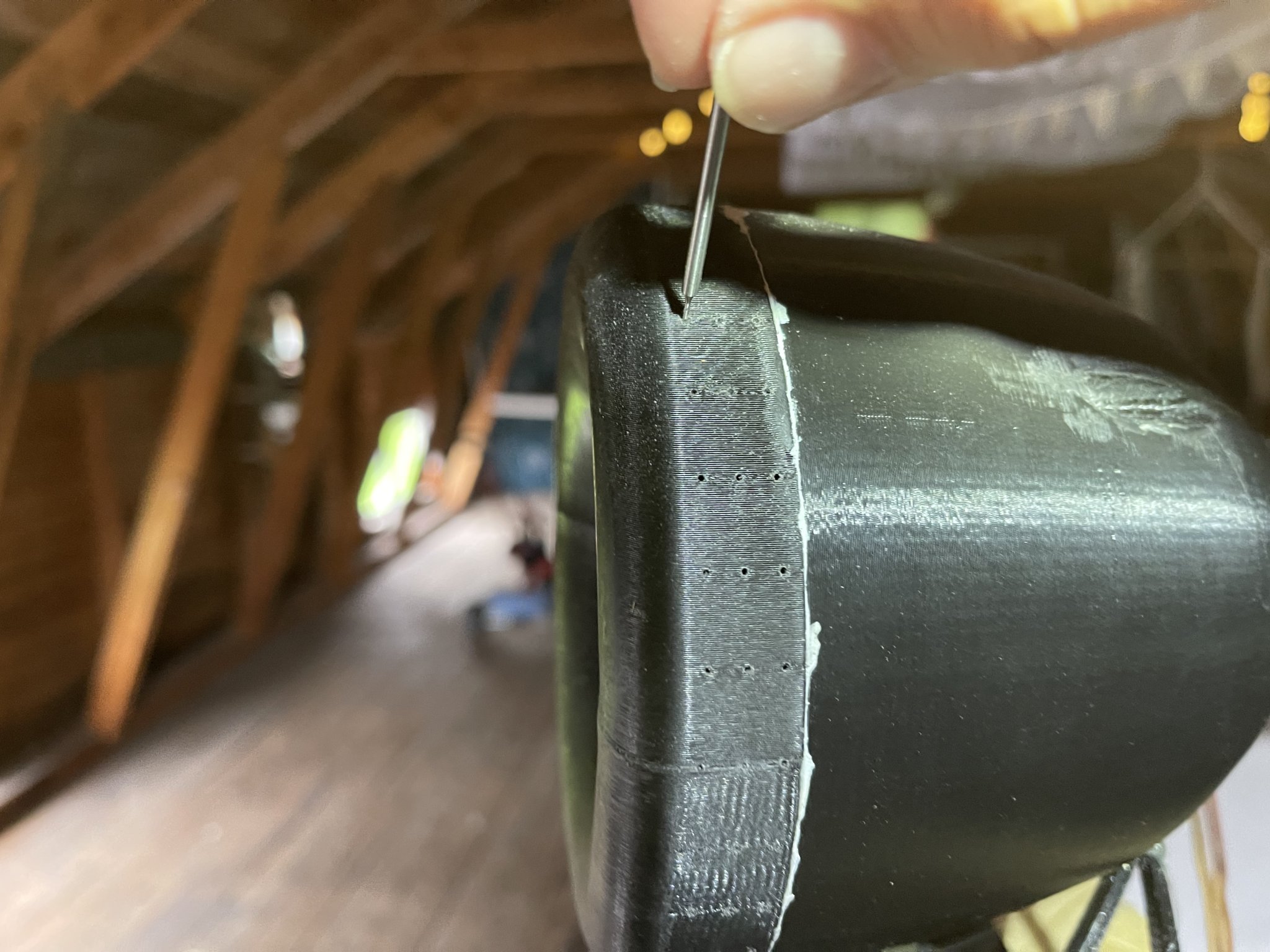

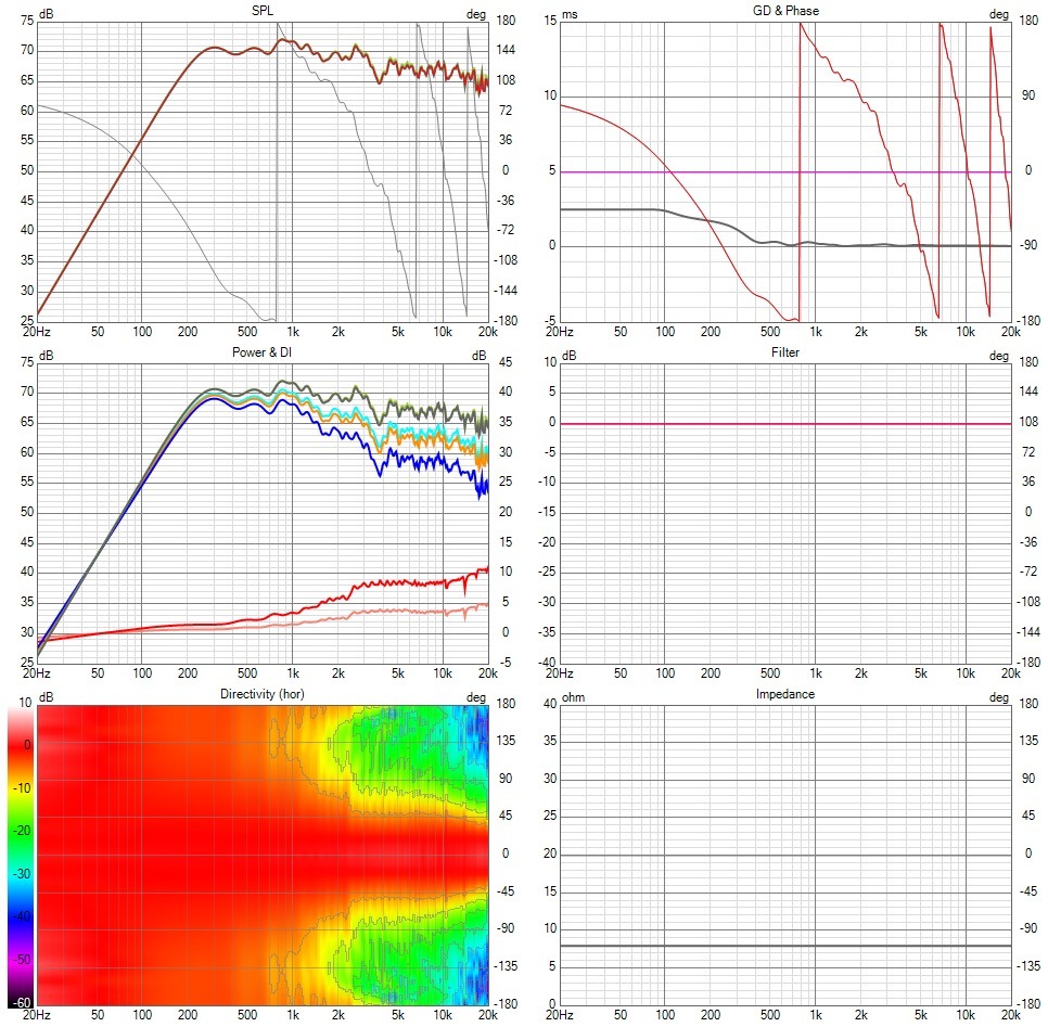

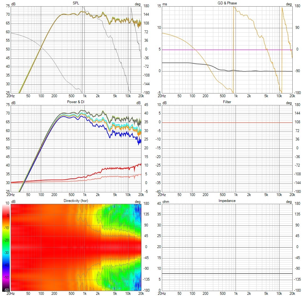

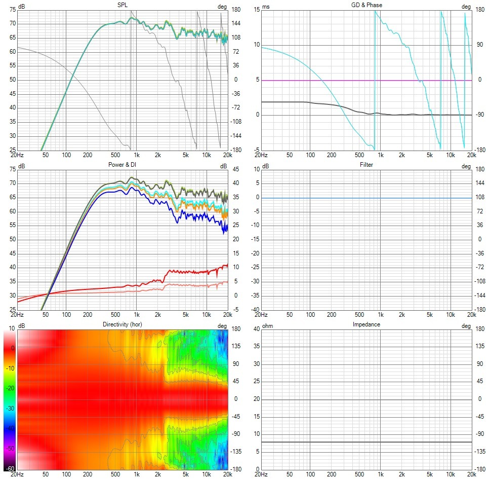

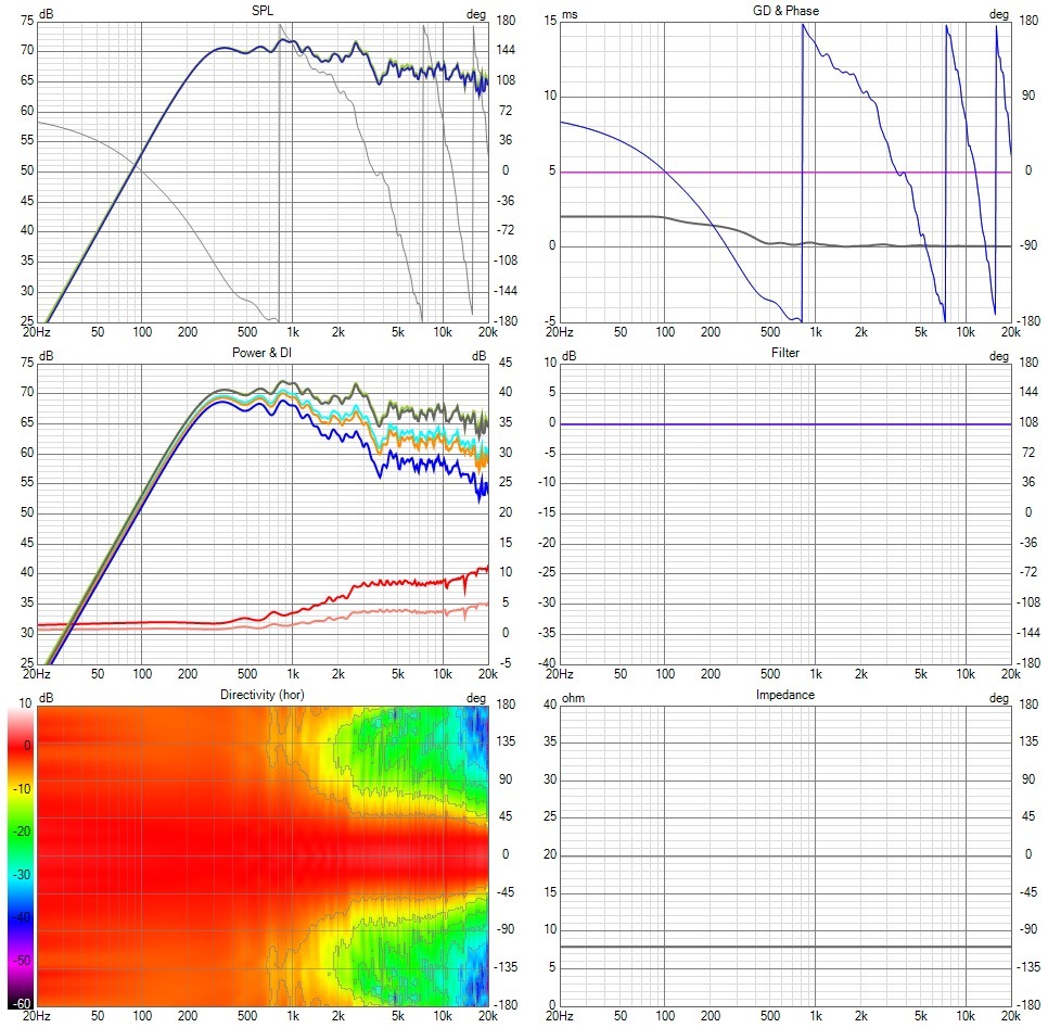

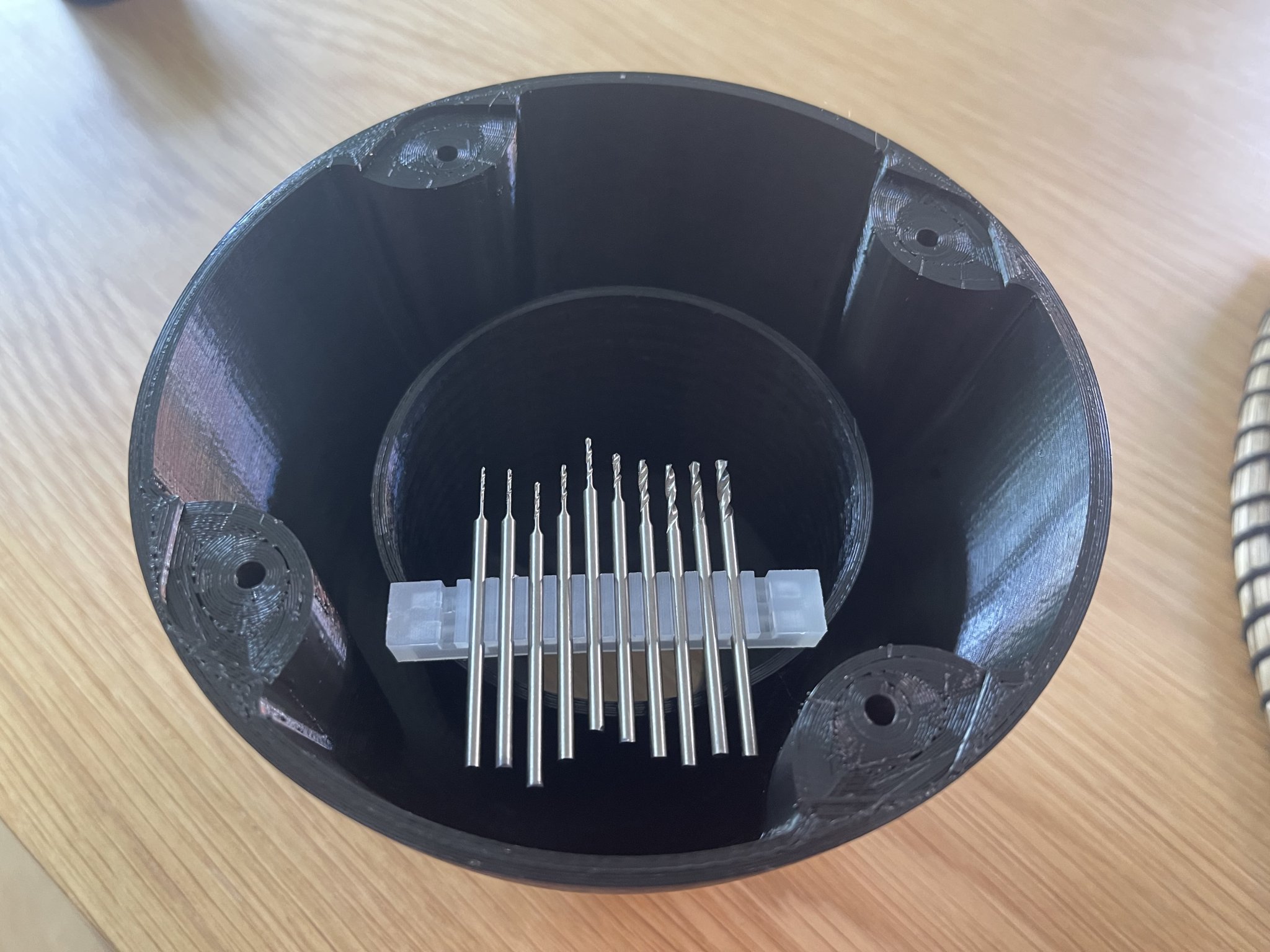

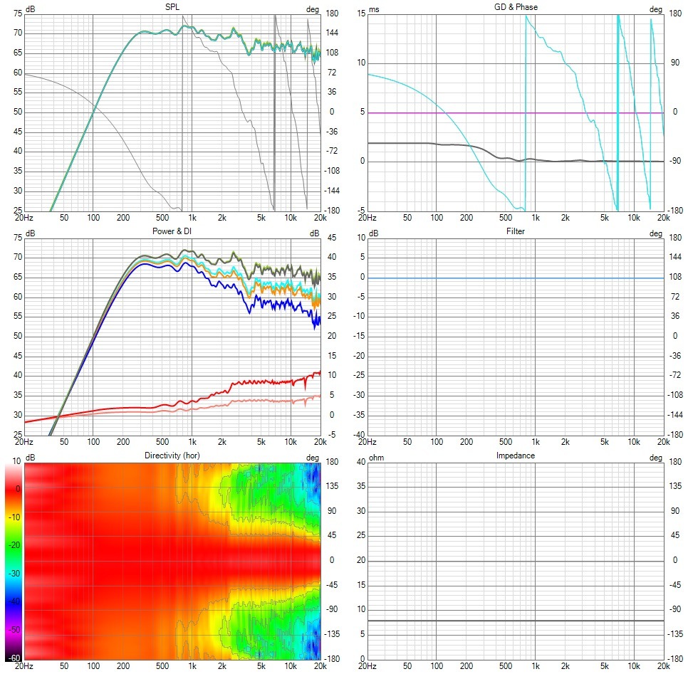

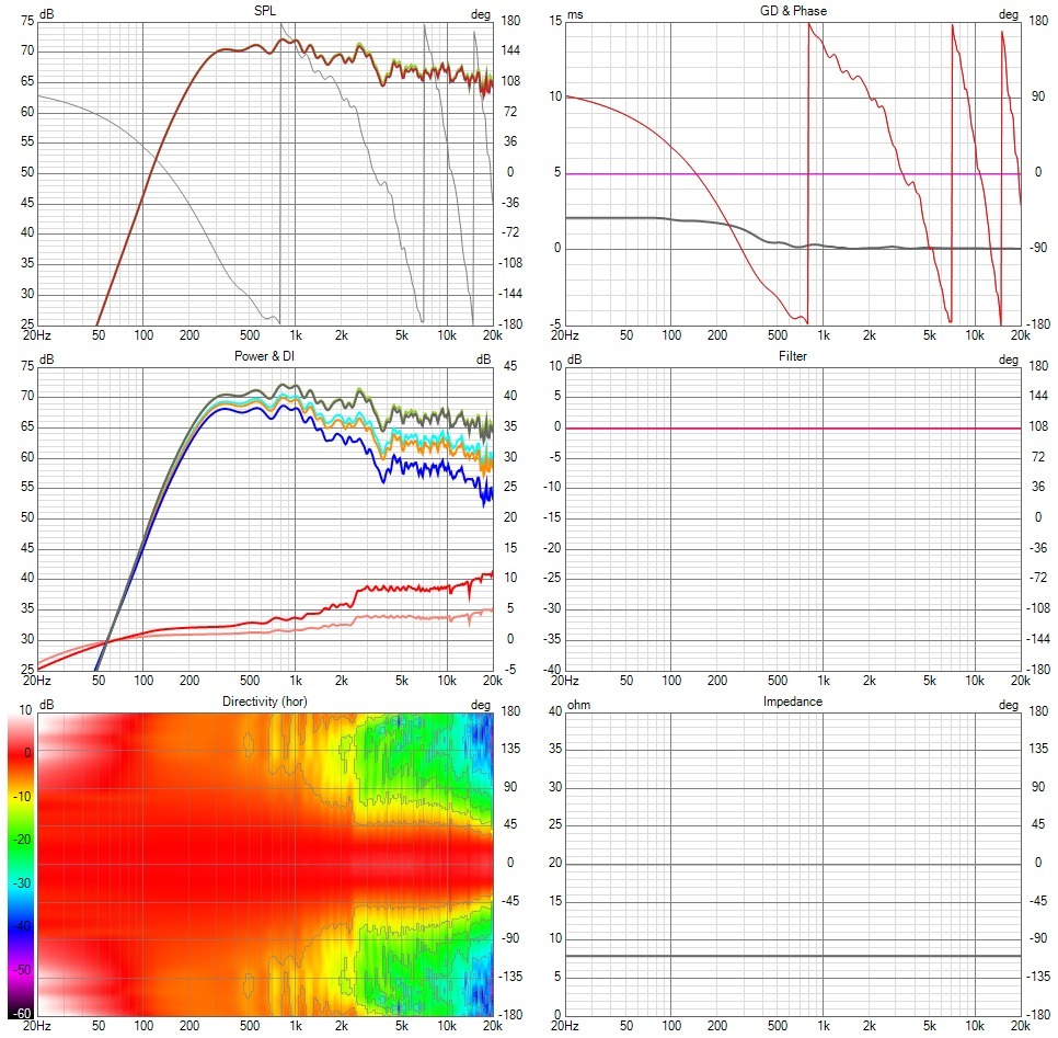

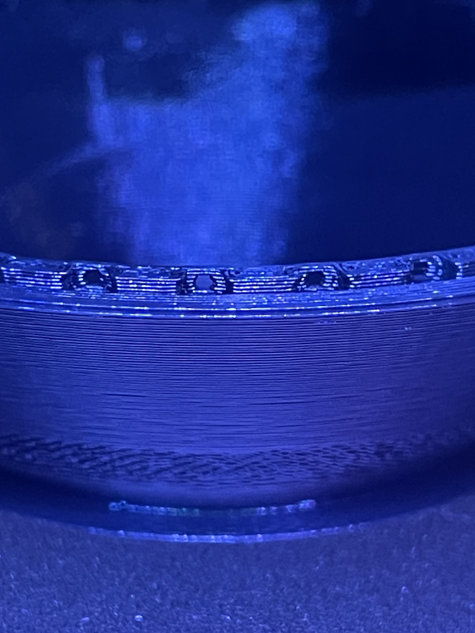

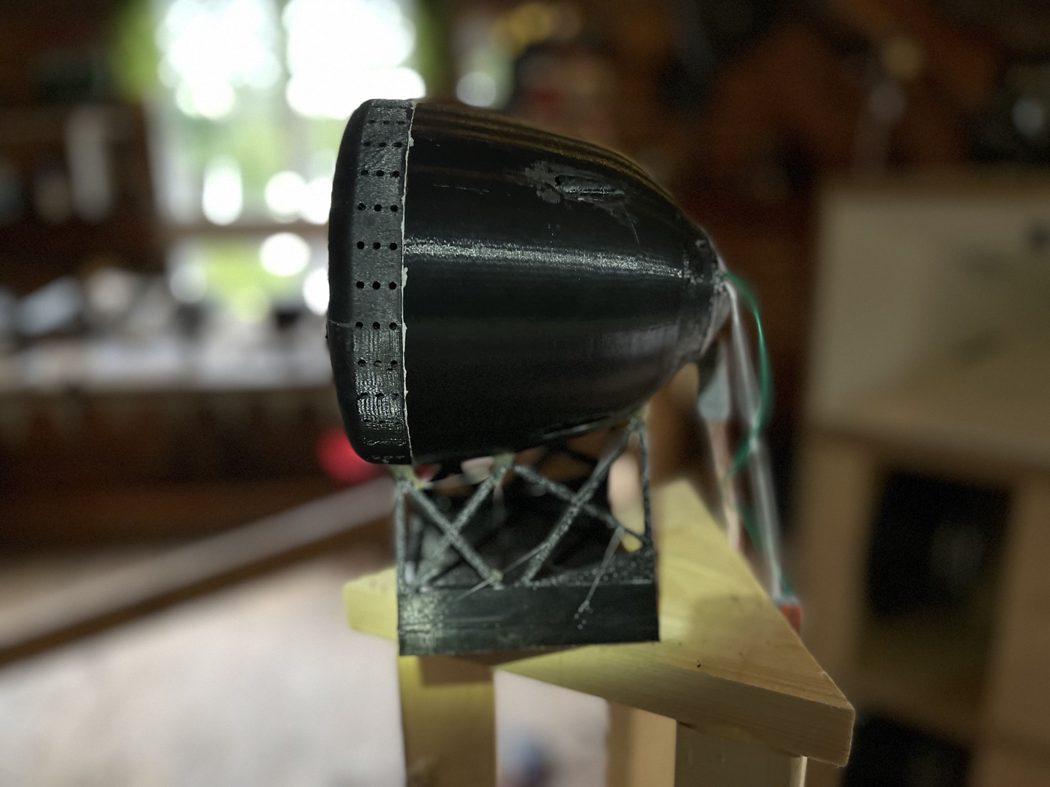

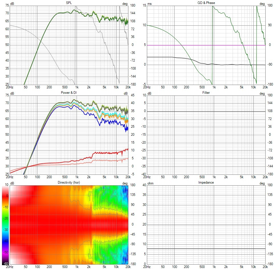

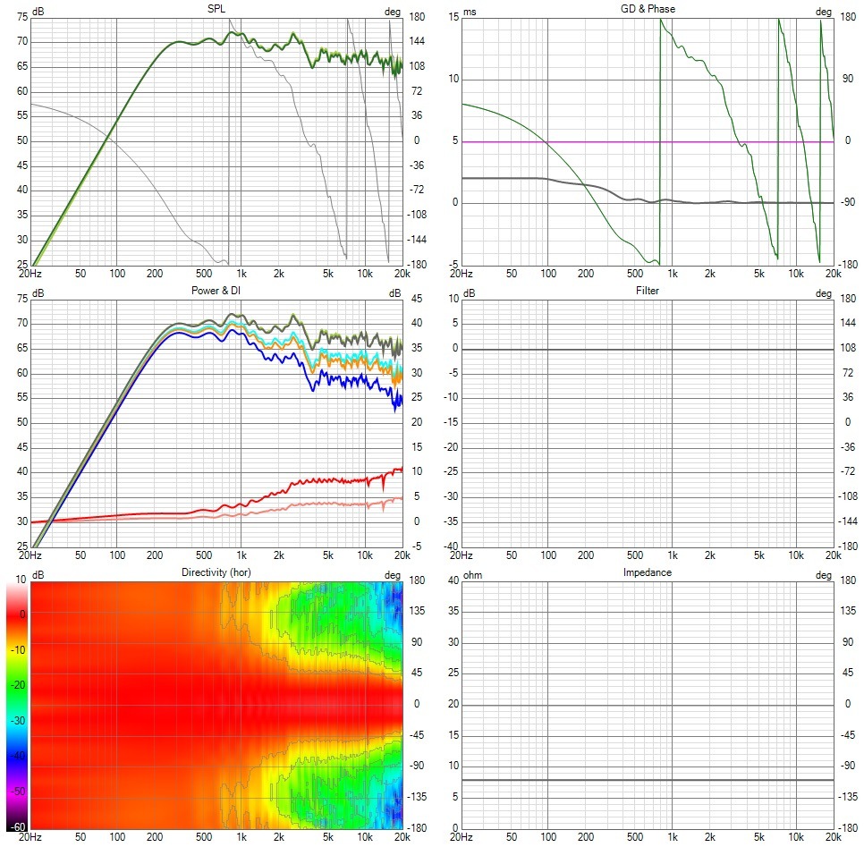

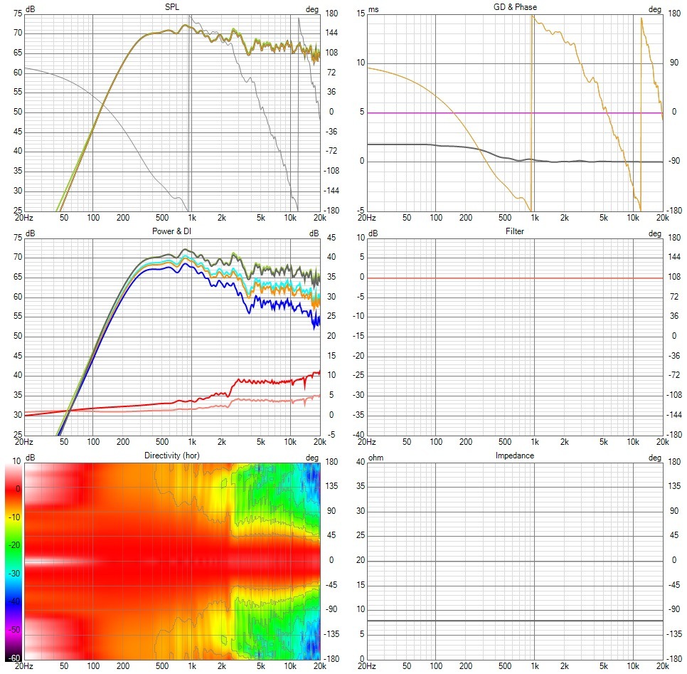

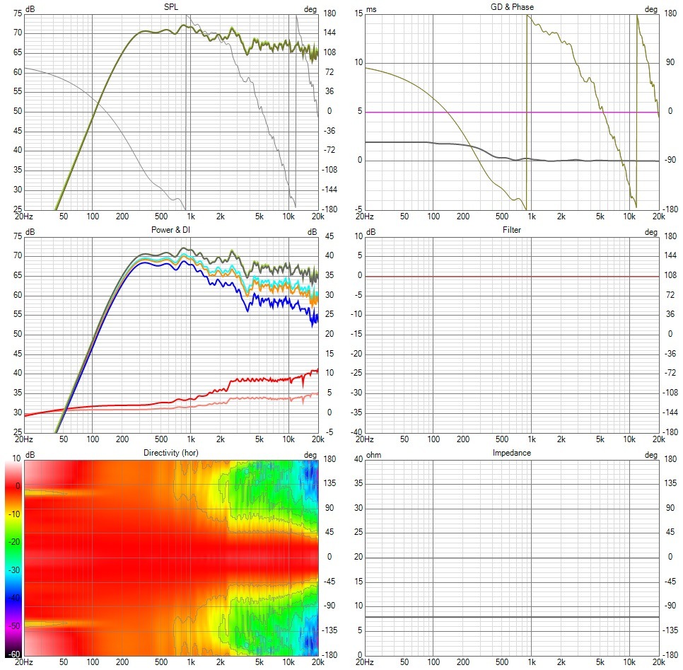

I made a test with perforating the side of the waveguide and studied the effect of enlarging the holes that bleeds the sound from the backside of the cone.
972 enlargements were made and a 10 degree per step spinorama was made each time I enlarged the holes. The speaker never left the speaker stand so the result could be compared.
I thought I was done, I thought that the last one was worse than the one before but I was wrong.
I still don’t know the perfect hole size..
The spinoramas is first the holes taped over. Then the drills that was used was
0,5mm 0,7mm 0,8mm 0,9mm 1,0mm 1,2mm 1,5mm 1,8mm 2,3mm

That is a much better idea than a rectangular waveguide - with only two more sides! I never understood the desire for a rectangle.I'm slowly progressing with the ATHEX 460-36...
I would be concerned that the tape is not a rigid surface and to suggest that it's more the distance from the CD diaphragm that is a majority factor. If that's the case then a more random distance would be what I would try. But I don't like using tape as any flexure of the walls will diffract.I made a test with perforating the side of the waveguide and studied the effect of enlarging the holes that bleeds the sound from the backside of the cone.
