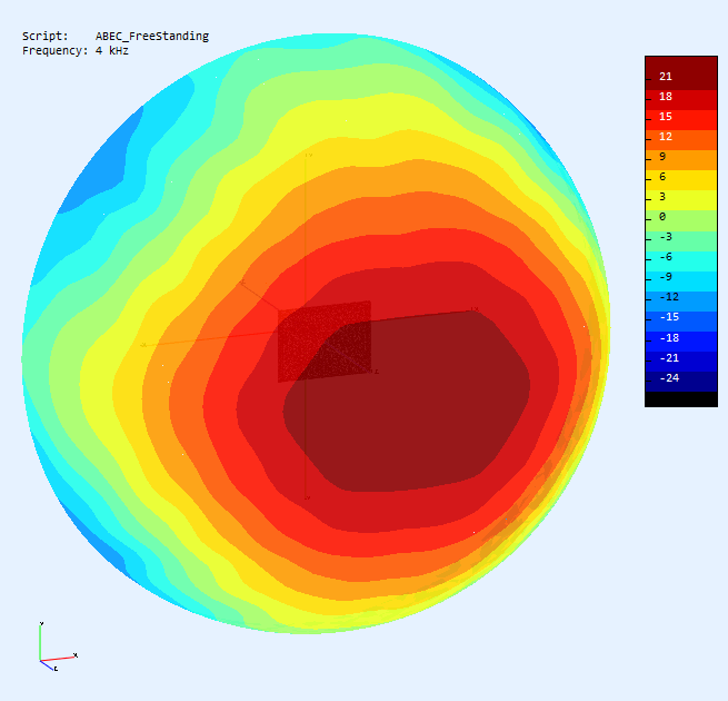

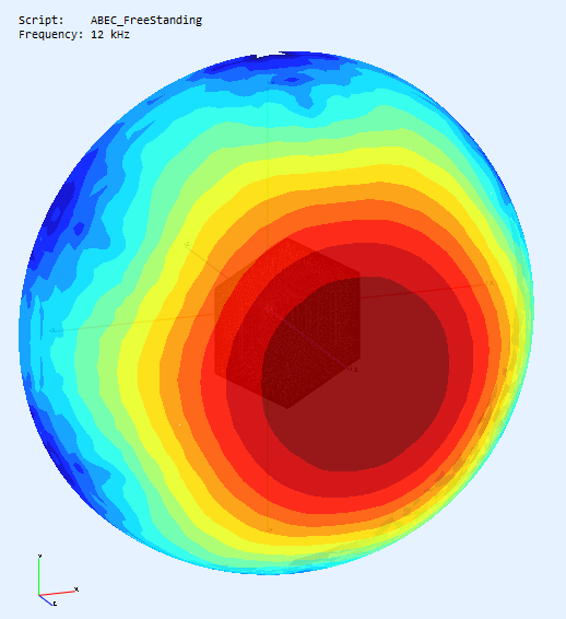

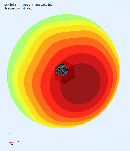

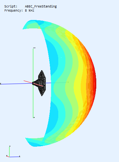

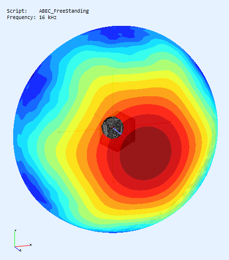

Yes, indeed. A funny thing is that the output wave is still virtually spherical: https://www.diyaudio.com/community/...-design-the-easy-way-ath4.338806/post-7419319That is a much better idea than a rectangular waveguide - with only two more sides! I never understood the desire for a rectangle.

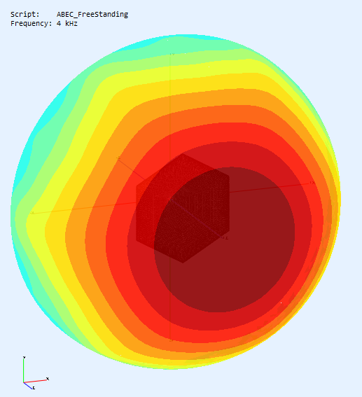

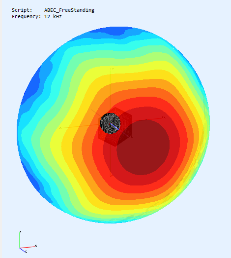

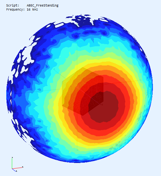

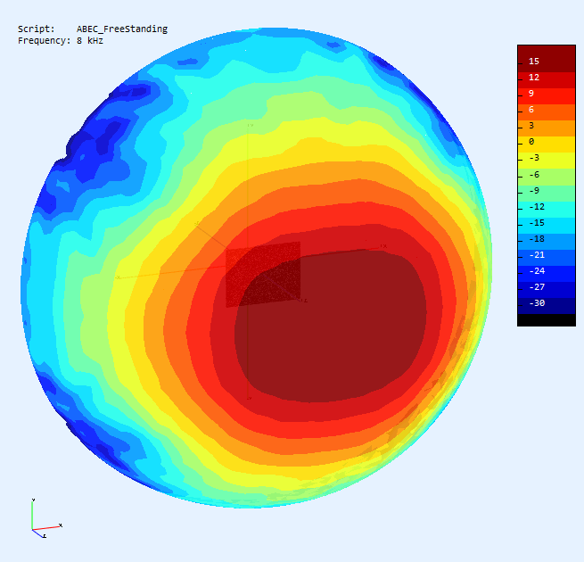

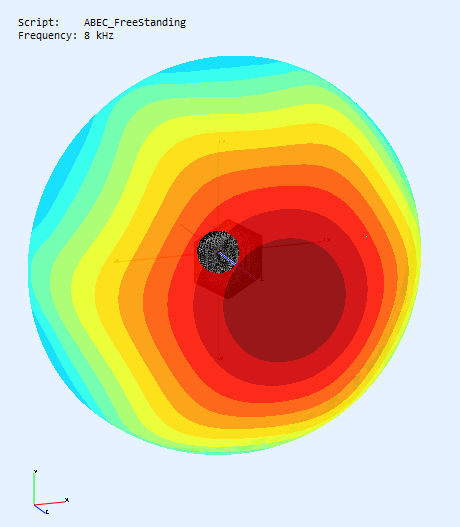

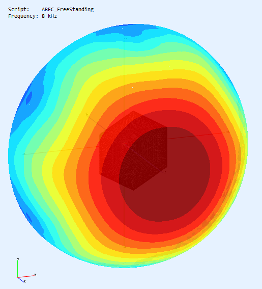

You're right, the formation of a hexagonal pattern off-axis is more apparent when in farer away (3 dB step)."Yes, indeed. A funny thing is that the output wave is still virtually spherical:"
I think that it would be hard to see irregularities in the near field wavefront. The far field polar pattern is more instructive as a visual indicator.

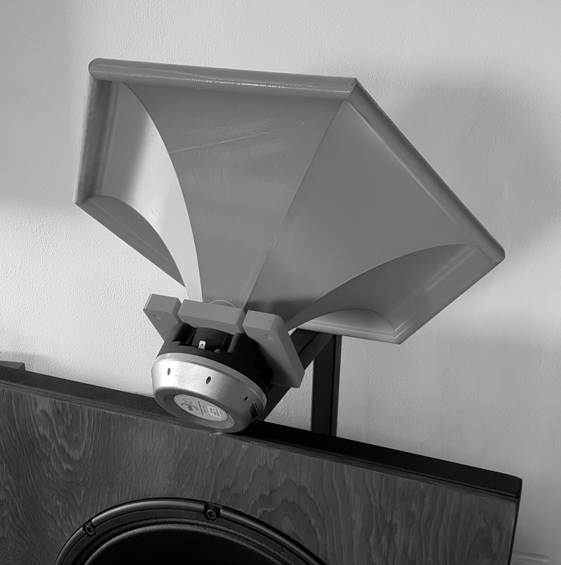

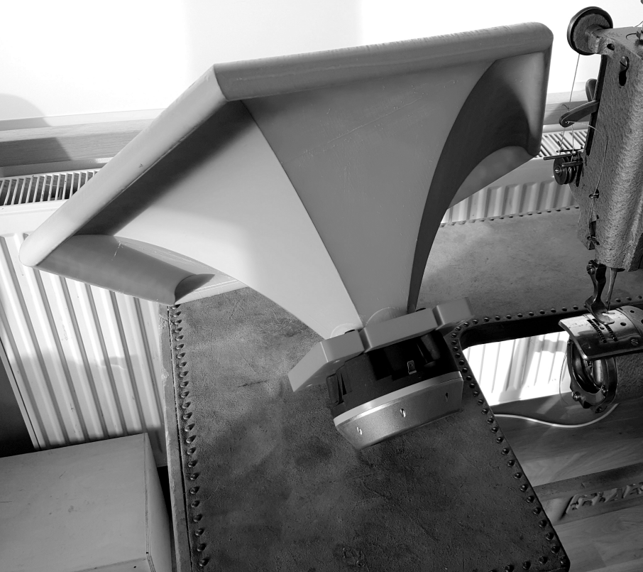

@mabat Can you share a picture of the backside? Also - are these hollow shells, which are then injected with some liquid material?I'm slowly progressing with the ATHEX 460-36...
Compared to assembling a round one, this was a piece of cake.
It's assembled using these parts: https://www.diyaudio.com/community/...-design-the-easy-way-ath4.338806/post-7407617
It's a prototype, still only a regular 3D print using infill. I wanted to see how it works out. Today I want to add a mounting flange and finally test it with some drivers.
- I had to make the picture grayscale, as the waveguide is a mix of blue and red parts and it looks rather silly - https://www.diyaudio.com/community/...-design-the-easy-way-ath4.338806/post-7418506
Shouldn't affect the sound though (at least not for a measurement...)

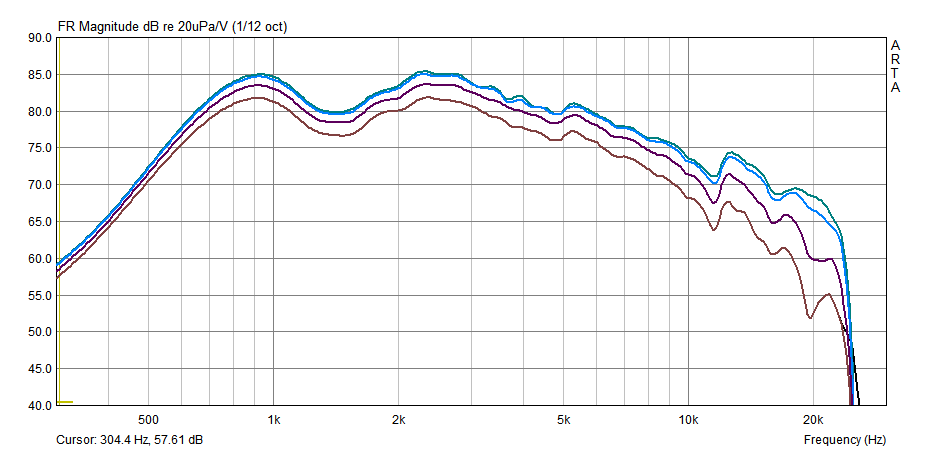

Yes, I'm pretty sure they are. I already measured the driver(s) with a completely different device and it was very similar:
https://www.diyaudio.com/community/...-design-the-easy-way-ath4.338806/post-6736091
https://www.diyaudio.com/community/...-design-the-easy-way-ath4.338806/post-6736434

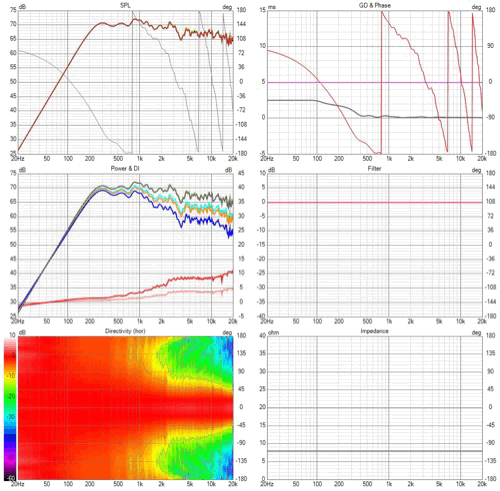

It should be no problem to EQ any of this. It's the smoothest driver I have at hand. I expect it to cover the range 600 Hz - 20 kHz with ease.
- I even measured the driver in my wavefront shape experiment. Above 10 kHz it resembles the same FR shape:

The double humps are very indicative of almost all compression drivers. It's unavoidable with a voltage source. The other ones are likely diaphragm resonances.I wonder if the valley at 1.3-1.5 kHz and the bumps around 11/12 kHz are inherent to the driver itself.
