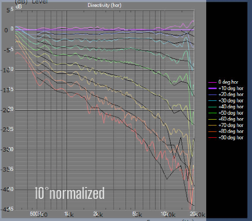

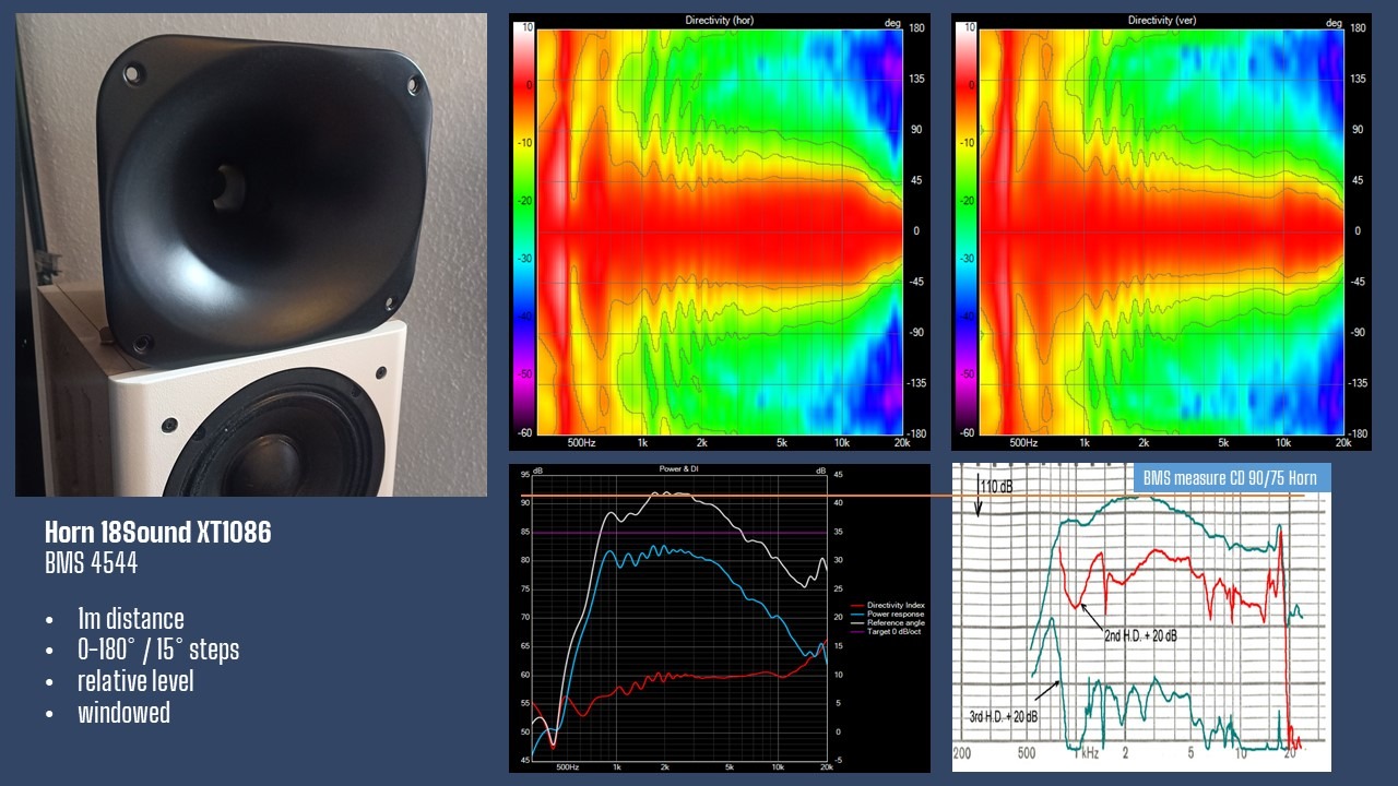

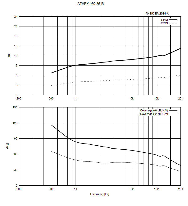

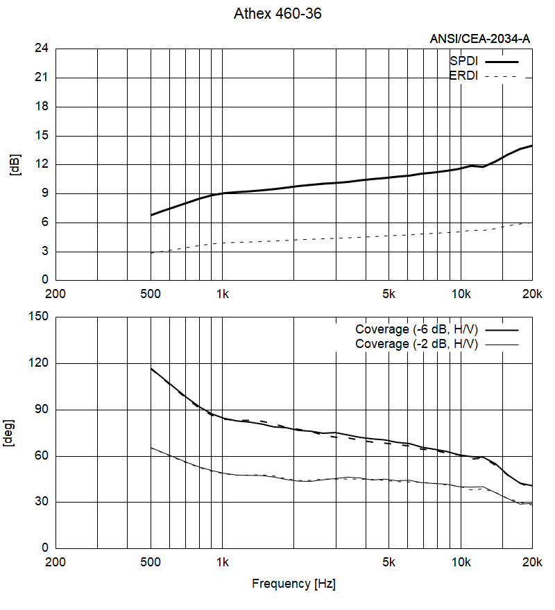

- It seems that the center of rotation was ~18 cm from the throat 🙂
Regarding the ripples between 500-3k, I guess this has not much to do with the waveguide. Could be a reflection off a nearby object.
Hi mabat, a really awesome match with your simulation. Nice.

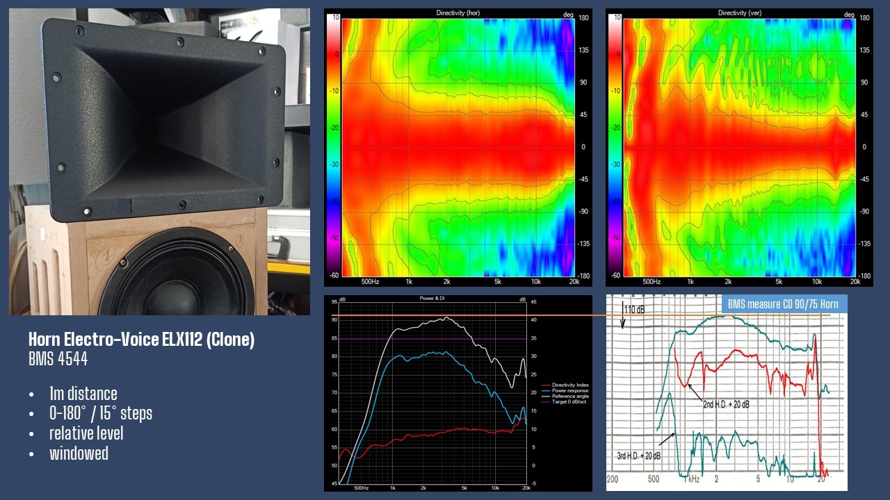

You're right, the rotation center was 18,5cm and yes I have measured your simulated vertical response.
The absolute fall off in HF with the BMS 4544 is something I measured across all my tested CD like horns. I have also the BMS 4550 driver but it is quasi identical frequency wise. Here are BMS own measurements with the 4544 on a CD Horn: BMS Measurement
In the attached files I scaled the BMS measurement to my own accordingly. It behaves up to 7-8 kHz similar to my measurements. But in the range of 7-20kHz it is different. I will cross check with a second uncalibrated measurement mic I have on hand.

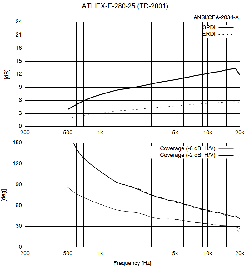

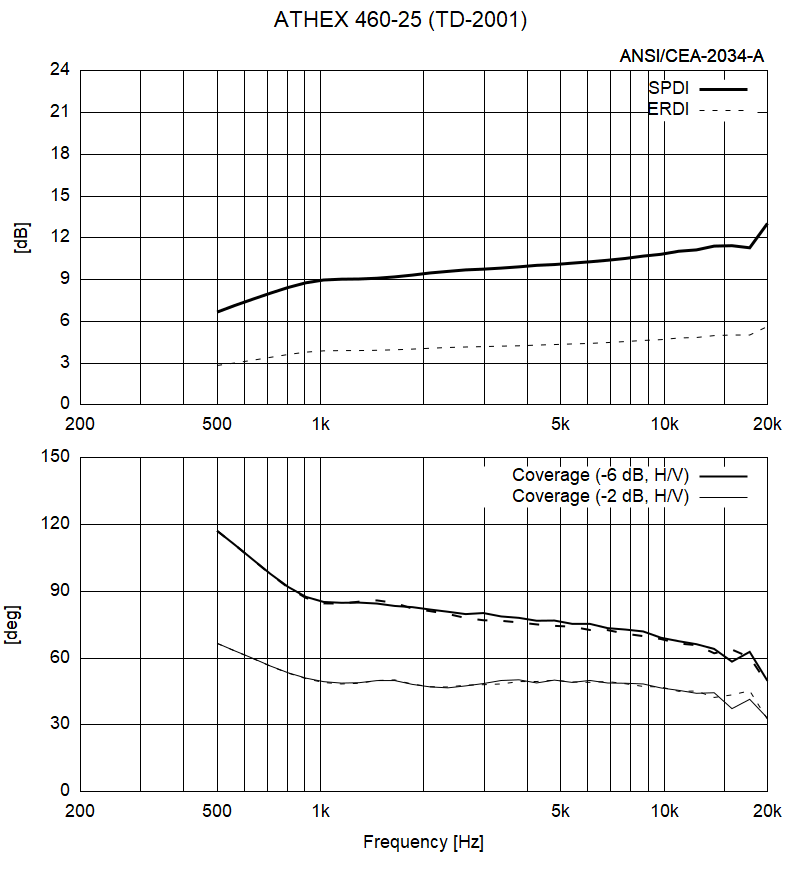

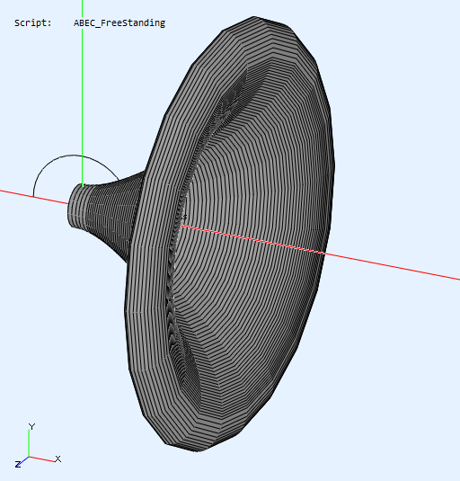

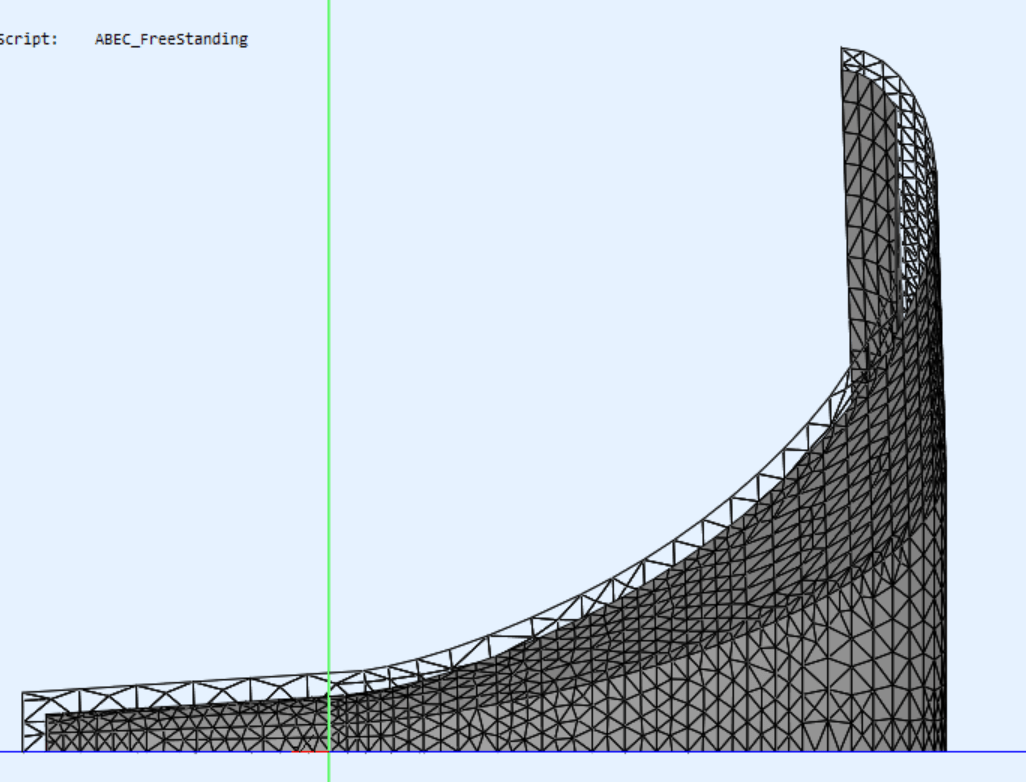

The ATHEX 460-25 with the TD-2001 throat section modeled:
- It has only a very little effect on the radiation pattern (i.e. it won't start beaming) but of course there are impedance issues. We already saw, however, that it doesn't have to be so strong effect in the end. Honestly I still don't know what exactly to expect.

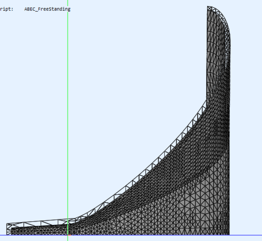

Does it help if you can supply coordinates?
https://www.diyaudio.com/community/...-design-the-easy-way-ath4.338806/post-7228138

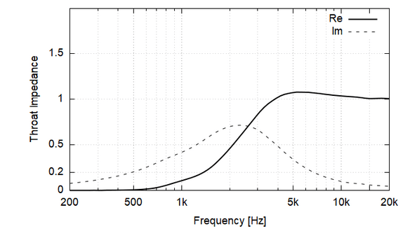

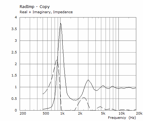

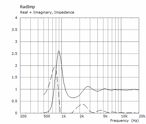

I guess it will be something along these lines (acoustic compliance?):
It is an acoustic compliance. Seeing as how little effect the radiation impedance has on the mechanical system, it's not a big deal. Positive imaginary is mass and negative is compliance (this, of course, depends on ones choice of sign convention in the calculations as it is arbitrary, although one has to remain consistent. Physicists tend to use the opposite convention from EE. Can cause no end of confusion.)
Please correct me if I am wrong, but what you have been attempting to inquire about was, whether you can replace the wave-guide (entire) profile calculation with an arbitrary profile defined by a set of vectors [r; y], correct?
What my problem reduced to its essence is; having a curve, characterized by an end-point [r_end; y_end] and 1st and 2nd derivative at this point, in terms of ATH the end-point of the generalized OS, and an additional limitation, e.g., overall length and overall end-point and 1st and 2nd derivative at this point, in terms of the terminated generalized OS the end-point of the termination section, and calculate the termination section between these points.
This is akin to a problem in laying train-tacks or roads. There is a first portion of the train-tack or the road and second portion of the train-tack or the road, generally in two different locations and angles with respect to each other. The problem to be solved is to generate a curve connecting these two portions with matching 1st and 2nd derivation at the end-point of the first section and the end-point of the second section.
There is (usually) an additional limitation of minimal acceleration through the connecting curve, thus using Euler spiral. Marcel has investigated this, but since the Euler spiral has no analytical solution, he decided to use a super-ellipse with known analytical solution.
What I am questioning is, whether Marcel's program, that was written with matching specific curves, generalized OS and supper-ellipse, can be somehow convinced to match a polynomial with super-ellipse.
Kindest regards,
M
OK, maybe I now understand better what you mean, but within the OS-SE formula there's in fact no such matching of curves, no separate curves to be connected. A superelliptical (SE) arc is merely added to a (generalized) OS curve, both as simple functions y(x) over the same interval. It's a superposition, one plus the other, not a connection. This sum then resembles an Euler spiral as a result (that's how it was motivated) but that's all.
In a general case you could take just any curve, like an OS curve alone, and by an algorithm modify the coordinates of its points so that the curvature is smoothly increased (starting at some point, and at a defined rate along the curve length) - that's exactly how the original Rollback algorithm worked. I abandoned it when I came up with the R-OSSE formula that made it just a lot more elegant.
- I have no clue how to optimally (in any sense) connect two curves... That's not what are the formulas doing.

So is it possible to say that a negative imaginary means that there's an amount of air surrounding the source, that is just compressed and rarefacted but it doesn't lead to a wave radiation? It's difficult to imagine, maybe even more than an acoustic mass...
It's difficult for me to imagine it as well. I just know that is what it is. I don't have a feel for how it comes about. It could be a sloshing of the media in front of the diaphragm.
Even stranger, when I worked on sonar heads of 100's of transducers, you had to calculate the impedances of each transducer with all the other ones at their expected values hardly ever in phase with each other. In rare case the REAL part could go negative and the transducer would blow up.
