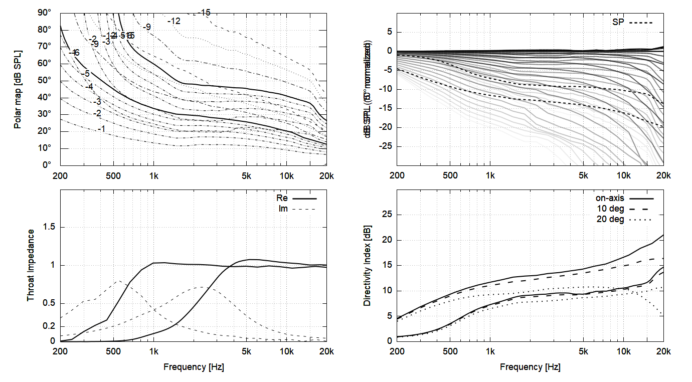

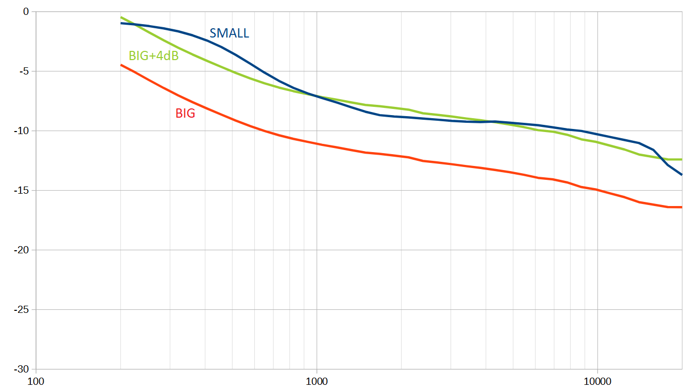

...perhaps hard to believe at first, certainly unintuitive (for me), but this is a comparison between ST260 (a small waveguide for a 1" driver) and a big waveguide with a 2" throat. Note the power responses (and the DI curves, naturally) - the shapes of the curves are not that different. "All" the difference is in the nominal coverage angle:Maybe this could have some appeal after all, especially due the relative ease of manufacturing.

Between 1k - 15k the DI curves for 10° are virtually identical in shape.
Both devices normalized to 10°:
There's still a difference between the two, of course - with the big waveguide the early reflections will have less HF content (i.e. will be less spectrally similar), compared to a smaller waveguide. How much is this audible could reveal an auralization experiment, as mentioned before. Would love to hear that in a direct comparison in a controlled test.
- There's no way to make a 2"-throat waveguide with the same nominal beam width as for a 1" throat (that would beam too much at HF), but if we make the DI higher overall, we have a great device back. It never occured to me how close it can be in terms of power response.

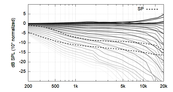

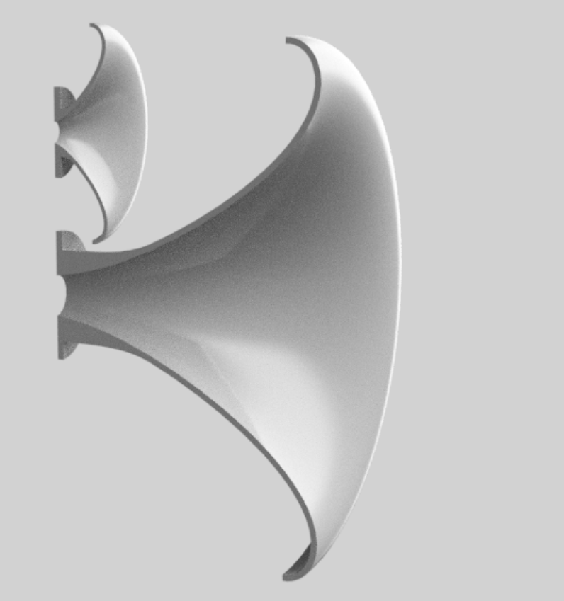

The two waveguides (serious piece of work, the second one).
R-OSSE at its best.

Those two waveguides are obviously very different, hense the difference in load....perhaps hard to believe at first, certainly unintuitive (for me), but this is a comparison between ST260 (a small waveguide for a 1" driver) and a big waveguide with a 2" throat. Note the power responses (and the DI curves, naturally) - the shapes of the curves are not that different. "All" the difference is in the nominal coverage angle:
A narrower horn presents more throat impedance, and is also increases the directivity.
The 2" horn has a beam width of 60 degrees at 2k and the 1" horn - almost 100 degrees.

How much subjectively different a 5db difference in the power response will be?
The direct to reverberant ratio will be higher. Maybe not always desired.How much subjectively different a 5db difference in the power response will be?
I guess it also depends on the listening distance..

(The big one is ⌀652 x 343 mm).

These are the power response curves again (EQed so the direct sound at 10° is flat):
