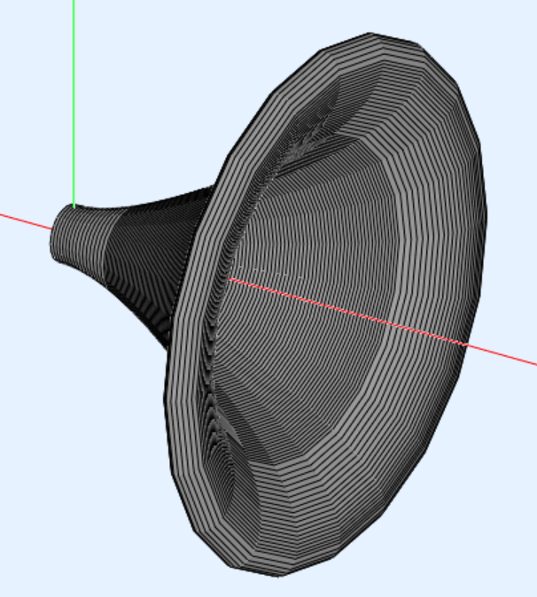

thank you for your generous offer.What is the exact throat diameter you need? (1.5" could mean 38, 40 mm, sadly, or maybe something else...).
I could make a STEP file of the surface, that's not a big deal.

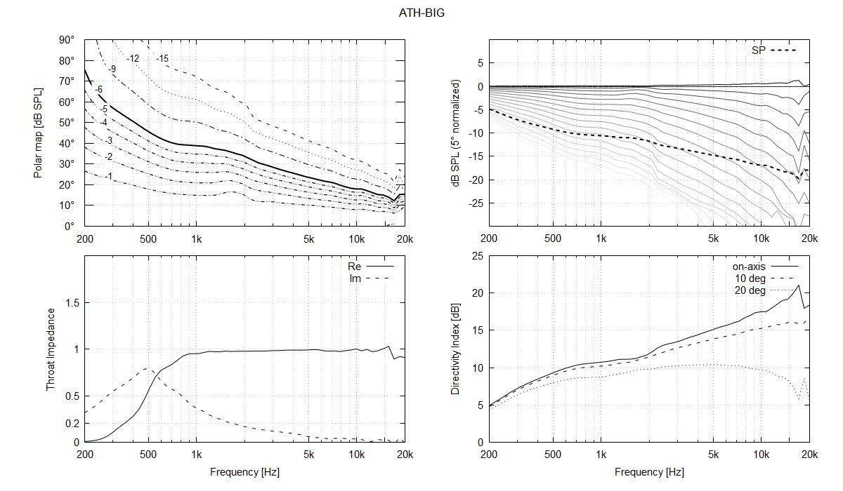

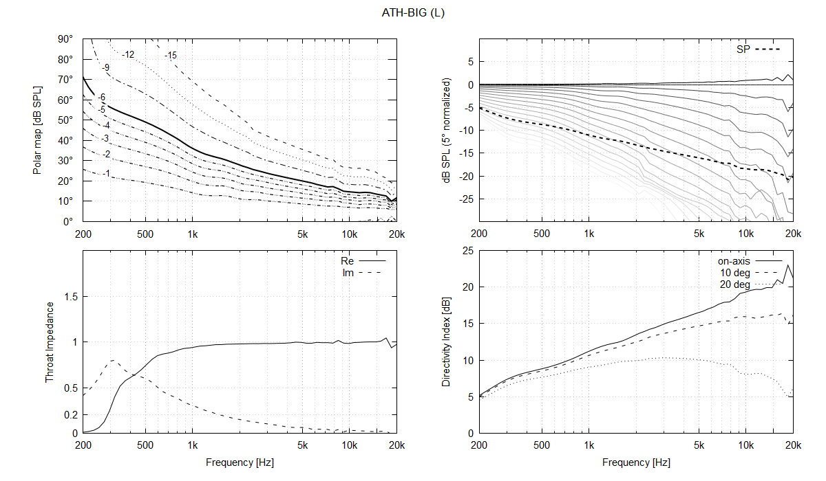

This is about as flat as reasonably possible with a 2" throat (the same picture as before) -
Here you go - STEP file attached. Beware it's only a surface (not solid) but I know it's possible to continue somehow, as I provided such data in the past and the people were able to use that.In any event, I just measured the driver and the diameter is 38.1 mm.
Tritonia, 38.1mm/0deg throat: https://a360.co/3n6cH0I

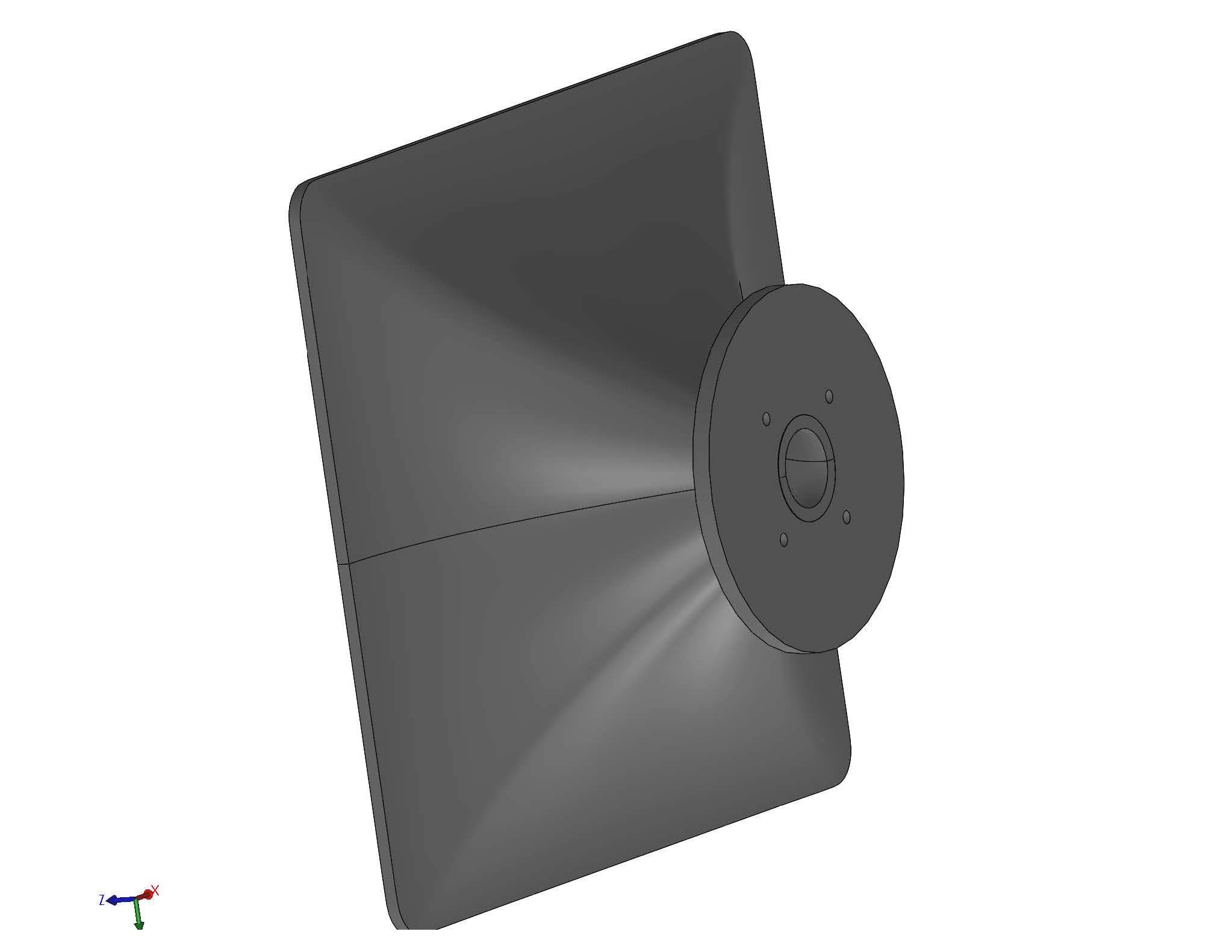

Hi mabat,
thank you very much.
I was able to open the file in Solidworks, but Solidworks indicates faulty face and gap in-between faces. When I heal them, I Solidworks cannot recognize any features so I cannot edit the part so that I cannot split it for printing.
I will keep working on it as I really want one. Worse comes to worst, I will have to learn Fusion. 😢

Here's a hi-res STL but that's all I can do...
V2 has reversed normals but I doubt that's an issue.

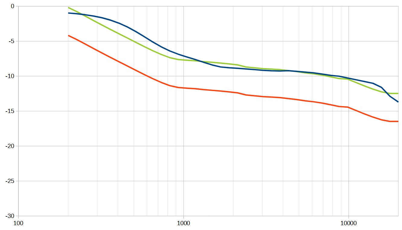

What general rules do you follow when matching a driver diameter to a waveguide? For example, is it clear by looking at this report which driver diameter you'd want to use or is it not that straightforward? (assuming freestanding horn rather than two-way enclosure)
B&C DE111 recommends 1.2kHz 12dB/oct or higher crossover on B&C ME 45 horn

Hi mabat,
thank you very much. And no, the reversed normals were not the problem.

Hi mabat,
thank you, thank you, thank you.
I was able to create the wave-guide ready for printing.
Since I am on the roll 😀 and the mouth ends perpendicular to the axis, what do you think if I added a four inch radius rollback on each of the mouth edges? I have a faint recollection that you had simulated something along these lines, no?

You mean a woofer diameter? I don't think it's clear just by looking at the report. First, you have some capabilities of a HF driver used, which basically determine how low it can be used with that WG. Then you decide how big LF driver to use, so both match nicely around the chosen crossover frequency. It takes some experience I guess. Using a diameter comparable to that of waveguide should be a pretty safe bet in most cases.What general rules do you follow when matching a driver diameter to a waveguide? For example, is it clear by looking at this report which driver diameter you'd want to use or is it not that straightforward? (assuming freestanding horn rather than two-way enclosure)
I have no opinion on that 🙂what do you think if I added a four inch radius rollback on each of the mouth edges?

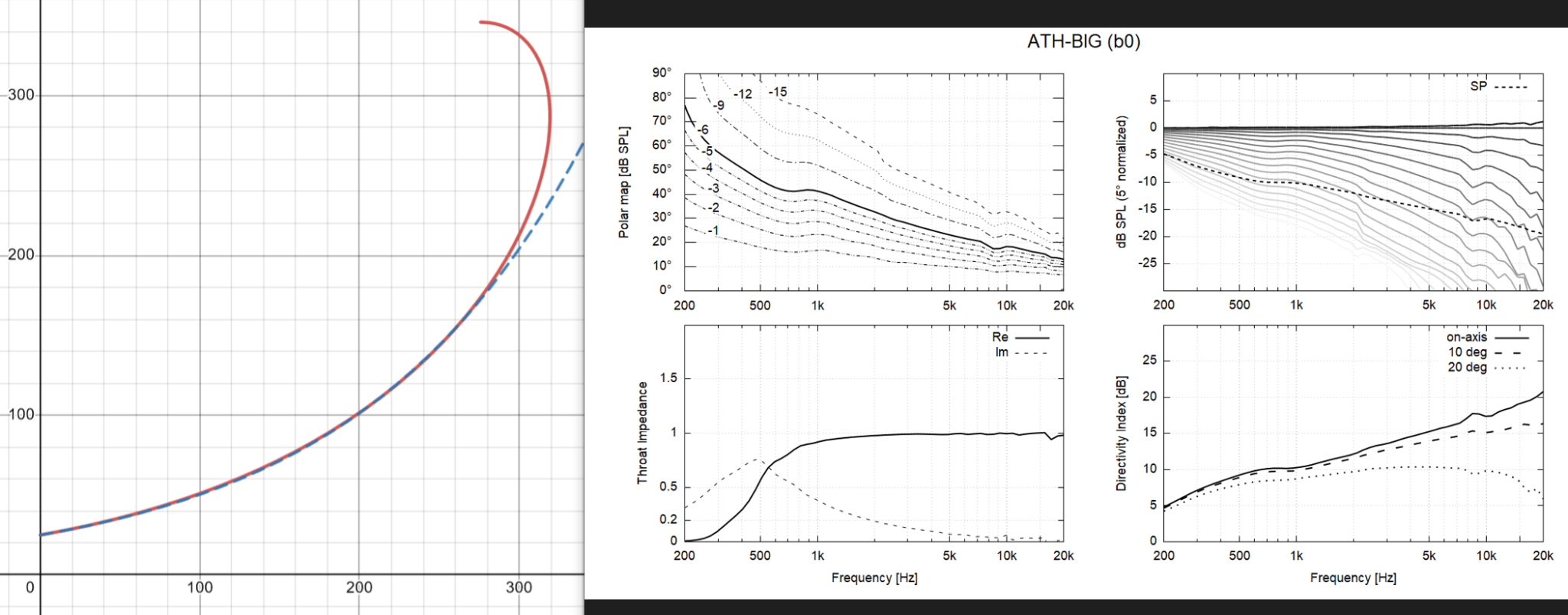

BTW, I have found the parameter "b" of the R-OSSE definition as unnecessary degree of freedom and it can be left out (set to zero).
It seems always possible to get virtually the same results without it. This simplifies the optimizations a bit.

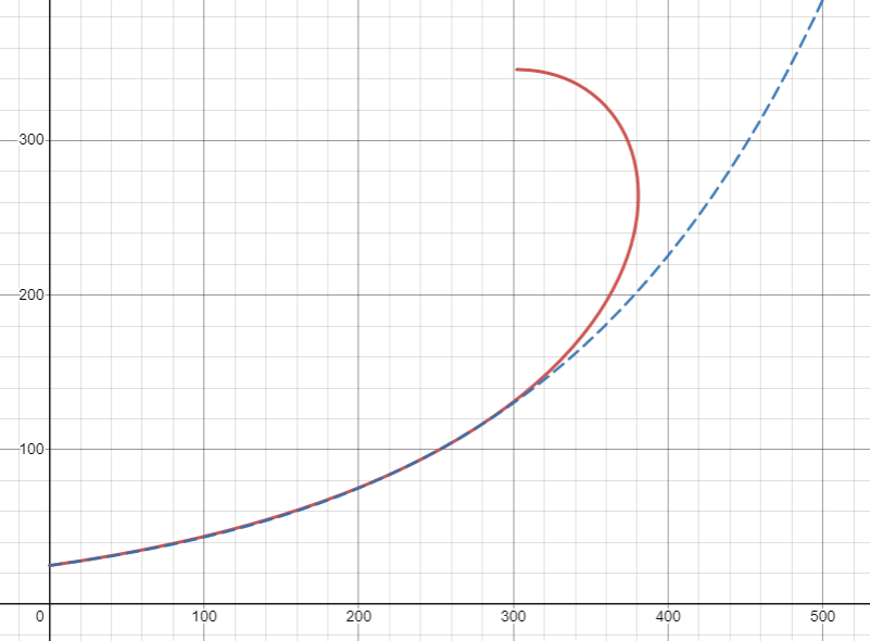

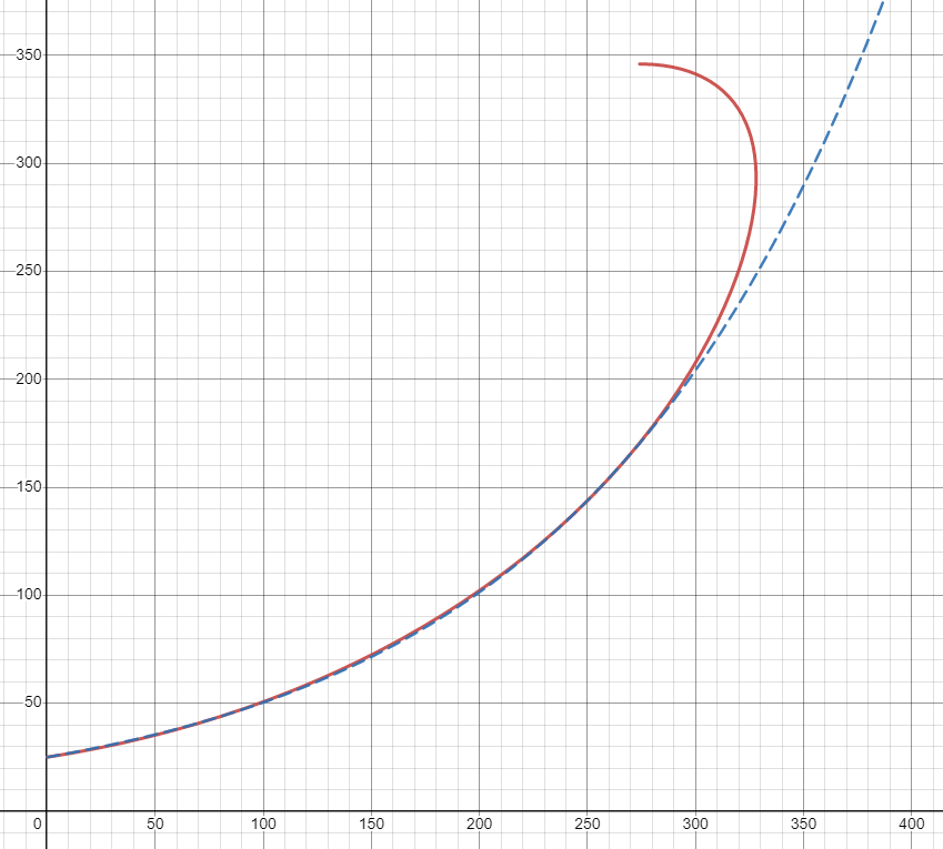

I tried to approximate an exponential horn of a similar size as the BIG waveguide above (dashed) with an R-OSSE profile (red):
2" throat, this is the result:
Yes, this particular one is. So obviously, with a R-OSSE profile one can create all from a straight conical, OS to exponential and everything in between (and then there's always an inherently smooth roll back at the mouth).
With an optimization algorithm, I believe one could generate a shape for any DI slope (within reasonable limits) desired.

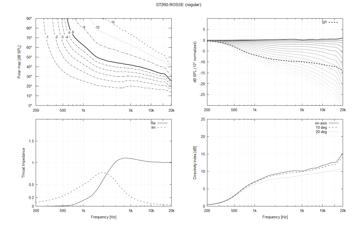

No doubt, it can be worse. This is for a nominal cutoff ~ 300 Hz:
R=346, r0=25, a0=5.3, a=18, k=13.2, r=0.81, b=0, m=0.7, q=3.02
At least it doesn't resonate.
