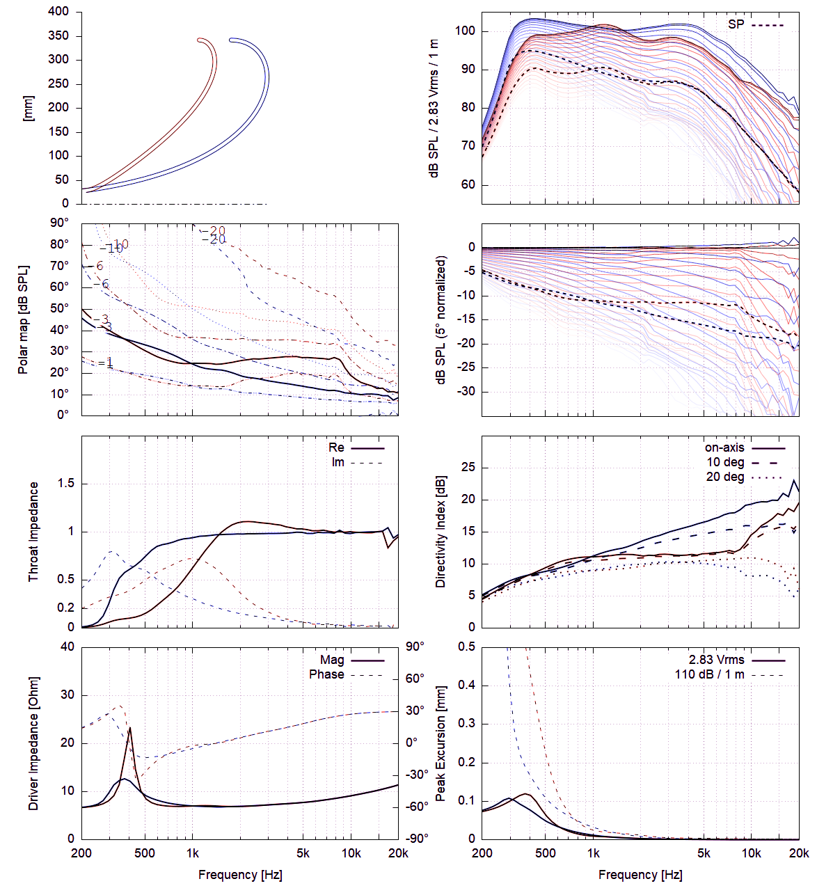

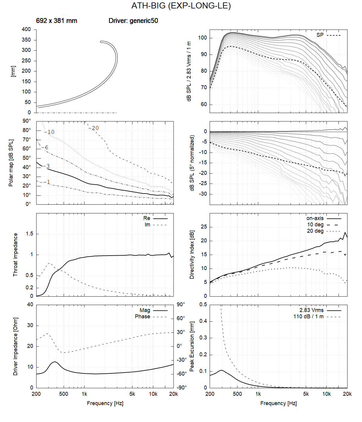

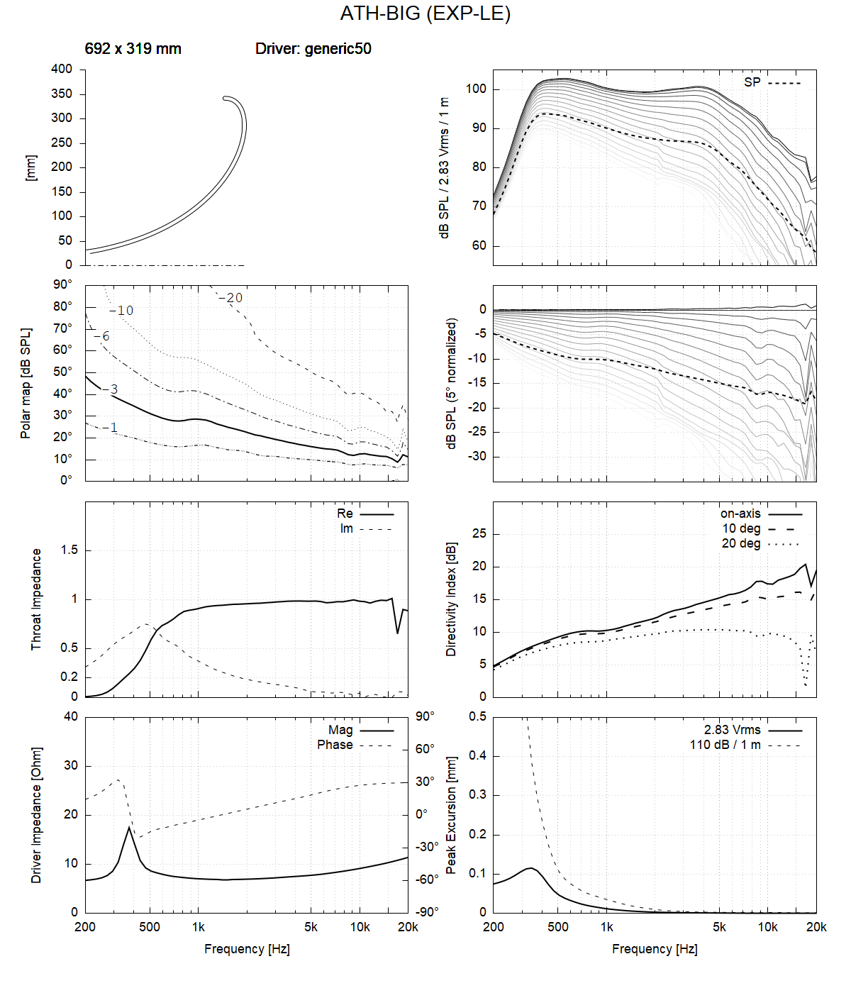

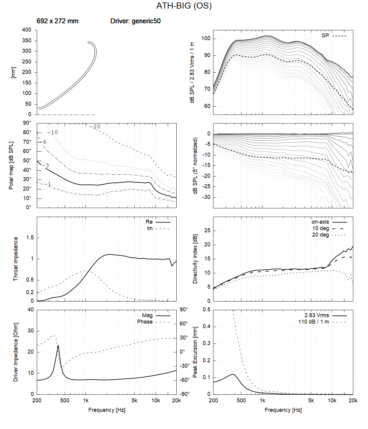

Here's a comparison of three different BIG waveguides (two of which were shown in the above posts), including a simple 2" driver LE model, i.e. showing also actual SPL responses and excursions:
The dashed line in the bottom-right graph shows the required (peak) excursion for 110 dB@1m on axis.
This is the driver model used, I just changed the numbers from a 1" model...
Code:
Def_Driver 'Drv1'
dD=100mm
Mms=8g
Cms=50e-6m/N
Rms=3.0Ns/m
Bl=10Tm
Re=6.3ohm
fre=35kHz ExpoRe=1
Le=0.1mH ExpoLe=0.618
System 'S1'
Driver 'D1' Def='Drv1' Node=1=0=10=20
// Rear volume
Enclosure 'Eb' Node=20
Vb=100cm3 Qb/fo=0.1
// Front volume
Duct 'D1' Node=10=200
dD=100mm Len=0.3mm
// Phase plug (simplification)
Waveguide 'W1' Node=200=300
dTh=18mm dMo=40mm Len=35mm Conical
// Conical section between phase plug and exit
Waveguide 'W2' Node=300=400
dTh=40mm dMo=50mm Len=25mm Conical
RadImp 'Throat' Node=400 DrvGroup=1001
