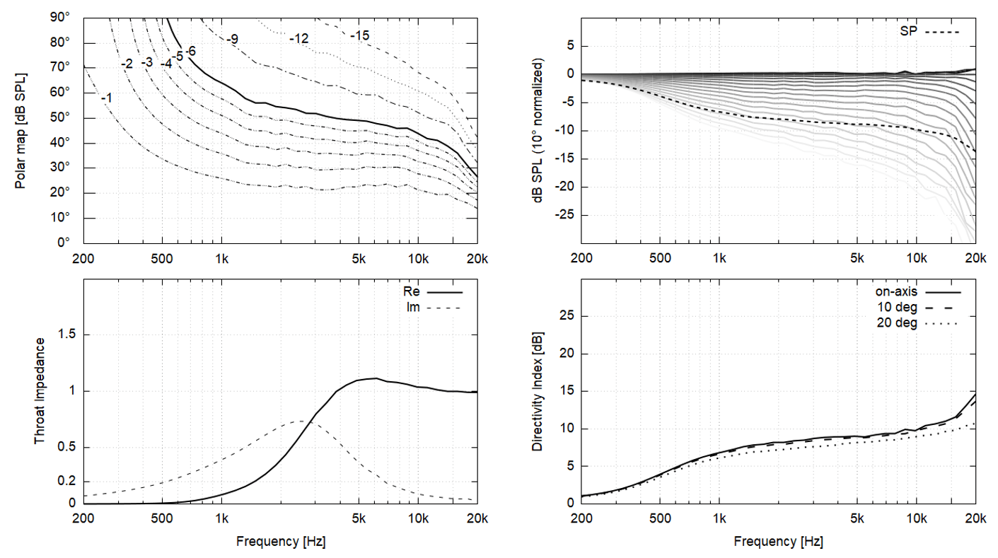

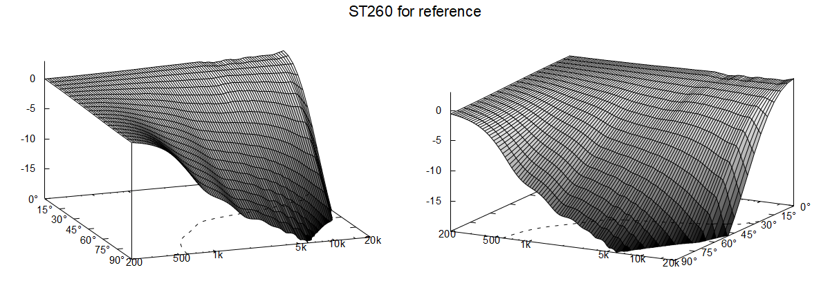

The thing is that as long as this deviation is in level only, it can actually be a good thing - I assume you're familiar with the toe-in delay/level trade-off concept. But I've never thought much of the shape of the off-axis level gradient itself - I always intuitively assumed that there's not much that can be done about it (other than changing the nominal beamwidth). It would be interesting if you could simulate some devices with different gradients. I don't have a clue how would I try to do that...[...] With an approximation closer to the gradient beam, which is closer to actual behaviour, there is a large deviation in listening window.
BTW, you could easily add a gnuplot report to Ath showing the gradient in the same way as you did.
All the examples I gave were perfect CD bc it would be a pain to try and make a non-CD version, so in an imperfect or non-CD case it is not a simple deviation in level. I'm not sure what you mean by toe-in delay, is this delay of first reflections? And neither am I on level-tradeoff.The thing is that as long as this deviation is in level only, it can actually be a good thing - I assume you're familiar with the toe-in delay/level trade-off concept. But I've never thought much of the shape of the off-axis level gradient itself - I always intuitively assumed that there's not much that can be done about it (other than changing the nominal beamwidth). It would be interesting if you could simulate some devices with different gradients. I don't have a clue how would I try to do that
Yeah its likely very difficult to engineer the shape of the gradient, it would depend on the WG profile, but it may just be inherent in how the sound behaves.
It may be possible to do it using some kind of phased array of drivers, but it's not exactly analogous to a real speaker.
See page 9 in Earl's summary: http://www.gedlee.com/Papers/directivity.pdf
The lastest ath plot is quite close alreadyBTW, you could easily add a gnuplot report showing the gradient in the same way as you did.

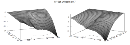

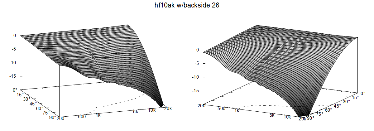

the trend would always be so that off-axis, 90 max in these default graphs, is always high at low frequency and slopes down toward high frequency due to sound wavelength changing, unless you make such big of a horn it can control the output down to very low frequency.Yeah its likely very difficult to engineer the shape of the gradient, it would depend on the WG profile, but it may just be inherent in how the sound behaves.

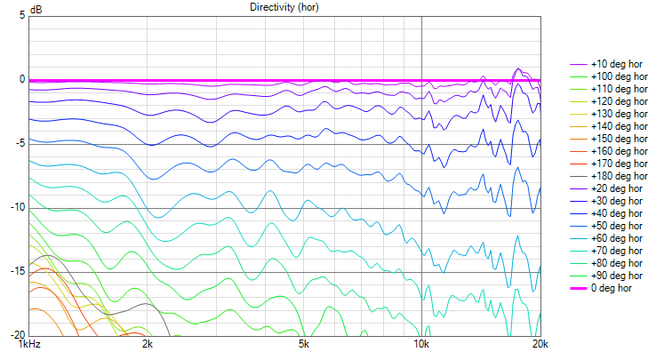

One can introduce some "widening" with diffraction, but it comes with narrowing so not sure if its something useful, its just ripple. Then we are limited to constant directivity for some bandwidth with less or more sloping DI, beaming. I think one could tailor some gradient for some bandwidth but the problem is from 20kHz and down. Here few examples, try to follow for example 40deg line on the two first images, dip around 1-3kHz and then some boost above. Compare to ST260 where it doesn't happen to an extent but is more balanced, like flat or smooth downward slope. The first two have much wider nominal directivity, but no matter what it is they always plunges off-axis 20kHz given the throat is 1". You could make the throat much smaller if you wish to extend the top, but it simultaneously cuts usable bandwidth from the bottom I think.
All these have the same big picture trend of course, wide response at low frequency and narrow response at high frequency and some behavior in between. If you look the graphs the difference is visible on the edge, on the 90deg line, also the 20kHz edge is nice to look at. I really like information on these graphs
So yeah I also think that basically all we can do is make sure the nominal directivity is wide enough to cater a practical listening window, especially at the highest frequency of interest. Reasonable target could be to have response within 1db for some bandwidth for a 3 person sofa, which is some degrees depending on distances and toe-in, width of the sofa. Basically it is quite close to the typical definition with +-30deg horizontal coverage so listening window within 1-2db or so up to some target frequency is reasonable.

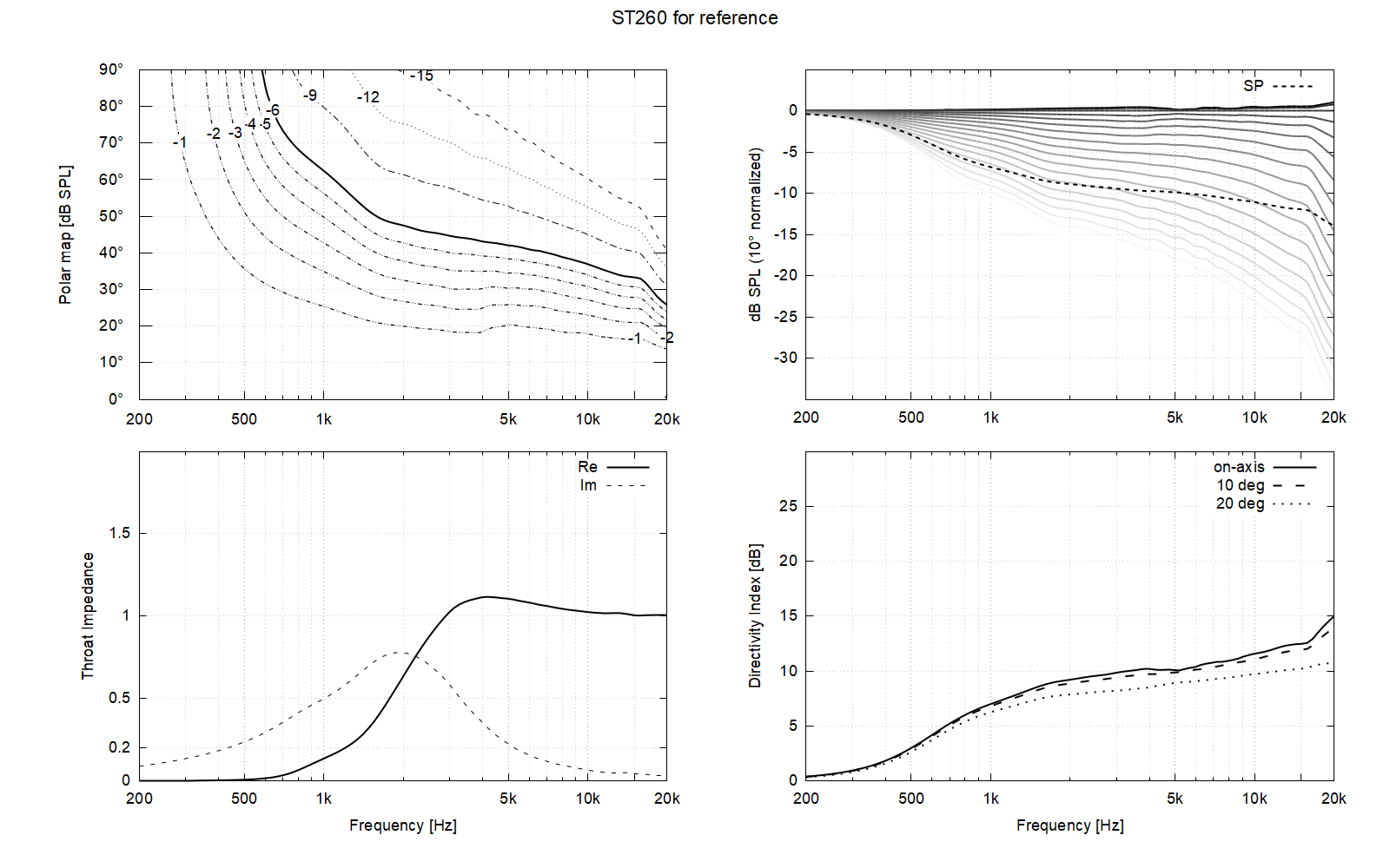

Here is measured normalized graph with ST260 which is reasonably constant directivity nominal 90deg device with 1" throat. It is roughly within 1db up to +-20deg. If you compare response of 1kHz to say 10kHz it is within 1db with itself up to +-40deg or so or how ever one likes to interpret the graph. This is of course few db:s down from on-axis SPL but every person within +-30deg listening window would get roughly the same frequency response above ~1kHz. In practice I would call this even response for a whole three person sofa, and beyond.
And of course its all visible in the standard ath raport as well, look the 1db controur line on the top left image.

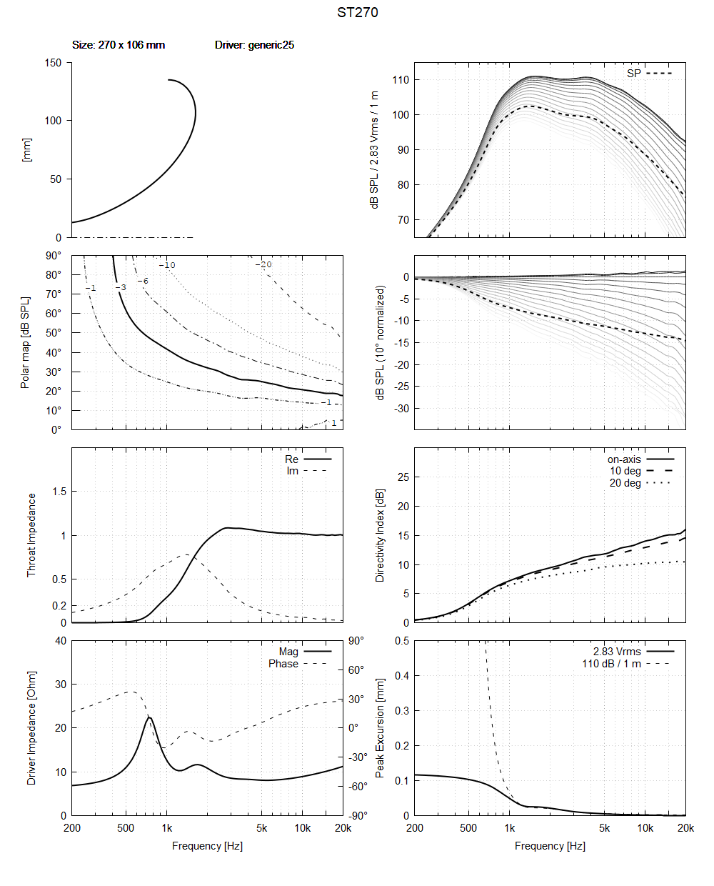

- As a reminder, this is the performance (note the power response curve ):
Virtually no hint of diffractions, resonances or narrowing, with a DI as smooth as it can be.
As for the power response (the last comment) - I found an old simulation including a lumped-element model of a compression driver. Here's a power response shown both as absolute and using normalized data (the calculation doesn't care what's at the input). It's really only a different look at the same data. For the waveguide acoustic properties alone, this obviously doesn't matter at all -
