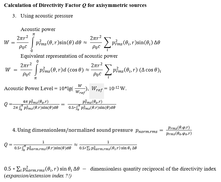

Now I understand why you insist on your definition of "the Sound power". Acoustic/Sound power has a strict physical and mathematical definition and it is described as [1]BTW, here's an excerpt from the ANSI/CEA-2034-A:
Sound power represents...

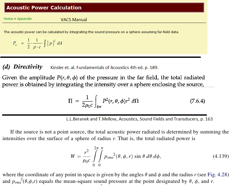

Definitions in some textbooks:It is defined [2] as "... the product of the sound pressure, and the component of the particle velocity, at a point on the surface in the direction normal to the surface, integrated over that surface."
[1] ISO 80000-8(en) Quantities and Units - Acoustics
Since we are able to choose any surface for the pressure integration, a spherical one is most convenient. For axisymmetric sources acoustic power curve can be calculated using equations in the picture below.
In turn, you calculate some dimensionless value "SP" using normalized pressure, which is the reciprocal of the directivity index, but noway the acoustic/sound power curve as it is described by ISO standart and acoustics textbooks . It makes sense to name this "SP" quantity "extension/expansion/cea2034power/mabatpower/whatever" index, but actually it is not "Sound Power". But again, this quantity become meaningless if you provide the Directivity Index curve, because it represents essentially the same thing as DI.

No, it's not the reciprocal of the directivity index (as I told you already), neither it uses normalized pressure. Sorry, but that's just nonsense. BTW the dimension is dB SPL.In turn, you calculate some dimensionless value "SP" using normalized pressure, which is the reciprocal of the directivity index

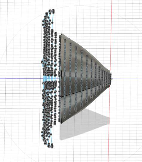

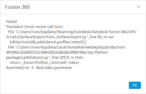

It seems that Fusion 360 Surface Import script crashes when adding a rollback.
After adding a rollback to Tritonia and exporting resulting surfaces into Fusion, I get the following error:
I opened the script file and add "if" condition on the line 56 (spaces preserved - forum engine removes them):
This suppressed the exception, but Fusion now isn't able to generate a shape for thickening. It thickens part of the horn before rollback:
I don't know Fusion API and don't understand the CSV data good enough to figure out what part is breaking. If there is something I have to change in the configuration file, let me know, please.
for pa in points_array:
sketch = root.sketches.add(root.xYConstructionPlane)
sketch.sketchCurves.sketchFittedSplines.add(pa)
if len(sketch.profiles) > 0:
loftSectionsObj.add(sketch.profiles.item(0))
Yes, I think the problem with rollback was that it makes the slices non-planar, which causes trouble to the loft feature in Fusion. I can't recall a workaround, but honestly, I think there's no point in making a rollback for that waveguide. If free-standing, I'd just make it round.
I told you maybe five times what that quantity ("SP") means. It is the frequency response of an ideal point source radiating the same total sound power as the source with the given/measured polars. What's not clear on that?It makes sense to name this "SP" quantity "extension/expansion/cea2034power/mabatpower/whatever" index, but actually it is not "Sound Power". But again, this quantity become meaningless if you provide the Directivity Index curve, because it represents essentially the same thing as DI.
And it's exactly this quantity that's needed to calculate the DI in practice. And why not to show it when I already have it. It gives a nice insight into how the radiation pattern and the power response relate to each other.
