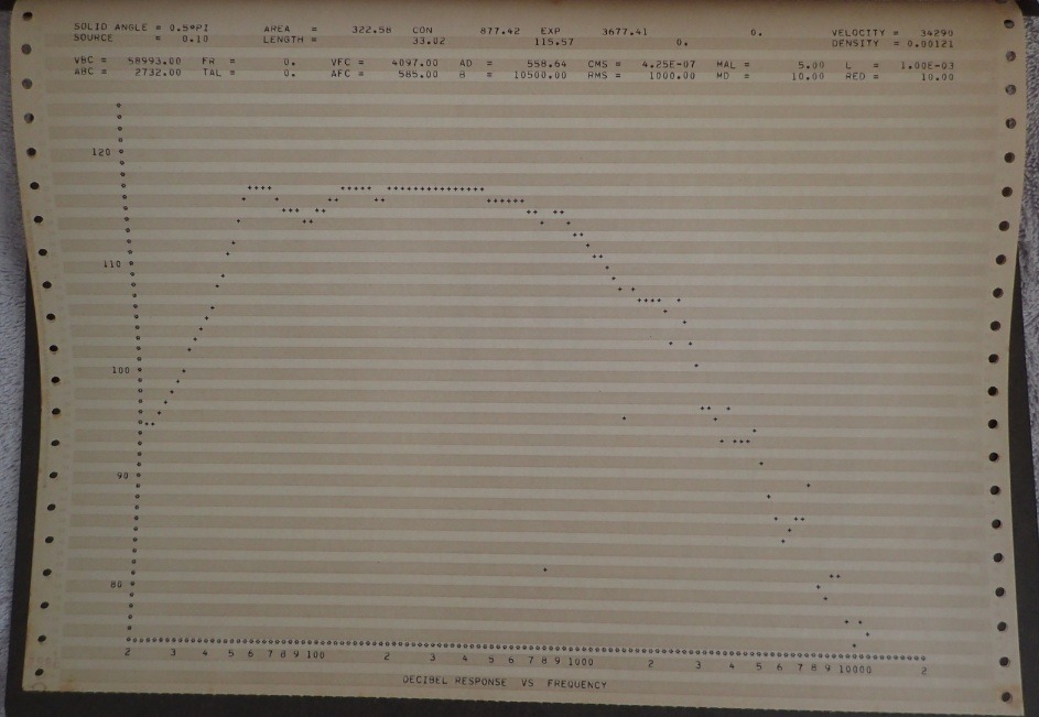

I sincerely hope so as the method has been used in Hornresp and its predecessor programs for more than fifty years to calculate the power response chart 🙂.
(The chart shown in the attached photo was produced in 1970).

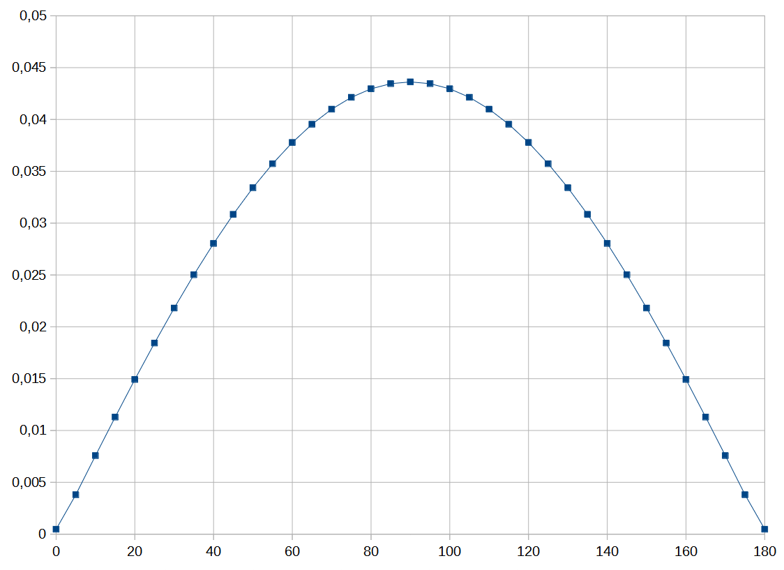

To all who still haven't get what we are talking about (David McBean being obviously one of them):
Measuring SPL responses on a (spherical) surface around the source is a method of estimating its total radiated power (which we need e.g. for DI calculation). The more points you measure, the more accurate result you get. If we measured in a dense regular grid across the whole surface, the total power would be directly proportional to the sum of squares of the measured pressure values. We could also take a square root of that and get an equivalent average pressure (or SPL), corresponding to that power.
Now, If we have an axisymmetric source, it's obvious that it's enough to take the polars in a single plane, 0 - 180°, say with 5°step. So now we have 37 SPL curves: 0, 5, 10, ... ,175, 180°. To calculate the total radiated power in this case, we again sum the squares of the pressures, but now we have to assign different weights to different values/angles, accordingly to the relative areas of the spherical surface that they actually represent (you probably have to make a skecth to get a grasp) - the values far off-axis will have much higher weights, just because they represent much larger areas, where we would measure that pressure if we did.
So we have the weights and make the weighted sum: radiated_power ~ SUM(w0*p0^2 + w1*p1^2 + ... + w36*p36^2).
This is the total radiated power. If we now make a square root of that (acutally a rms average of the pressures), we get an average pressure, which, if present in every direction would lead to the same total power, obviously. We can also convert that average pressure into SPL, which becomes the "SP" curve shown in the Ath reports:
SP = 20*log(sqrt(radiated_power)) = 10*log(radiated_power) [dB SPL]
This is exactly the method described in the CEA-2034 standard how to estimate power response and DI.
The meaning of the power response as an SPL curve ("SP") is simple, as naturally stems from the above - it's a frequency response of an ideal omnidirectional source radiating the same total power as the measured device. To calculate DI, take the direct difference in dB between the on-axis SPL curve and this SP curve.
