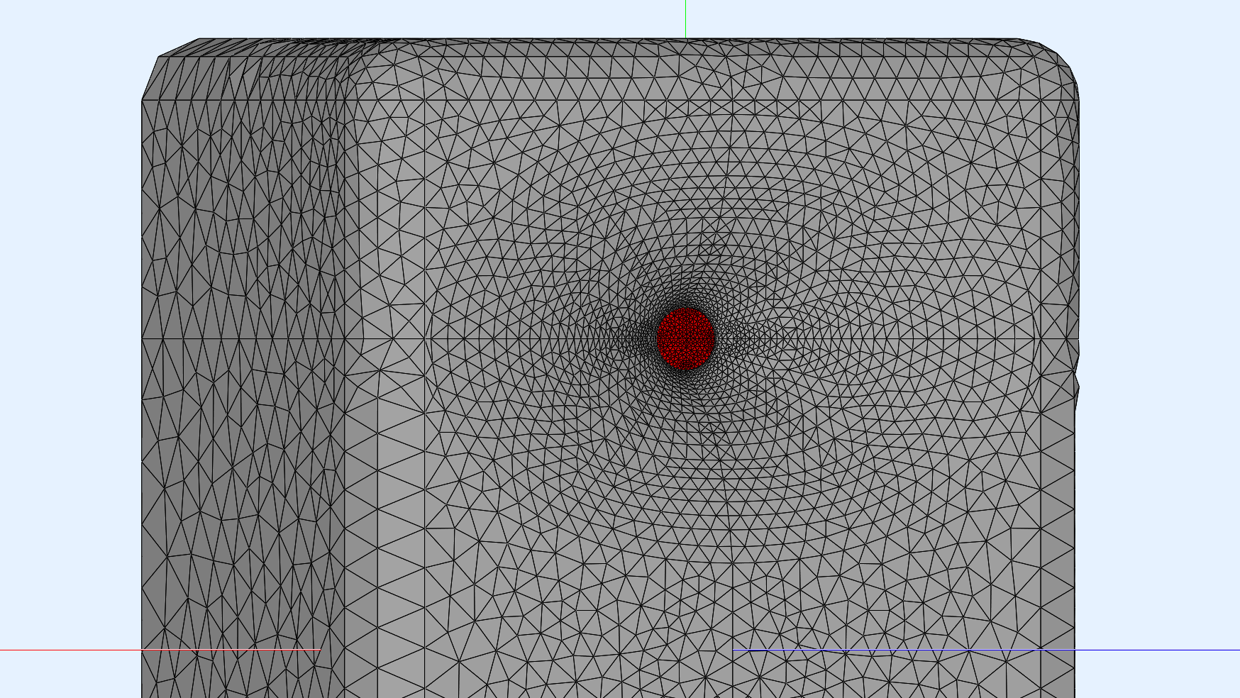

I's most likely the rounding of your corners. Increase the radius and it will improve.Interesting. Just to make sure we are on the same point: I am not concerned about the splash >10k, which is a mere artifact of the resolution. I mean the strong wiggles between 2 and 8 kHz.
The mesh does not include thin triangles that should be problematic:
What you could focus on instead is the narrowing at 1k
It seems that I indeed had reducedI's most likely the rounding of your corners. Increase the radius and it will improve.

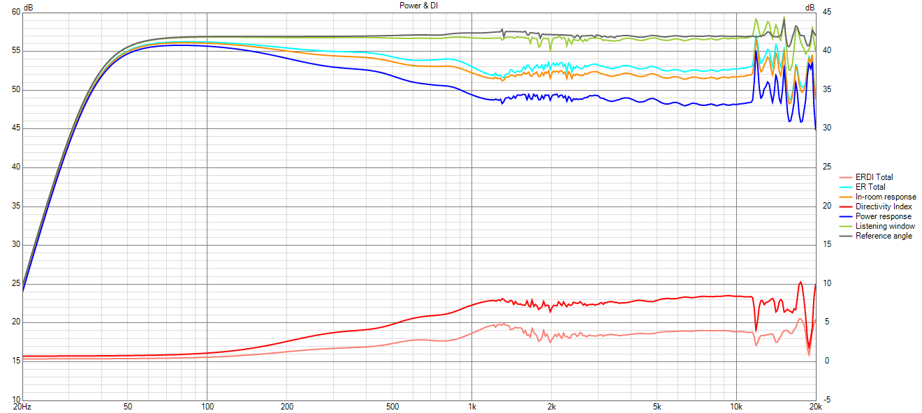

For the sound power, the solution can be as easy as using a different profile on the vertical axis. The extra energy there (also slightly oriented at kimmos rule, where he proposed a wider radiation pattern for the tweeter at the crossover) fills the gap. This is what I get in VCad for the same crossover:
The best pattern / sound power at crossover result I have achieved in simulation so far. Not a JBL M2, but for a ten-inch this is looking good to my eyes.

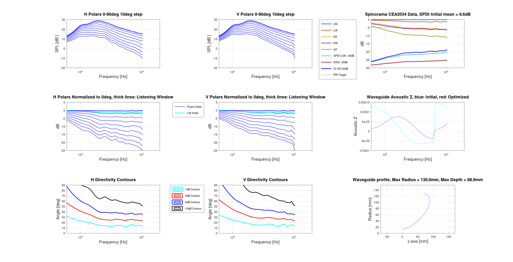

Hi sheeple! Could you share your workflow? I'd love to combine ath4 design/analysis with vituixCAD verification too.The best pattern / sound power at crossover result I have achieved in simulation so far. Not a JBL M2, but for a ten-inch this is looking good to my eyes.
I think something is messing up the report for VACS.Same thing happened to me with ABEC demo version but the exact same thing solved fine in AKABAK. Weird, nothing looks wrong with it.

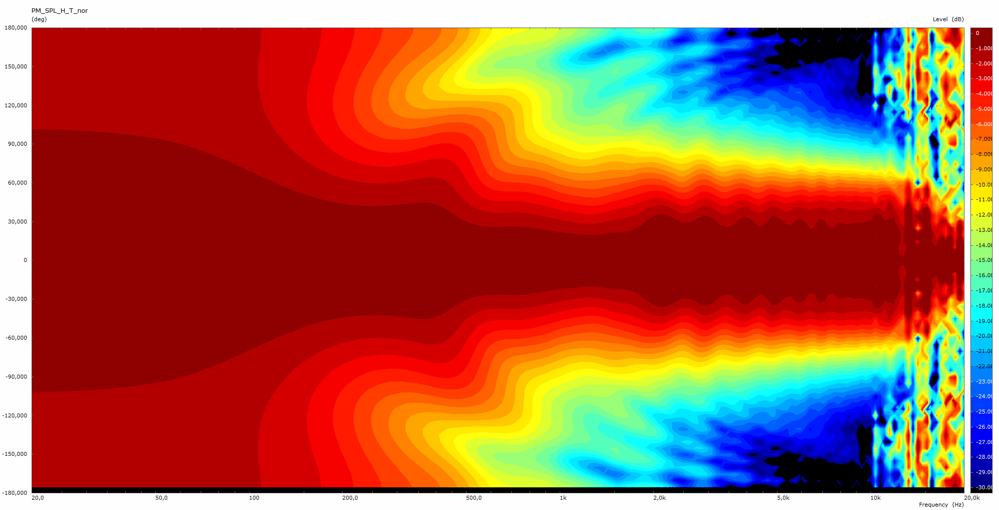

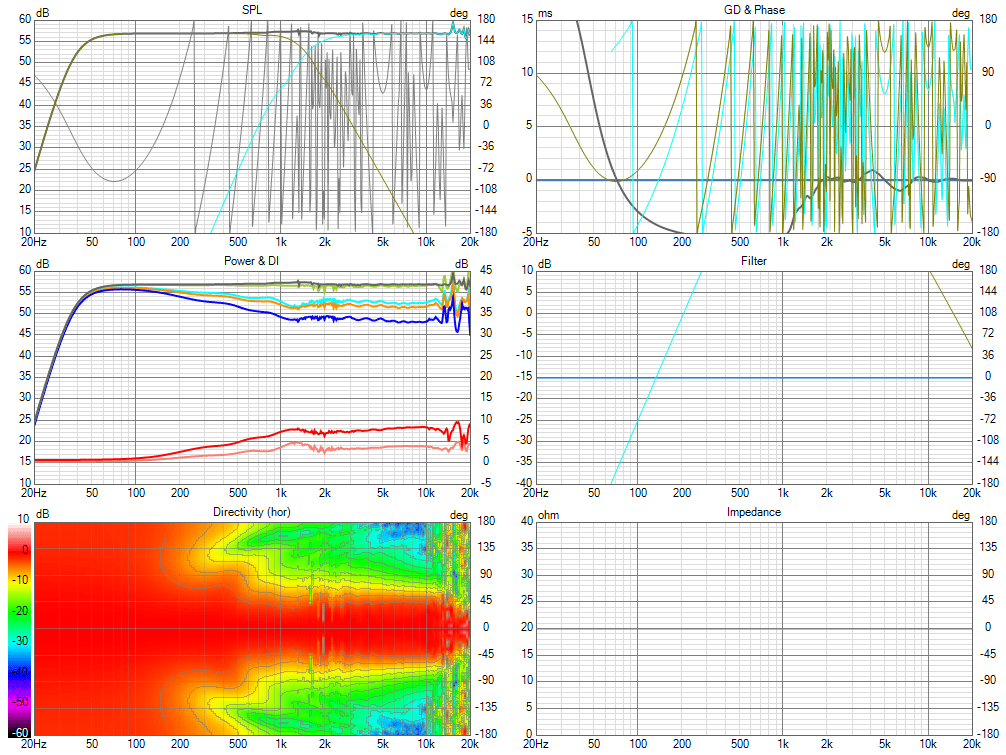

Create 4 ABEC polar observation sets in wg.cfg, for a full spin.Hi sheeple! Could you share your workflow? I'd love to combine ath4 design/analysis with vituixCAD verification too.
- tweeter +-180 vertical degree
- tweeter +-180 horizontal degree
The same for the woofer, all normalized to 0 degree axis.
From Ath 4.9, define the LFSource.B as SID = 1 and include the SID command in both tweeter (always SID = 0) and woofer obervations.
https://www.diyaudio.com/community/...he-easy-way-ath4.338806/page-541#post-7169897
Start calculating full spin 20-20k with frequency resolution of your choice, return later, ath [your waveguide .cfg path] -r and in the ABEC results folder, there is now FRD for both drivers.
Name them properly in the ath script so VCad automatically recognizes them (check VCad options), i.e. use NamePrefix = tweeter_ver (... tweeter_hor, woofer_ver, woofer_hor).
You can now search for either tweeter / woofer via Windows explorer search function in the FRD folder that was created by Ath in the ABEC Results folder. Select all (woofer / tweeter), cut and move them to a seperate folder. Go to VCad, add new driver, add all tweeter FRDs from one folder, add new driver, add all woofer FRDs from other folder. Done.

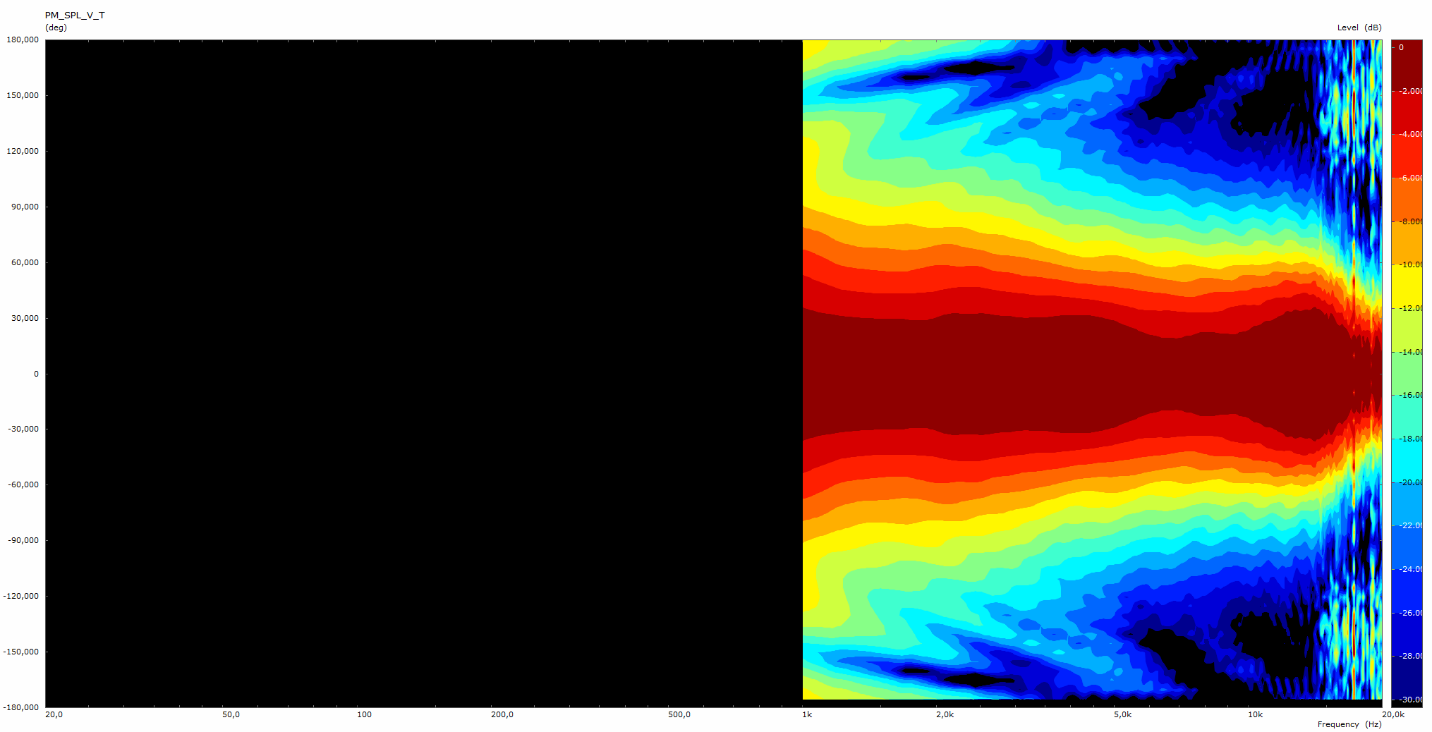

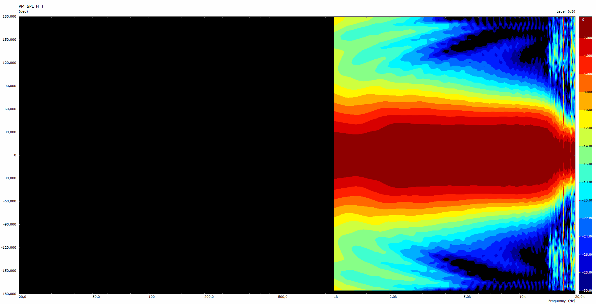

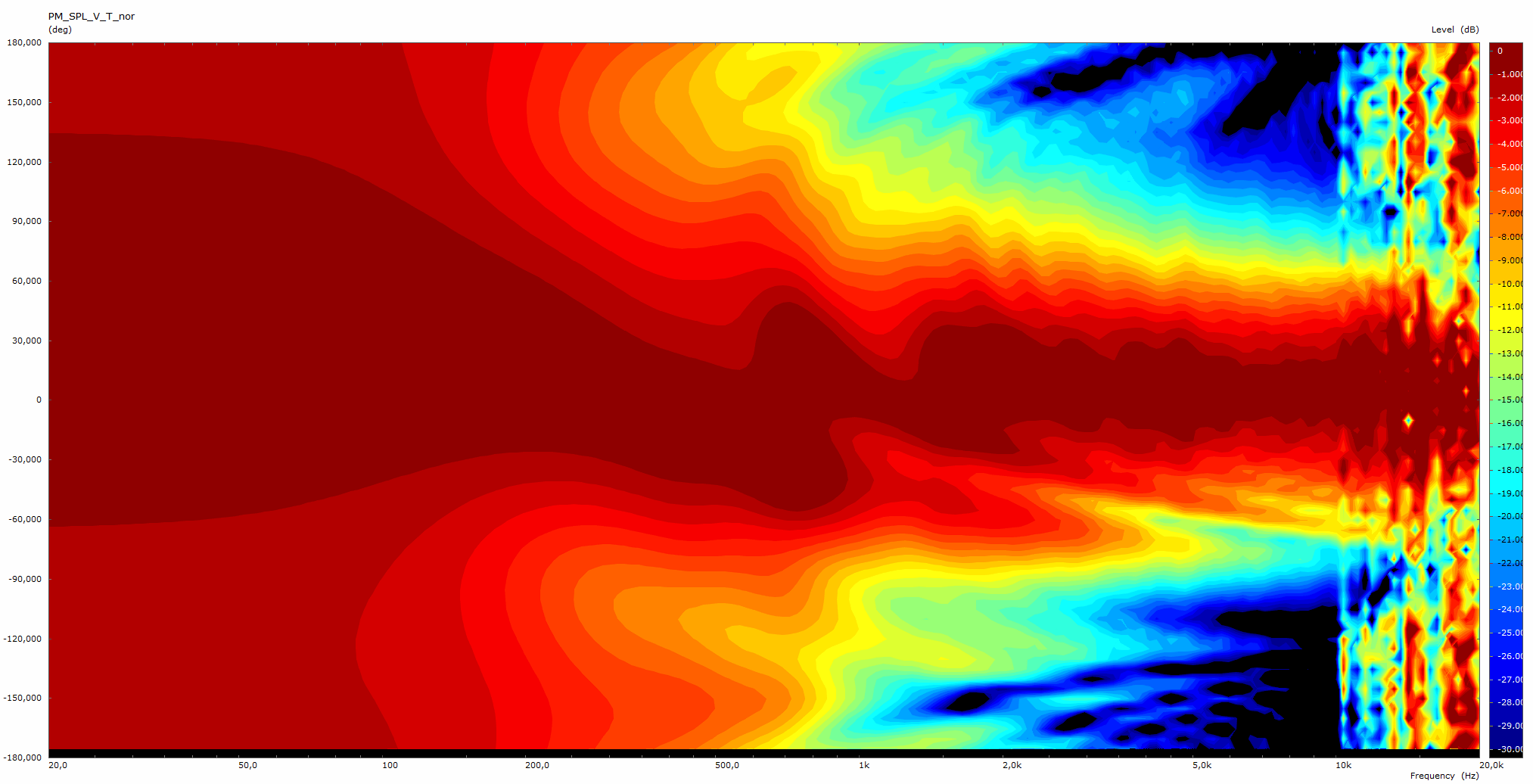

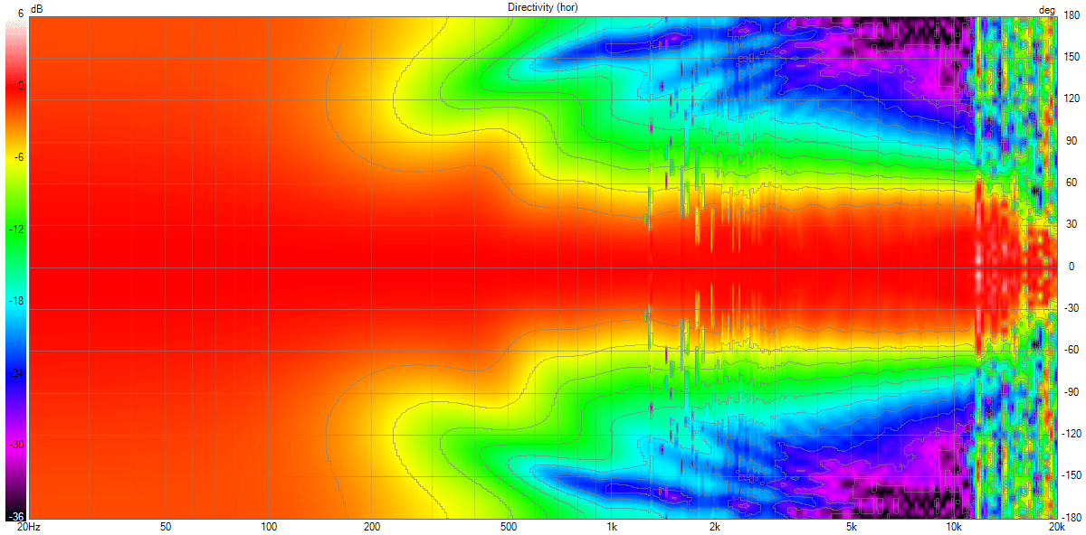

My issue with the wiggles prevails after increasing the resoultion of the rounded corners in half-symmetry. This is the results of waveguide in quarter-symmetry, free field:
This is mostly the same mesh (more resolution at rounded corners, frequencies = 200) in half-symmetry:
Also, phase issue is still in the data:
Is someone running Ath on Win11? The only change to my system lately.
