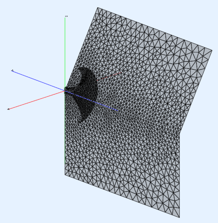

For a planar field, you can define as many as you want. With the spherical, it's indeed limited to the first quadrant at the moment.
BTW, with 'Resolution' you can define a nominal mesh size in each of the corners:
ABEC.AxialField:1 = {
Inclination = 60 ; [deg]
Radius = 0.4 ; [m]
z0 = 0.0 ; [m]
z1 = 0.75 ; [m]
Resolution = 10,20,50,30 ; [mm]
ABEC.AxialField:2 = {
Inclination = -90 ; [deg]
Radius = 0.4 ; [m]
z0 = 0.0 ; [m]
z1 = 0.75 ; [m]
Radius = 0.4 ; [m]
z0 = 0.0 ; [m]
z1 = 0.75 ; [m]
Radius = 0.4 ; [m]
z0 = 0.0 ; [m]
z1 = 0.75 ; [m]

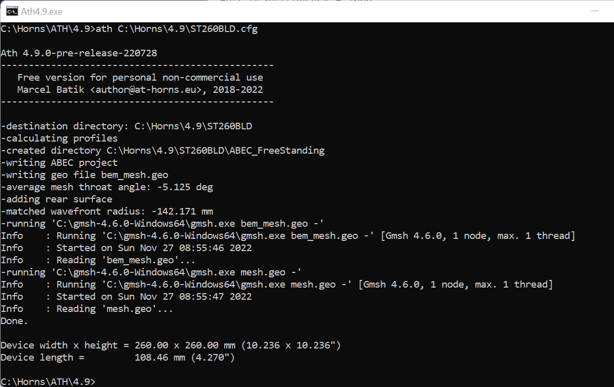

I tried with the exact ST260BLD code you just posted and I get these "Unknown control point" errors:It seems that it just crashes. It's possible that the old demos won't work with the newer Ath versions, it's probably better to start with something more recent.
Then I tried SDK version of GMesh and also gives same errors.
I'm sorry to bother so much, I just can't get started 🙁

Try using an older gmsh version, things do not get more compatible with gmsh as they update it.I tried with the exact ST260BLD code you just posted and I get these "Unknown control point" errors:
4.6.0 works fine for me with Ath 4.9 and the BLD code

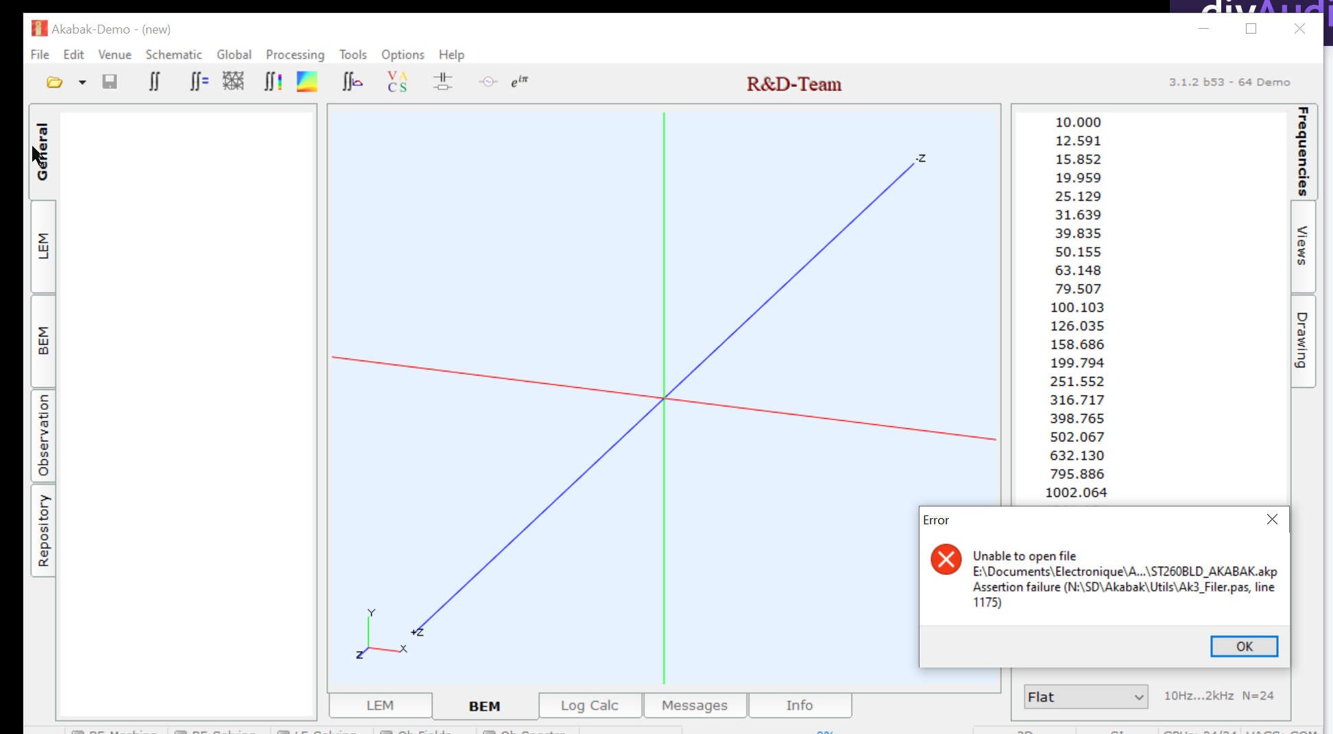

my laptop died and should obtain new one. I've asked, R&D team, new code for ABEC but seems there is no more ABEC, only AKABAK.
Is ATH compatible with AKABAK or I should somehow find code for ABEC
Explain Mr. Panzer that you need it for ath. He basically knows this project and I could imagine he then supports you (very nice guy!)

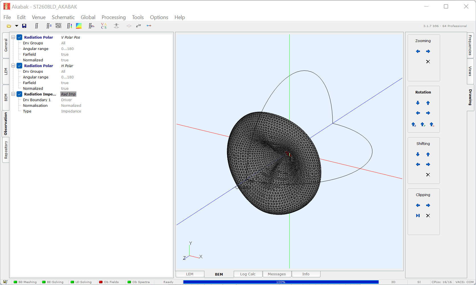

Some projects (e.g. the ST260BLD above) can be imported to AKABAK without an issue (AKABAK - Tools - Importing ABEC project), some can't, for some reason. Personally, I still use an old ABEC 3 demo without any code. I don't plan to change to AKABAK, as I still find it a lot more difficult to use.Is ATH compatible with AKABAK or I should somehow find code for ABEC
Ath+Gmsh create the MSH file (*.msh), which is the crux of what you need for a simulation. I guess you can always setup your own simulation in AKABAK using just this file. The mesh elements in the file are tagged into logical groups - see any generated project for a hint how to use them.
I felt the same but now I like AKABAK more 🙂I don't plan to change to AKABAK, as I still find it a lot more difficult to use.
I have attached a solved version of the ST260 BLD as an AKABAK project. I have fixed the things that don't import properly. Anyone can use this as a base template. I do this myself, copy the project to a new location and change the name before opening. Then swap the mesh file for the one you want and update the elements to the new references. It sounds more of a pain than it really is. The orientation and all the observation spectra will be the same. AKABAK will not output the spectra as text all in one go so the Ath report function won't work but VACS works fine.Ath+Gmsh create the MSH file (*.msh), which is the crux of what you need for a simulation. I guess you can always setup your own simulation in AKABAK using just this file. The mesh elements in the file are tagged into logical groups - see any generated project for a hint how to use them.
