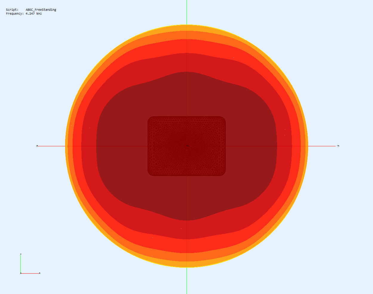

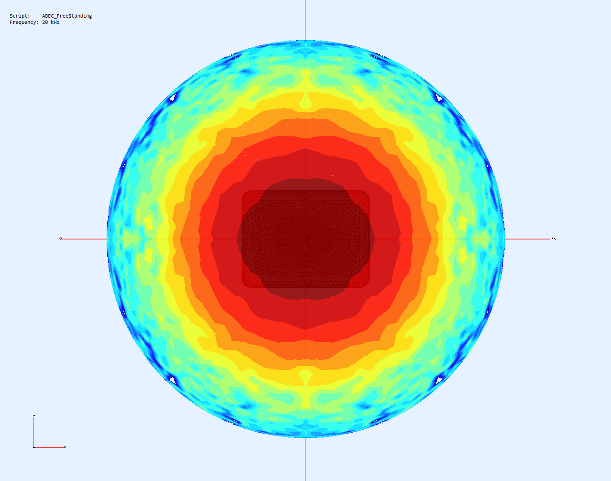

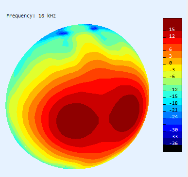

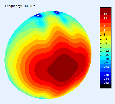

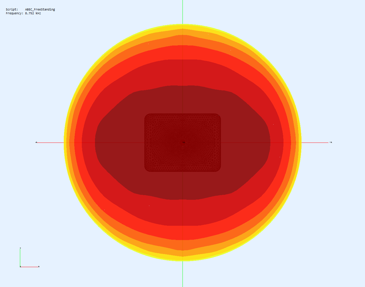

It's obvious now that the wide / non-narrowing vertical pattern of the BLD is kind of a trick (but a neat one) 🙂
Hah, yeah, better measure exactly right to catch the pattern 🙂

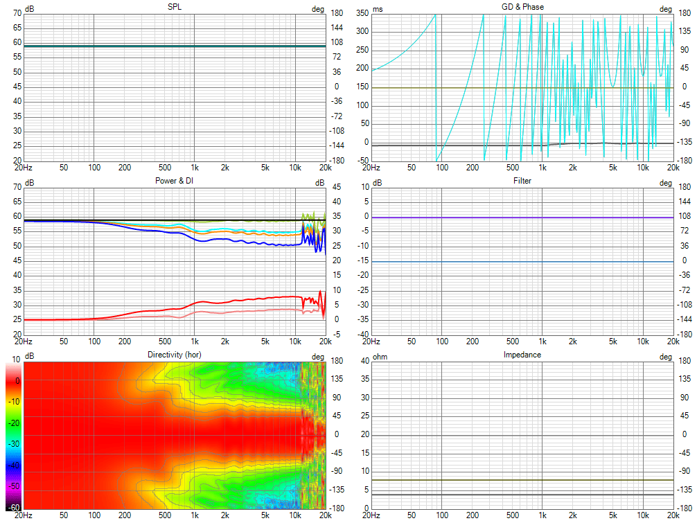

It is nice view of the device, I'm glad you added that. Might catch issues from that, like the BLD is probably fine waveguide you already pointed out the detail whicj wasn't visible on other data.

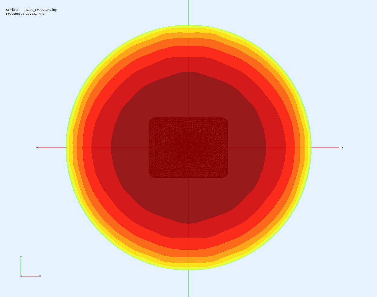

What does the top octave look like, for example 14kHz?

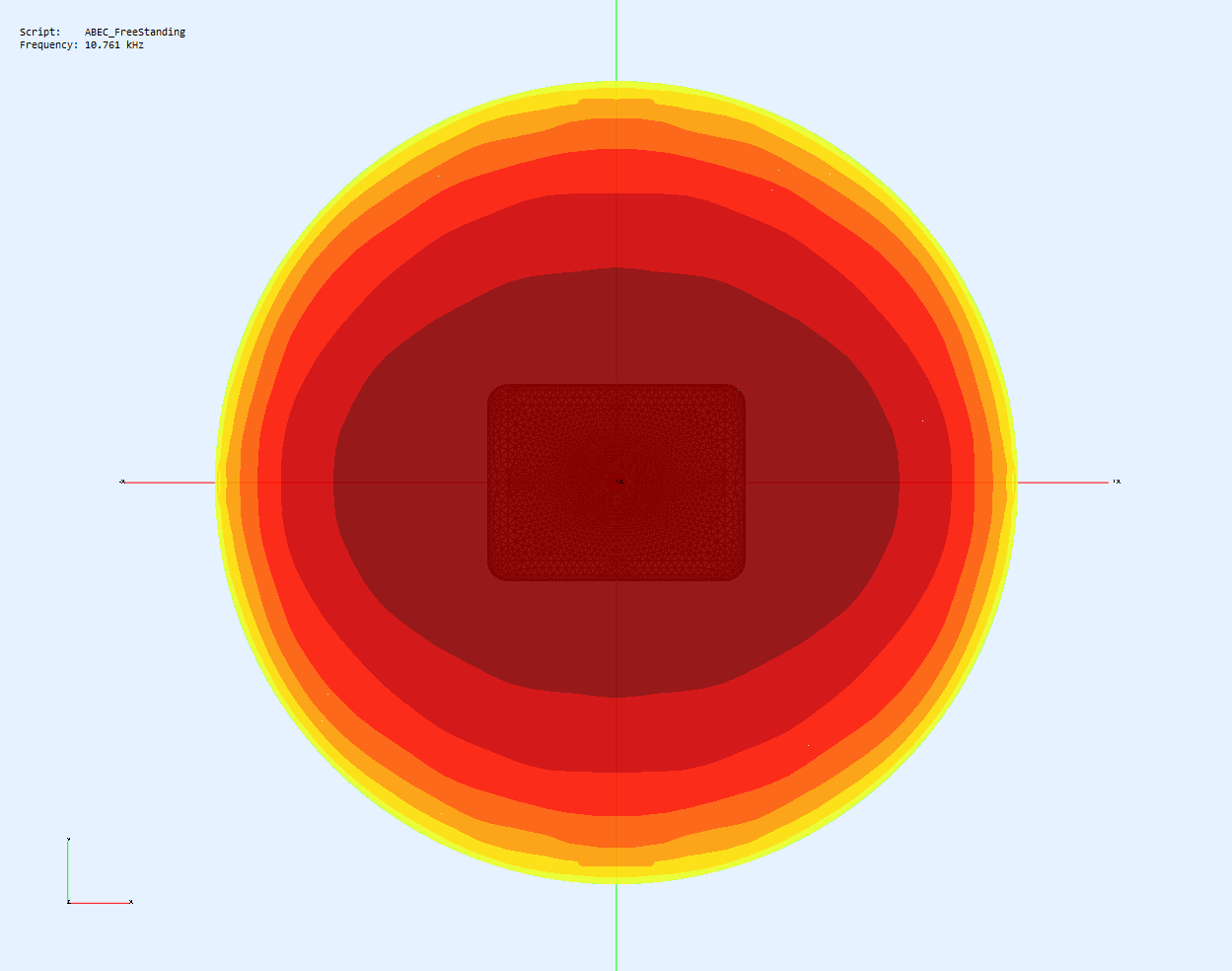

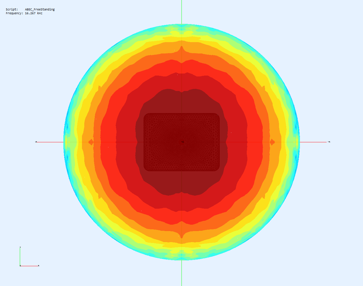

You can easily add a planar field manually in observation.txt however, without the need to re-solve the project.
Unfortunately for the spherical field the mesh file needs to be re-generated (at least I don't know how to create such a surface in an ABEC script alone).Possible to insert the command into observations.txt after calculation?

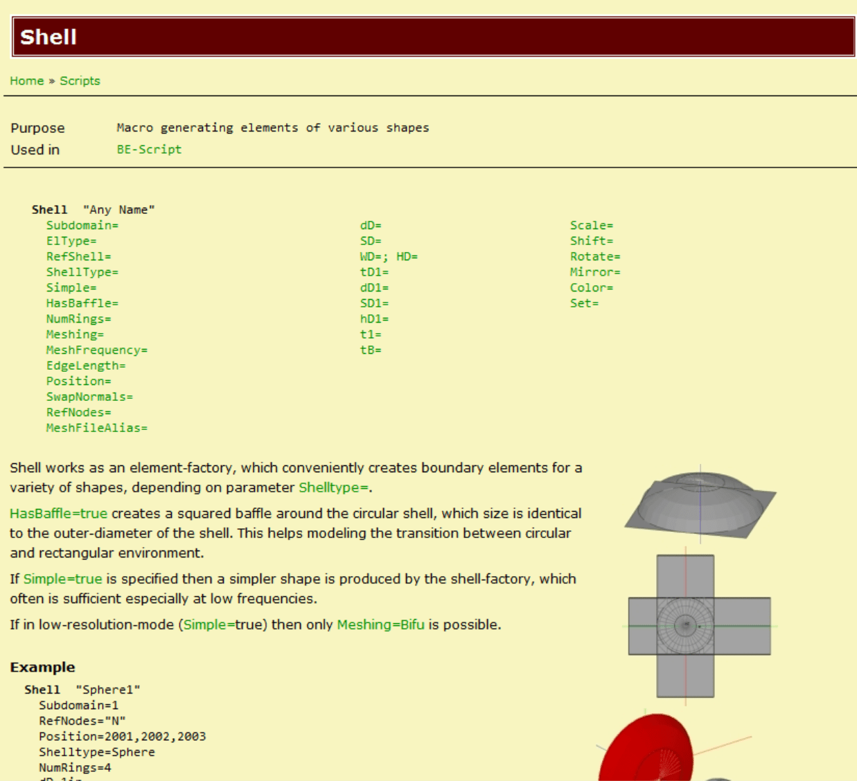

The Shell command is what you want for that, AKABAK has a Shell Field creation tool, in ABEC it's under the BE Script so would still likely have to be resolved.(at least I don't know how to create such a surface in an ABEC script alone).

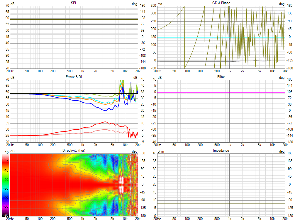

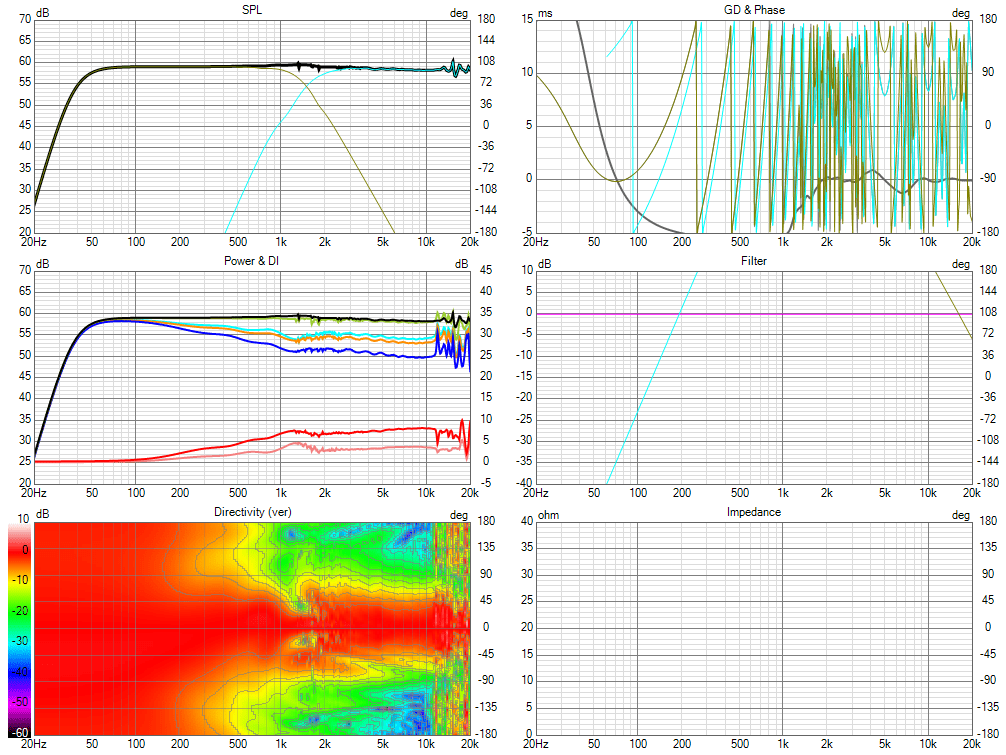

The corrupted phase issue remained after another simulation run:

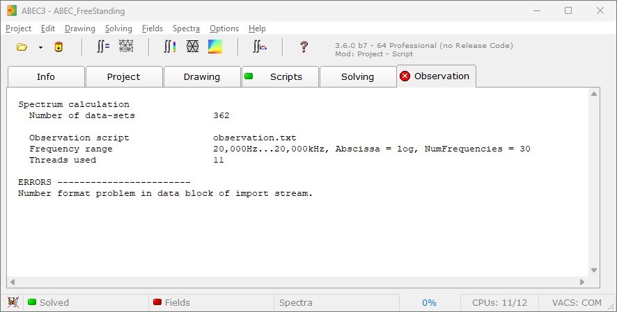

Sometimes solving of fields fails:
When I removed one entry from observations.txt, non-normalized plot "PM_SPL", it solved. ath49 sometimes was terminated after generating FRD from this. In the FRD files, only first normalized file had numerical phase enty, other files -inf. Afterwards adding "PM_SPL" again, also solved with unmodified observations.txt:
waveguide.cfg has the following setup:
Any hints what could be causing the issue appreciated.

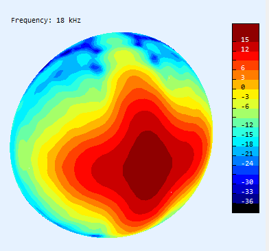

I'm not sure it has any value, as it's strongly dependent on a particular driver above ~13k, as we saw already.What does the top octave look like, for example 14kHz?
Reason for above phase problem could be: Copied the folders doc, export, lib from ath483beta in the 49 prerelease, ran -r command again from same data, issue gone. Sadly did not save Spectrum_ABEX.txt from the higher resolution run, but low resolution data now without the phase issue.

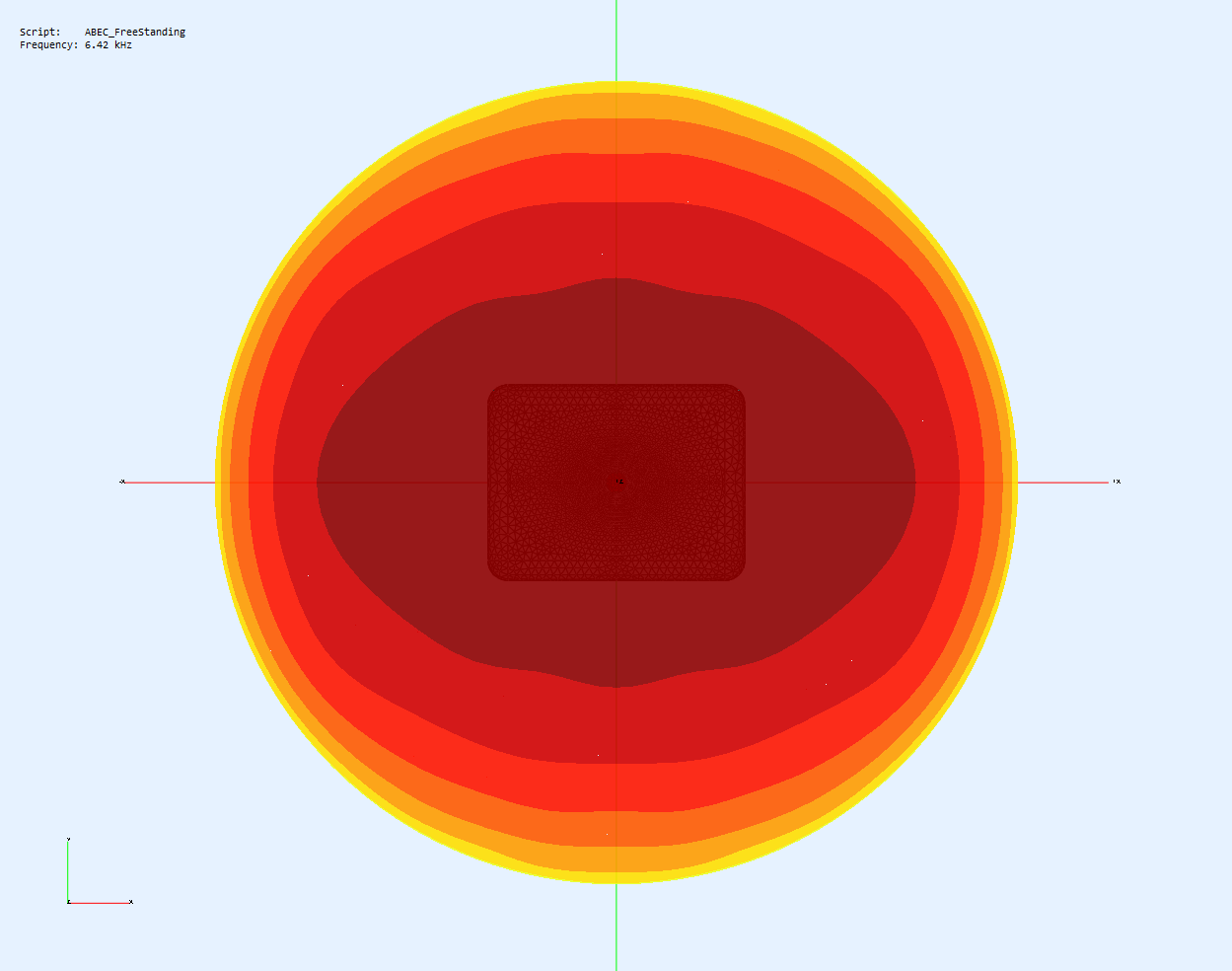

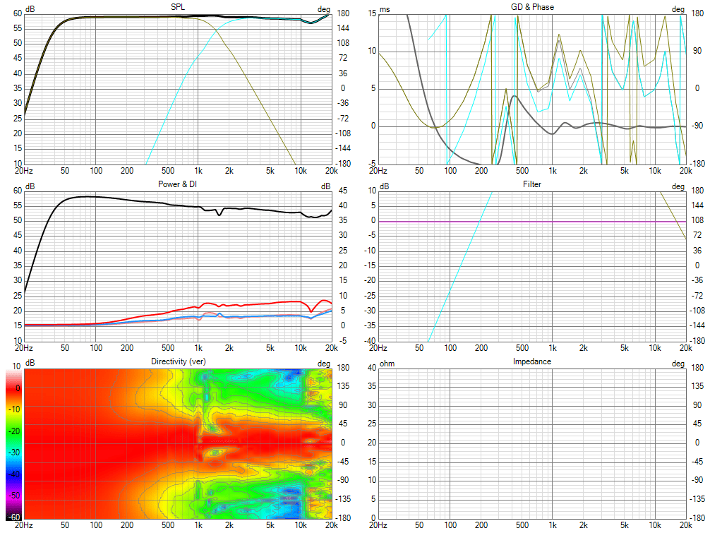

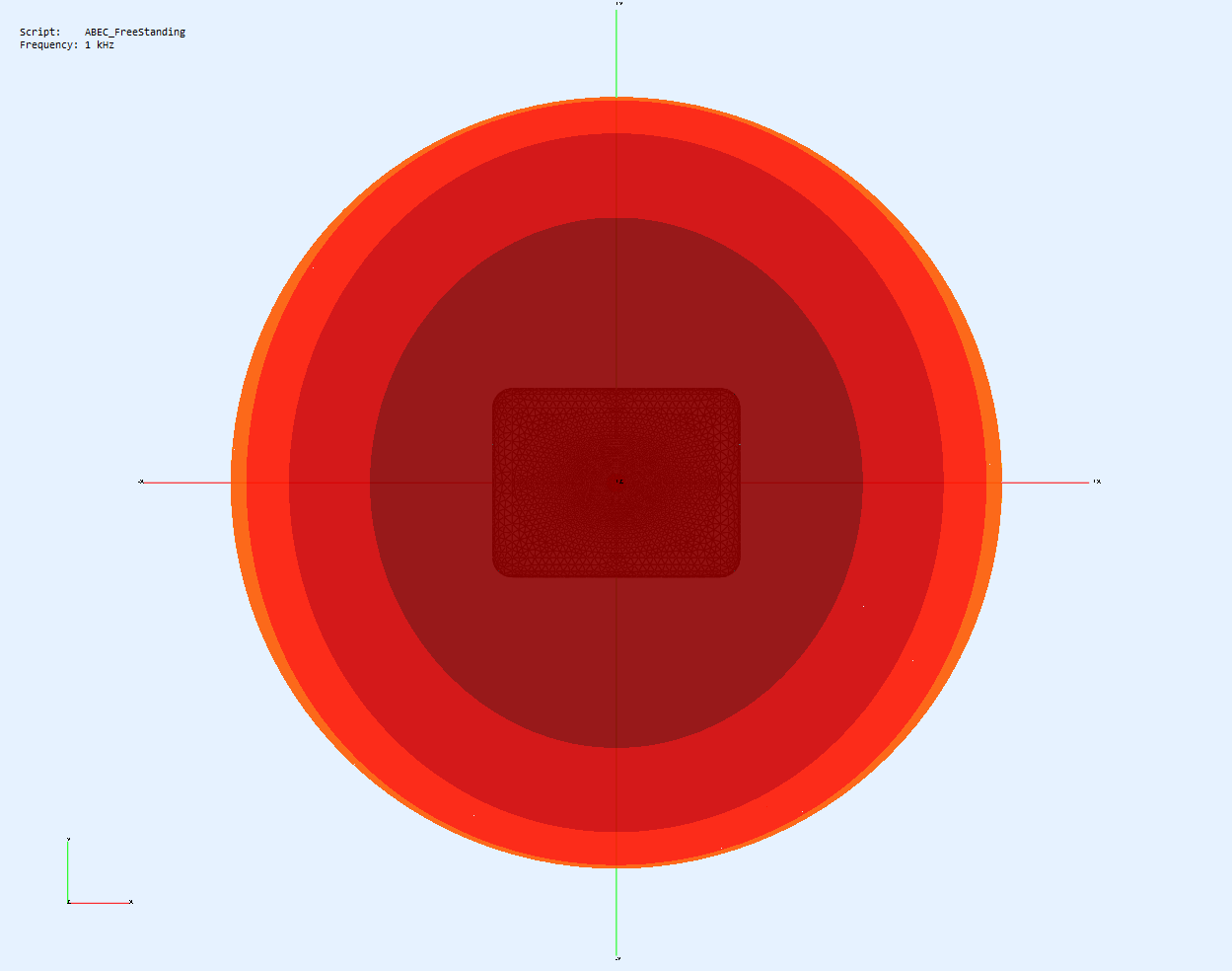

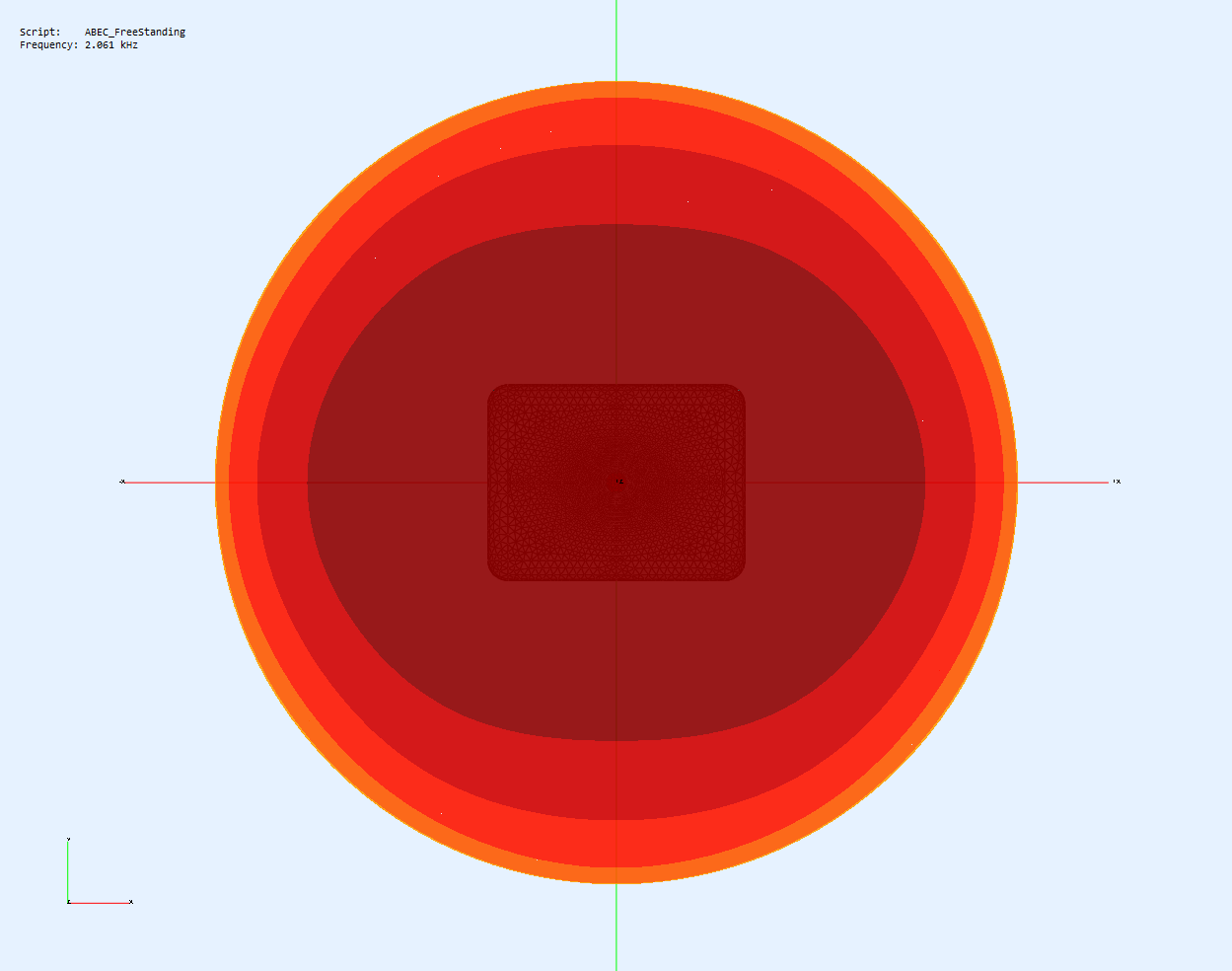

Quickly checked if fields would reveal any surprises, but this waveguide does what was expected from x- and y-axis graphs:
vertically wide low, for better crossover power; extra energy in vertical HF as a trick to have enough energy up top while also having horizontal pattern as smooth as possible, in-between asymmetrical.

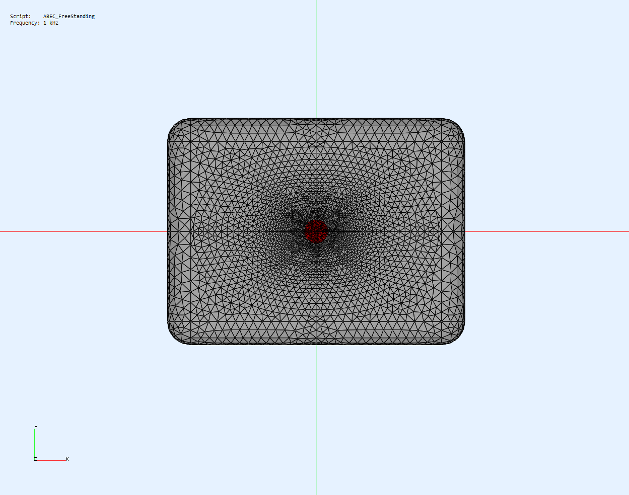

I saw from the current implementation of this field that the shell is kind of bound to the (one) source, and as soon as half symmetry is defined (with second source), only the upper hemisphere remains. Is it possible to generate such a shell that sees the field for two combined sources?
