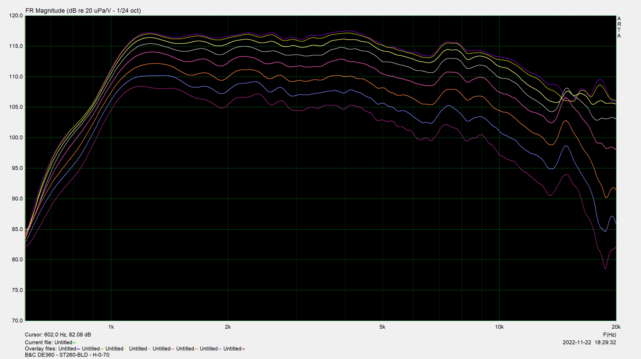

The BLD has a really well controlled directivity and is virtually diffraction free at least up to 12-13 kHz (where the CD takes it over anyway). The only downside I see at the moment is that it's somewhat ugly. I'll try a rectangular/baffle version as well. There's still plenty of what to try out on that design.Which one? the KVAR or the BLD? If I remember correctly, I believe the BLD had better vertical polars than the KVAR. Will repeat the measurements this evening.
Yes, it looks like when that really old aunt tries to kiss you on the cheek 🙂The BLD has a really well controlled directivity and is virtually diffraction free at least up to 12-13 kHz (where the CD takes it over anyway). The only downside I see at the moment is that it's somewhat ugly. I'll try a rectangular/baffle version as well. There's still plenty of what to try out on that design.

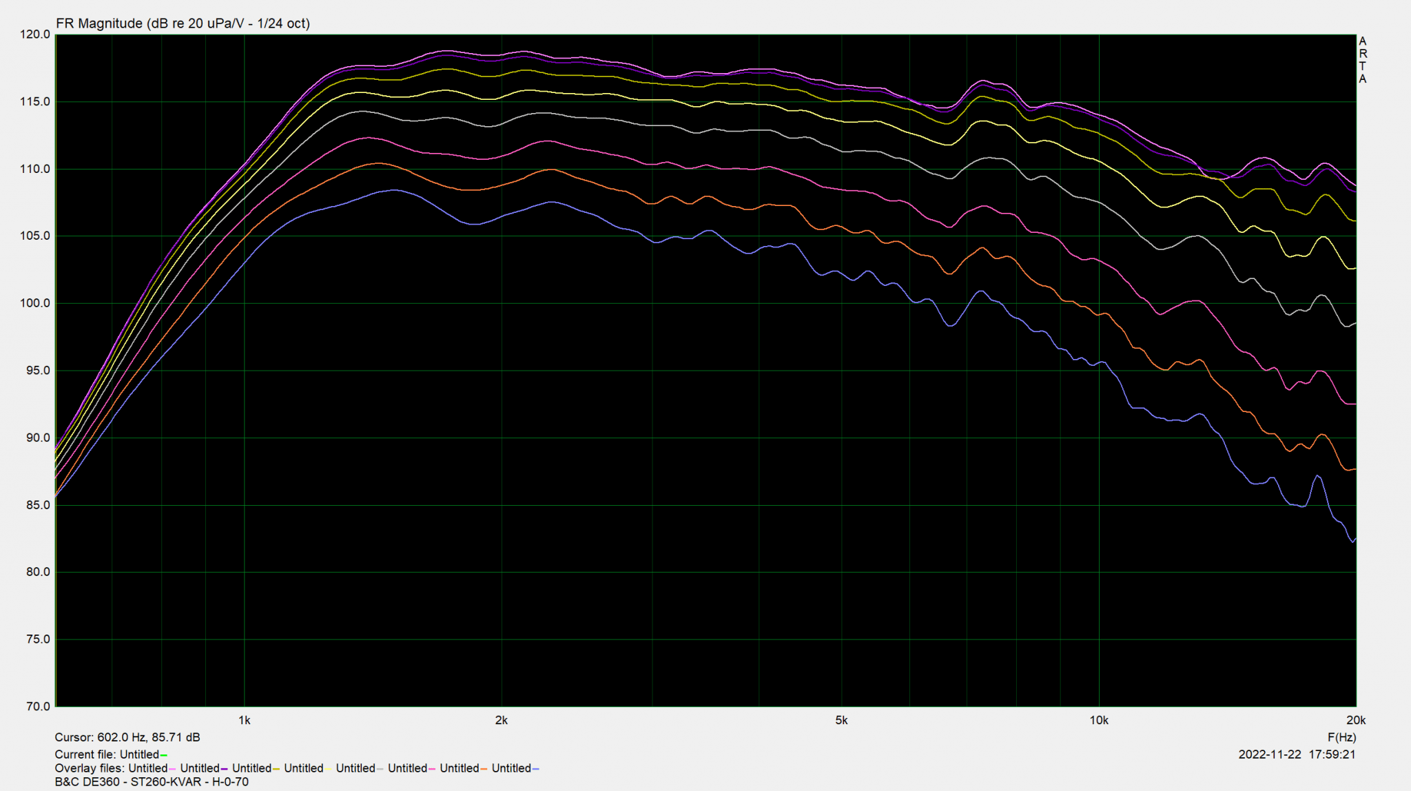

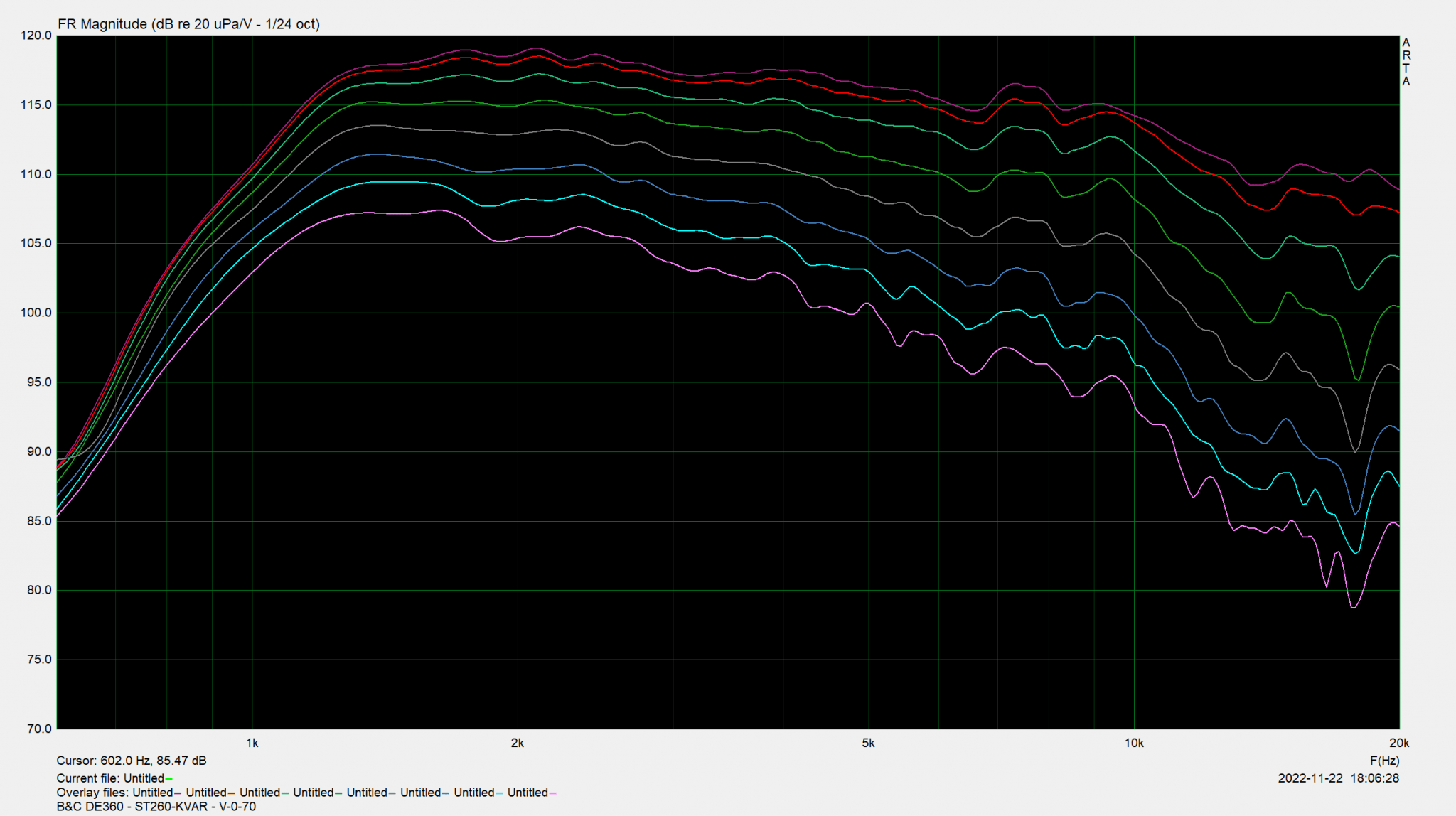

Okay - here we go. Some measurements:- Is it possible that the BLD was measured using a little bit longer time window?
1) BLD - Horizontal Polars - 0 - 70
2) BLD - Vertical Polars - 0 - 70
3) KVAR - Horizontal Polars - 0 - 70
4) KVAR - Vertical Polars - 0 -70
I tried to keep the measurements as consistent as possible (i.e., same distance - approximately 0.55m, same gate time (4ms), same driver, same mic location, etc.)
The BLD was printed as one piece
The KVAR was printed in two pieces, and just merely taped together.

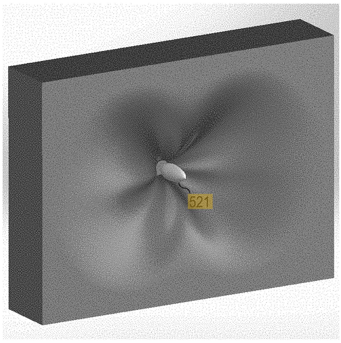

Harman wrote some software that iterated through thousands of different waveguide profiles, to find the optimal shape. When it finished, it ummm...
It looks like an anus
I don't think they ever ended up selling it in any designs.
Patent: https://patents.google.com/patent/US20200077180A1/en
There's even one with a phase plug that looks like... Well, umm, I think we all know 🙁
A possible M2 successor.Harman wrote some software that iterated through thousands of different waveguide profiles, to find the optimal shape. When it finished, it ummm...

I found the video where it's inventor explained how the Comsol optimizer converged on this shape:

I think there weren't many other options how could it end up (I mean the Samsung optimization exercise), given their constraints on the profile curves - the way they parametrized the splines. It was an easy and straightforward approach but inevitably leading to a shape like this. Employ e.g. the OSSE curve and it will look different - see the ST260. What I find actually intereting on their results is that it worked.
