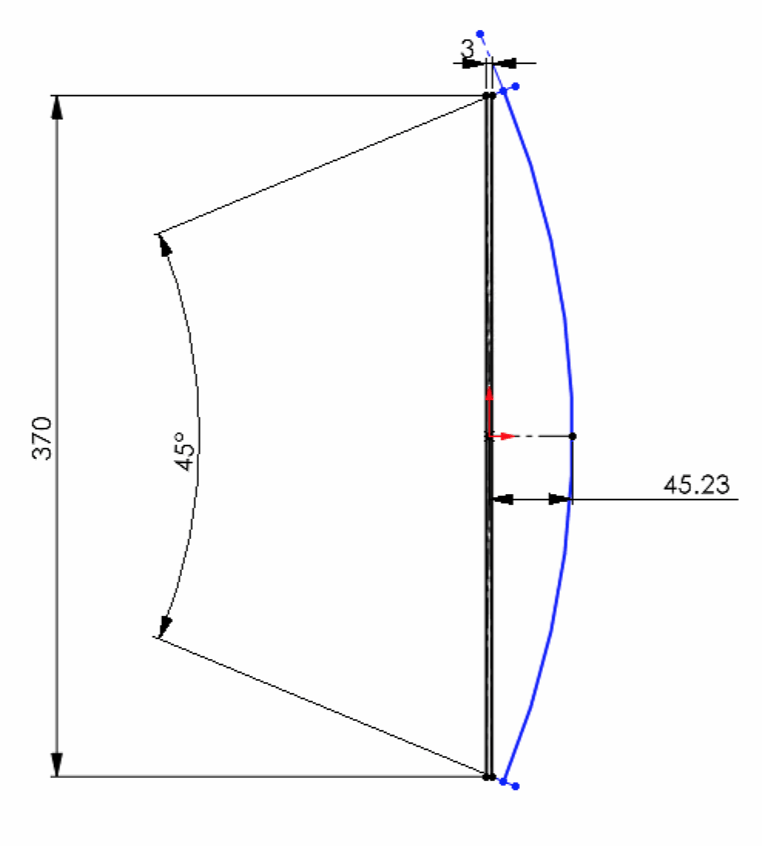

Maybe such an array (with a WG on the horizontal) could be made with some small form-factor compression drivers by using adapters that would guide the waves from the circular exits to small discrete segments of the circular arc of the CBT (i.e. one per shading level). How low in frequency could one get, say with 10 - 12 CDs at home listening levels? 🤔

Solely on displacement available, if one driver is capable of 800 Hz, ten drivers would handle ~250 Hz. In a CBT it's not that simple, it will be higher.
I don't think that a frequency-dependent delay or gain is really necessary, certainly not in a curved array as a CBT, which would be the only construction I would go for anyway (a tall one). I commented on the rectangular source in my previous post.

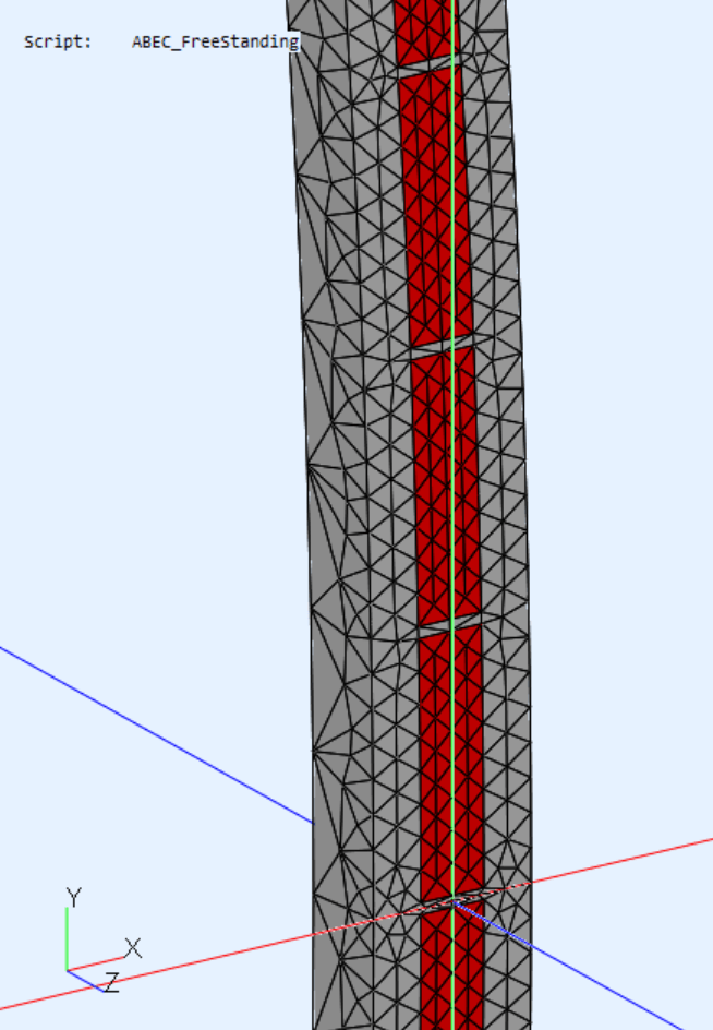

Here's the version for rectangular elements, including an example.
https://www.at-horns.eu/release/ath-beta-221115.zip
In observation.txt you can manually set the basic weights and delays (the default is the Legendre shading as used by Don Keele (page 6) - which has a typo, as I've just noticed):

I'll implement some trimming/averaging/normalizing across the arc groups...

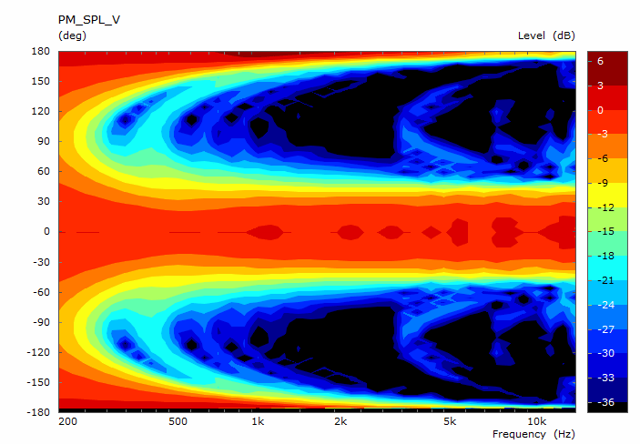

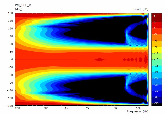

The previous example (22mm circles, 30mm c-c) changed to 12x45 rectangles, 47mm c-c:
The same from discrete elements 12x90 mm, 92mm c-c, I think the pattern is obvious.
-So, some basic analysis of various CBTs is now possible via Ath, now it's time to return back to big horns...

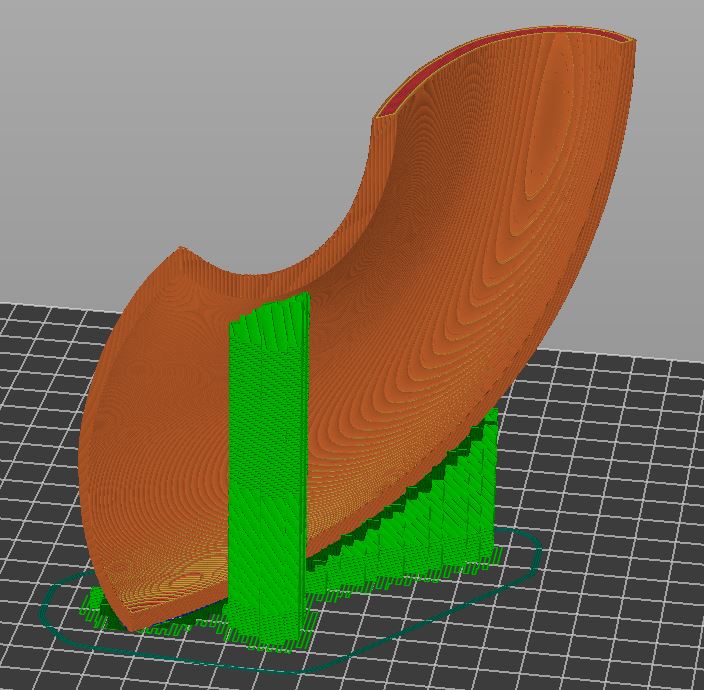

Might split up to into 4pcs in my X=33cm x Y=18.5cm Z=40cm - Phrozen Mega 8K.Here's a link for a 3D preview: https://a360.co/3USnCXg
Quick question about printing, how to specify more infil on the flange than on the waveguide part? I'm not too familiar with printing and have to order prints from some company, would like to specify/communicate this on next order. Already ordered one set of prints and its fine other than would like to have stronger flange not to be afraid to put some torque on the mounting nuts.

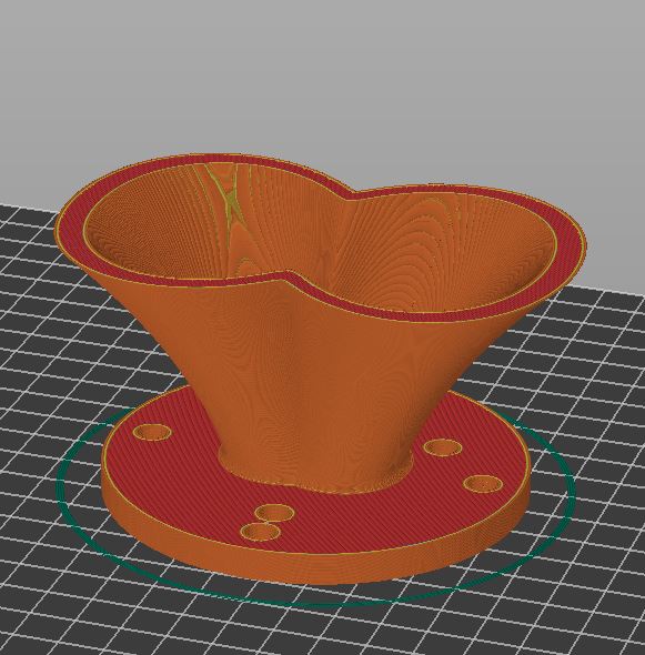

Sorry to muddy the waters again, but for a while I've been thinking that instead of using 2" drivers, it should be possible to use 2x1" drivers and combine them in the throat.
Looking at he 3d print you just posted, it reminds a bit of two throats 😀
I don't think this is a good idea for home audio but am keen on work and discussion in this area. I have a design for a dual 2" driver adapter I am working on: https://www.diyaudio.com/community/...per-scripts-and-m200-fun.385493/#post-7167590 . I have had a hard time making the geometry where the rounded corners transition to square (the simulation linked avoids this by not fully transitioning) but am almost done on another attempt to fix it. I'm not sure yet if my adapter will work at all well!Sorry to muddy the waters again, but for a while I've been thinking that instead of using 2" drivers, it should be possible to use 2x1" drivers and combine them in the throat.
