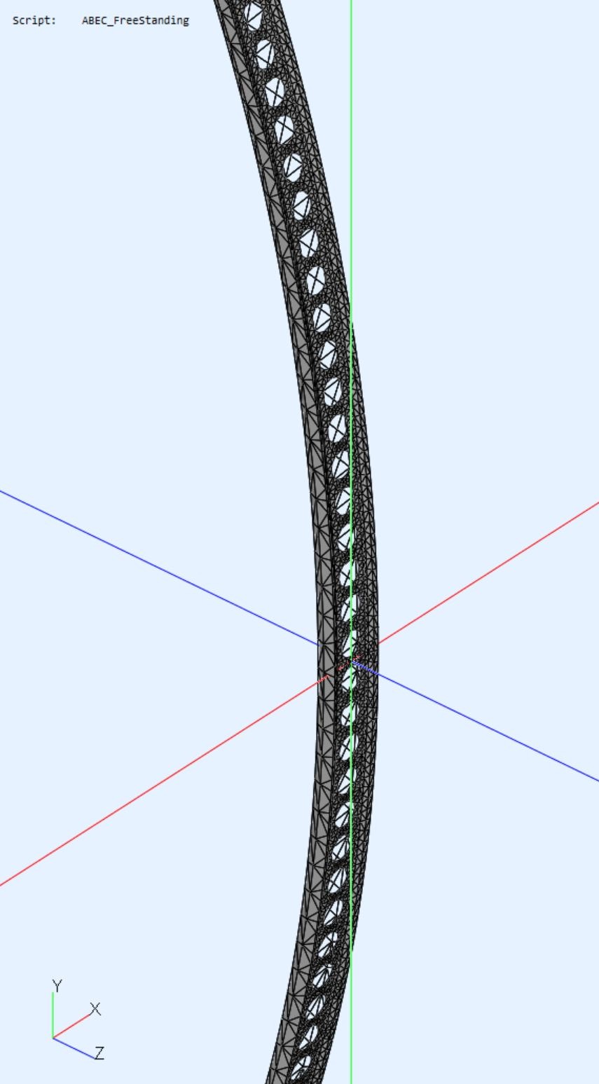

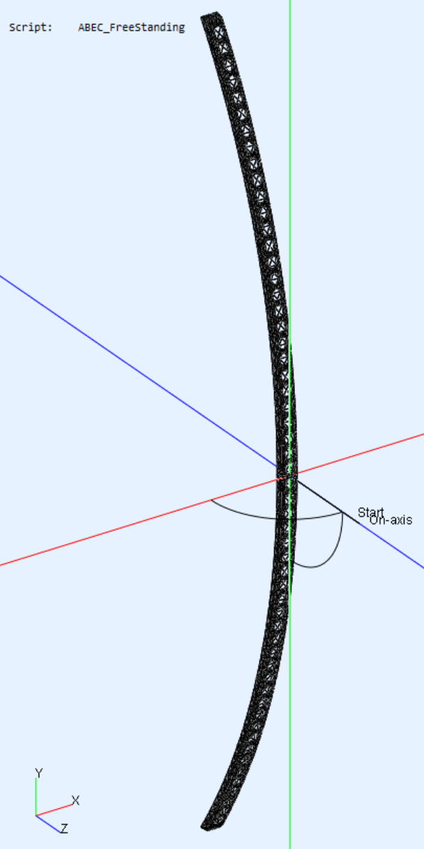

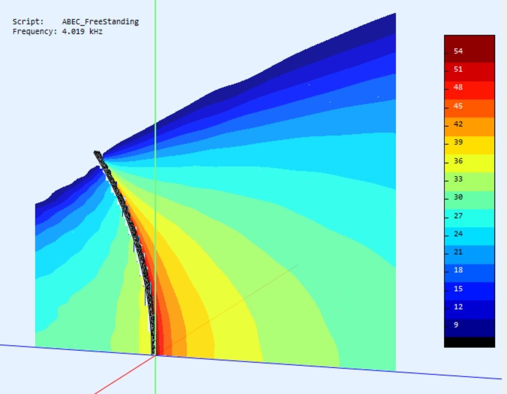

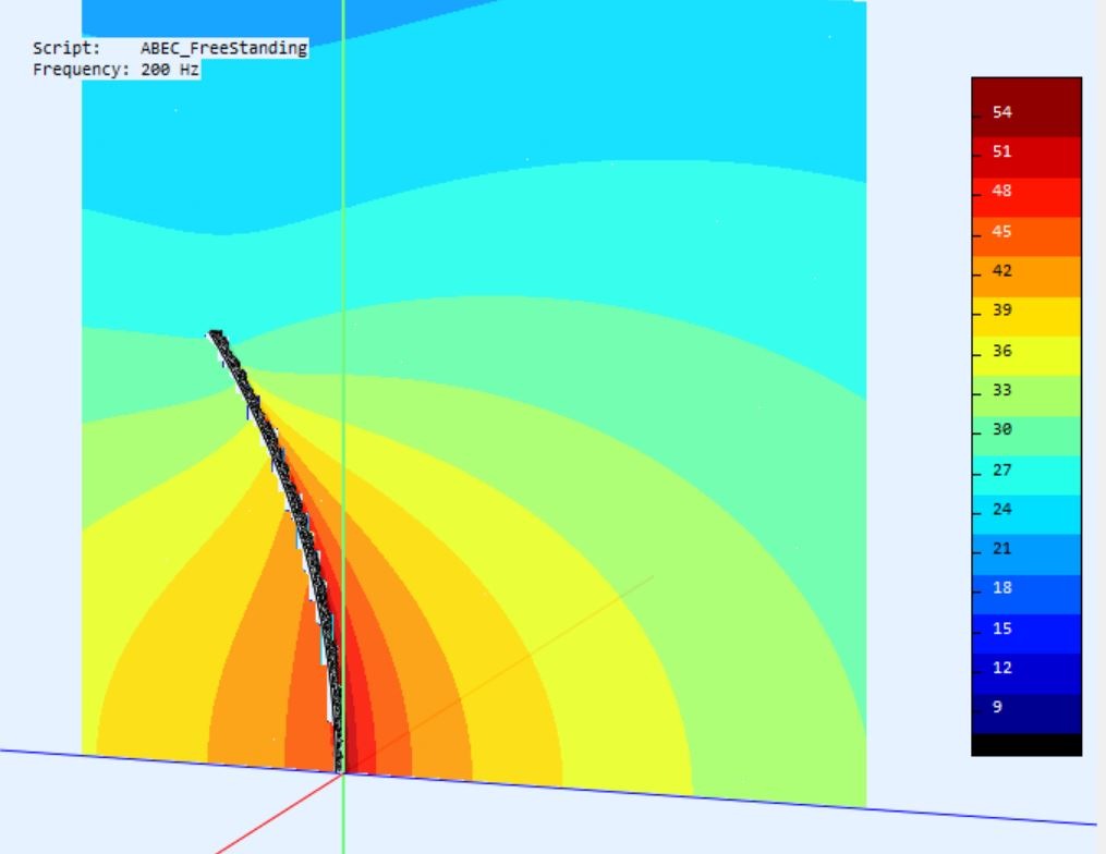

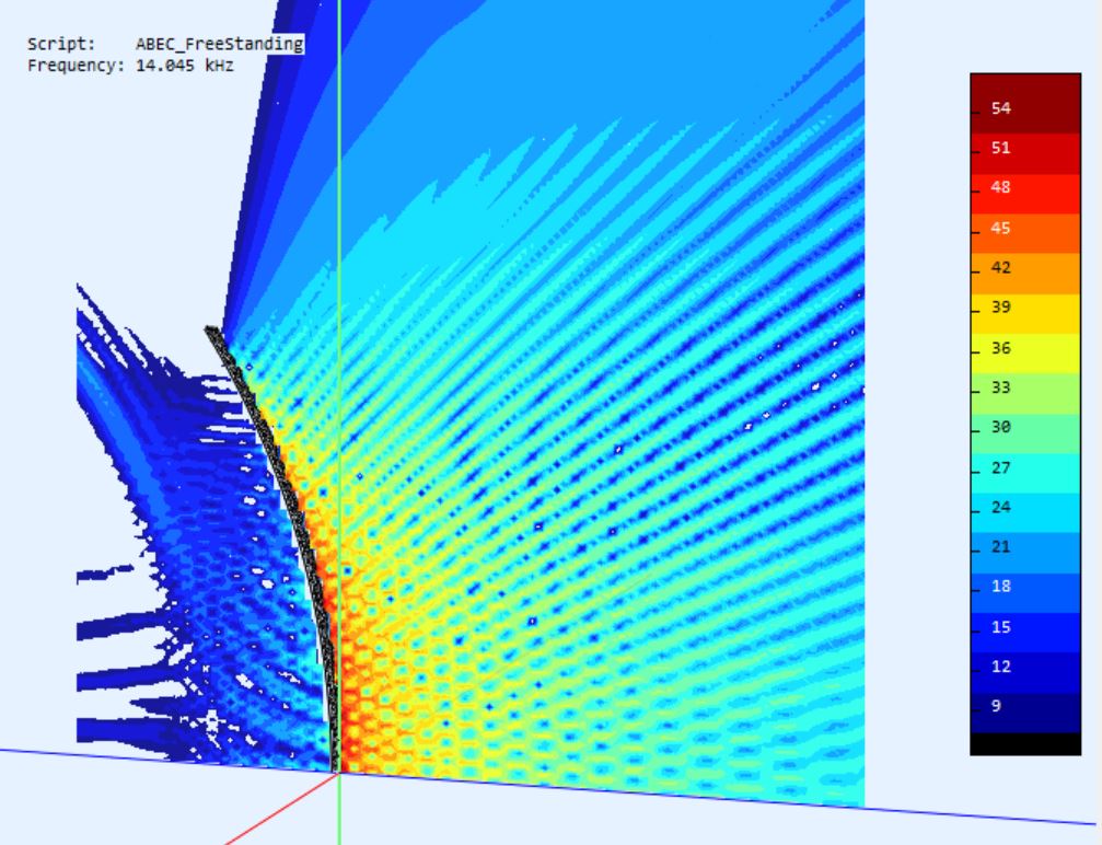

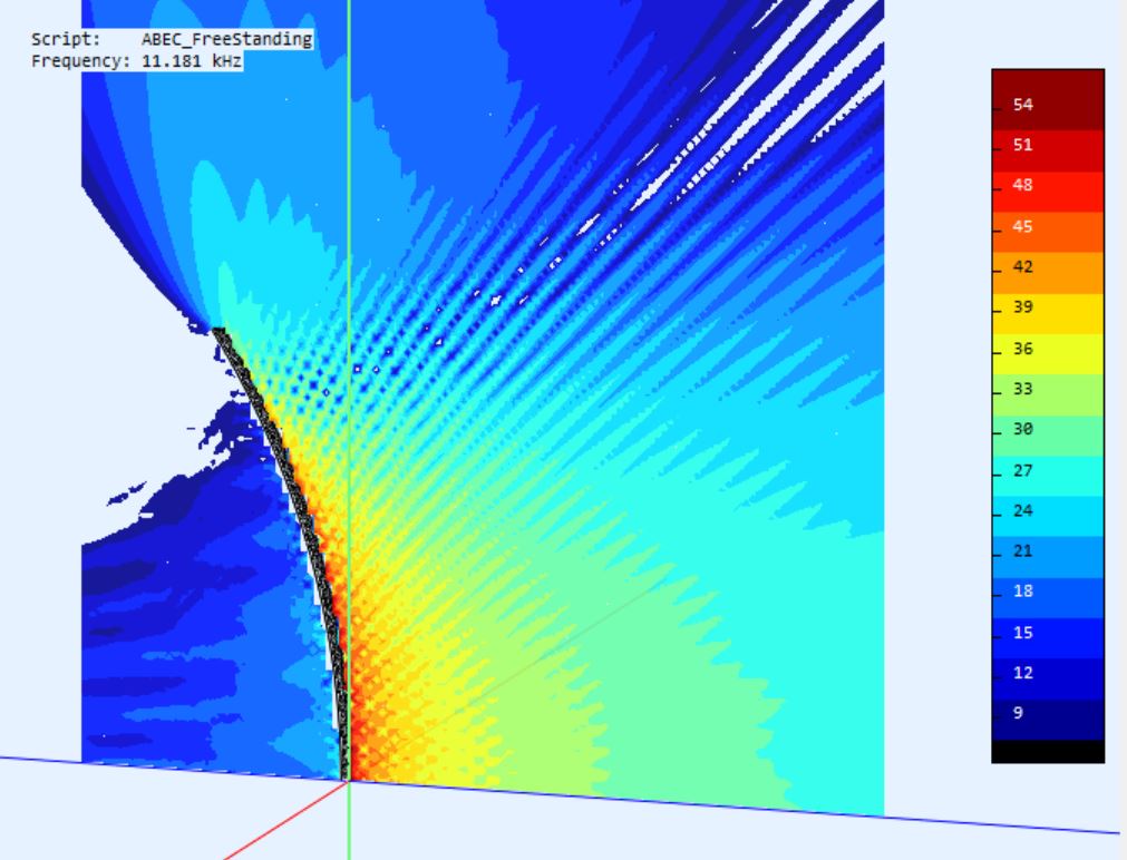

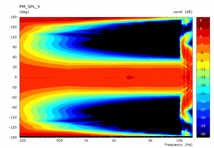

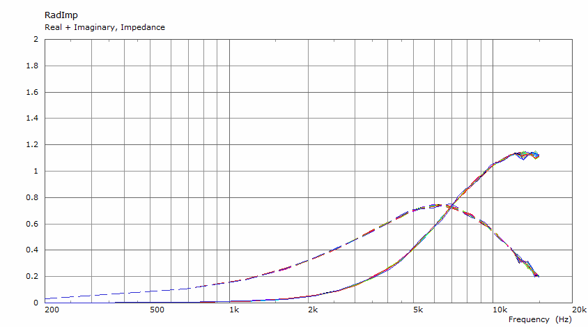

The first quick sanity check.
Circular arc length = 2x850 mm
Half angle = 30 deg
2x28 elements in CBT/Keele's shading
Element diameter = 22 mm
Element center-to-center spacing = 30 mm

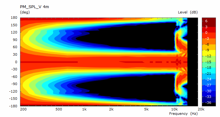

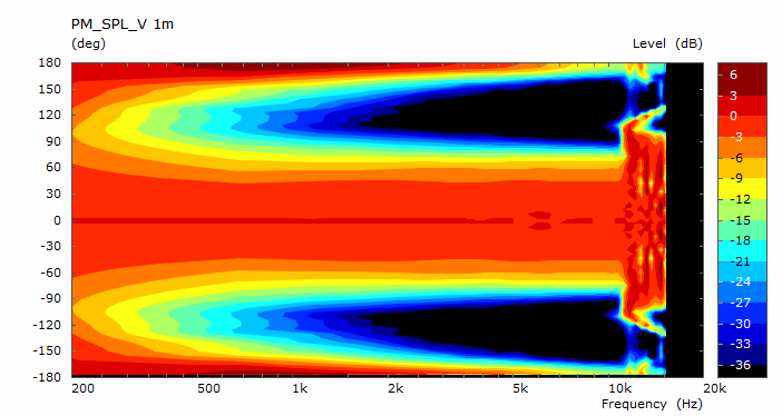

Vertical polars:
Half angle = 30 deg
Vertical polars:
Vertical polars at 1, 2, 4, 8 meters:
It's fascinating how rapidly it falls apart around 10 kHz. Partly it may be due to the BEM resolution but I guess this is basically how CBT behaves for the given c-c distance.
The bad news is that the simulation took almost 1.5 hour, despite only some 1700 BEM elements. That's probably due to the high number of separate sources (?).
