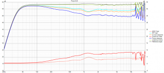

My efforts to control vertical pattern and at the same time create a wide disperson 60 degree horizontal pattern led to a very wiggly waveguide. Stupid, this only shows up with more resolution and calcultion time. Any tips how to improve the workflow for earlier detection and design appreciated.

If you end up with a mesh that has too many thin triangles you get this sort of pattern, very much like a non unique problem, but turning NUC on does not help.
Try the zmap points to make the mesh have the triangles be all a very similar non thin shape or just ignore it as a simulation artefact.
Interesting. Just to make sure we are on the same point: I am not concerned about the splash >10k, which is a mere artifact of the resolution. I mean the strong wiggles between 2 and 8 kHz.
The mesh does not include thin triangles that should be problematic:
With previous waveguides that did not treat vertical and horizontal pattern as different to the degree this one does, they did not show as many wiggles. And after all, Ath designs tried to combat this typical behaviour of commercial waveguides IIRC. Speaking of commercial designs: Does not the S360 waveguide response looks less struck by this behaviour? https://www.audiosciencereview.com/forum/index.php?threads/genelec-s360-review-studio-monitor.36187/, as well as Neumann's KH150? https://www.audiosciencereview.com/forum/index.php?threads/neumann-kh150.33454/post-1363792 If they can surpress the wiggles and do so, this should be possible for is to do too.

No not what I was talking about, the slight diffractive ripple that you term strong wiggles is hard to completely avoid when there is a complete baffle being modelled. The fully reflective boundaries highlight issues that you would not see in the same way in a real speaker.
It's not the resolution that creates the artefact but by increasing the mesh resolution there can be more chance of making meshes that are hard to solve, hence the garbage.
I can't see in enough to know but there is something wrong with it to get that sort of result.
